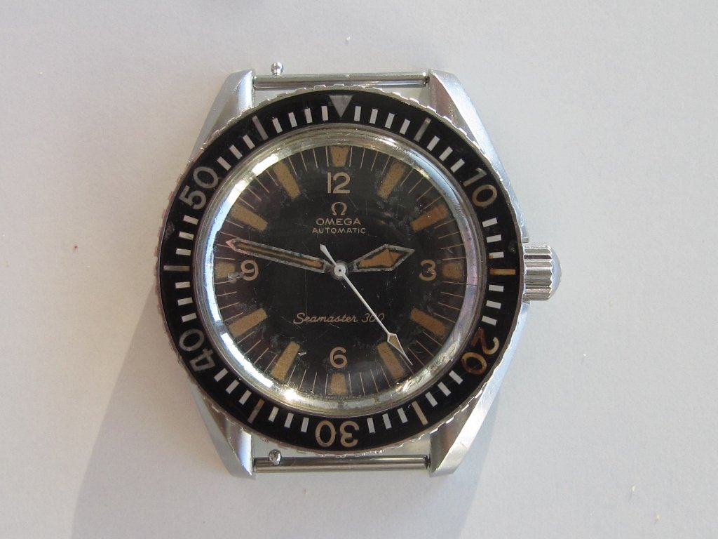

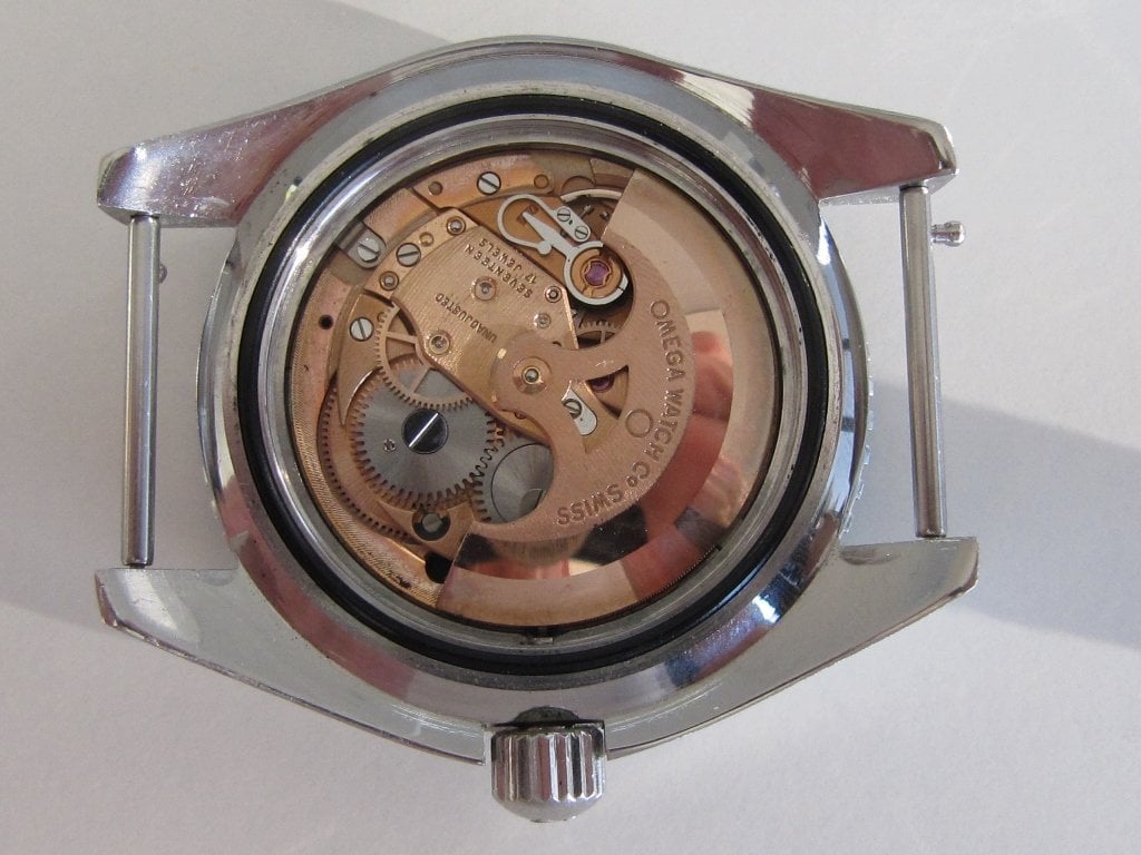

A little update what happened so far:
I gave the crystal a chance with a polish: now it allows a better view on the dial, the dilemma is: the better the crystal, the worse the damaged dial looks, but I can live with that: it´s a diver, so getting in contact with water will lead to typical signs of wear... The gaskets are changed, the pressure check (without movement) was ok, the lume was stabilised from the back. The movement got cleaned and oiled. Otherwise, the case stayed untouched as is. The bracelet got adjusted, so now it is ready to be used: probably more a dress watch with a diving past than a true tool watch...
Btw, are there members here that use these vintage ones still for diving? Share your experiances if you have...
Best, caslock

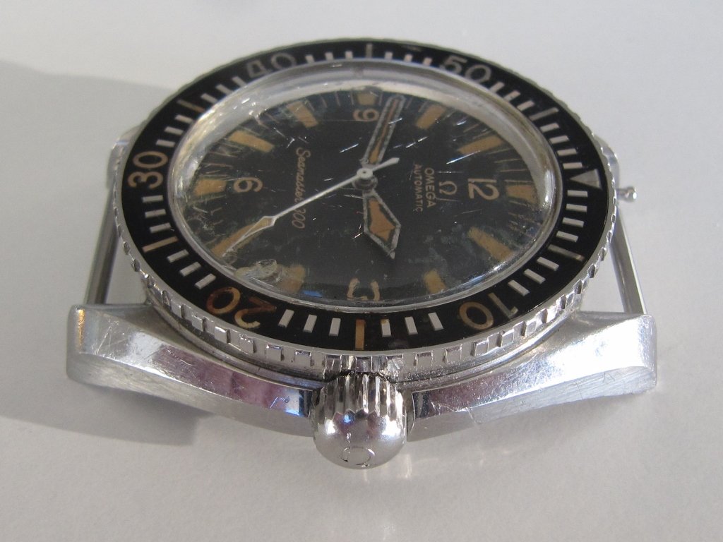

It's hard to see the condition of the dial due to the lighting (case and bezel look VERY nice!). Can you post pics with the dial receiving direct light?
As to your question about diving etc--mine recently passed a pressure test to 300 feet, but I don't feel it's worth the risk to use it for water activities (swimming, fishing, etc). The difficulty and cost of finding a nice replacement dial/handset makes my decision easy. I will use a modern diver (Serica 5303). Your results may vary.
edit to add: Mine is not a screw down crown.

I wear/swim/dive a screw down variant only (watchco), vintage naiad version I don`t swim in salty waters, as it kills the bezel lume most...I made this experience on my Ploprof in the past...
So, if you get you SD crown changed + crystal and case back seal + WR test pass, you can dive it. As you bezel is also beyond saving, I can`t see why not...

I will try to take a better pic of the dial. And thanks, I share your point on using the watch in the water...

The SD crown is likely the safer choice for diving compared to the Naiad crown. Still I have the feeling that the water could harm the bezel insert: I would expect it to creep inbetween the acrylic and the steel rim, especially on a watch of 50+ years...

Yes, it will harm the bezel insert lume, it can turn down from vintage yellow patina to gray/ black.
But yours wont get much worse, than is now

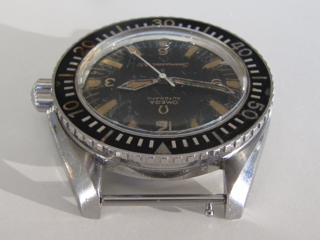

I forgot to post: this is the best picture so far to show the damage on the dial....

👍 indeed: a nice and authentic gilt no-date 300! I would only polish the hands - if at all.....and avoid water 😉

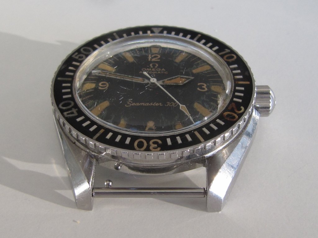

Would just stabilize the lume - have clear coated the back of the hands and leave it as is...

... I will go this way ...
