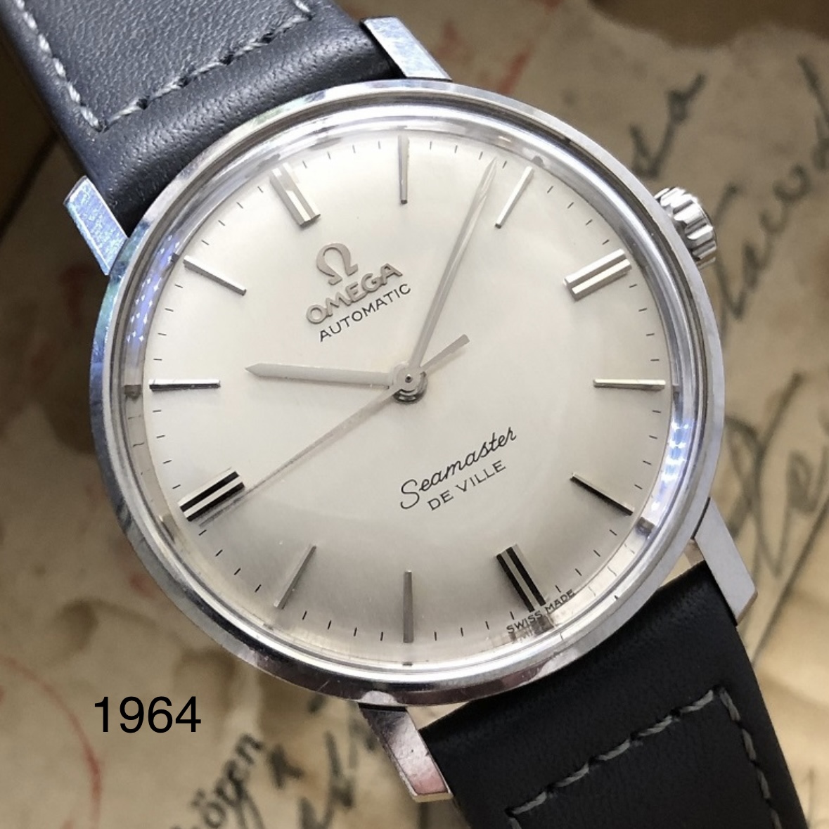

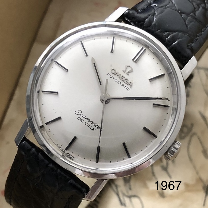

Hey everyone I am looking to find myself a 165.020 seamaster de ville. I have been doing a lot of research on the forums and I think I’m getting better at finding redials, but this one I just found kind of stumped me. It’s a 165.020 from 1967. The things that drew red flags are the M in automatic, and the first E in seamaster.
I’m going to attach pictures of a 1964 vs 1967 De Ville.
Did omega change the text a little in the late 60s? Or is it just a redial? Thank you everyone in advanced! Lookin forward to leaning more about this reference.

Don't see any issues with either one, nice original no-lune dials.
There were text variances which can be attributed to age as well as dial supplier.

A front on shot is preferable to assess a dial but from that picture I’d say original.

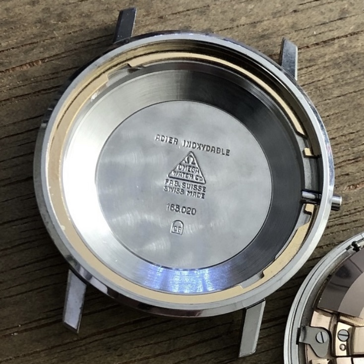

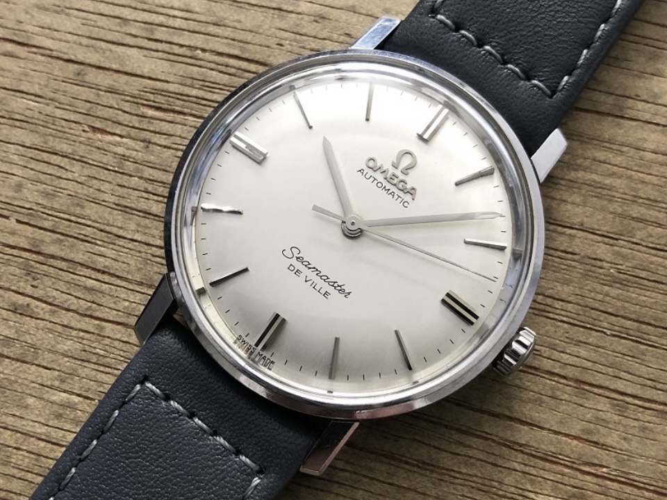

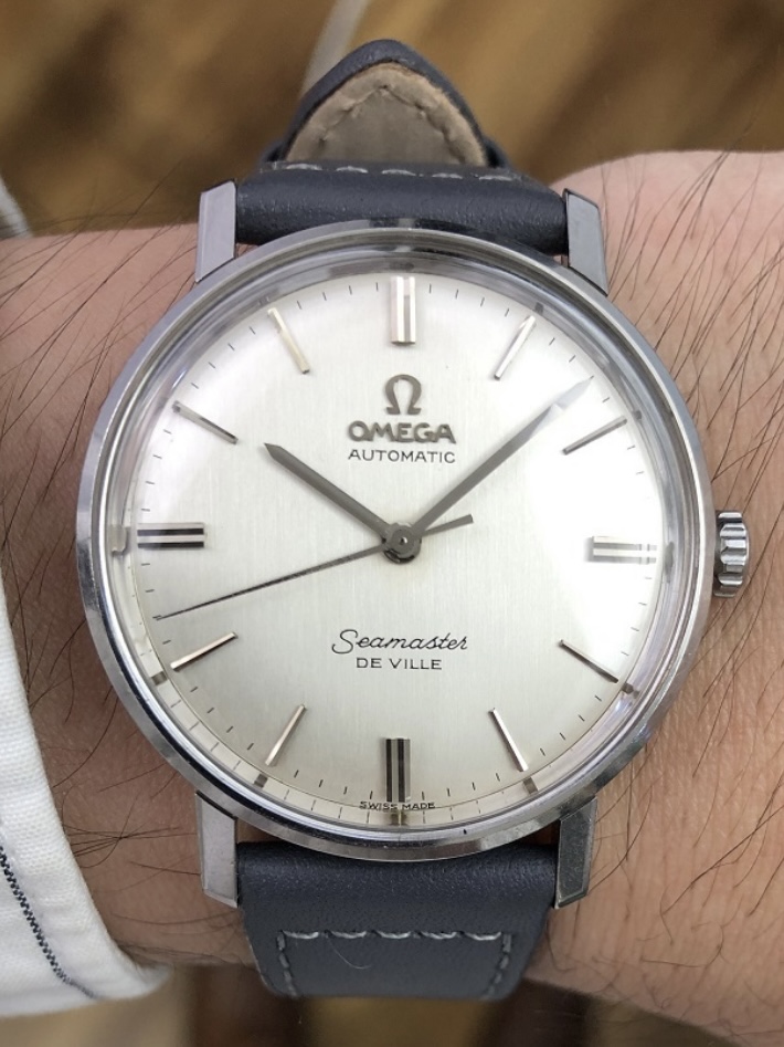

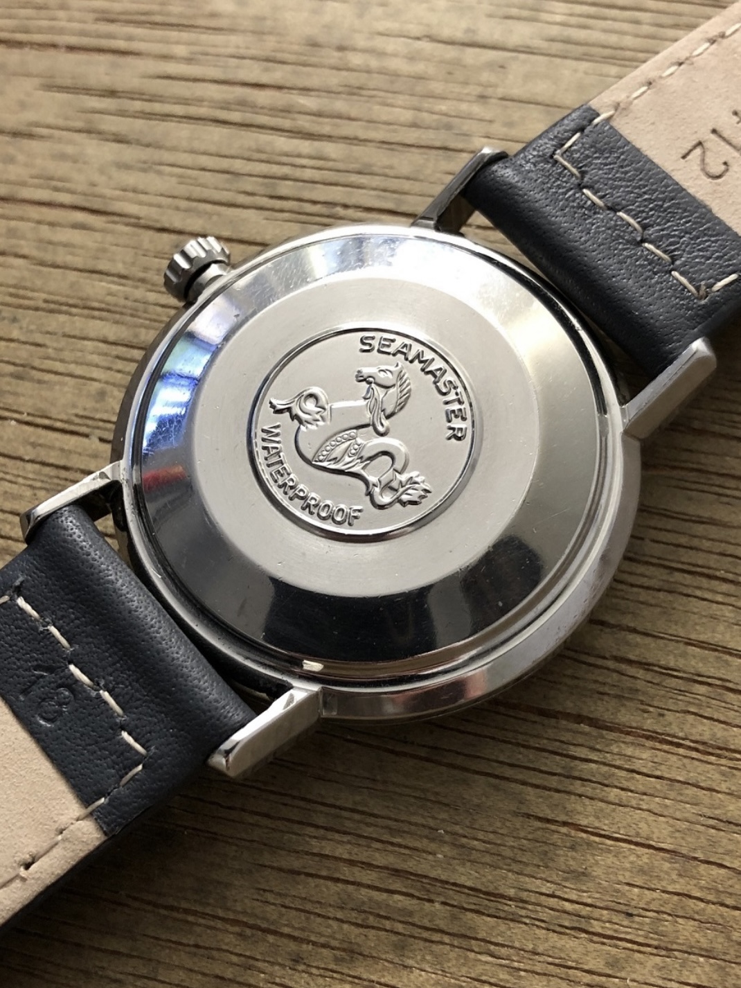

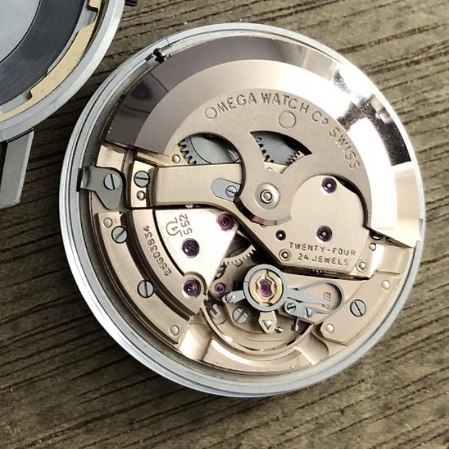

Thank you all so much for your feedback. I figured it was probably just different variants but wasn’t 100% sure. How does the rest of the watch look to you? Original Crown, polishing, movement etc
This is how the seller describes the watch:
Solid stainless steel original unpolished case. Silver tone factory original dial. The automatic wind movement is an Omega caliber 552 and has been professionally serviced.
Year: 1967
Model: Seamaster De Ville
Caliber: 552
Case model: 165.020
Case gasket: Does not take a gasket
Crystal: Acrylic crystal
Crown: Original signed crown
Dial: Factory original finish
Hand type: Index
