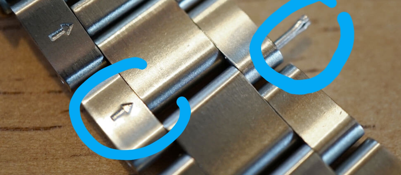

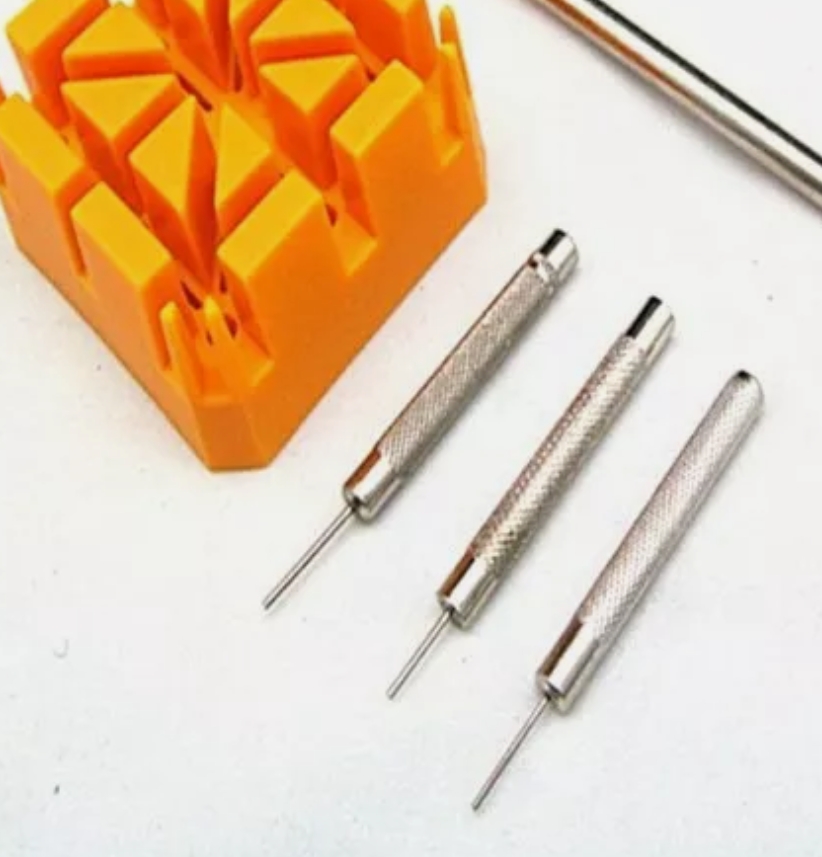

Hi, you listed the right solutions...
I use that to remove the links (cheap tool...) but you must care about the way to push out the axles: the pic is not a 1450 but it is the same.

Thanks! Good images. To re-attach the links to the other side, do I push them through the same direction, in the direction of the arrow?
No, the opposite. It will be obvious when you look at the pins.

I gave it a shot, and it's trickier than I thought. First, it actually made more sense on mine to push them opposite the arrows to remove them. I wonder if somebody put the pins in backwards at one point. Anyway, I see how they only go one way. Second, not all links/pins are removable. Third, the end links (half-links?) on each side can't be moved. On one side is the quick-release pin, on the other is the microadjust pin. Finally, I'm not too experienced at this, and worried I'll damage the pins or the bracelet.
This is like a puzzle. I'm thinking I can remove pins 1 and 2, and remove those two full links, then reconnect 1 and 2. Then remove the hidden pin at 3 (the one connecting the microadjust link to the rest of the bracelet). And finally connect the two links to pin 3 and the microadjust link.

It's normal that only a few links are removable, and the last link is fixed. Certainly possible that the pins were inserted backwards. Your plan makes sense.
