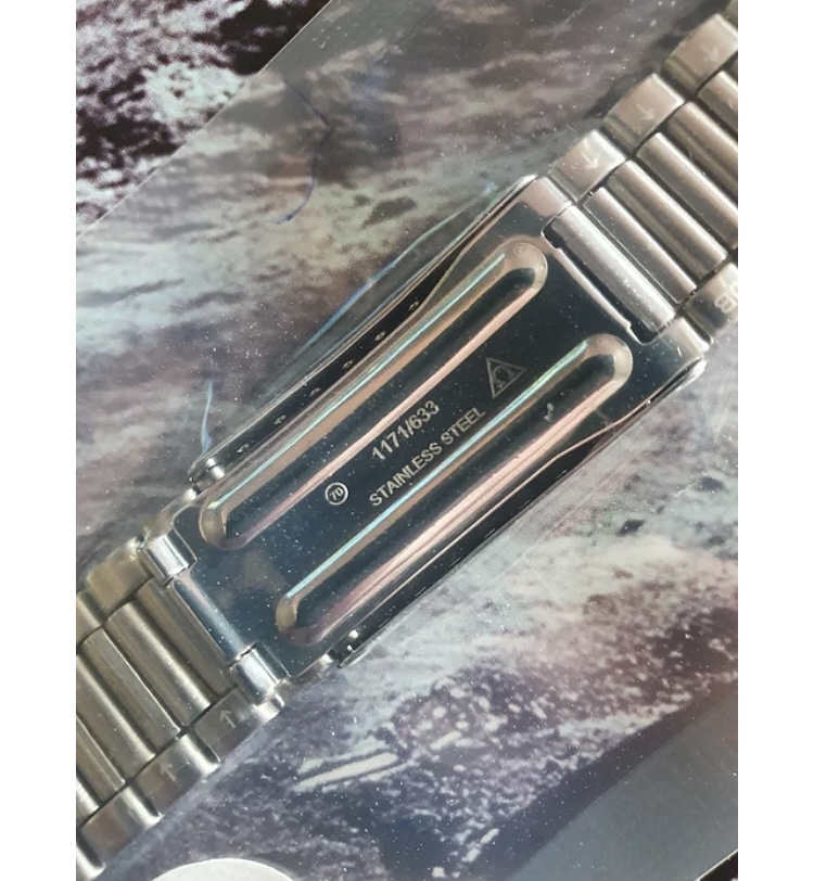

New Omega 1171 bracelet arrives this Thursday.

Sounds like an 1171 bracelet is incoming so that's taken care of.
Jeff, is that a new 1171/1 or a true NOS (or vintage) 1171 that you have on the way?
14
15
I believe it鈥檚 a NOS by the stamp. If it was the new one it would have the 1171/1 stamp....right?
I bought mine new from Ofrei in 2013 or so and it's marked 1171/633 and a 32 in a circle.

That 1171 just looks new(ish) to me. Not new, old (vintage) stock.
The 1171 started life with screwed links and trapezoid clasp logo, then went to the 1171/1 with pins around 1980 then back in name but not design to the 1171 sometime more recently. What you have there looks like the current 1171, the marks on the links look laser inscribed, that is a recent thing.

Is the logo square or trapezoidal?
It鈥檚 square. Looks like a new style bracelet.
