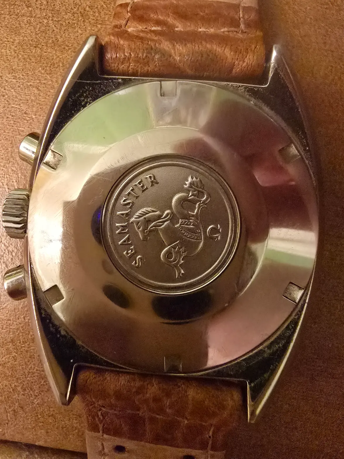

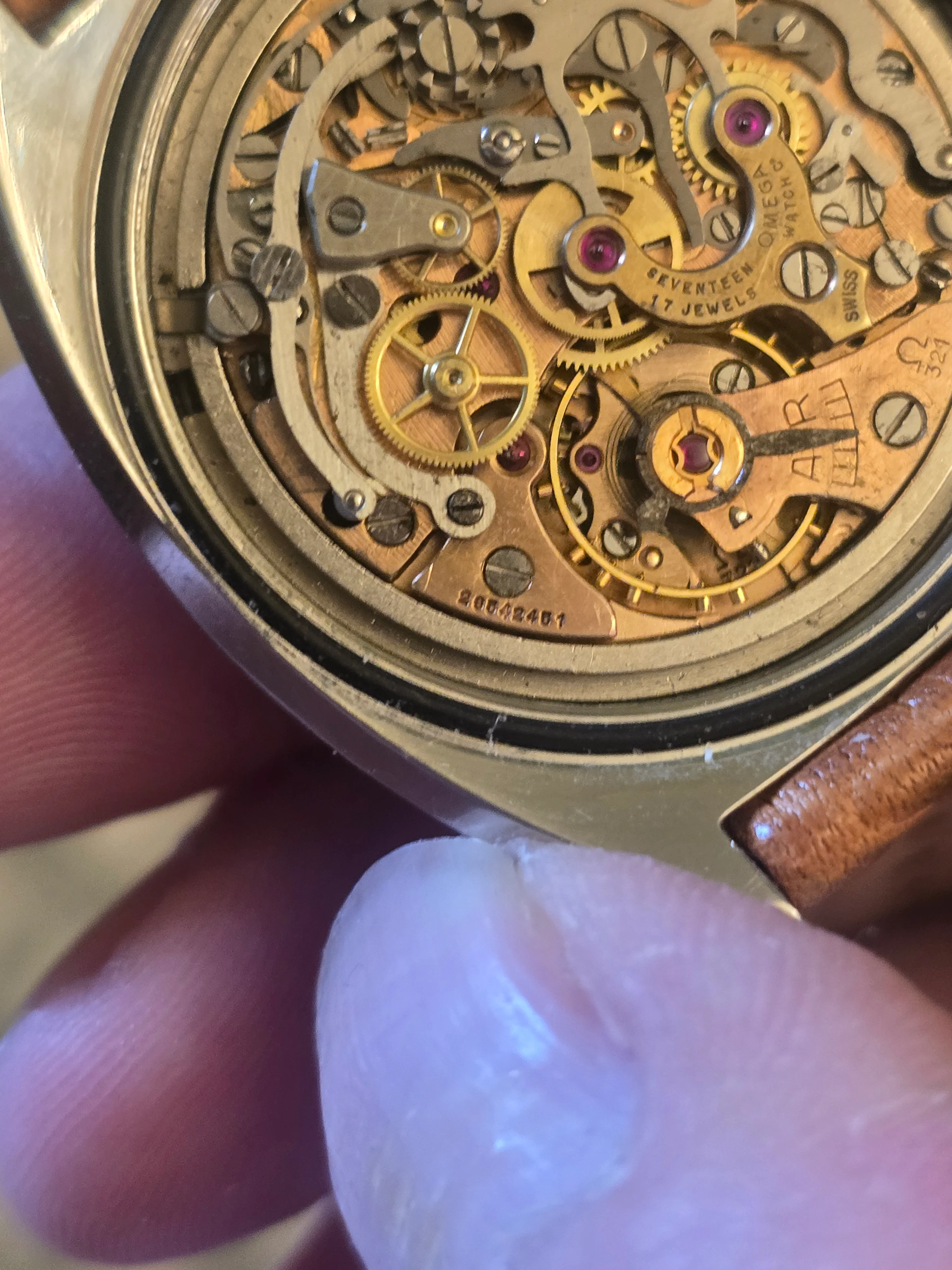

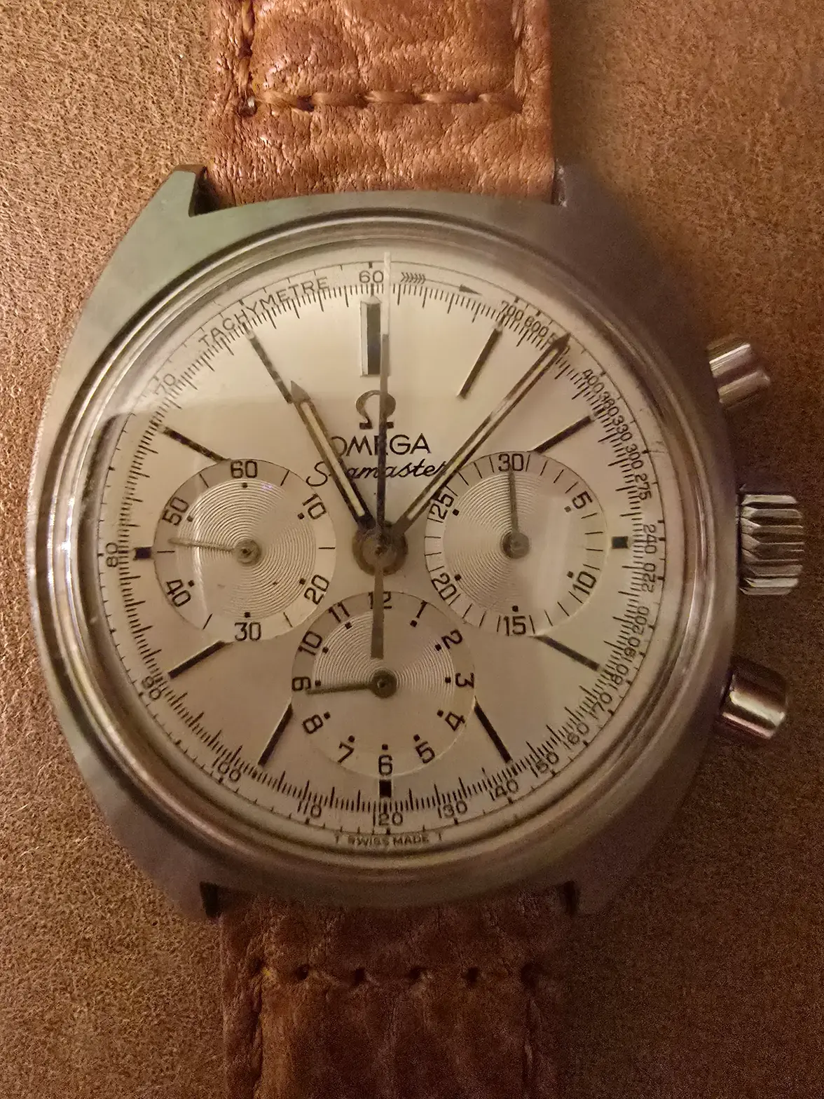

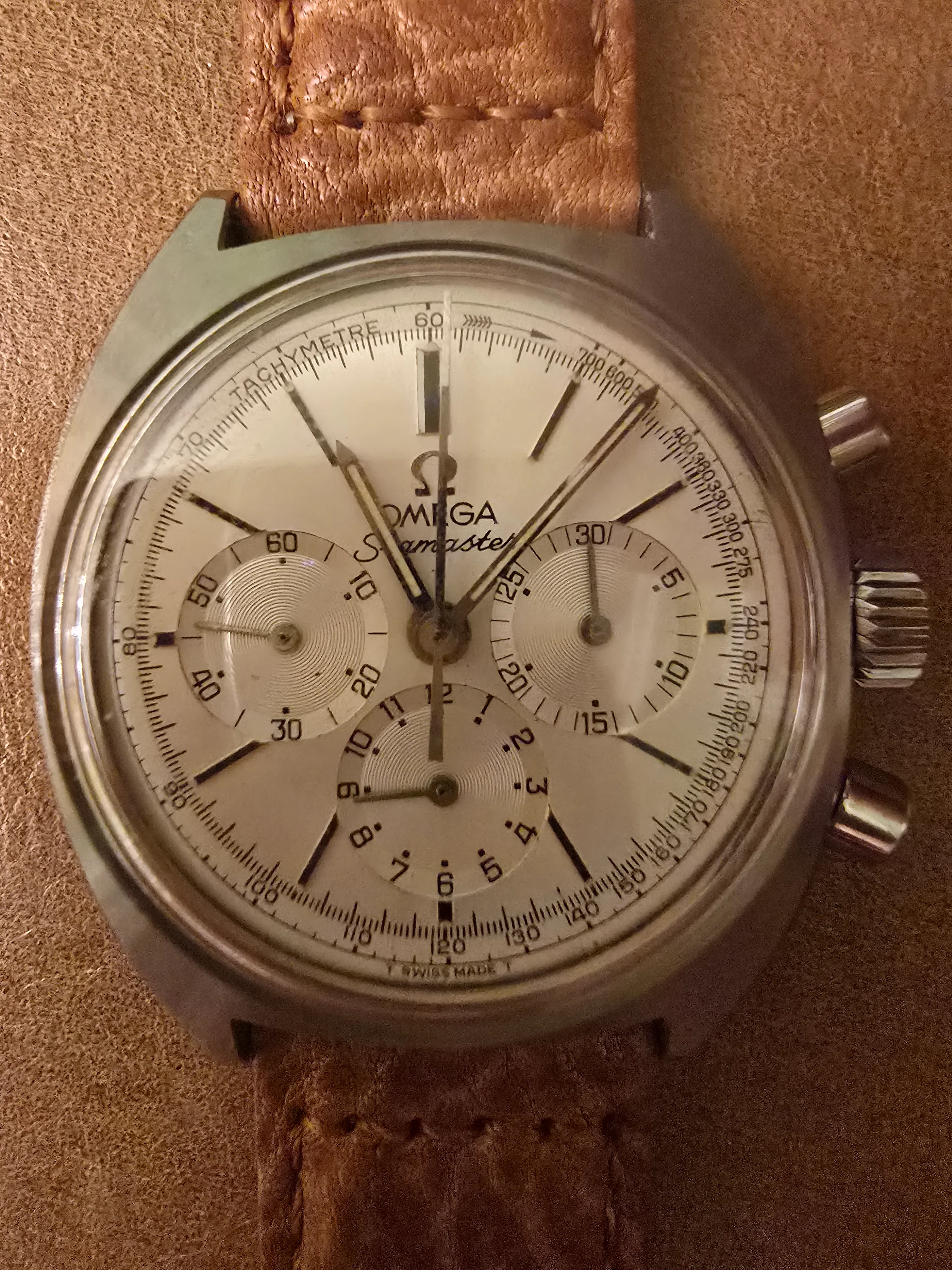

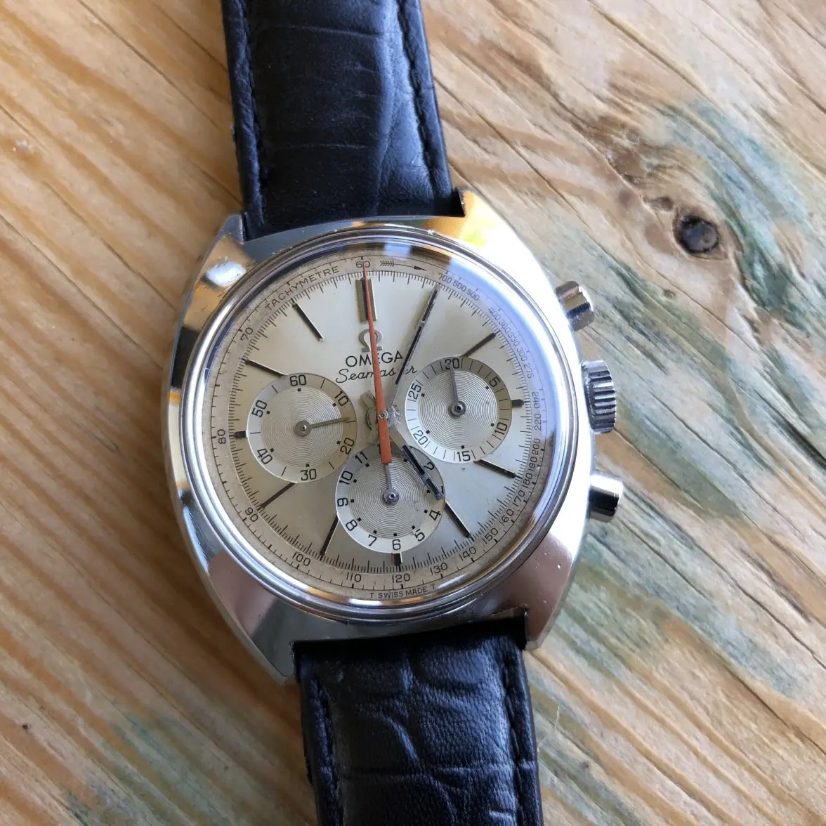

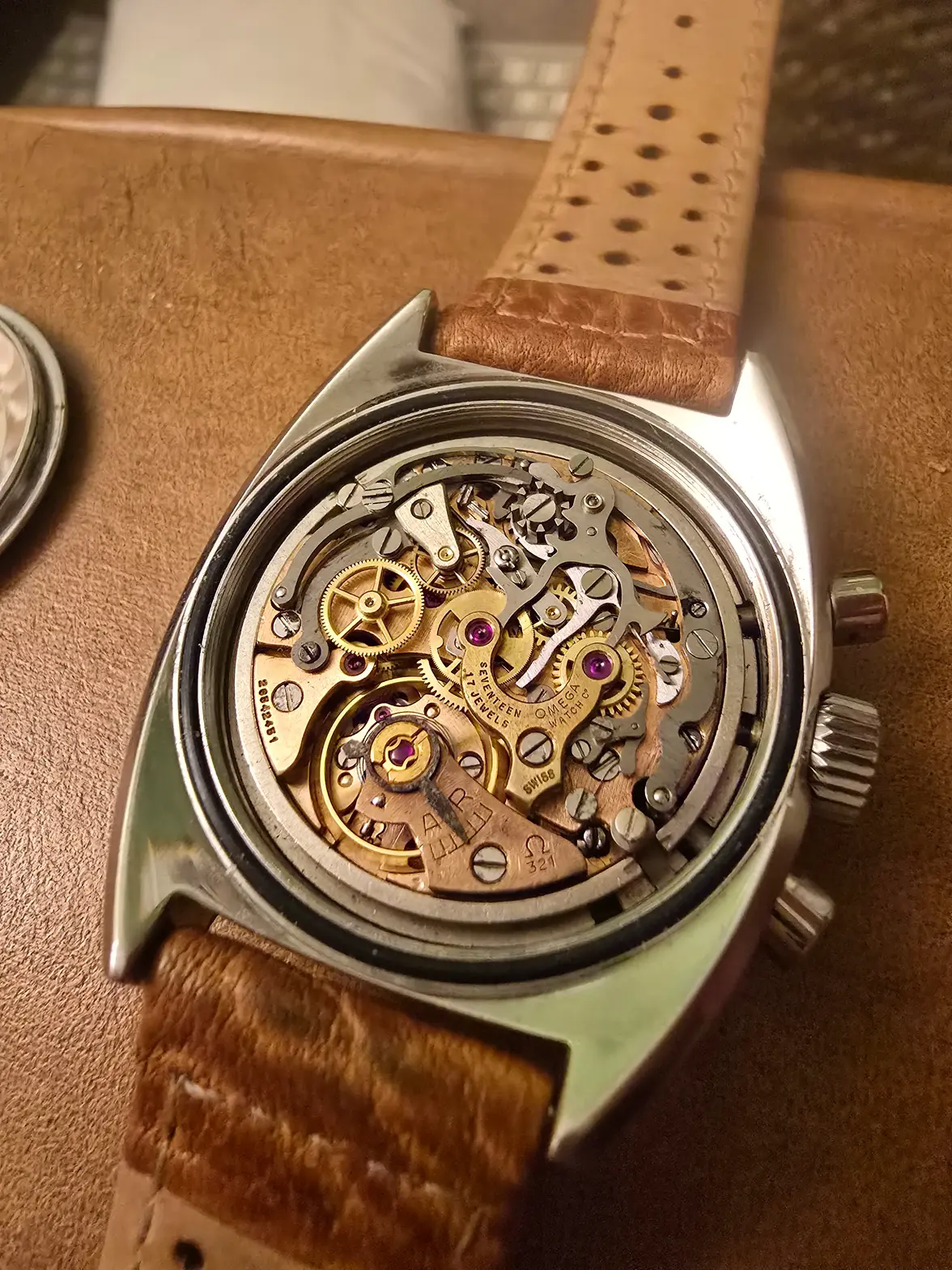

Posts 25 Likes 3 Cisitalia1976 ·Jul 9, 2026 I own this 145.016. I believe the hands are from the Moonwatch, as is the movement? Would like to track down correct hands and movement.

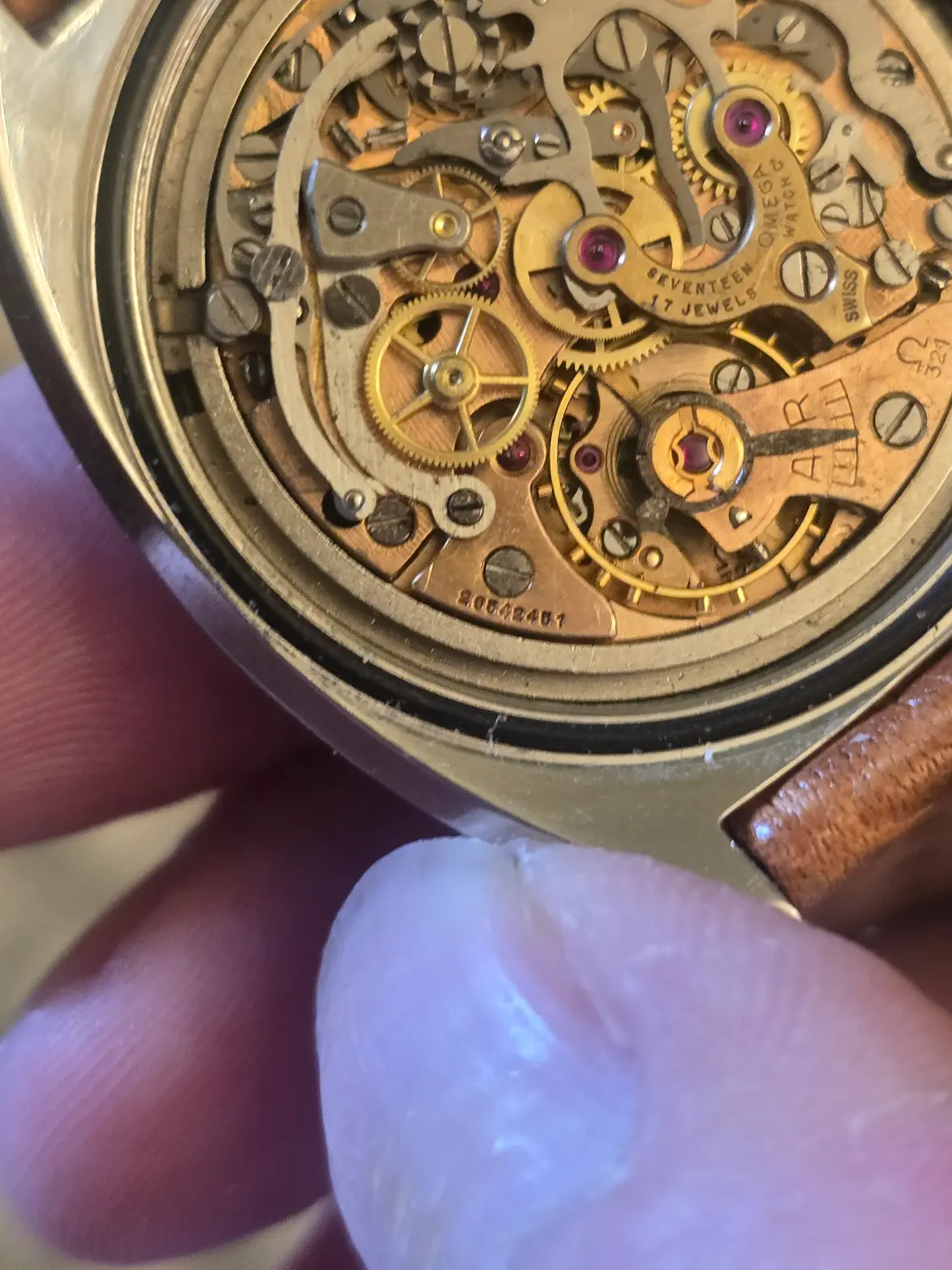

Posts 25 Likes 3 Cisitalia1976 ·Jul 9, 2026 The 321 movement was in other Omega's of course. I believe this watch should have the 816 movement.

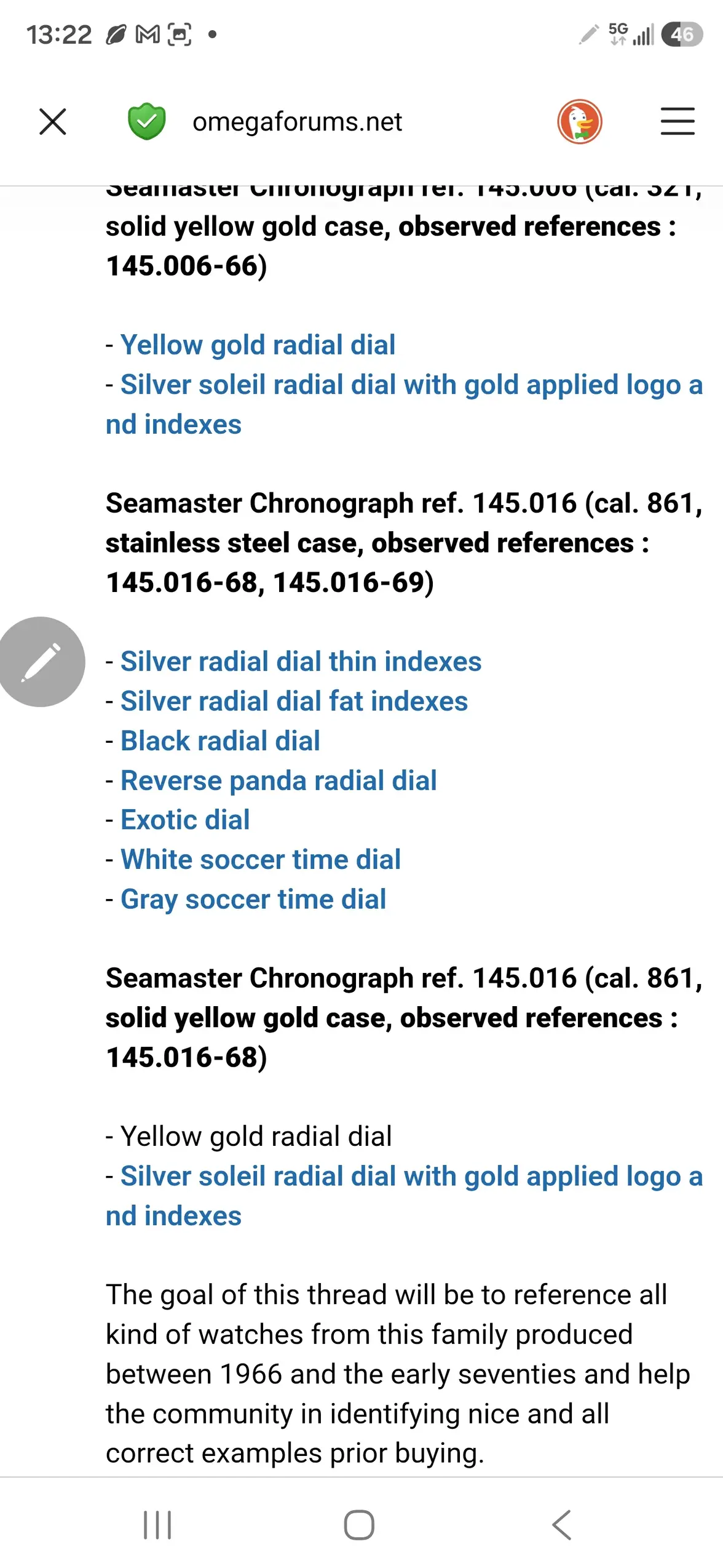

Posts 2,273 Likes 3,098 Passover ·Jul 10, 2026 Hi Cistalia! Basic reading for you is here: https://omegaforums.net/threads/145-006-145-016-seamaster-chronograph-research-thread.77145/ Thread '145.006 / 145.016 Seamaster Chronograph Research Thread' · As some of you already know, I have been digging into Seamaster chronos lately and literally fell in love with them. I have got some more than that - enough to start a research -... kov · Jun 4, 2018 Another possiblity could be a swaped caseback, maybe you have an original 145.006??? Can't read the serial number of the of the 321 movement, would you mind sharing it? Correct hands lool like that: Thanks @kov

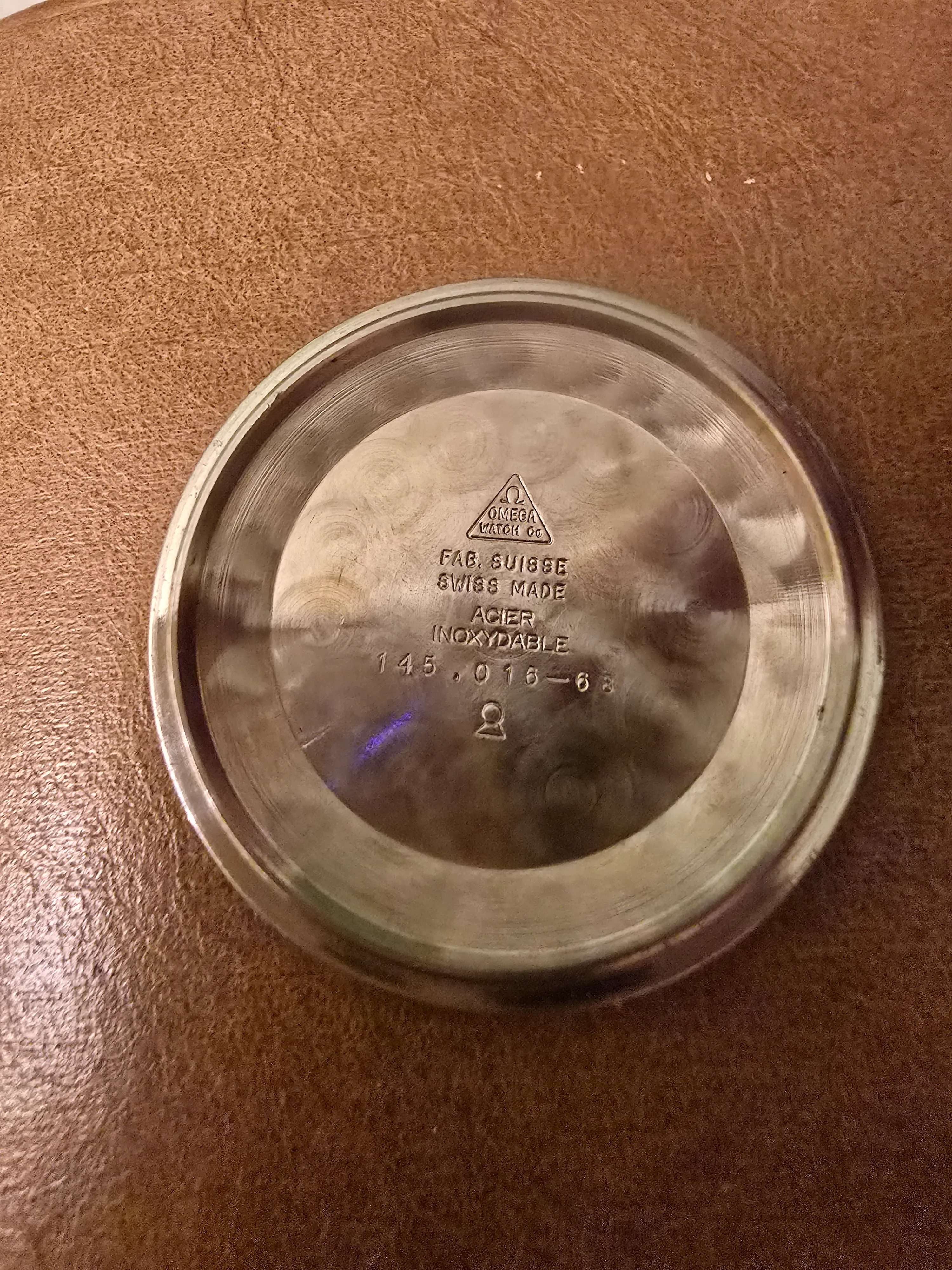

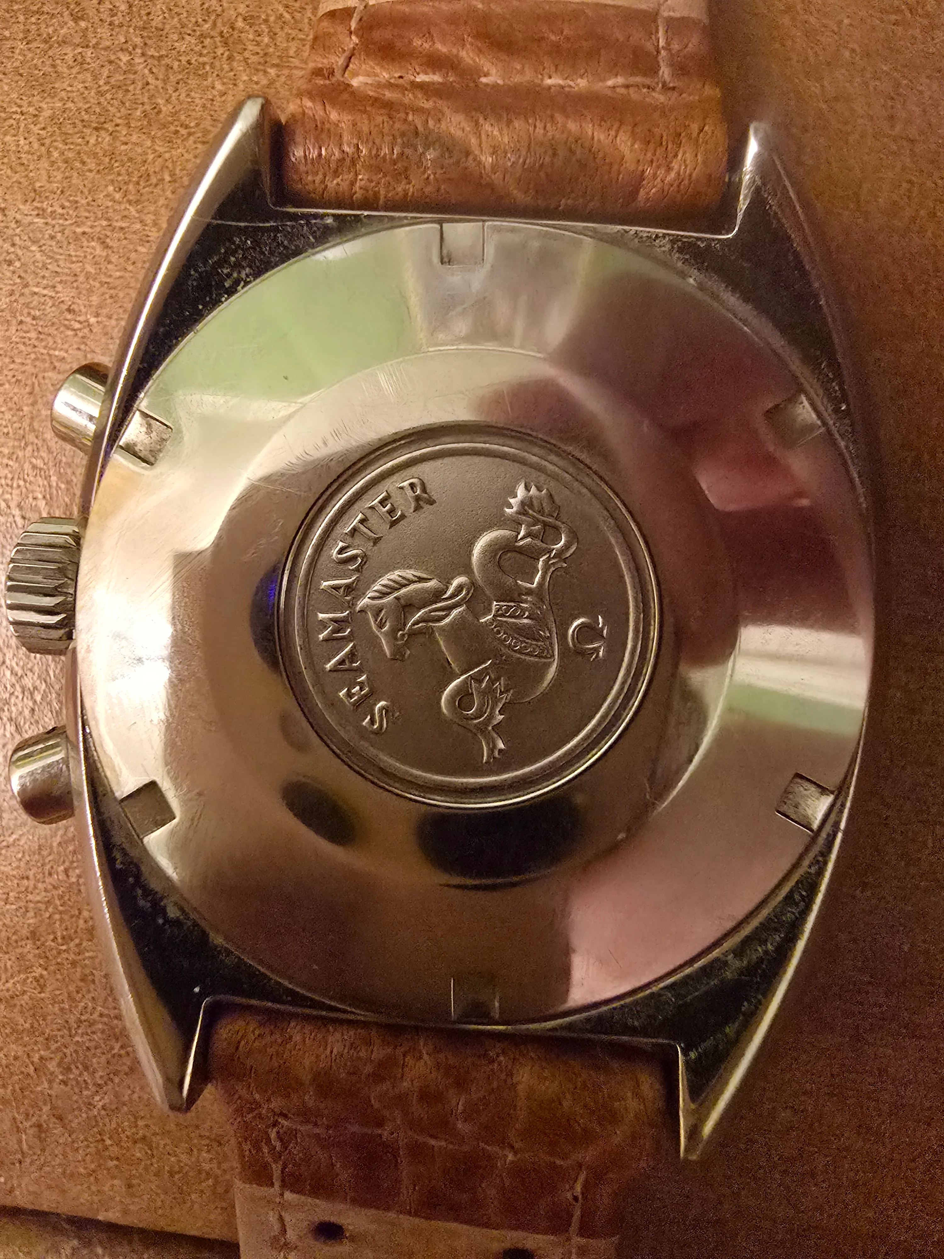

Posts 25 Likes 3 Cisitalia1976 ·Jul 10, 2026 Could be a 145.006 with swapped case back and different hands. Or a 145.016 with wrong movement (321) and wrong hands.

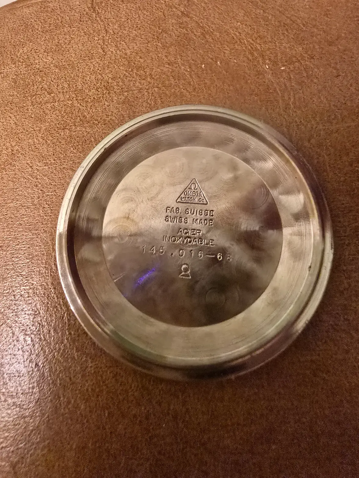

Posts 25 Likes 3 Cisitalia1976 ·Jul 10, 2026 If the cashback is correct (145.016-68) it should have the 861 movement and hands like the photo you sent. As the dial, case and movement are in nice condition it would be good to return it to original specs.

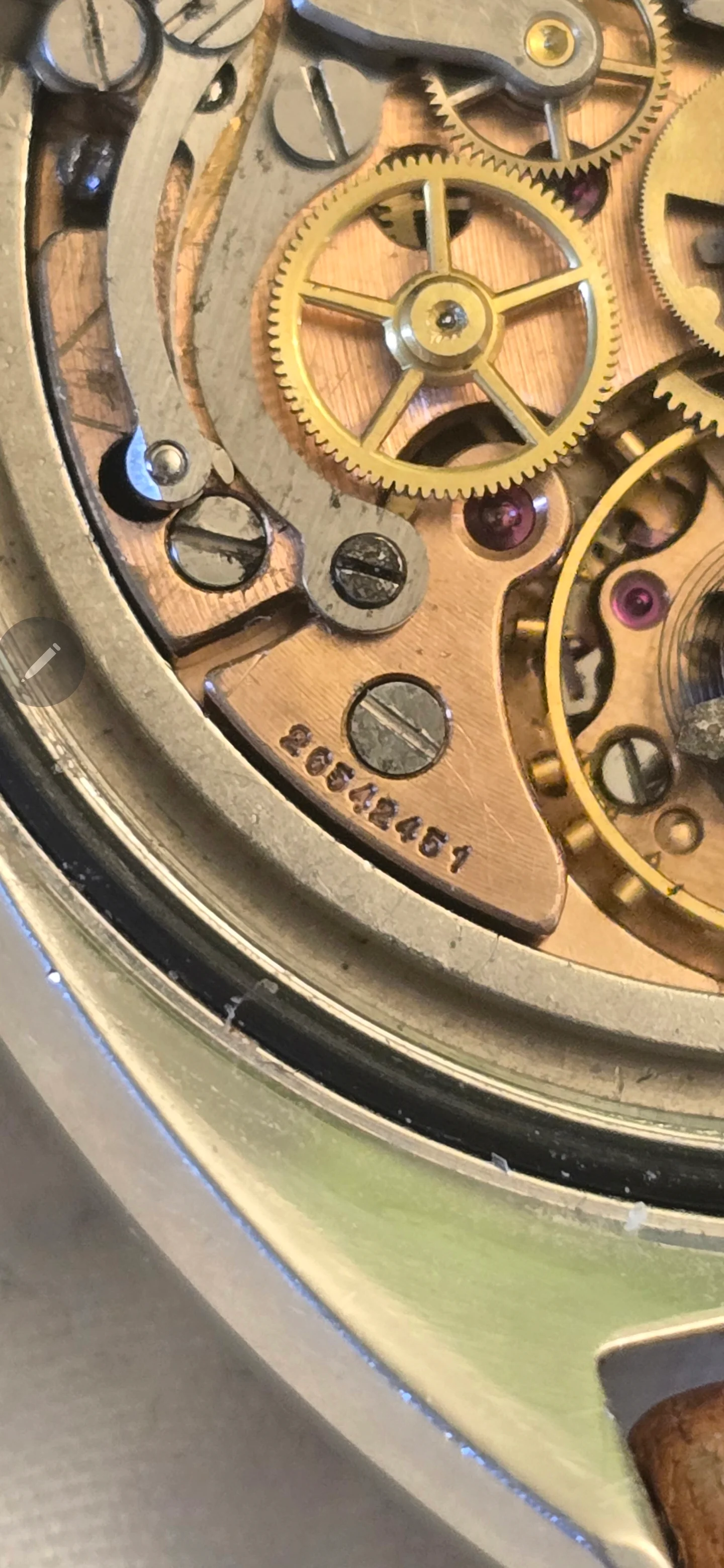

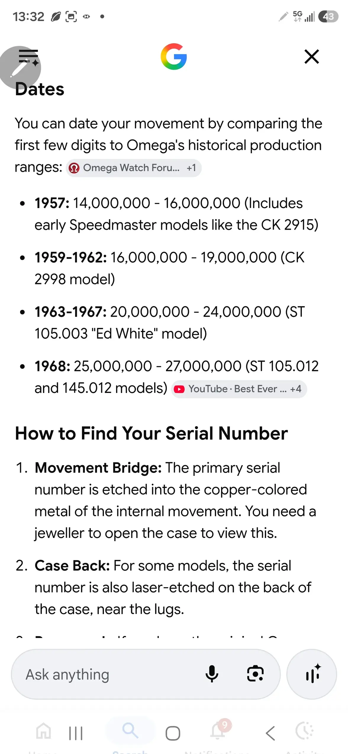

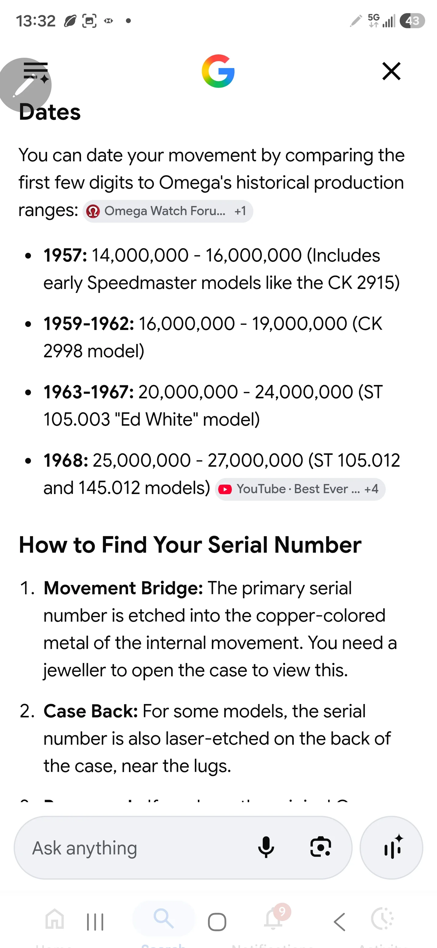

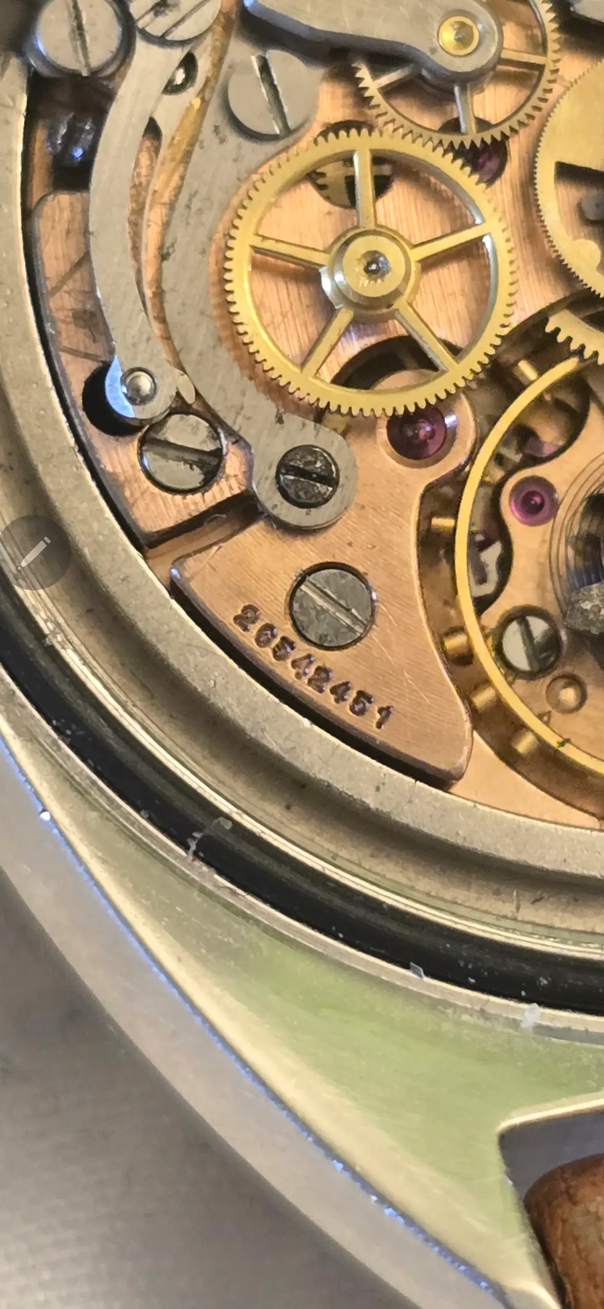

Posts 25 Likes 3 Cisitalia1976 ·Jul 10, 2026 Serial 26542451 according to what is written here was used in: ST 105.102 & 145.012 models. 1968 Serials: 25.000.000 to 27.000.000
