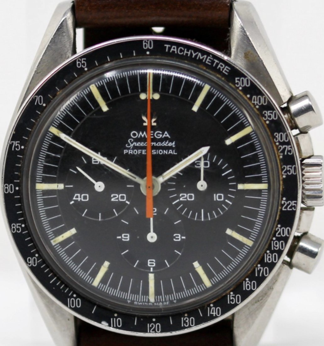

What do you guys think about this one? It’s in the serial range, but the one photo doesn’t show very well the length of the Chrono hand.
Chrono hand isn’t long enough if my opinion. No extract.

Did anyone on here end up picking up the 145-012-67 with orange chrono hand? Went for 14k plus 30%.

With that apparently shorter orange hand, tough call…And is it the picture or did someone played with a grinder and the caseback.
Seems expensive…

And is it the picture or did someone played with a grinder and the caseback. Seems expensive…
Looks like it had a lengthy encounter with a polishing wheel years back and had been worn rough since. Agreed though, pretty high result. Especially with 30% hammer premium.

That watch on Invaluable was interesting. The serial number was not only in range, it was within the last digit of one of the “verified” serial number numbers from MWO - which I suppose doesn’t necessarily mean anything. I had expected a flurry of bids on it as someone would be willing to take a chance. That said, $14k at the hammer - $18,200 with the premium - was a bit more than I would’ve expected.

The auction watch is close, very close, but while I think it is overall an original watch except I think the hand could have been added to it.
Things I like about the auction watch is that it looks owned, and has an original crown. The patina or decay looks commensurate, BUT the hand doesn't look quite right. If it is a fraudulent seller, (surely not in Miami) then he has taken an original watch in the right serial and added a Vietnamese hand and thrown it into an anonymous auction.
We can go off into the weeds about UM hands, but if it looks correct and has an extract, I accept it. From experience, the hand should be slightly red, and reach the outer edge of the minute track. Any deviation from this means it is probably not original (the auction example is short). Then we have to consider, is a perfect reproduction acceptable? If I cannot tell the difference, then yes. If perfect reproductions are available, (and I see no reason why they are not) then we look to the serial, and take a view on future values.
With the possibility of the hand being repro, the price has to fall, as there will be many more examples offered - until the museum returns with an extract service that will confirm an orange hand - if they ever do.
That said, experienced collectors will look at a potential UM and get a feeling whether it is right or wrong. When you have two of those collectors in an auction, that's when sparks fly.

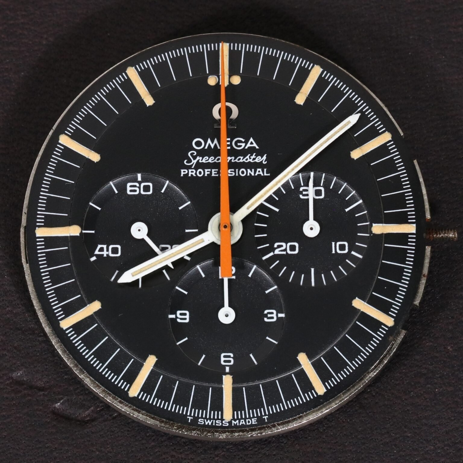

Here is an example of one I bought last summer. The seller was a storage unit salvage picker, and he found it in an abandoned unit. We spoke over a long period, and it transpired he did this for fun, and gave all the proceeds to a local children's charity. The unit this watch came from was full of the usual junk, and he said that in this hobby of his, he had learned to be ruthless. In my discussions with him, he let slip that he might have thrown away the box, papers and bracelet, not realising the value of them. He was used to selling children's toys and old furniture.
Here is the watch, de cased. I think its one of the best.
(the unit was untouched for at least two decades).

Surely the extract with the auction watch while supporting the Meister dial is more suggestive that it isn’t a UM since it mentions nothing about the hand or special equipment.
