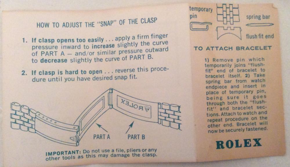

Nice document, @Davidt, but the OP is asking about an Omega bracelet. 😉
Bah, I always get those two mixed up!

If your bracelet have a tab or tabs take a plier an bend it or them carefully outwards (relative to the curve of the tab(s) in slight increments until you are satified with the function of the clasp.
