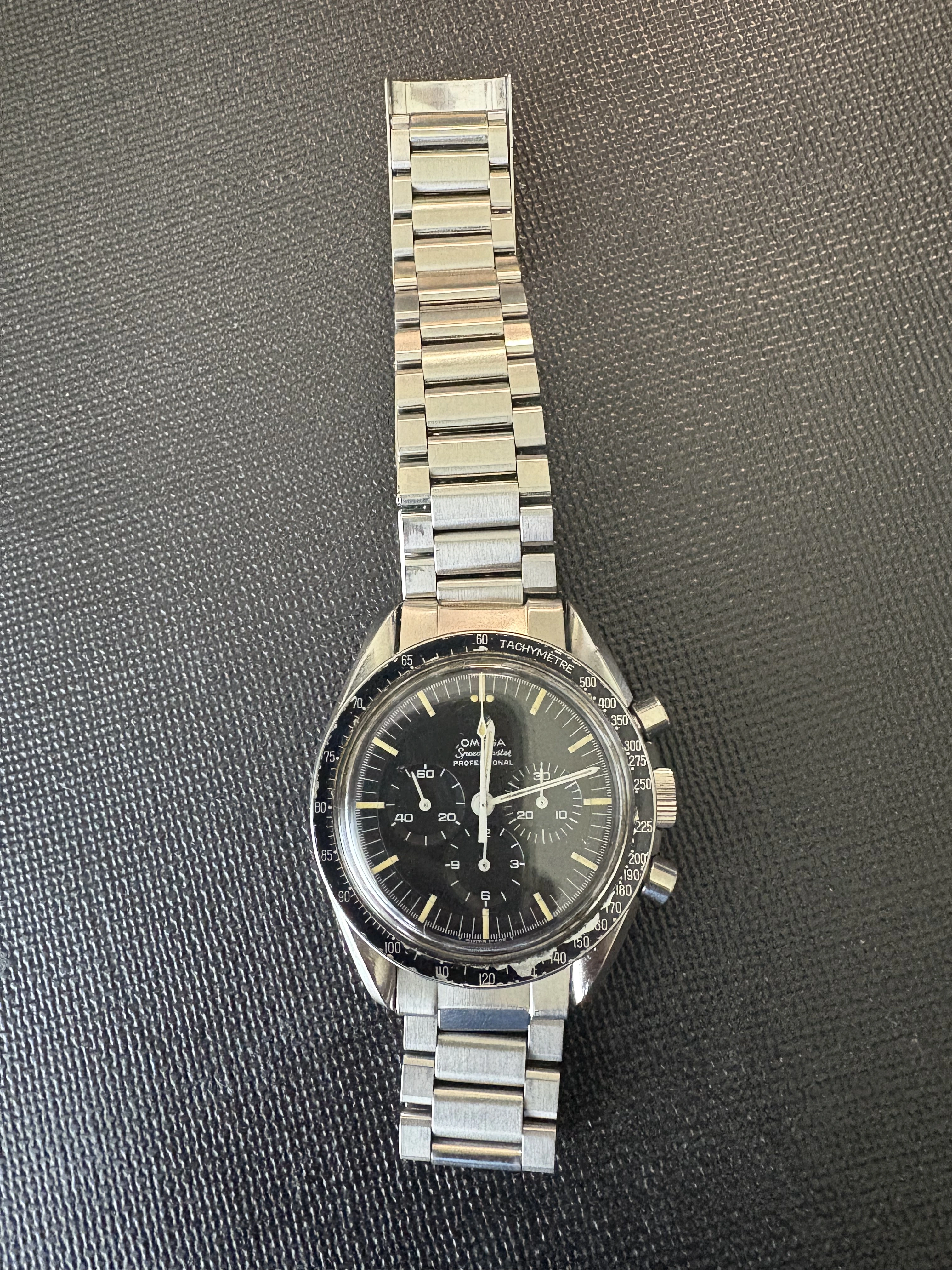

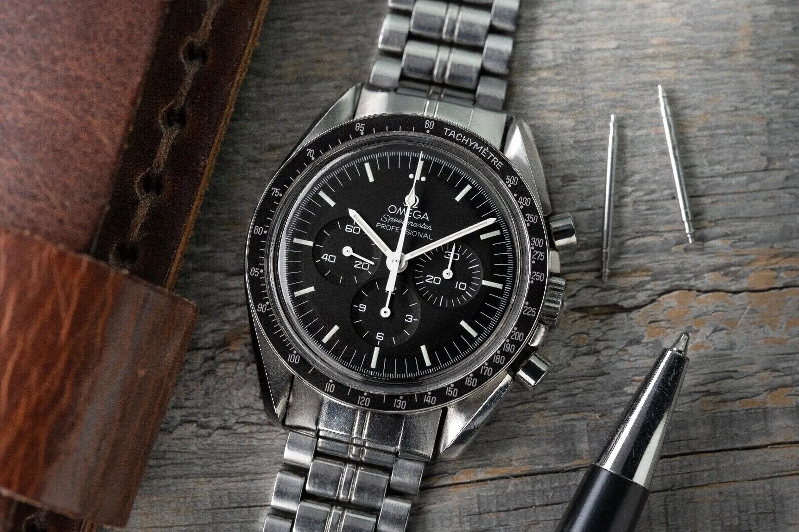

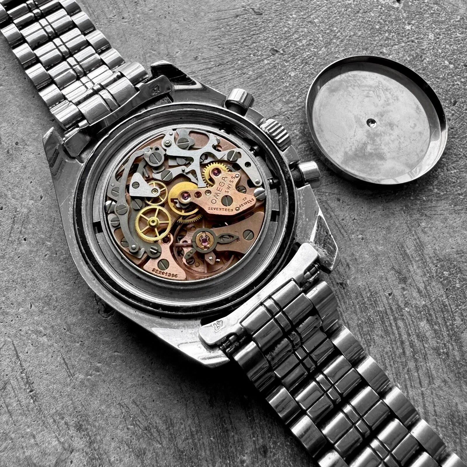

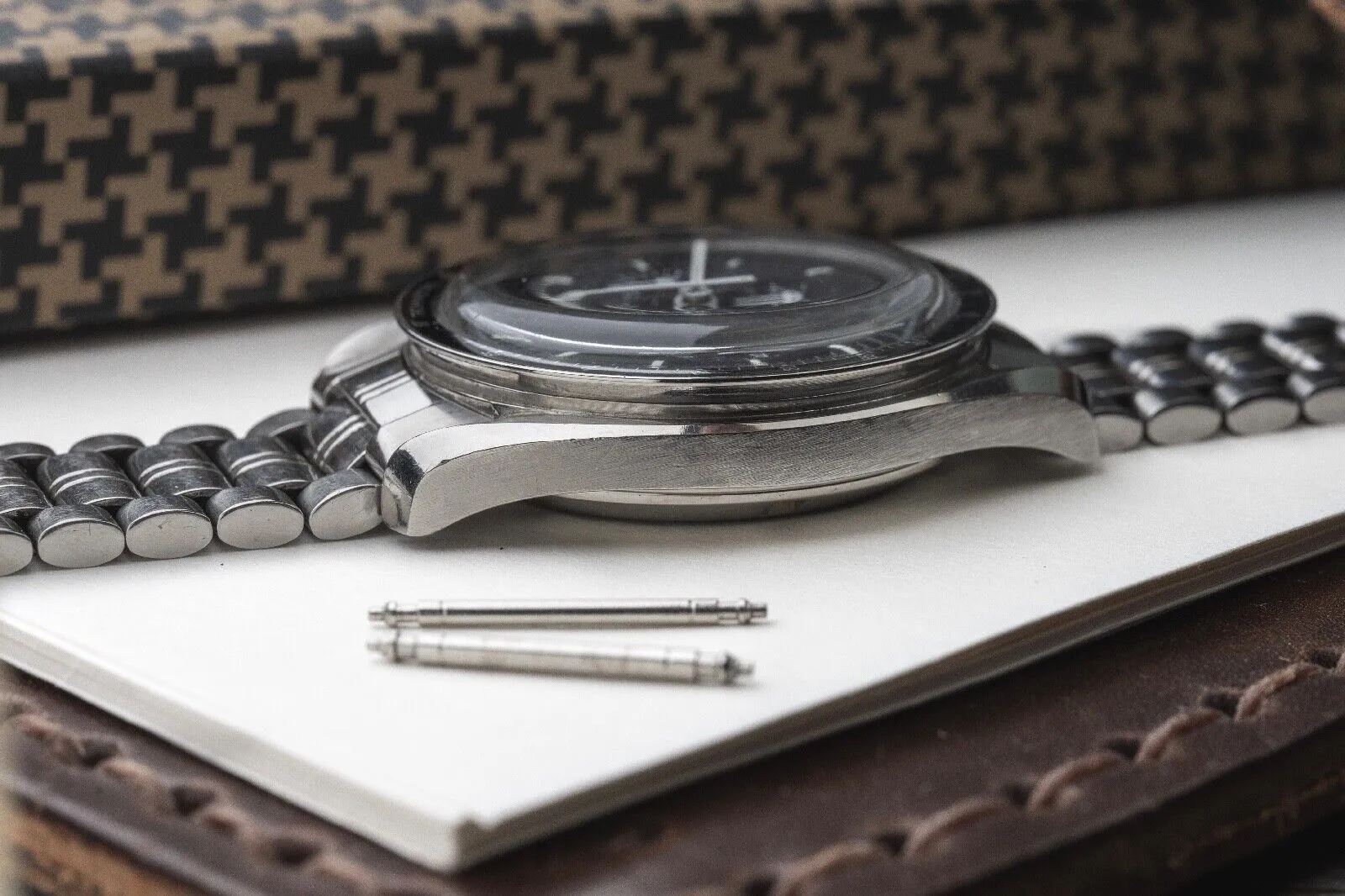

I was looking at some watches on eBay and came across a 1069 bracelet with 20mm 47 endlinks installed on a Speedy. The watch is a franken, but I've seen the bracelet before and wanted to see if anybody else has, or if others had more info. Usually, 47 endlinks are seen with 1175 bracelets (american market?). However, these endlinks were clearly made to match the 1069 as they have the same link design running down the center.
I saw a set here on the forum: https://omegaforums.net/threads/omega-47-endlinks-20mm.125407/ . However, I've never seen them discussed anywhere. Does anybody know if these bracelet were orignally meant to be a speedmaster accessory? If so, any guesses when?

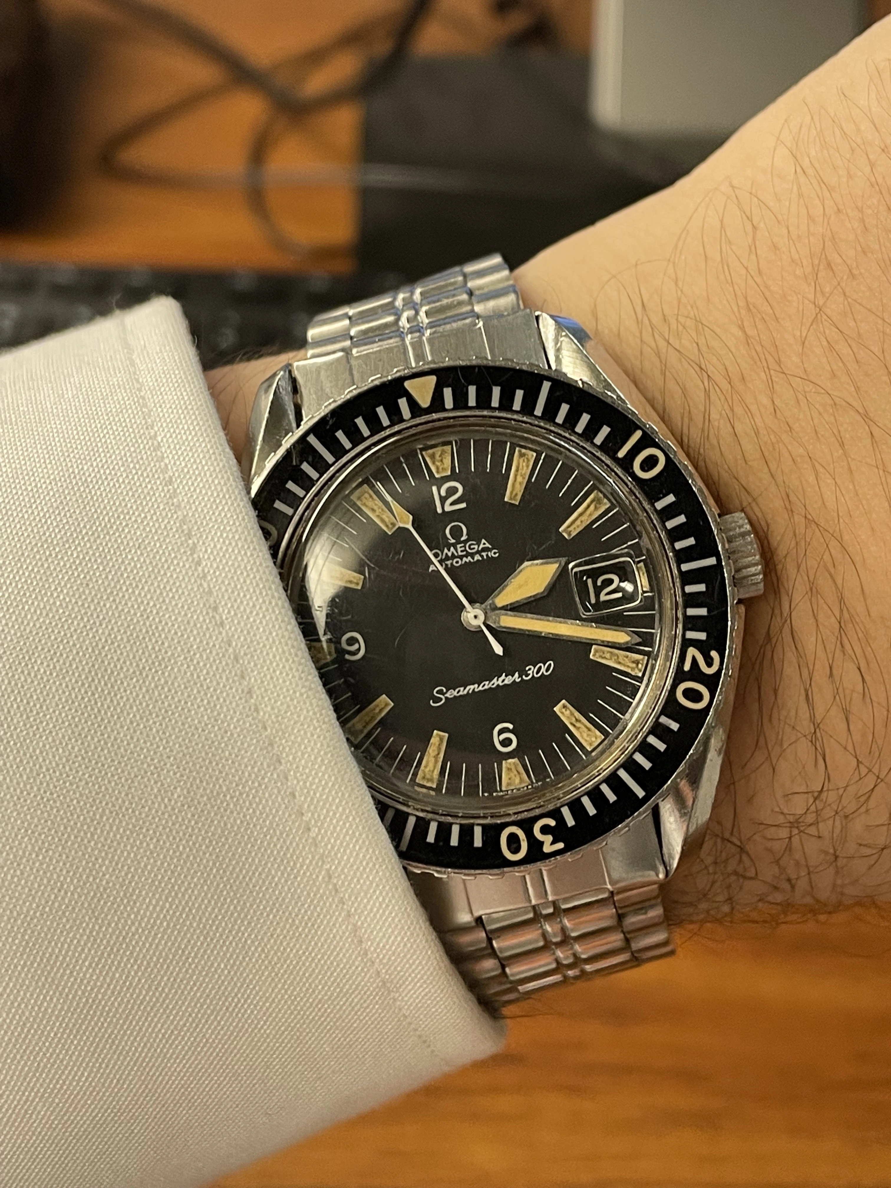

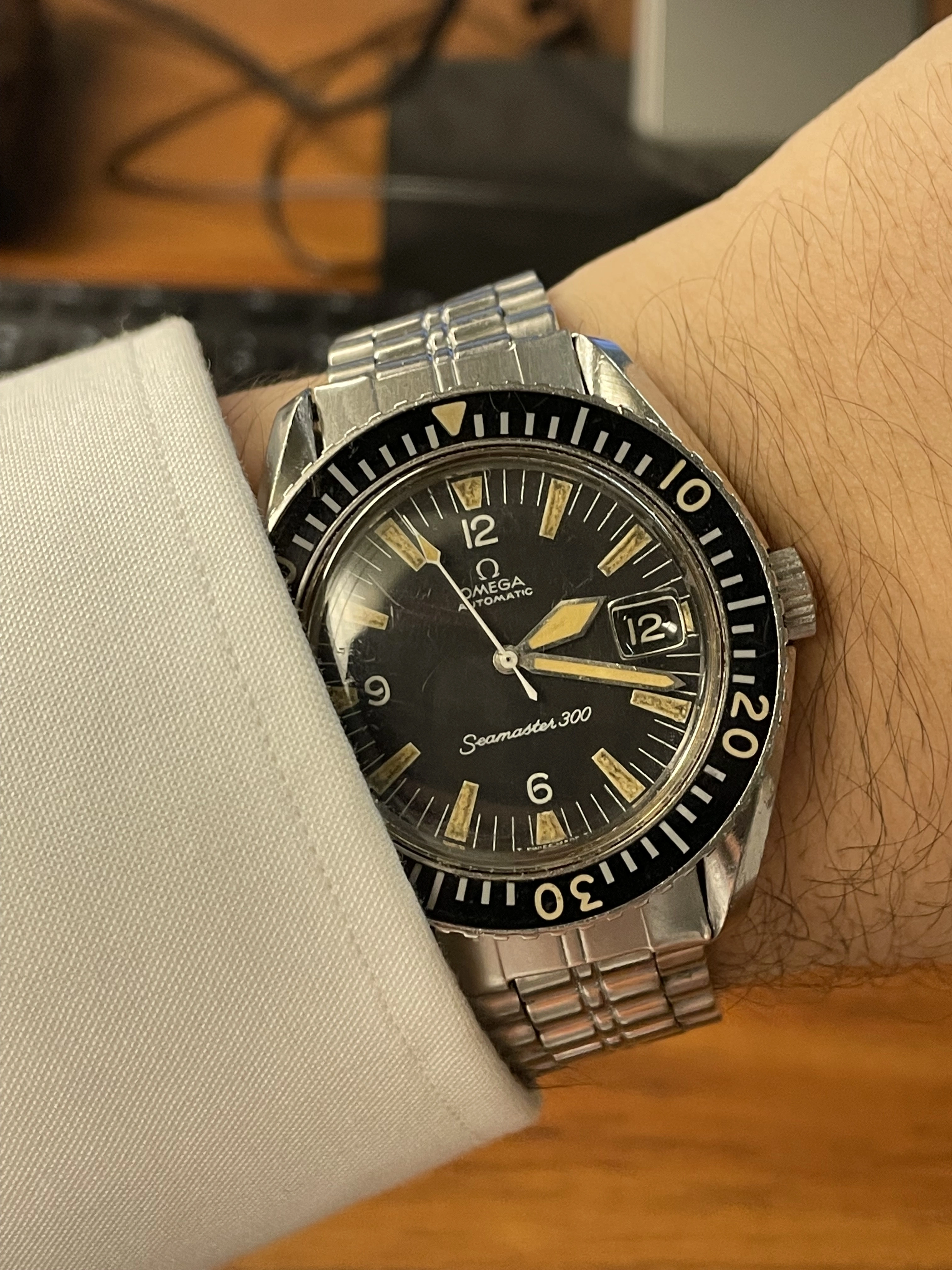

I bought a stray 1069 on ebay a few years ago that ended up coming with a set of similar 47 endlinks. I was never able to find much on it, but it fit my SM300 well:

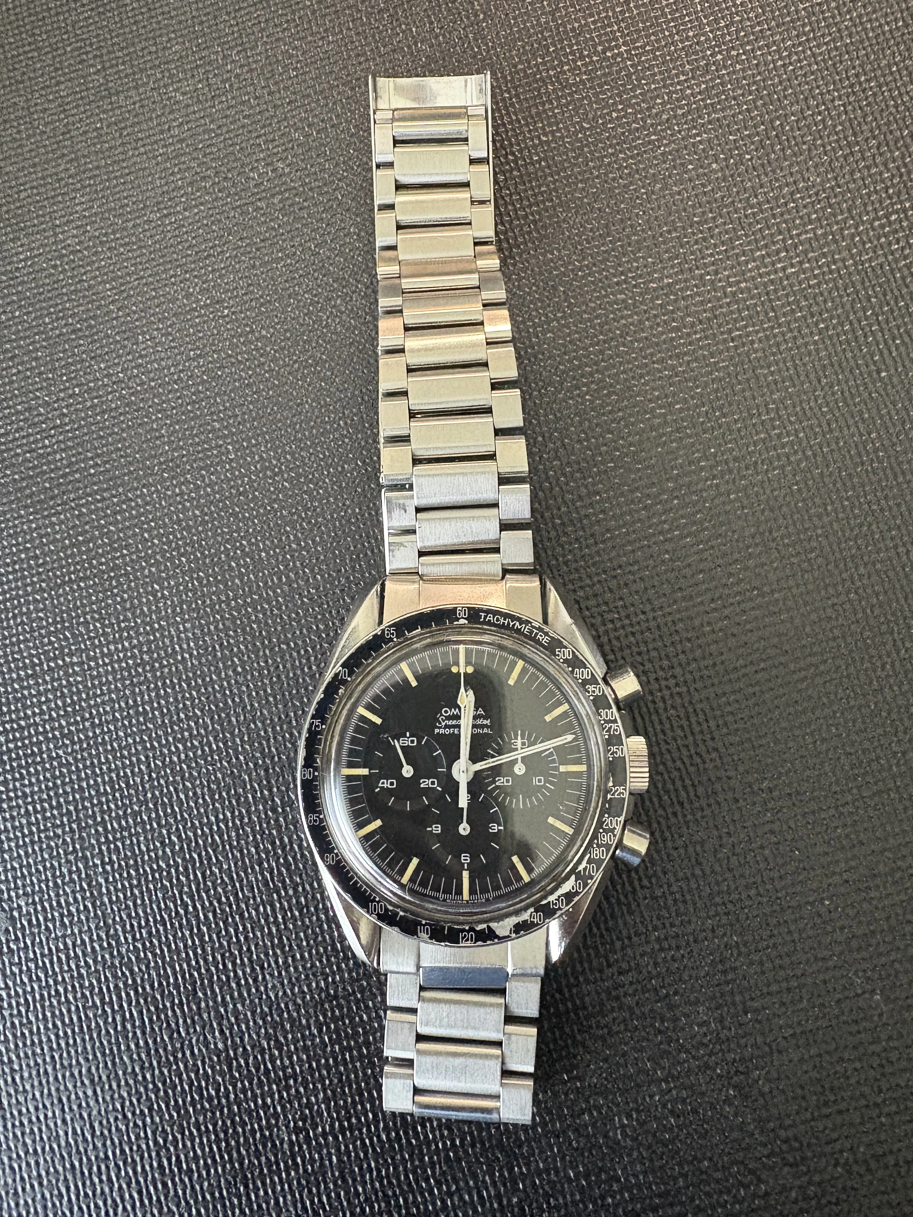

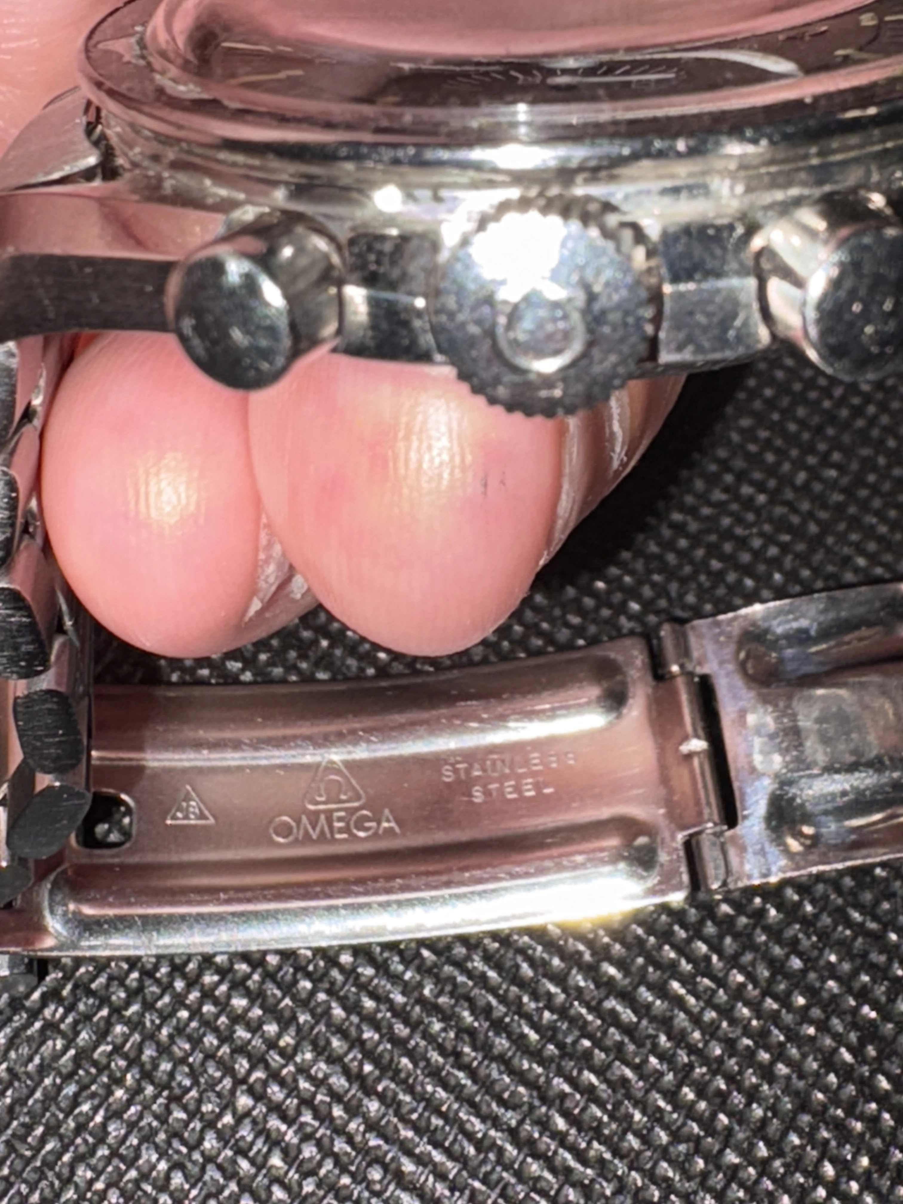

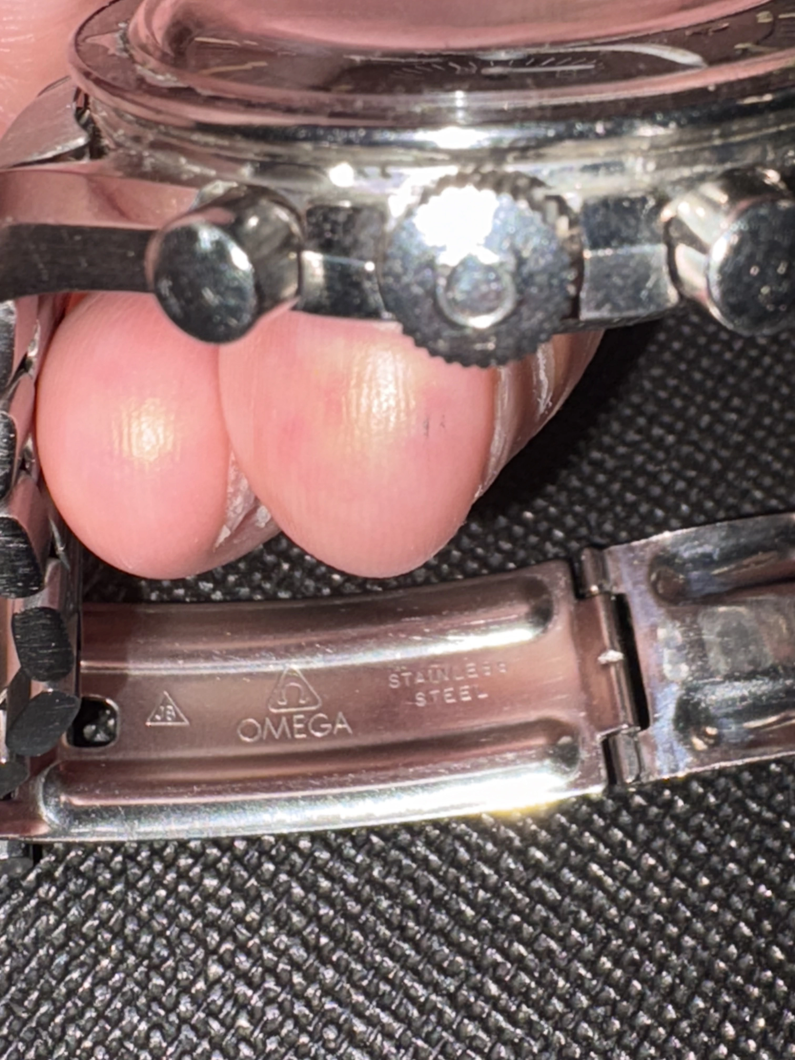

I came by this one with #47 end links on another Speedmaster not pictured. It looks like a 1039. From my research, JB didn't stamp the reference numbers on the ones that were attached in the US for retail sale. They appear to be rare, likewise the bracelet.
