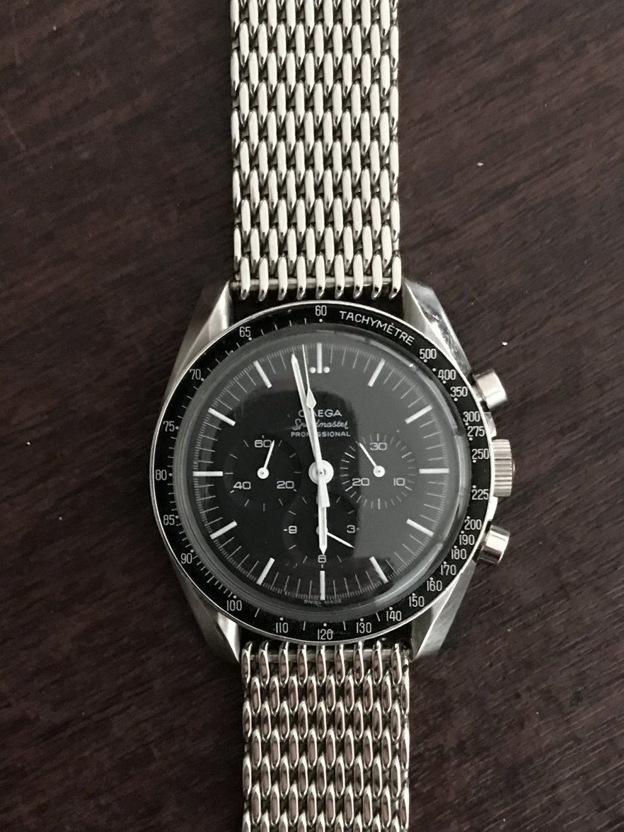

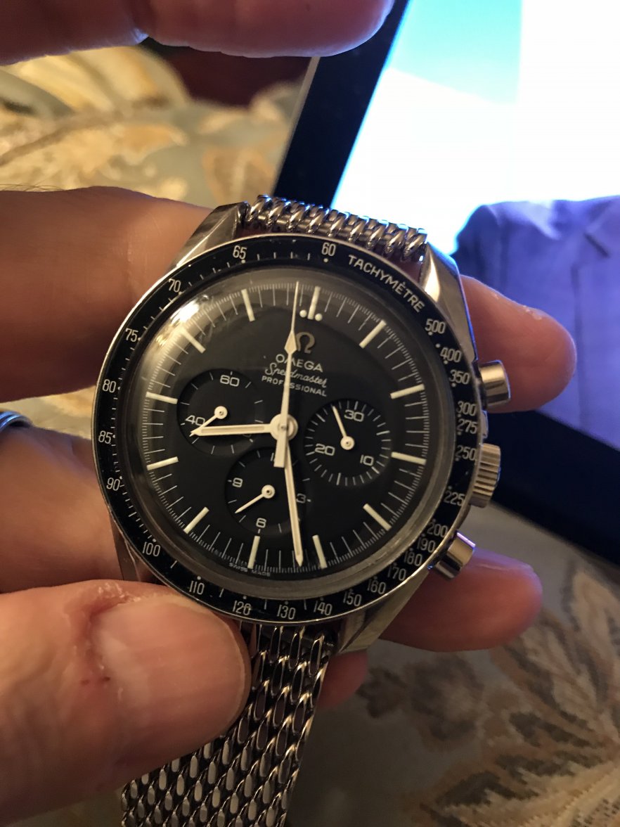

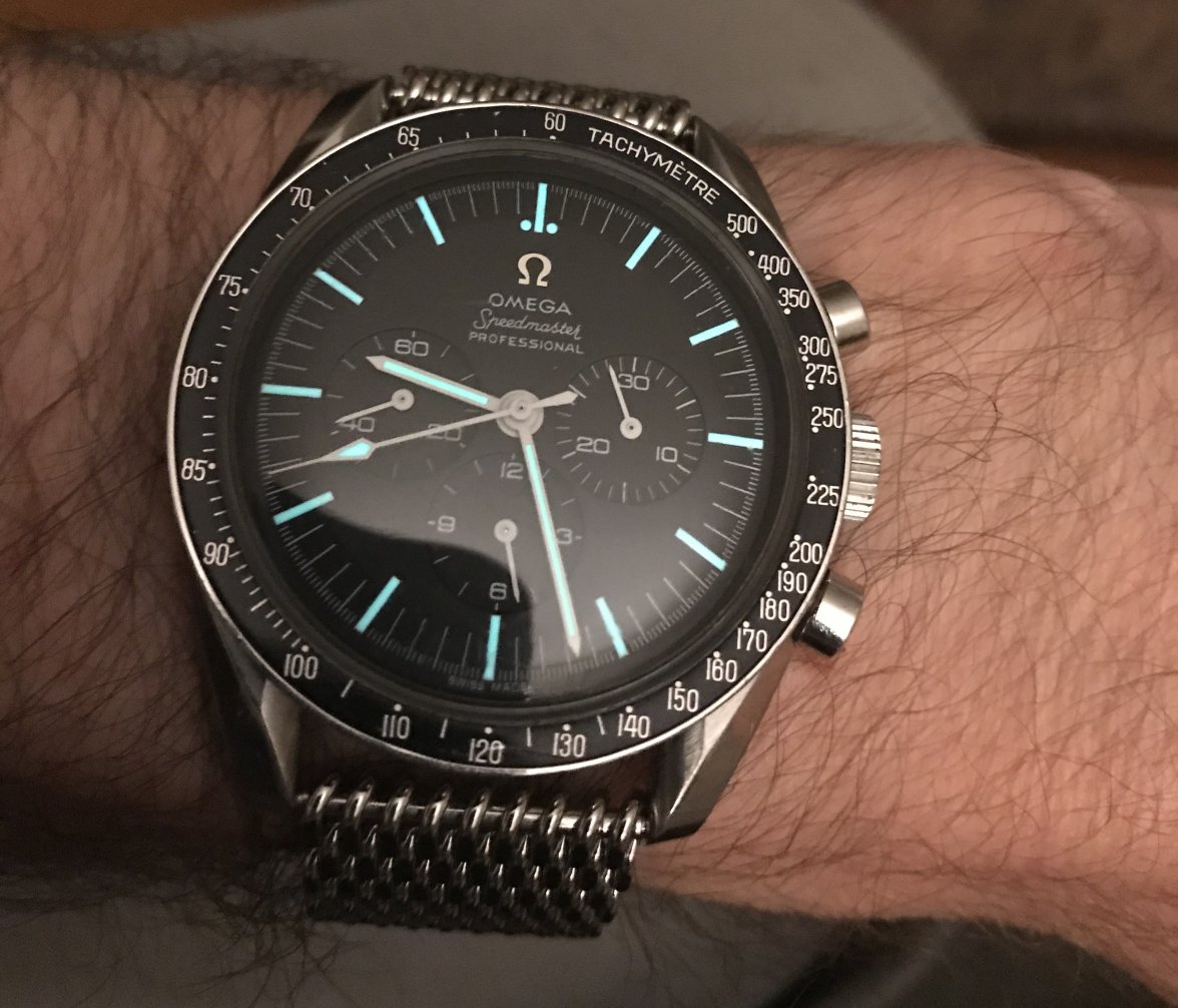

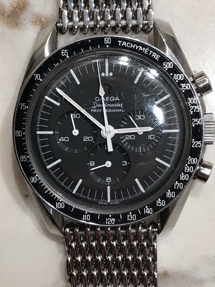

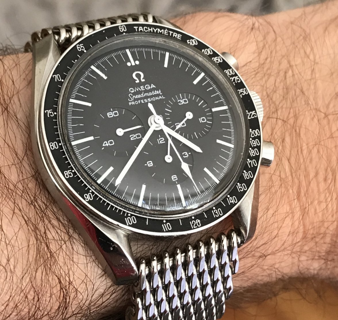

    It just occurred for the third time in a week. I’ve taken photos each of the three times, which is how I figured it out.
    This morning:
    Three days ago:
    About six days ago:
    The watch was just serviced. Before the service, the movement was periodically stopping far more frequently (but I did not take pictures and hadn’t noticed this pattern). My watch maker was told. In fairness, the watch, when it hasn’t stopped, is now keeping time within one or two seconds a day.
    I’ve worn the watch all week, with the chrono running, and these are the only three times it’s done this; otherwise, it’s been wonderful. Each time, the watch is less than one third down from fully wound. The movement starts again when I depressed the top pusher to stop the chrono.
    I can’t believe this is a coincidence, these stops while flipping from 57 to 58 minutes. I’m assuming that there’s a specific problem in the train, that a gear is probably slightly damaged in one place, making this one particular spot problematic.
    I’m going to show this to my watchmaker later this morning. In the meantime, what do you guys think?

    The watch is stopping just when the minute counter is starting to be engaged. This can mean excessive friction in that part of the movement, or overall low balance amplitude.
    Any idea what the balance amplitude is with the chronograph off and then on - what sort of drop is there?

    So, story closure.
    I was using the old time guy to service the watch. He’s clearly knowledgeable and long time experienced.
    I did have to go back twice, and was getting disheartened. I gather that 321 movements are more ‘delicate’ and require greater assembly precision than 861s. (@Archer : please clue me in!) One smart thing I did do was not touch the watch every time it stopped, not winding it or stopping the chronograph, so he could pull it apart at the stoppage and adjust. (I’m very lucky that his shop is walking distance.) Of course, there was no charge for the subsequent visits.
    (He’s now serviced a number of my 321s without a problem; he’s also previously serviced a number of 861s, Rolexes, vintage wristwatches, pockets watches and a marine chronometer of mine, all without a hiccup. I gather that, in buying watches from around the world, even in pristine condition, you can’t be sure about the state of the movement — even if the movement looks beautiful.)
    Anyway, I’ve had the watch now for a couple of weeks without a single problem. And it keeps good time too, within a few seconds a day. You’ll notice that I’ve replaced the chrono second hand; it’s still luminova, but now it’s the correct style.
    Closing shots. I love the CB case. I love that it’s a 321 with old style chrono buttons. And I love that it’s luminova. I wear it when I sleep.
    So, it all worked out. This was $5.5 on eBay a few months ago.
