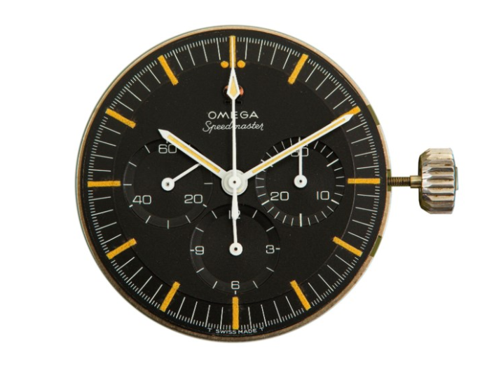

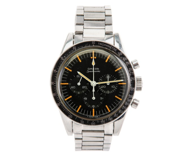

Hello everyone,
I hope this sort of post is allowed here - my first time posting. My grandfather left this watch to my father, my father died last year, and my mother moved house recently and found the watch. Apparently it is in exquisite condition with very little wear indeed - it is not something my grandfather would have used, knowing him. Link here.
It's described as follows by Chiswick Auction House, where it is at auction:
Model: Speedmaster
Date: 18th August 1966
Case reference: ST 105 003-65
Movement: Signed, 17-Jewels, Cal.321, No. 24'004'447
Dial: Signed, black, applied luminous batons, white outer minute division, white sword hands with luminous insert, centre seconds hand for chronograph with luminous insert, subsidiary dial for minute chronograph at the 3 o'clock position, subsidiary dial for hour chronograph at the 6 o'clock position, subsidiary dial for seconds at the 9 o'clock position, "T SIWSS MADE T" at the 6 o'clock position
Case: Signed, brushed and polished stainless steel, straight lugs (last model produced with straight lugs), an extremely rare DON black bezel with silvered Tachymetre, screw down back with engraved seahorse logo, Speedmaster and Omega inscription
Bracelet: Signed, brushed and polished stainless steel No.6, signed brushed and polished deployment clasp No. 7912 Size: 40mm
Accompaniments: Extract from Omega Archives
Same model sold at Sotheby's, 19th July, Lot 43 without bracelet, for 12,500 USD
The extremely rare reference 105.003 was produce between 1964 and 1969.

Lengthy description which coincidently lacks the word “original”.
Makes sense as the dial and hands appear relumed.
If this watch has always been in your family, why is there no mention of this provenance by the auction house?

That’s a dial and hand relume or I will eat my hat. J Hyman’s work by the looks of it.

The orange texture indicates a different flavor.

The 105.003 is a relatively common cal. 321 speedy model and as has been pointed out here the relume hurts the value - it is not only obvious but the color and the granular look are both wrong.

Regardless of the observations by our more experienced-collectors regarding the apparent and undisclosed dial/hands relume, I must say [to my own eyes] it's a good looking watch plus its case appears to be in a very sharp condition. I'm sure someone will buy the watch regardless its obvious flaws wrt originality. It goes with the individual concept of how-much-is-it worth to you..

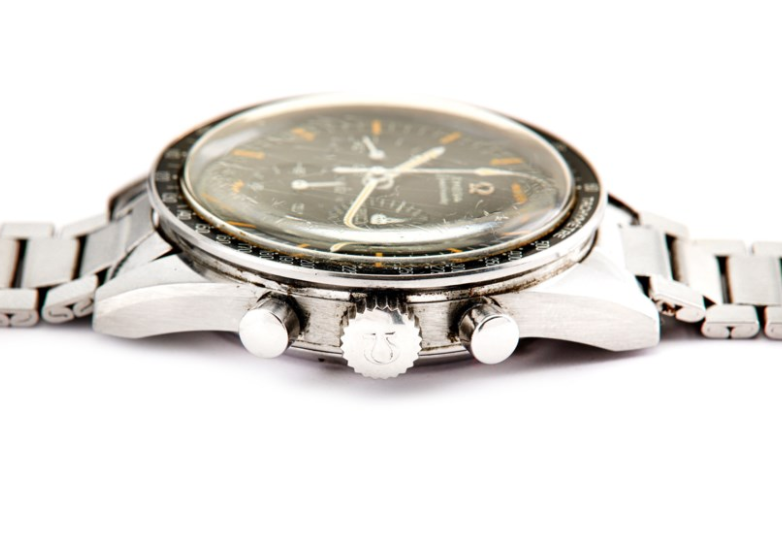

and here are some pics from the auction house...

Good looking case. The hand lume looks too clean and uniform. Does not fit the age of the watch. I haven’t looked at these watches enough to comment on the dial lume, but it also looks too clean and uniform for the age. Good luck!

There seems to be a lot of grime on the case and bracelet for this watch not to have been worn a lot.I've never seen that lume colour on a 105.003 before.I'd say relumed.

A little bit much lume I would say, Omega hour markers do not turn yellow very often. Is rare to see that

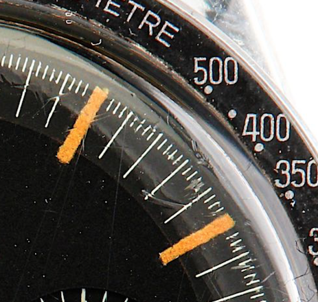

More curious about the possible Hyman relume ... haven't seen any in person but looking at a few pictures of his work, it seems like he's more exacting that the lume application on this example. Not that the wolf in sheep's clothing is a sheep, but the lume application doesn't seem far off from other Eds. Any chance the coloration of the pictures is oddly enhanced?
Hyman's work:

Don’t believe it’s my work guys
An expert opinion. Would you agree it looks redone?
6
30
Never easy to tell unless you get better pics and uncased, colour could be saturated......I wouldn’t like to say either way bud
