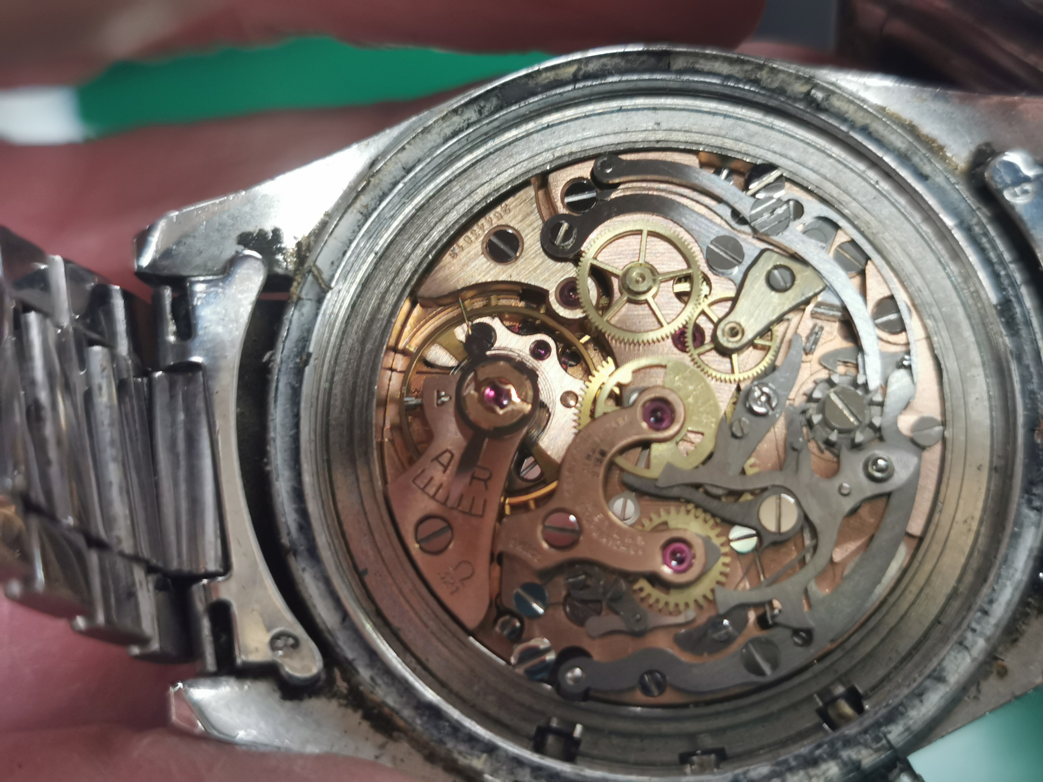

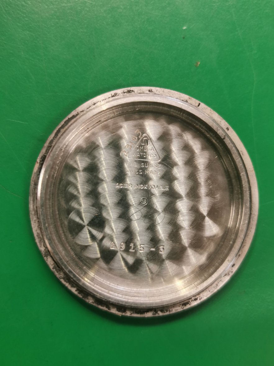

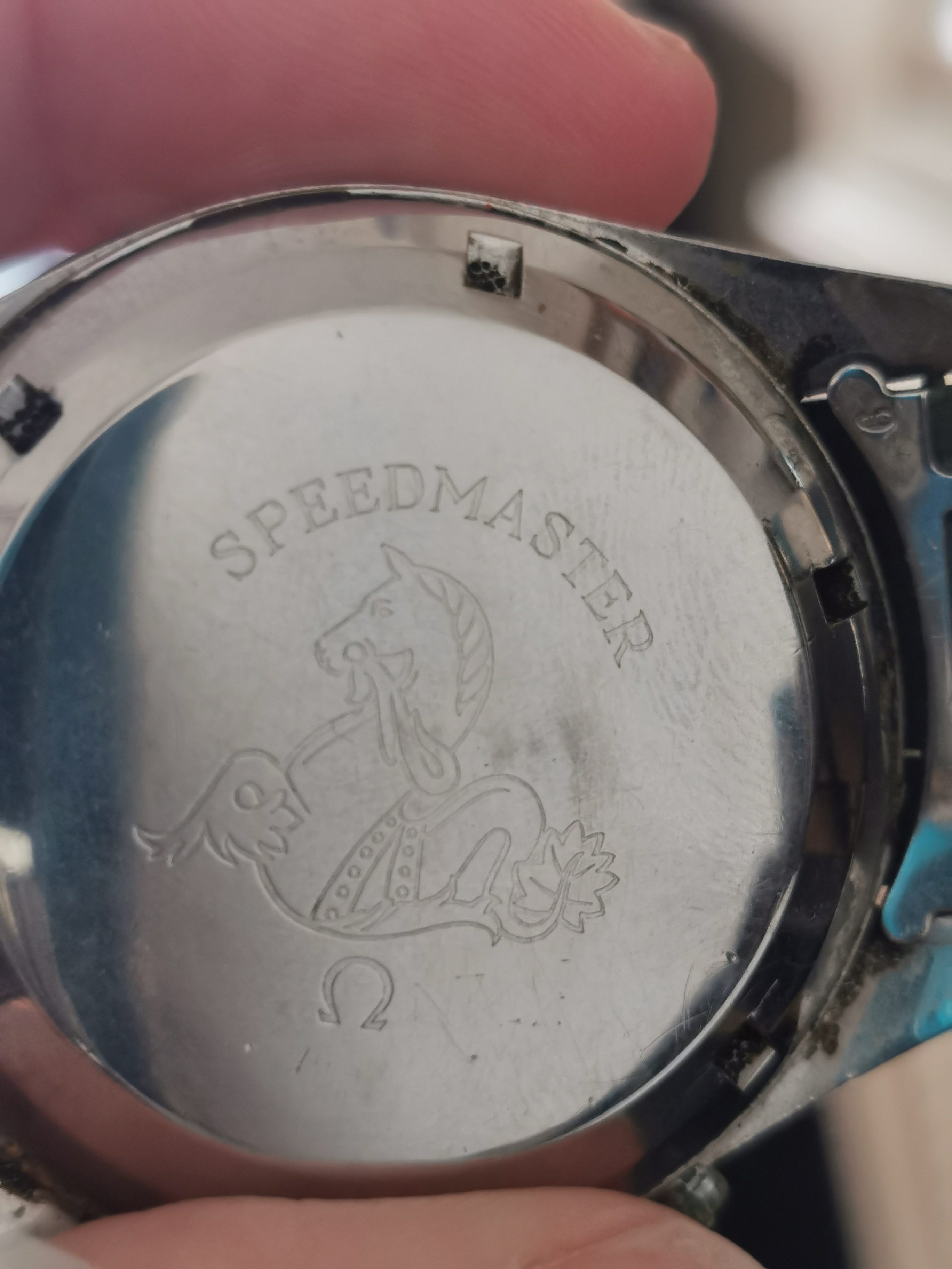

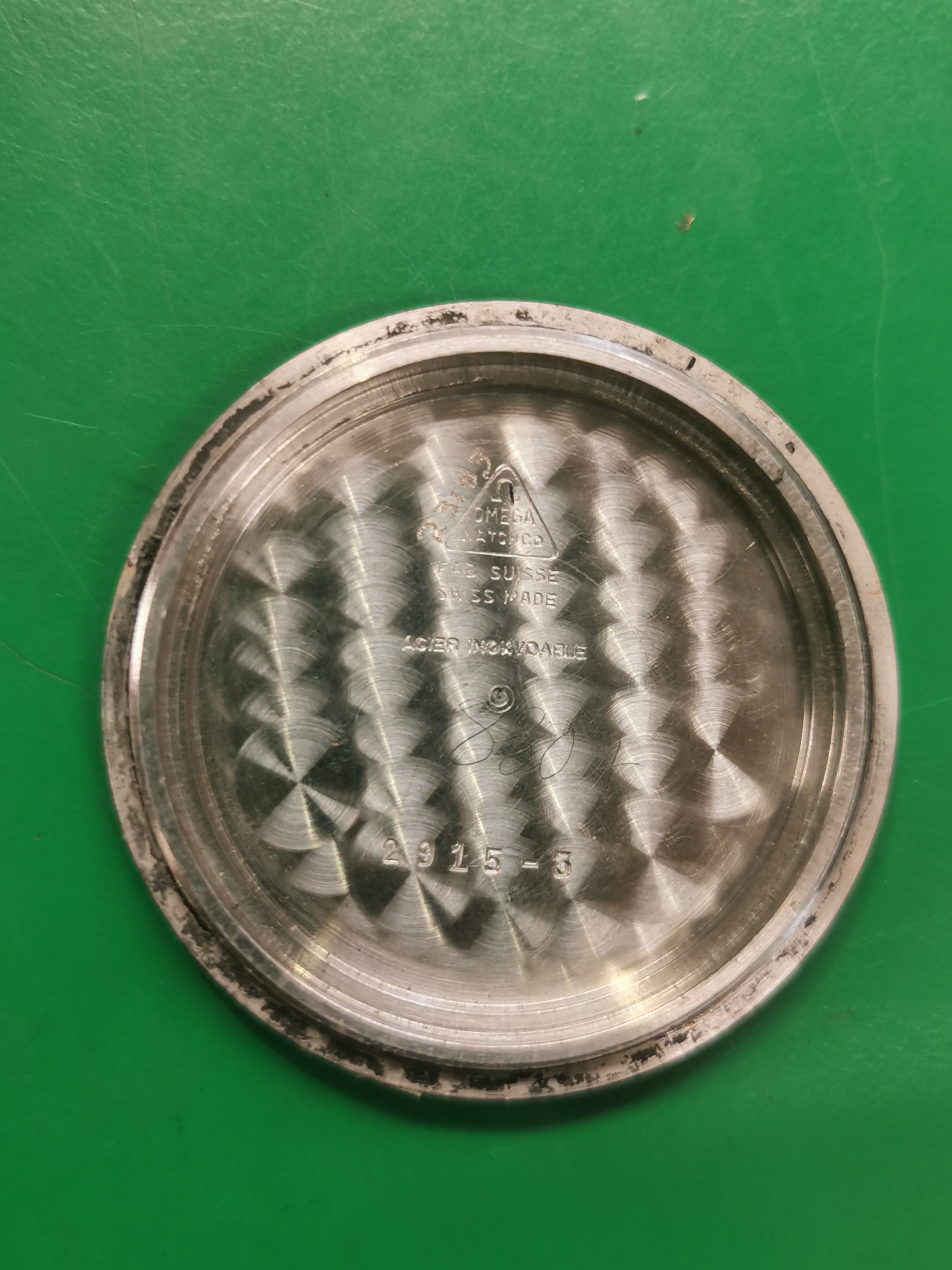

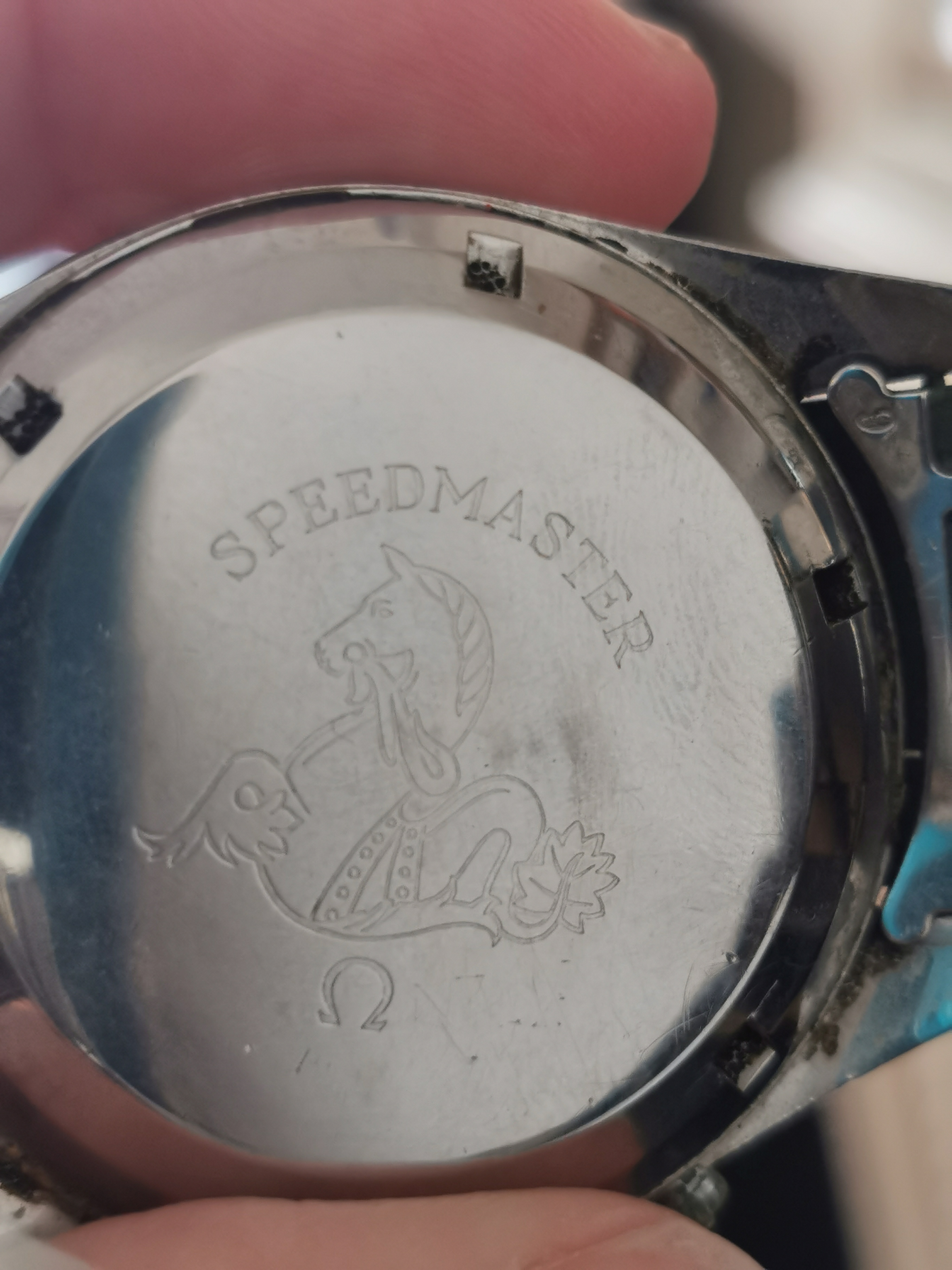

I have a 1957 speedmaster, not fab condition but what can you expect for the age.. However I'm told by a reputable dealer the workings were replaced with genuine omega workings at some point in the 60s. So can't be sold as a complete 1957? I'm just wondering if anyone has recommendations for a good auction house? I took it to a local place but they didn't seem to have the knowledge that the dealer had and suggested it was an early sixties watch and they could put it in the auction and felt it would fetch 3-5k but the back I'm told by the dealer is worth up to 4k on its own.. So just wonder if anyone has a recommendation for a good watch specialist auction? Thank you

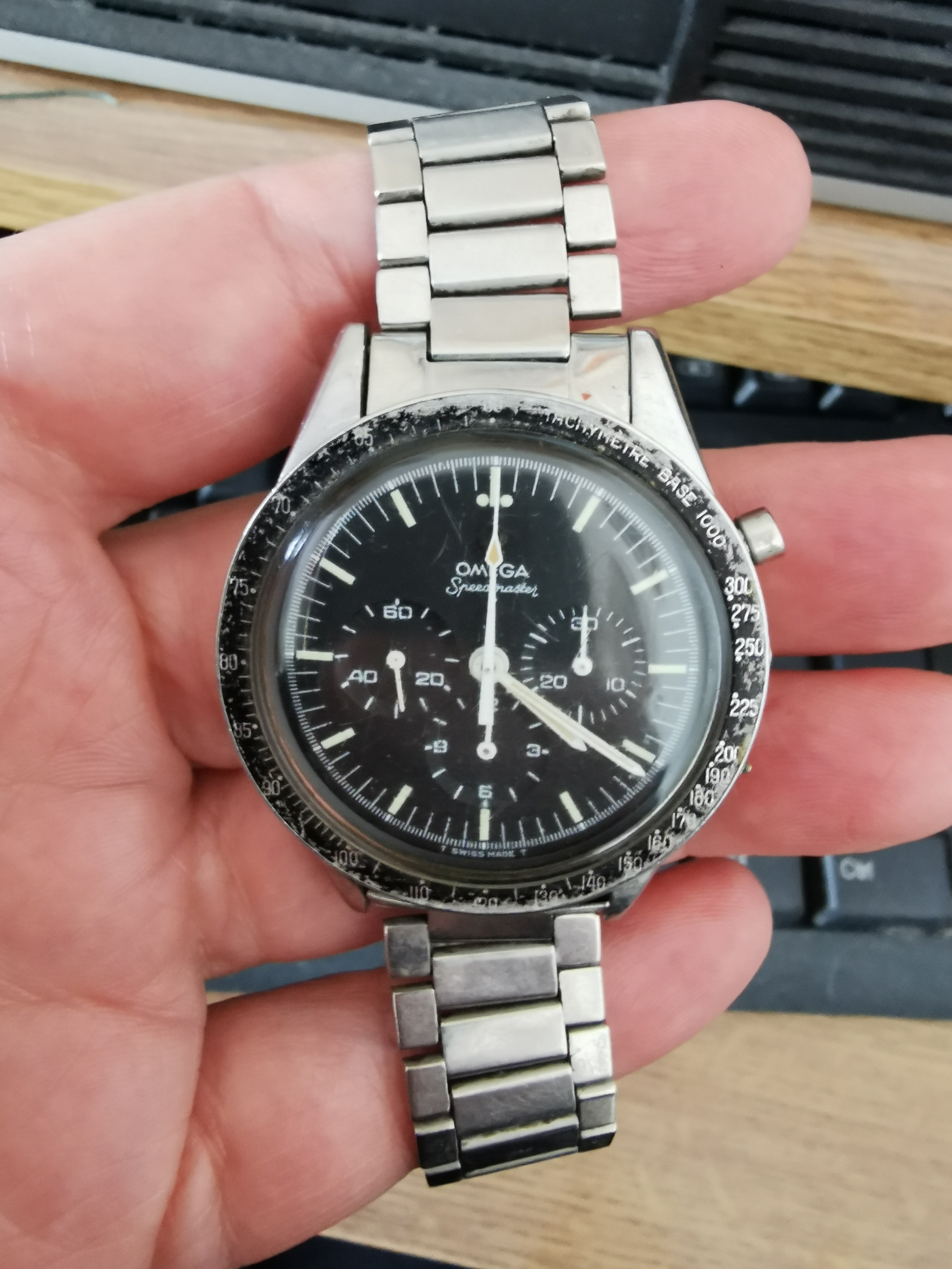

Thank you for the advice, pics added

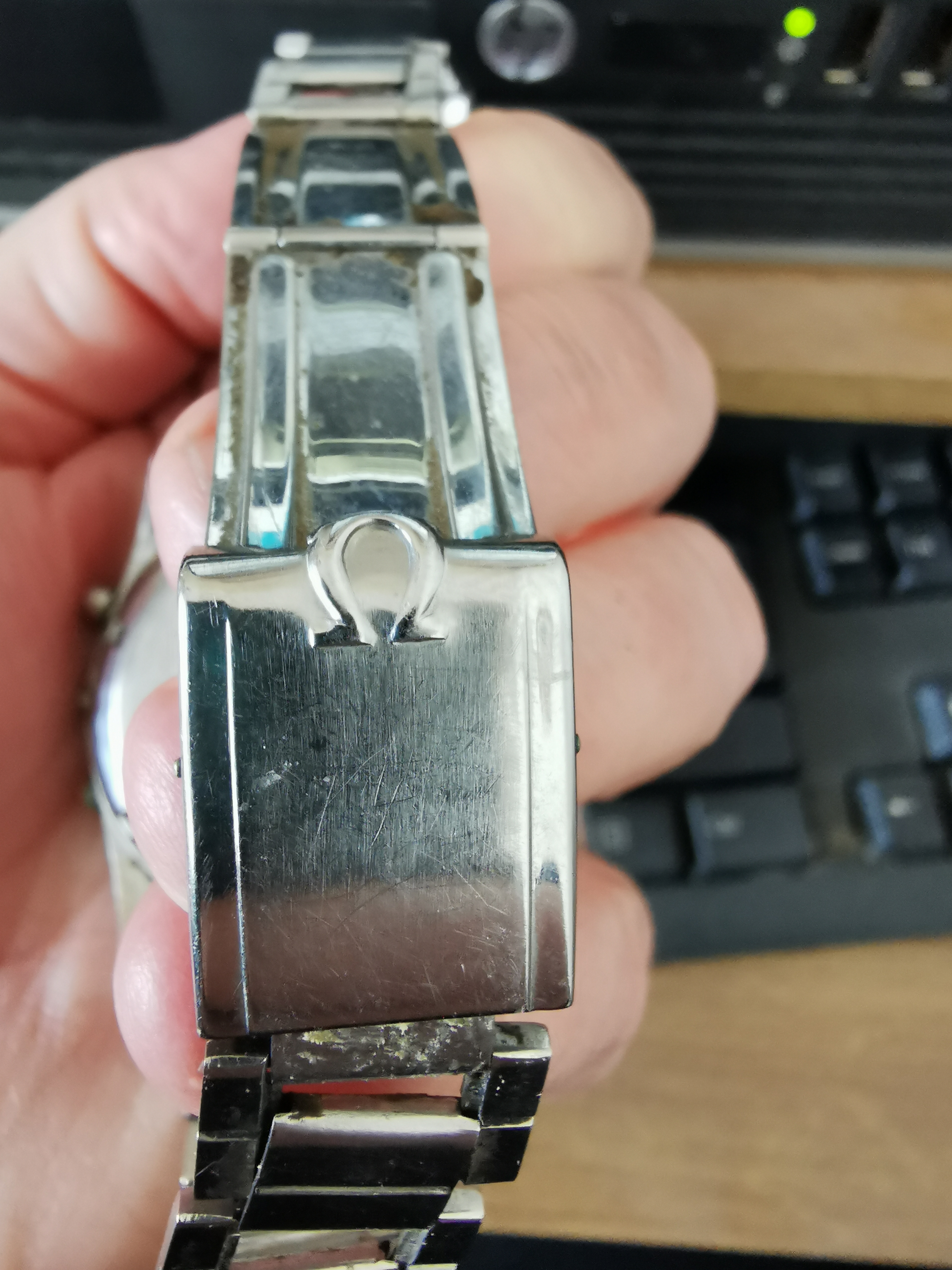

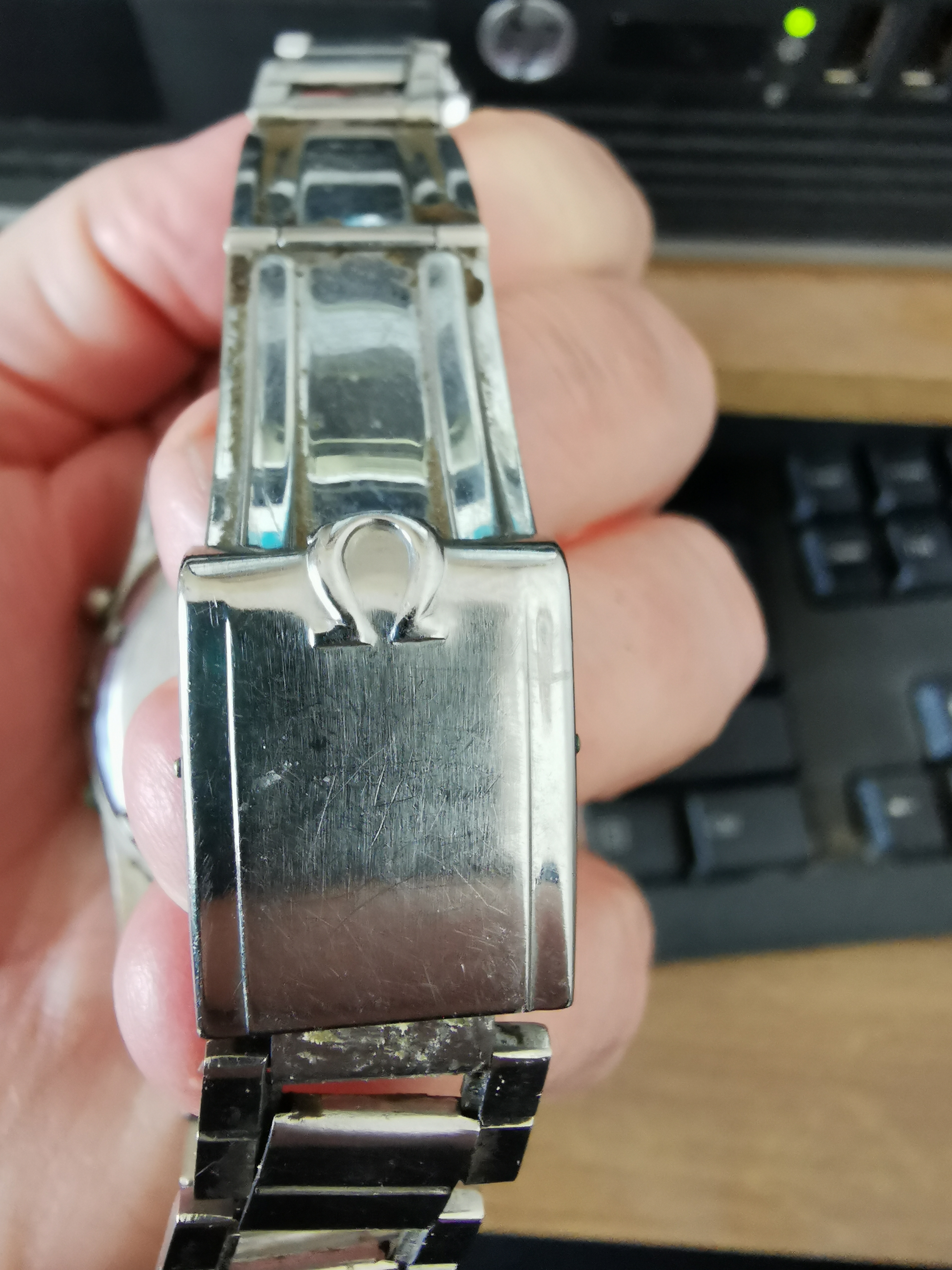

Just the bracelet is worth those estimates, rip your inbox I guess 馃榾
eBay seems like a good idea with good/better photos, visibility is high and fees above $1000 is low
Edit: If it鈥檚 not polished, that鈥檚 why you need better photos, if the endlinks are polished the estimates were better

Maybe sell all the parts separately? (With much better photos.) There's sure to be value in the caseback, mid case and bracelet. And maybe the dial and handset as separates too.

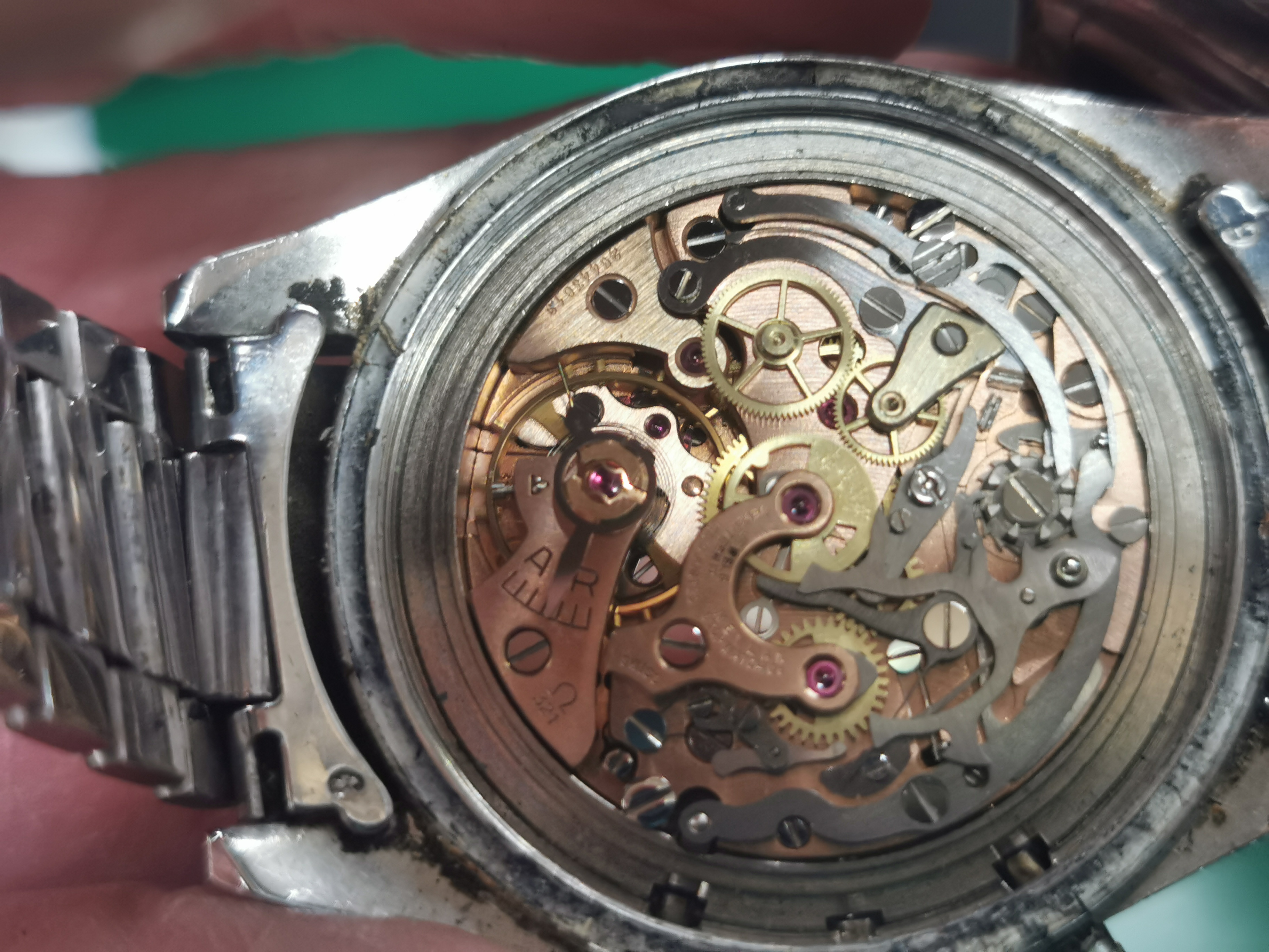

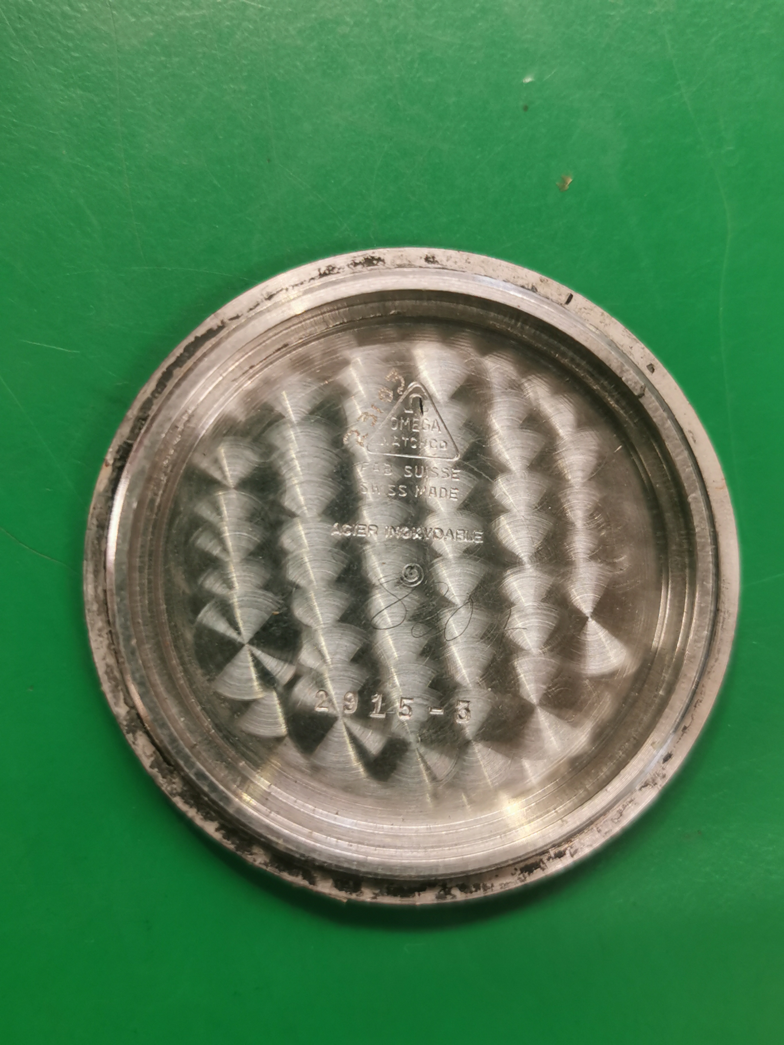

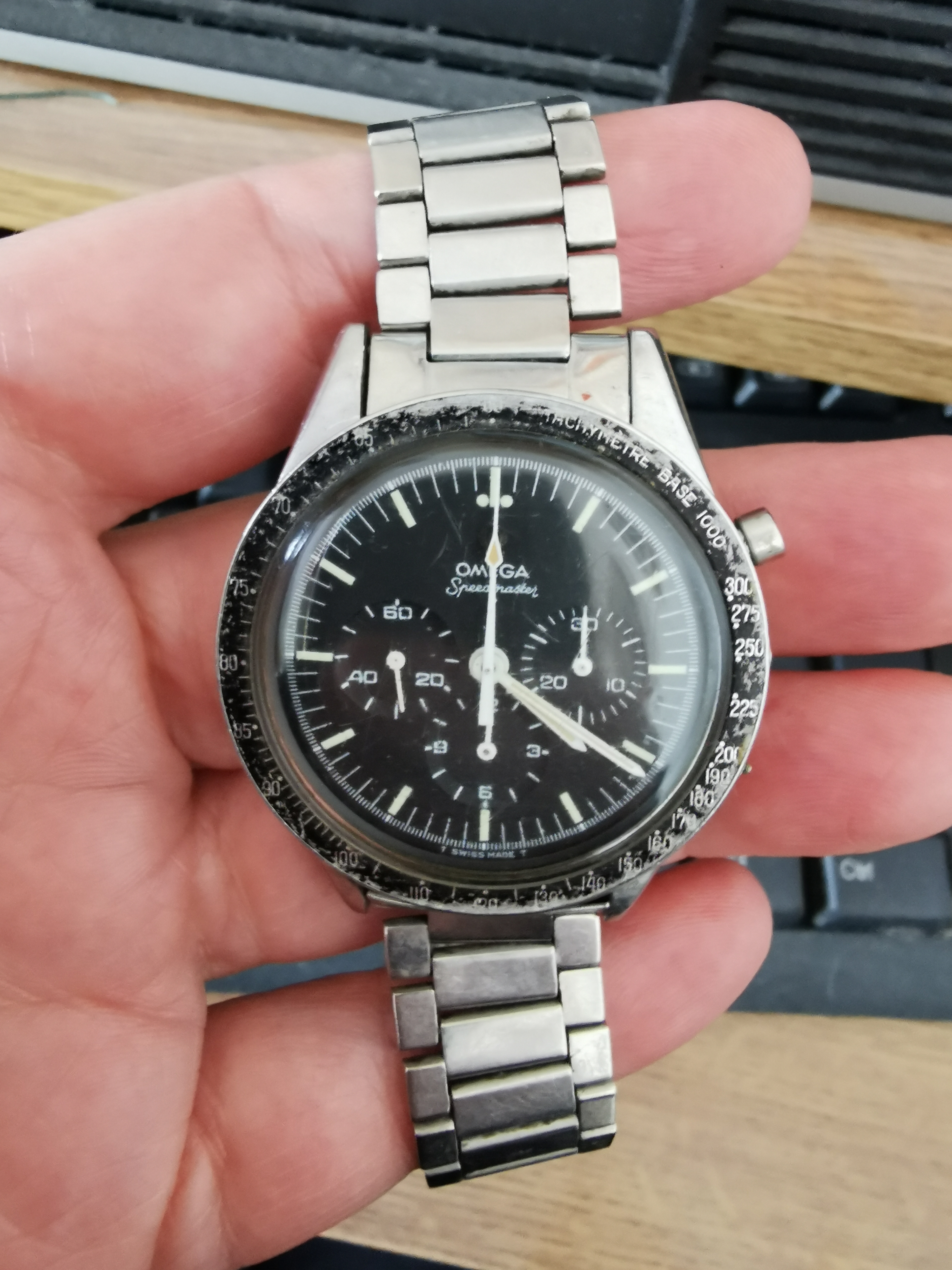

So I am by no means a speedy expert but it appears that the dealer you spoke with wasn't completely wrong. From what I can see movement inside is a gen 2 321. For a 2915 I would have expected to see a gen 1. All the hands have also been replaced as some point in time. You have the DON base 1000 bezel which is correct. Kind of beat up but not terrible shape.

In addition to the later movement, the dial and hands have also been replaced. An original 2915 dial has long indices, the short indices are seen from 70s onwards on service dials. The watch head will likely be priced as parts, expensive parts though and the bracelet and end links will fetch an extra couple of thousand too so there is likely the thick end of 拢10k there perhaps. The case and bezel are worth a few quid alright, but not many collectors will covet that as a watch to keep whole and that will affect the value since the rest aren't anywhere near as desirable as the originals. The movement may not have even been in a Speedy to start with.

Not a simple sale. In addition to what is mentioned above, a BASE 1000 bezel is always of interest, but yours is not in good condition. Very tricky to put a value on a piece like this. One really needs to have a good handle on the value of the various parts.
