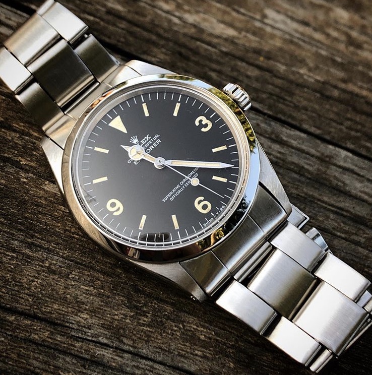

Here's mine, a late gilt example:

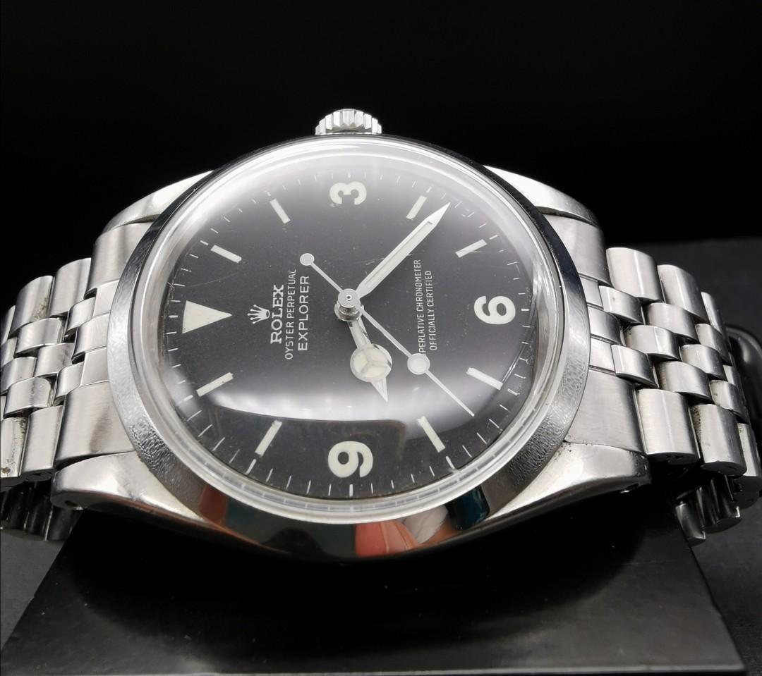

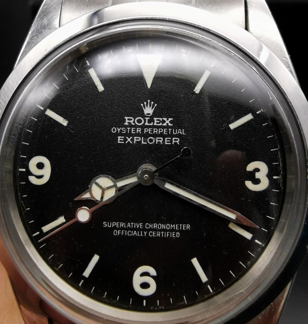

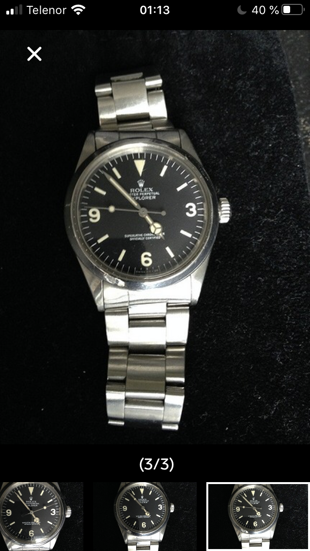

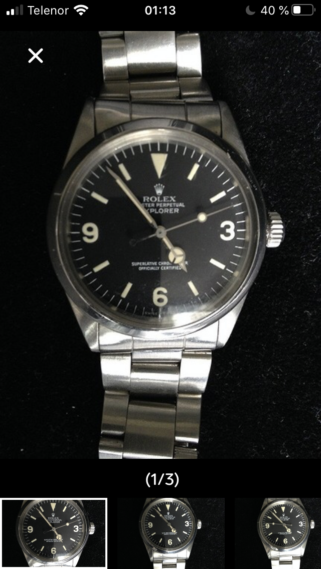

What do you know, one pops up just a week or so after this posting. Does anyone have a pointer to a good 1016 FAQ or guide? I'm a little bit concerned by a couple of things in the description:
Original matte black dial with aged tritium markers
Newer set of original serviced hands
'Frog foot' coronet
Original stainless steel folded bracelet
744 xxx circa 1961
Wouldn't a circa 1961 1016 have a gilt dial if original? They're asking $10K. It's a Mom & Pop watch shop, located in a rather dubious mall, and I'm skeptical.

You should be very skeptical because that dial is a MK 1 matte dial seen from 1964-1974 and possibly from 1976-1978 but definitely not from the serial given (1961/62) which would have a gilt chapter ring dial with a MK 2 or a MK 3 gilt variant. It would be interesting to see between the lugs if possible
The dial, even if the case were from the correct range, is of poor quality and has been tampered with. Not worth near 10K

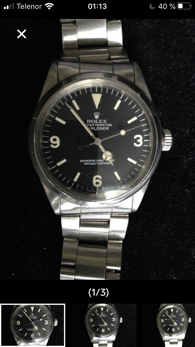

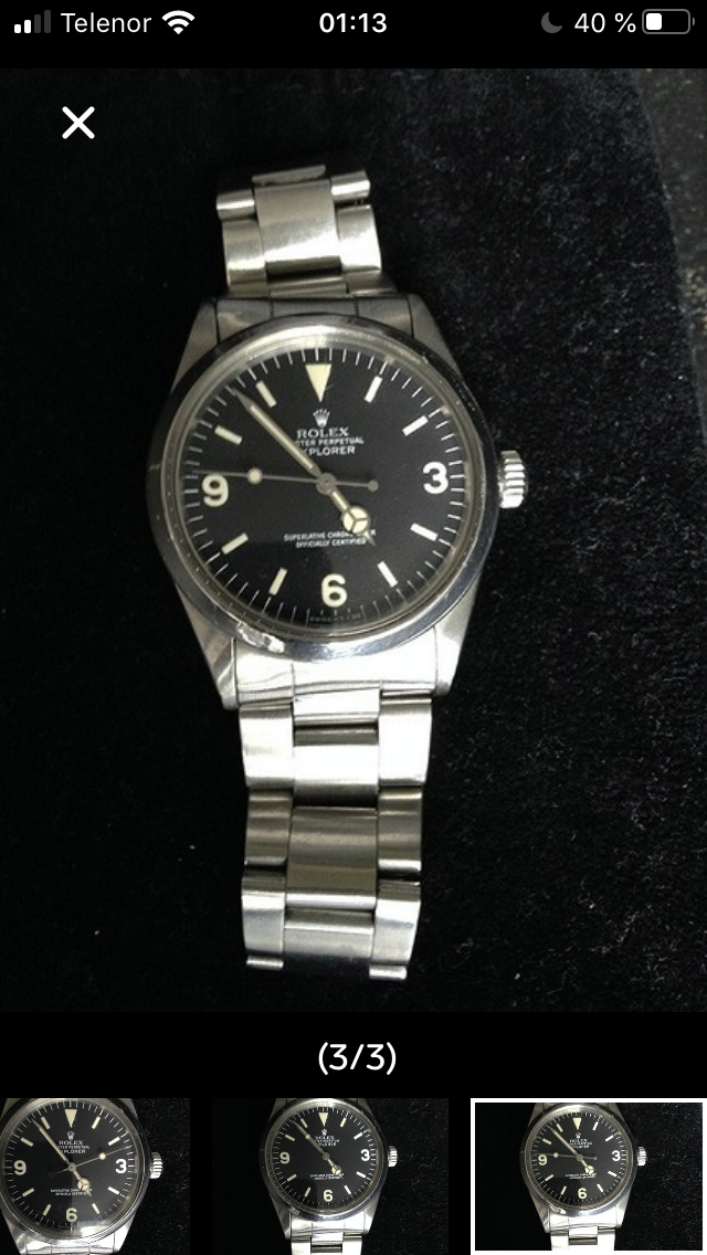

I’d love to find a perfect example but have always struggled with their rising prices. I also love a self-winding Tudor Ranger so that would be a great alternative for likely a more rare watch.
101
540
Back in 2013 I could have bought this one for about Euro 1600. I was at the time even less familiar with watches then I am now so I didn’t dare buy such a small and expensive watch, even if it being a Rolex... Had I only known...

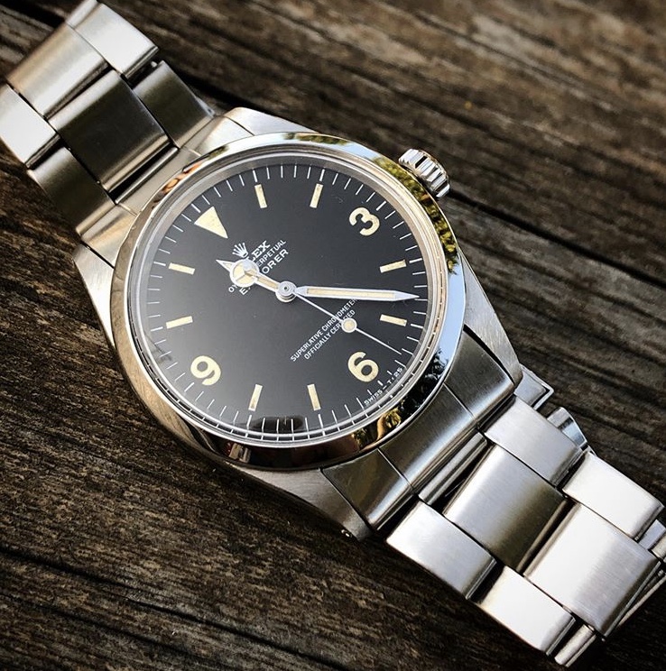

Interesting that this watch during a pandemic can get $16,500 in minutes. The condition is very good but not excellent imo, attractive lume (though small piece missing in a couple spots) and a non-matching bracelet. I would expect a better example to fetch 20K and it would likely sell just as fast
