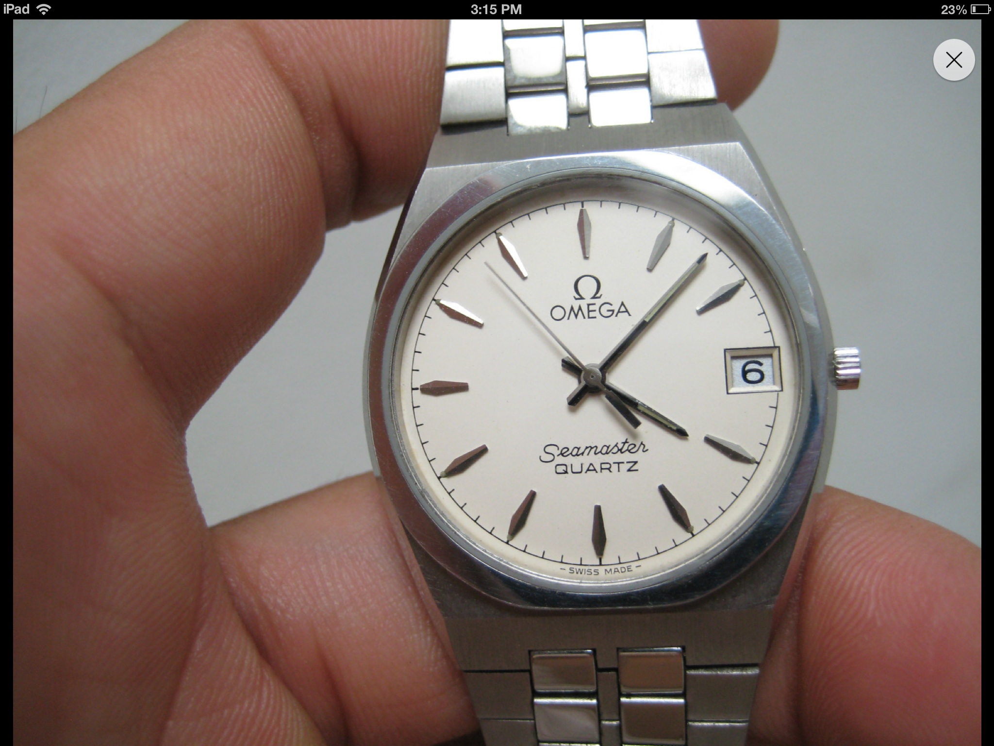

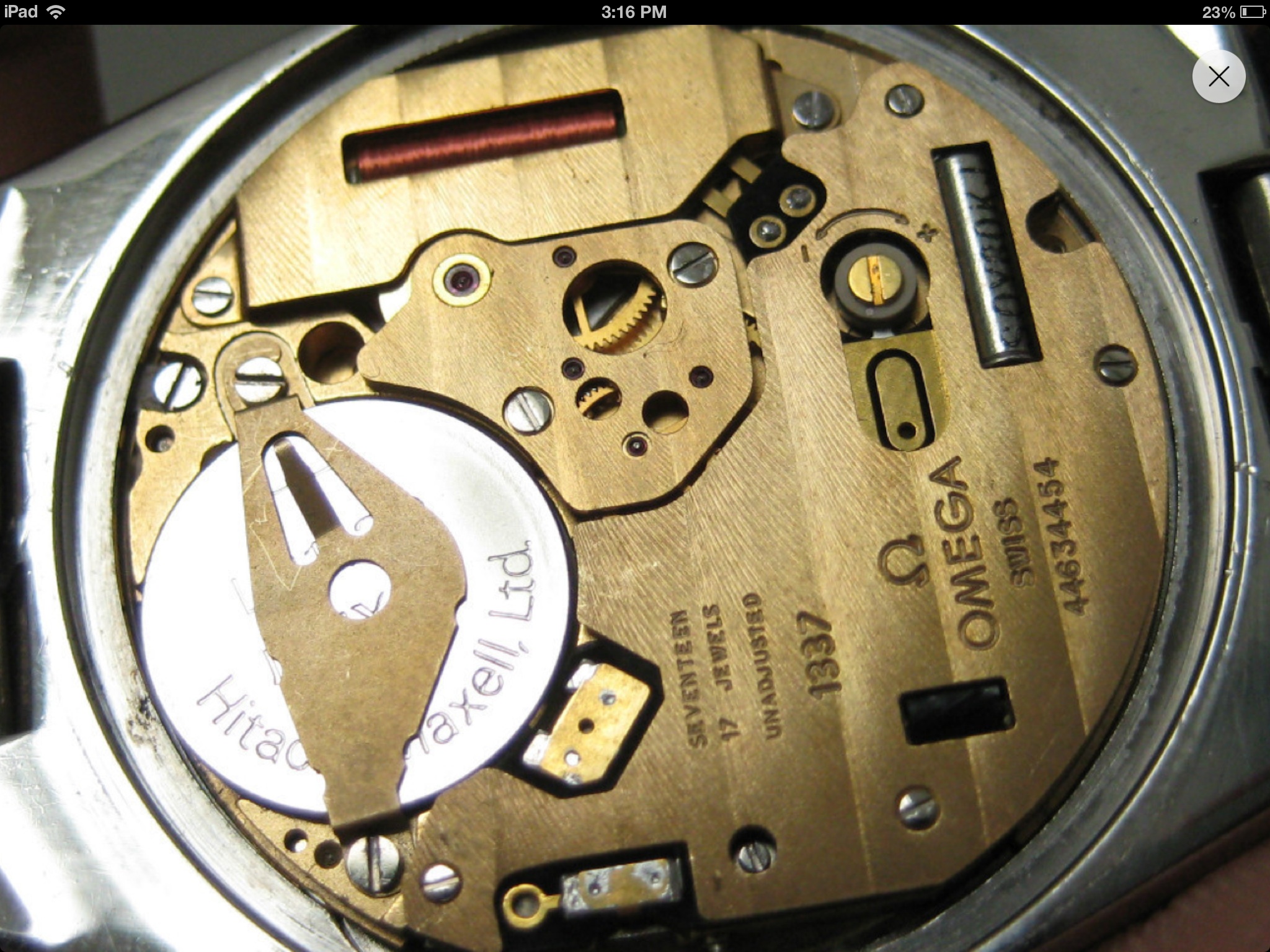

Hi, new here
I have an Omega Seamaster quartz 1981 vintage with the 1337 movement.
According to the manual these were originally specced to 5 seconds a month.
Mine is running at 2.5 seconds a day!!!
How much adjustment does the trimmer allow this to be corrected?
Thanks
Paul

The trimmer is pretty sensitive if memory serves, I'd give it a quarter of a turn and see what happens.

Thankyou
I thought it only turned as far as the - mark.
I had turned it to there but was still losing 1.75, shall turn a bit further

Although I don't have the figures in my head for the 1337, usually the trimmers are quite limited to how much they will adjust the timing. If I recall similar movements are limited to something like +/- 1.2 seconds per day. The trimmer is only meant for fine tuning, not for correcting larger errors.
Not sure what the service history is on your watch, but if it has not been serviced in a while, you might want to consider it.
Cheers, Al

Thought I'd put an update here for reference on the 1337 trimmer
was running 2.5 seconds fast moved trimmer 1/4 turn to - now running 0.4 sd slow.
Looks like the trimmer can vary maybe + or - 4.0 sd?
I'd imagine with Archers machine it could almost be made spot on as long as I kept to the same wearing routine.

Good to hear and res a timing machine would help fine tune but it's good fun moving the trimmer in small increments and then measure the impact a few days later, with the video method (see watchuseek HAQ forums), it's actually pretty accurate. There are cheap "clones" for mechanical watch timing machines but nothing affordable for quartz timing machines, yet...
