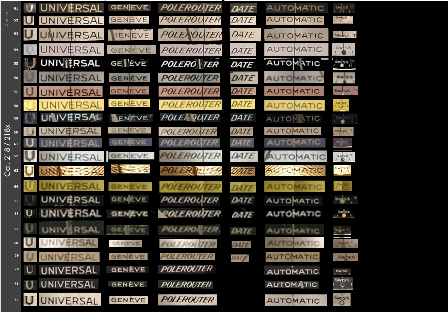

    Interpreting the world of Polerouter dials can be a daunting task for novice enthusiasts such as me. The overall challenge stems from at least five factors: (a) diversity of dial designs, (b) variety in execution, (c) limited availability of official or otherwise definitive reference materials, (d) poor survival rate of engraved serial numbers on non-bumper cases and (e) prevalence of redials, including some good ones. While these factors can add to the challenge of separating fact from fiction, they are also part of what makes Polerouter-spotting so much fun.
    To help me learn more about Polerouters, I’ve compiled a small set of sample dials which I extracted from photographs found on the internet. I present that sample set to you below for reference and hope you will find it useful. The sample set includes Polarouters, Polerouters and Polerouter Dates which, for convenience, I will collectively refer to here as “Polerouters”. It does not address other three-handed models such as Geneves, Jets, Supers, Subs, Electrics, etc. My initial focus is on Polerouter text, including shields. As such, the sample set includes all shields and text found on those Polerouter dials I was able to find online and which had some modicum of visual clarity (unfortunately, as I’ve mentioned elsewhere, the photos on polerouer.de were far too fuzzy for me to use here) . I’ve broadly organized the samples according to movement “family”.
    With the exception of logos/shields and the words “Swiss” or “Swiss T”, each row is more or less to scale with itself. I say “more or less” because many of the donor photos were taken from angles – this means that the internal scale-relativity of each row should be taken with some degree of salt. While I’ve tried to catch only what I suspect to be “unrestored” dials (especially difficult for me in the area of bumper models), I cannot guarantee that a redial or two did not sneak its way into the mix. Another caveat: I attributed the samples to caliber family based largely on the poster’s/seller’s own caliber identification and, where available, on my own visual inspection of the movement photo. This might have introduced some error in cases where the poster mis-identified a movement which I was unable to verify – if at all an issue, I expect it would be mostly (if not entirely) between the Cal. 218 and 69 families as their dials look very similar.
    All that said, I had a lot of fun compiling the sample set below and hope you will have fun checking it out. I’ll be very interested to hear any observations you might have and look forward to hearing from you. In the meantime, I’ve jotted a few of my own observations for discussion. Those observations are found immediately below the sample set and apply only to the sample set at hand (i.e. I don’t claim these to be “Universal” truths).

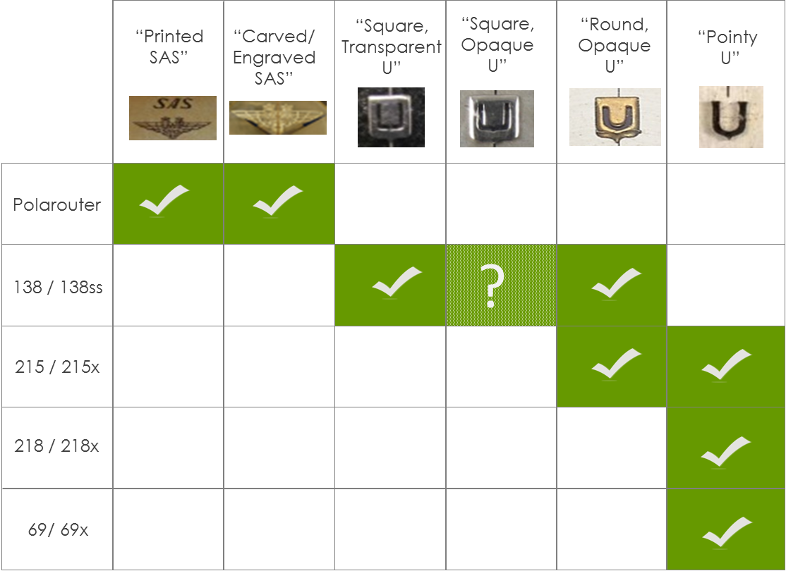

    A. On logos/shields:
    Five or six logos/shields are evident and can be somewhat correlated to caliber (see table below):
    1. A printed SAS logo, appears on the Polarouter
    2. A carved/engraved SAS logo, also appears on the Polarouter [edit: removed term "applied", added "carved/engraved"]]
    3. The third shield/logo appears on Cal. 138/138ss models (including the Polarouter) and consists of a shield with a square-ish cut-out letter “U”. Because the U is cut-out from the shield, one can see the dial and crosshair through the shield. For this reason, I refer to this shield as a “Square, Transparent U” (“STU”).
    4. The fourth shield is still a bit of an open question as far as I am concerned: it is similar to the third shield insofar as it features a square U, but differs in that its U is opaque and perhaps the overall shield is more “bulbous”/”phat” than the previous example (which appears more flat). I refer to this as the “Square, Opaque U” (“SOU”). I am still on the fence on this one because I am not sure whether the opacity is actually due to dirt/grime/scudge. This shield appears on one Cal. 138/138ss (Polarouter) model in the sample set above (see reference #10) and can be seen on some bumpers on the polerouter.de website, including the following:
    http://www.polerouter.de/images/collection/polerouter39-big.jpg
    http://www.polerouter.de/images/collection/polerouter63-big.jpg
    http://www.polerouter.de/images/collection/polerouter33-big.jpg
    5. The fifth shield features a rounded, opaque U and I refer to it as “Round, Opaque U” (“ROU”). It can be found on 138/138ss and 215/215x models.
    6. The sixth shield is what @LouS has elsewhere called a “Pointy U”. It can be found on Cal. 215/215x, 218/218x and 69/69x models.
    [edit: the following table updated to reflect feedback below from @styggpyggeno1 ]

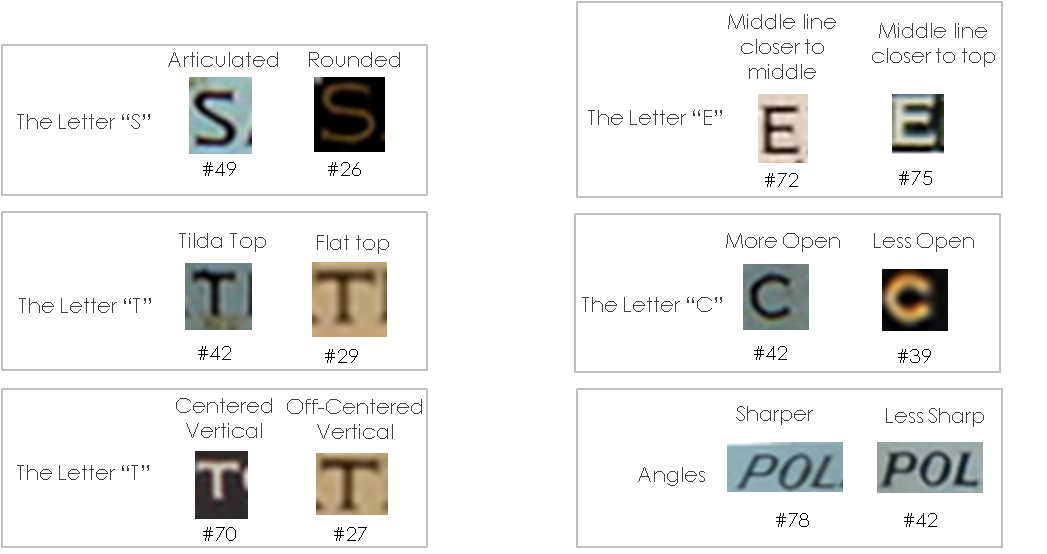

    G. On execution variety:
    1. Letters found on Polarouter/Polerouter dials come in a range of variants. For instance, as shown in the figure below
    a. The letter “S” can be bent/articulated like a pipe or rounded
    b. The top of the letter “T” can slope like a tilda or be straight
    c. The vertical line in the letter “T” can be centered relative to the horizontal line, or off-centered
    d. The middle horizontal line in the letter “E” can be vertically closer to the middle of the letter’s height or closer to the top
    e. The letter “C” can be nearly closed or fairly wide open
    f. The type can be angled more sharply (i.e. closer to 60 degrees) or less sharply (i.e. closer to 70/75 degrees)
    I’m splitting hairs at this point, but the list does go on...

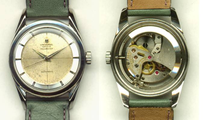

    I will try to get you a better picture for the first "SAS" Polarouter. You have namned them "applied SAS logo" - which for me sounds like they are applied on to the dial (but English is not my first language). They are in fact carved into the dial by hand.
    [​IMG]

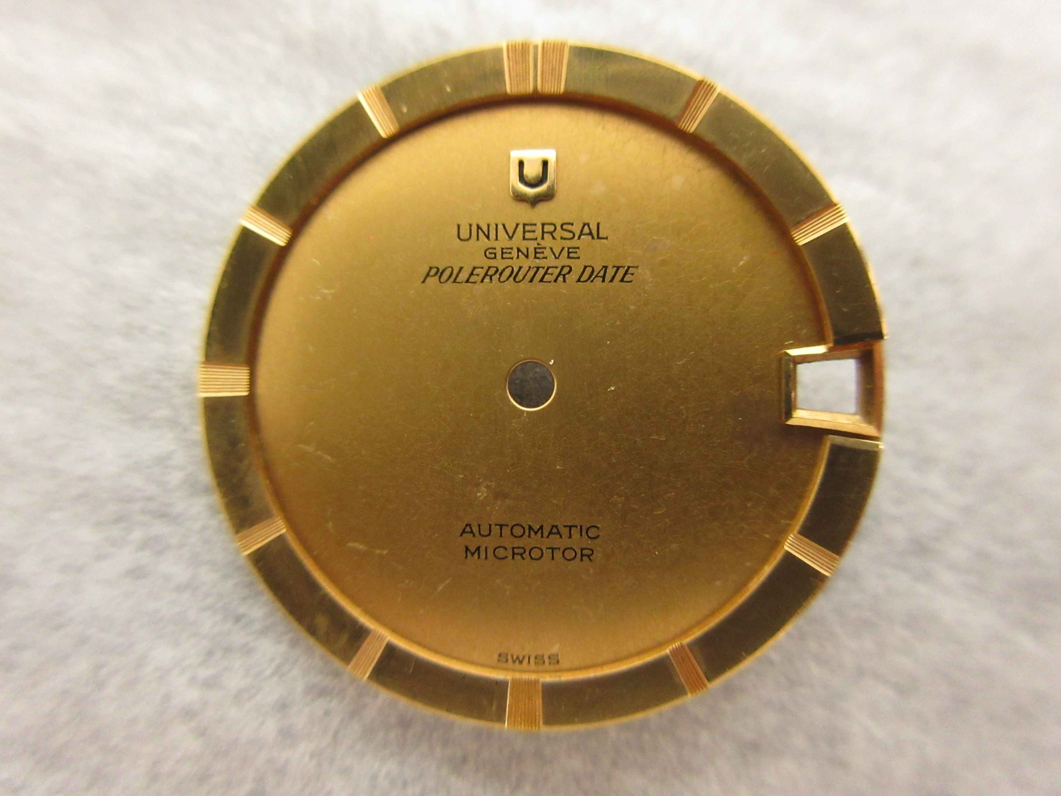

    Here's the dial from my 215-1 date should u need more samples for your analysis
    littlesheep81 and styggpyggeno1 like this.

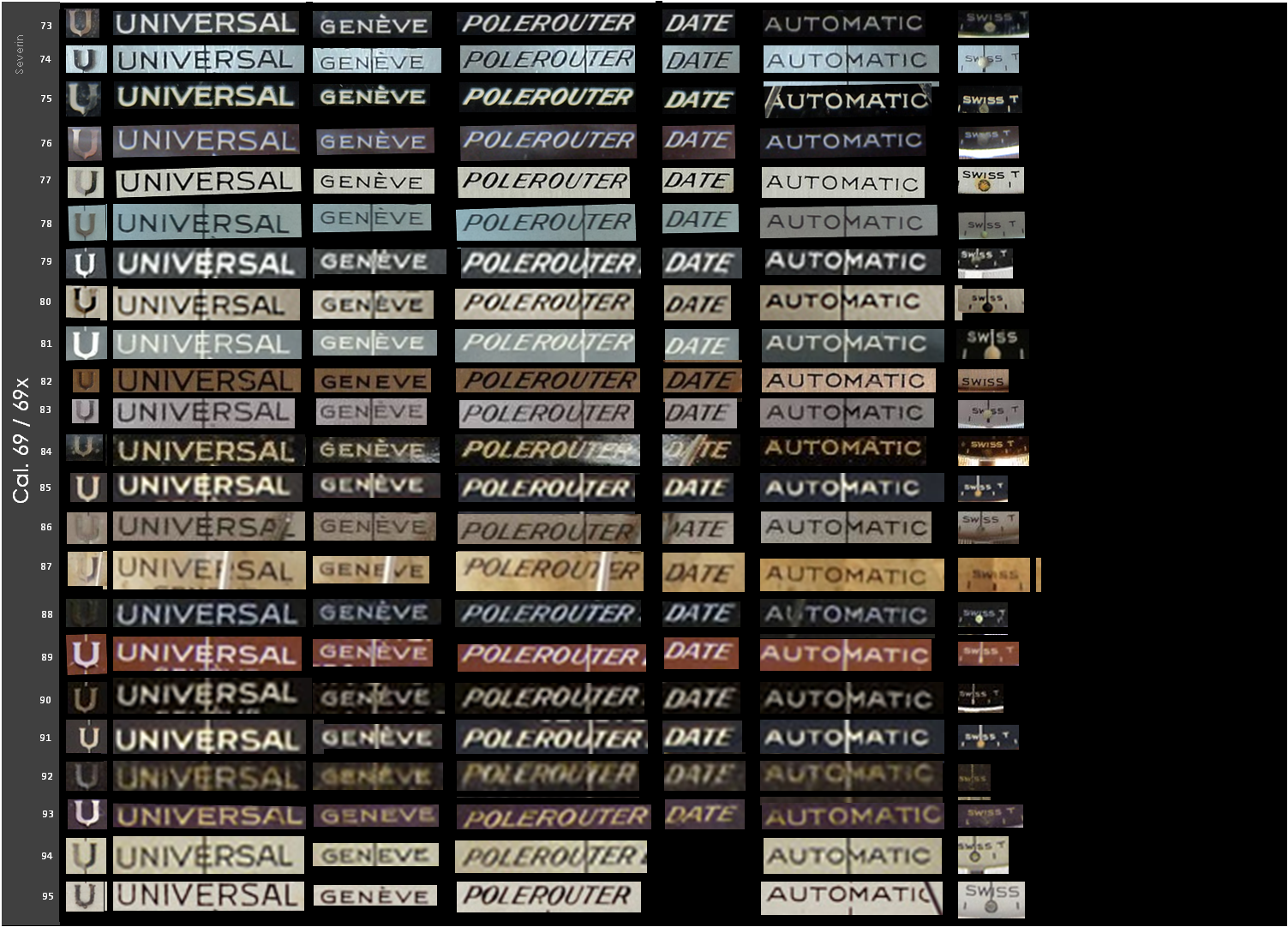

    Cal 69, 18k rose.
    [​IMG]
    [​IMG]
    [​IMG]
    [​IMG]
    SWISS MADE T, cal 69-1. Can not see any "MADE" in your pics. The U-logo in a square box.

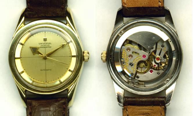

    Calling all eyes:
    This example confounds me and makes me wonder if i've missed something. It is ostensibly a 138ss, but I cannot see "Swiss" anywhere, including in other angles i've seen of the same piece. By my way of thinking, it should be somewhere beneath the minute markers. Has anyone seen a 138ss dial without the word "Swiss"?
    Thank you in advance for any reconnaissance you might offer.

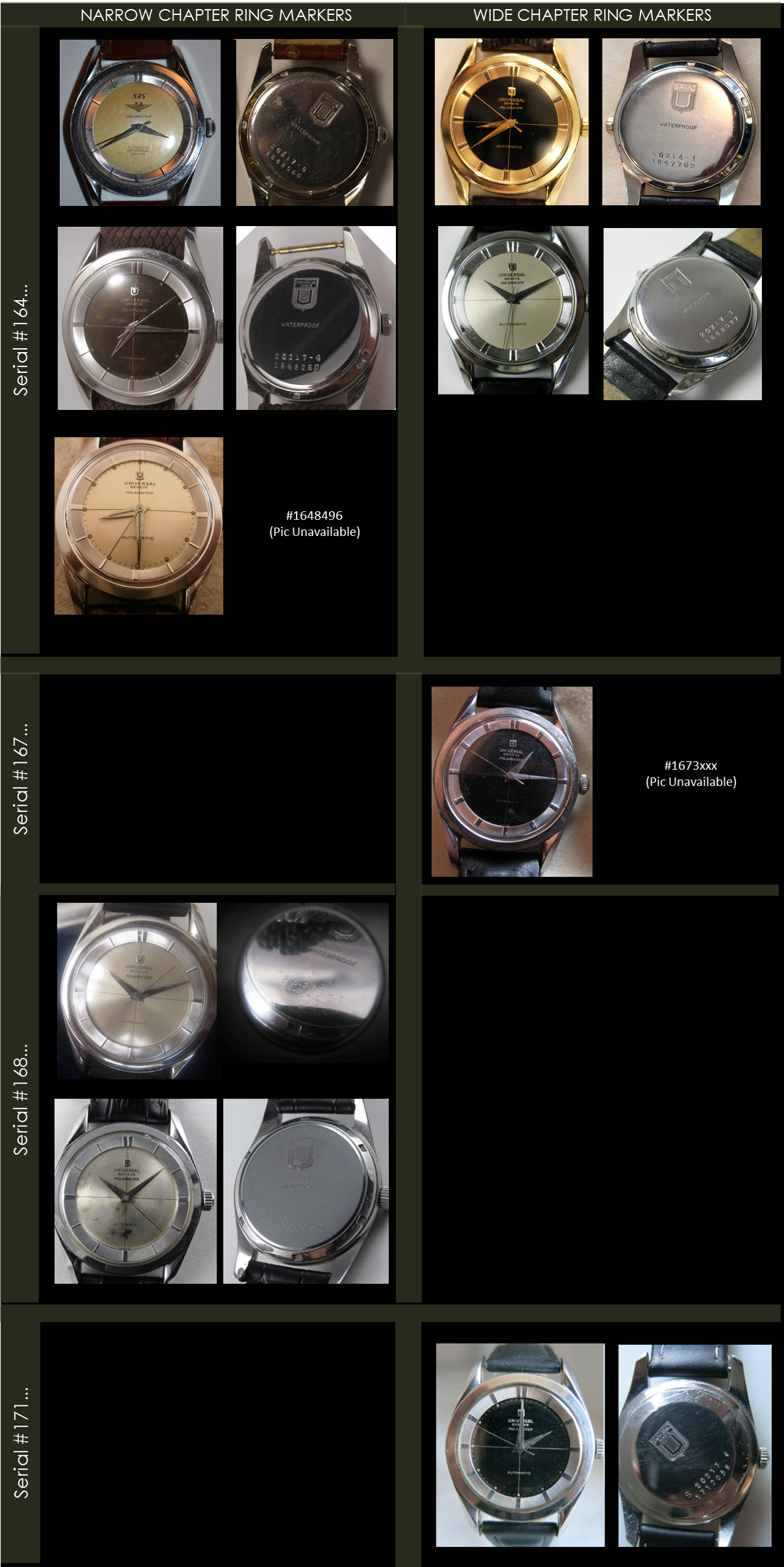

    ...Nothing fancy here, just had a few minutes of downtime and I thought I’d look into an interesting observation made previously by @guillaumeabxl – that some Polarouters have narrow chapter ring markers, while others have wider chapter ring markers. This led me to wonder whether the width of a Polerouter chapter ring could be predicted by serial number.
    To check it out, I put together a handful of examples I was able to find quickly and in which the serial number was either identified by the owner and/or a caseback pic was available. I’ve summarized these few examples in the figure below, most of which were taken from various OF threads. I excluded De Luxe models.
    Not much insight to be told based on the look so far, but the brief compendium below does suggest that serial number is not likely a good predictor or narrow vs wide chapter ring markers; there is overlap (for example, both narrow and wide variants are found with serial numbers beginning with 164).
    The sample set below is clearly incomplete: perhaps as you encounter some Polarouters in your searches and are able/willing to share serial numbers (at least the first few digits), please feel free to bring them to our attention here. Over time, we can fill in the gaps and perhaps a more obvious pattern will emerge. Thank you and all the best.
