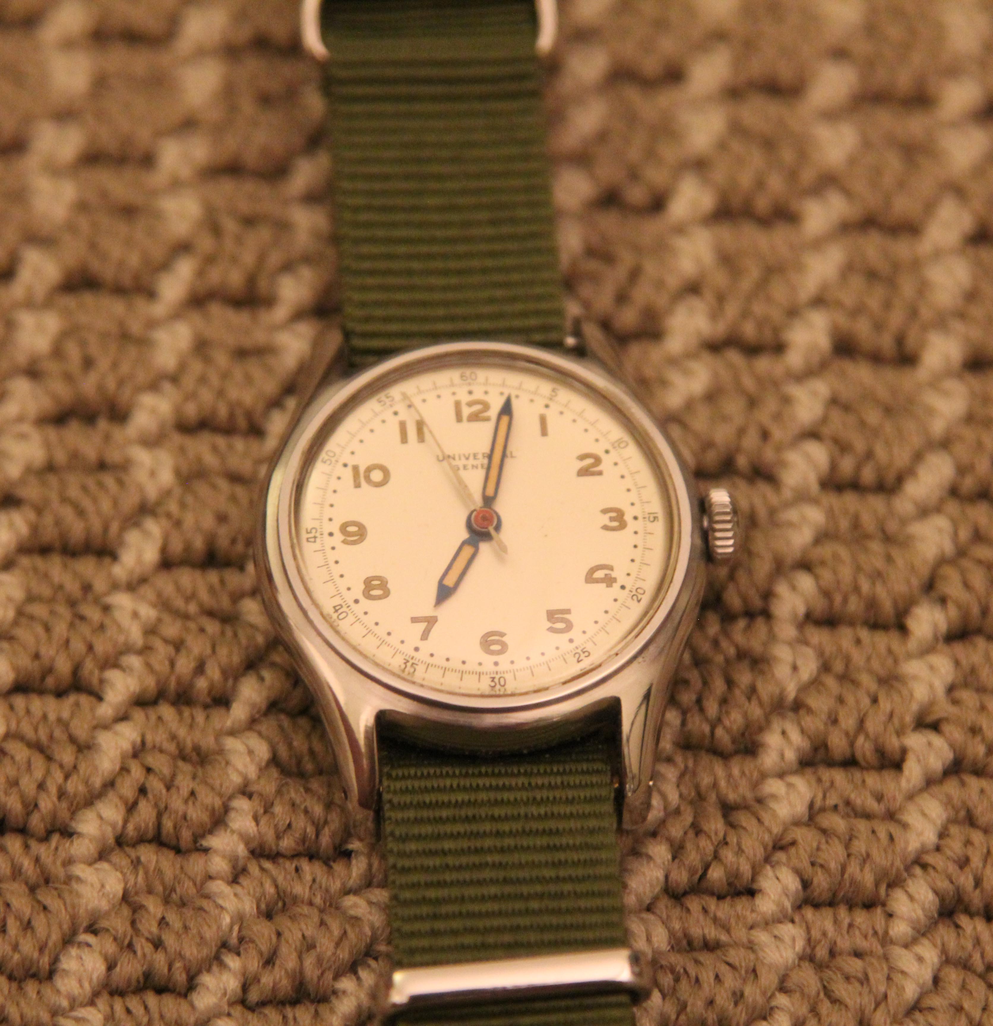

    Hi all, i stumbled across this very nice piece. The dealer claims its a circa 1950's Ref. 20503.
    I wonder if the experts here could weigh in on its authenticity and what you may think it's worth. Comments very much appreciated.
    Full description is:
    Universal Geneve stainless steel military wristwatch, circa 1950s, Ref. 20503, 33 x 42mm case with screw down back with original matte silvered dial with luminous indexes and pencil hands. 17-jewel manual-wind movement with sweep seconds. Pleasing post-WWII military-inspired design. Shown on NATO style, or your choice of sporty strap.
    [​IMG]

    Looks authentic to me. Case appears to have received an overzealous polishing, and of course you haven't included movement or caseback pictures. The crown is likely a replacement, though this is not a big deal, and the originals were unsigned anyways.

    Happened to run across the dealer where this piece is offered for sale. Check that it comes with a recent service, but for the asking price, I'd pull the trigger. If you're patient, you may find one one the Bay for a better price, but you're unlikely to find one in better condition, and throw in a service and you're talking similar money.
    For my preferences, I'd throw a vintage pigskin strap on her rather than that ugly green Nato.

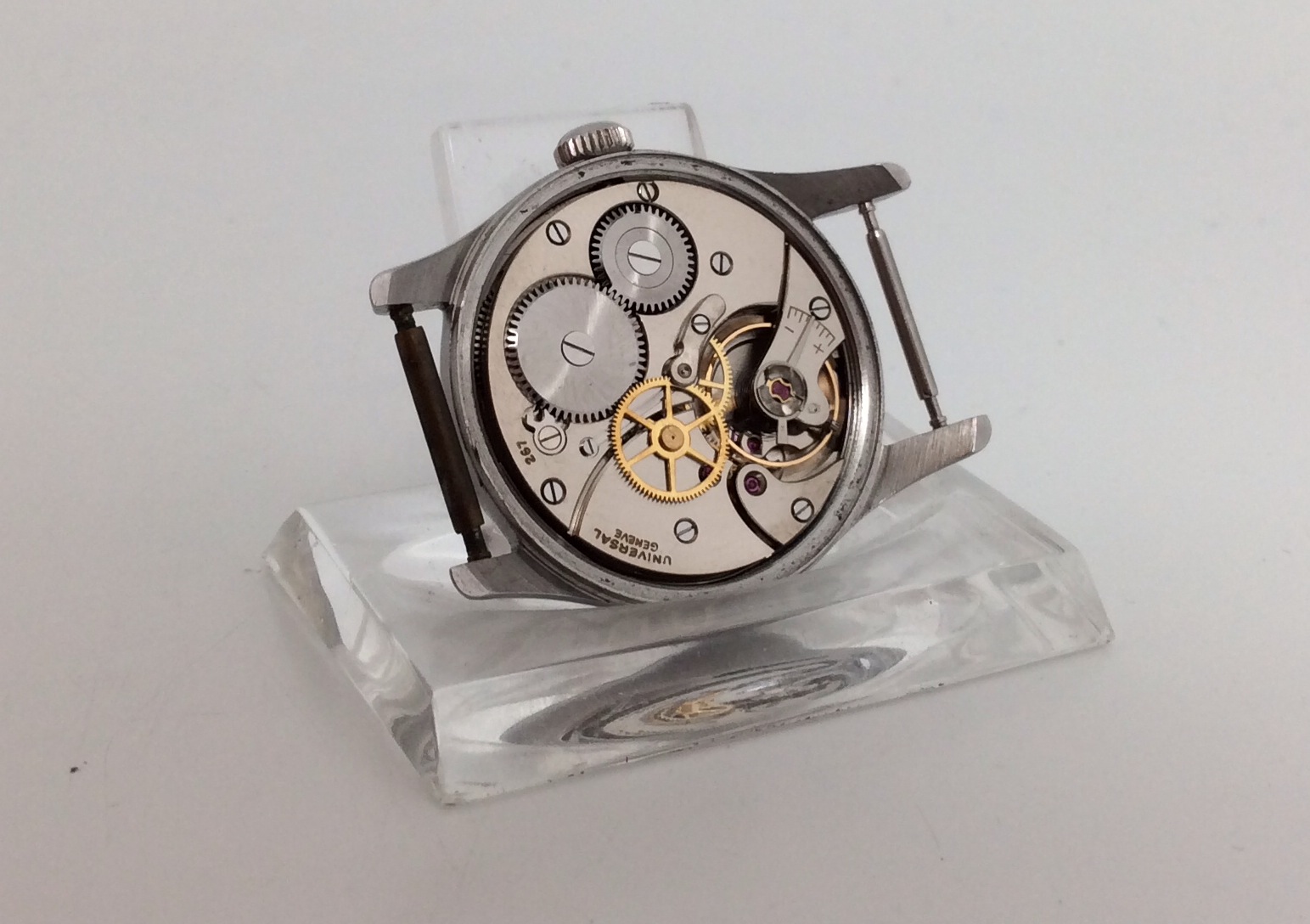

    Thanks for the input! I have a picture of the movement attached here. Thoughts appreciated. Can you send me a photo of one of those NOS pigskins?

    Looks like an unusually clean and nice example all around. I'd be careful about one thing: does the represented diameter include, or exclude the crown?

    Also, the dealer states this is a 17 jewel manual-wind movement. Curiously, the movement doesn't have any indication of that -- I've seen several caliber 267's - some have engraved 17-jewel, 15-jewel, and some without any markings at all. This has no markings. This one also doesn't have the word "Swiss". Any thoughts?
  7. Tony C. Ωf Jury member Jan 23, 2014
    7,387
    24,227
    In cases such as this one, my advice is to rely on Occam's Razor. The condition of the movement, while very clean, doesn't seem to be inconsistent with that of the rest of the watch. Also, it would hardly be worthwhile to piece together a marriage of a relatively inexpensive watch like this, unless the seller was in a third-world country. Assuming that the case back is in similarly good condition, I'd assume that it is a very well-preserved, original example.
    Also, the cal. 267 was a UG workhorse caliber, and came in many different variations, including what was or was not etched into the plates. That movement is certainly correct for the type of watch, in any case.

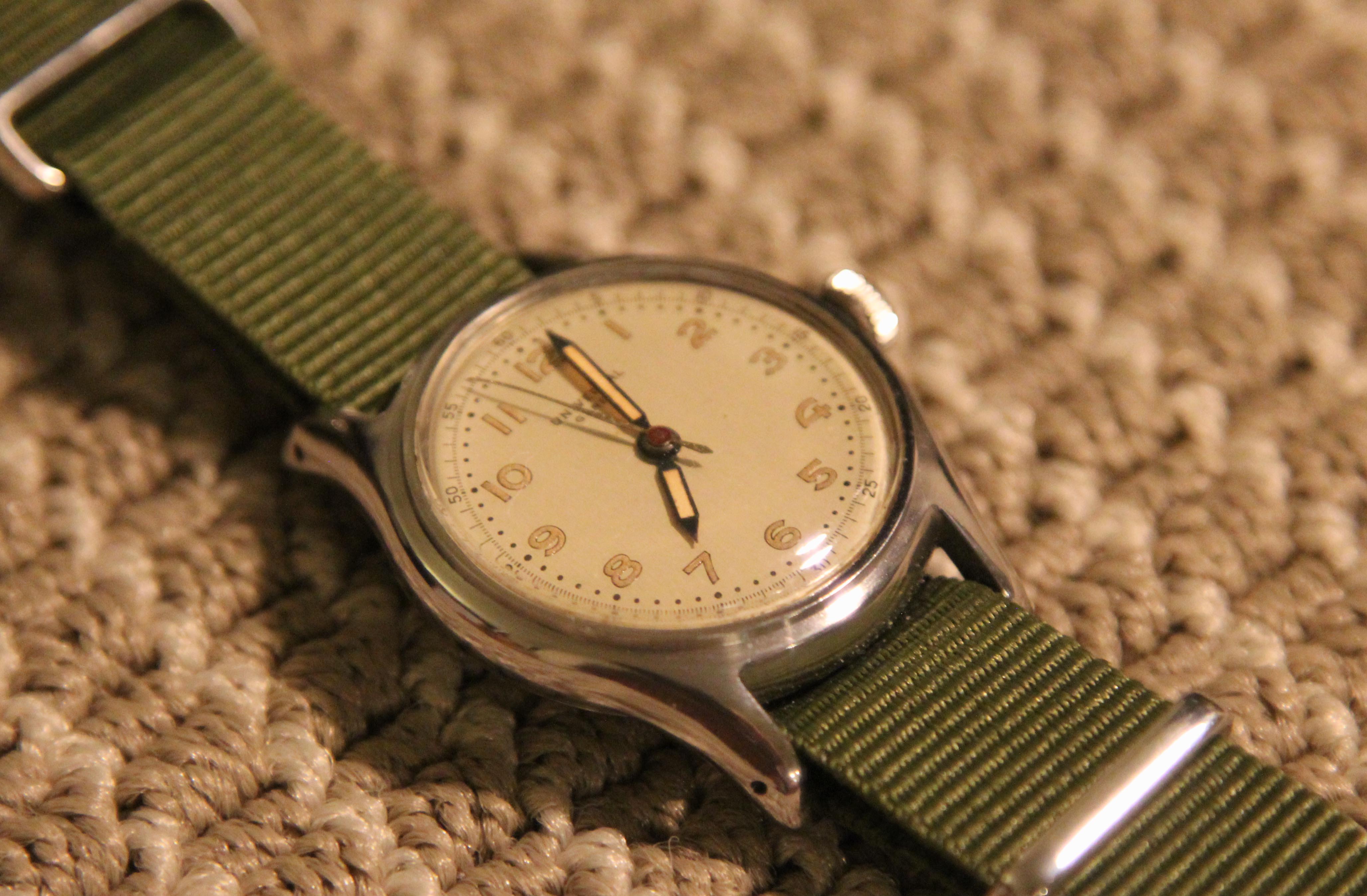

  11. eustace Feb 5, 2014
    95
    39
    Gentlemen, I am more than happy to oblige.

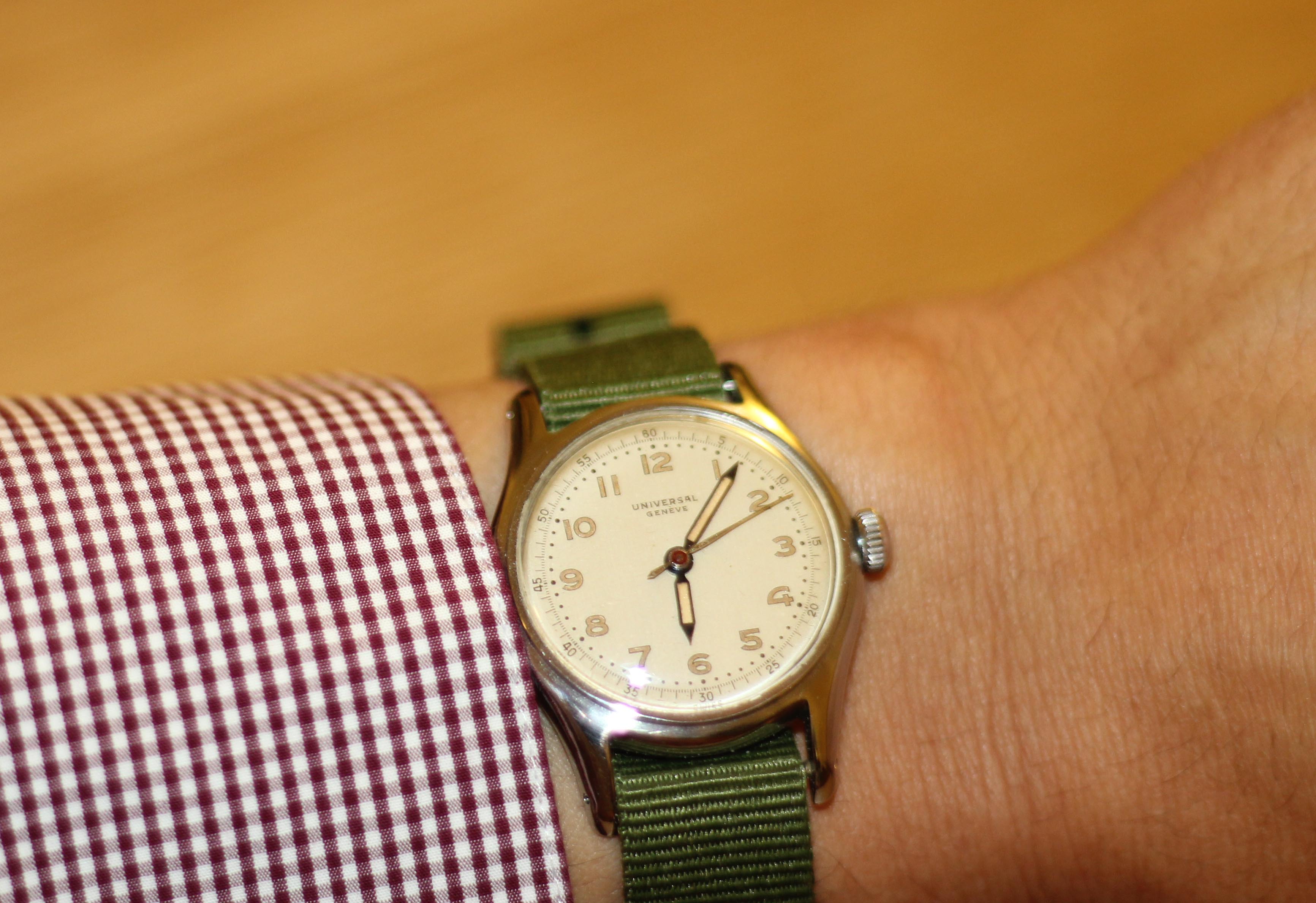

  12. JimInOz Melbourne Australia Feb 5, 2014
    15,492
    32,385
    Looks much better on the wrist :thumbsup:

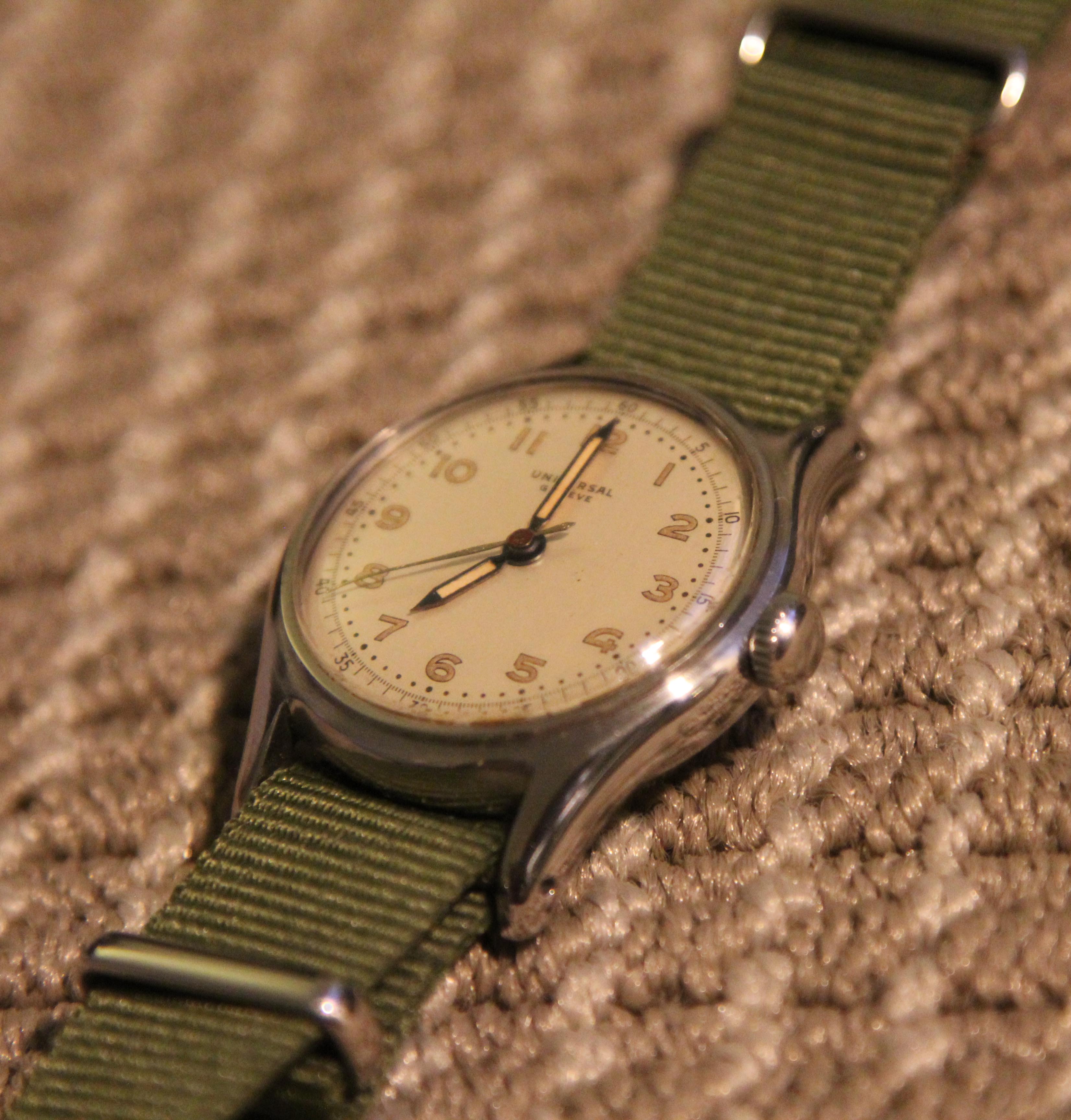

    some more photos

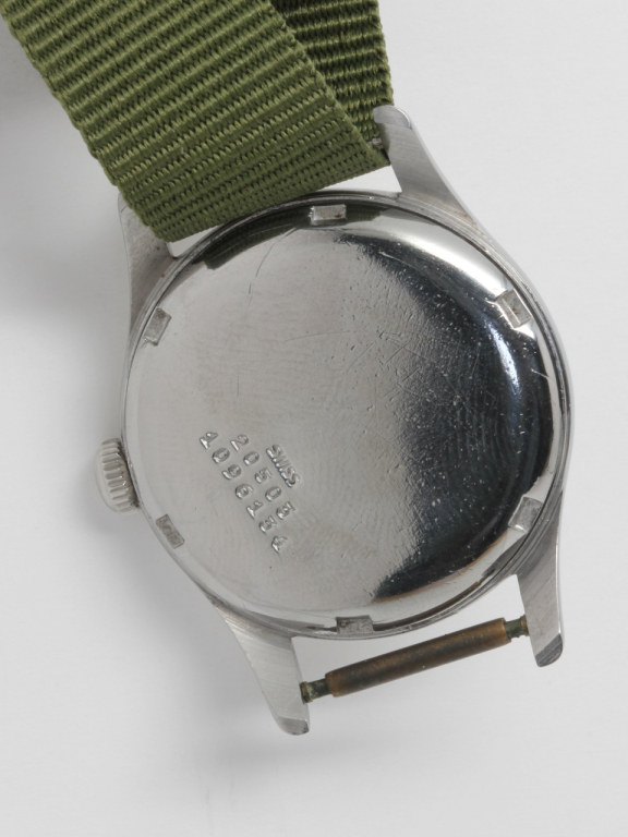

    That might be the cleanest version of that watch that I've ever seen. That case looks a lot like a Zenith Pilot case, and its the same size. What's on the back?

    LouS - it does seem to bear a striking resemblance. The caseback:
  18. LouS Mrs Nataf's Other Son Staff Member Feb 10, 2014
    6,713
    18,260
    interesting - 6-notch screwback. I'd wager it's the same casemaker. OK, this one's on my list.
