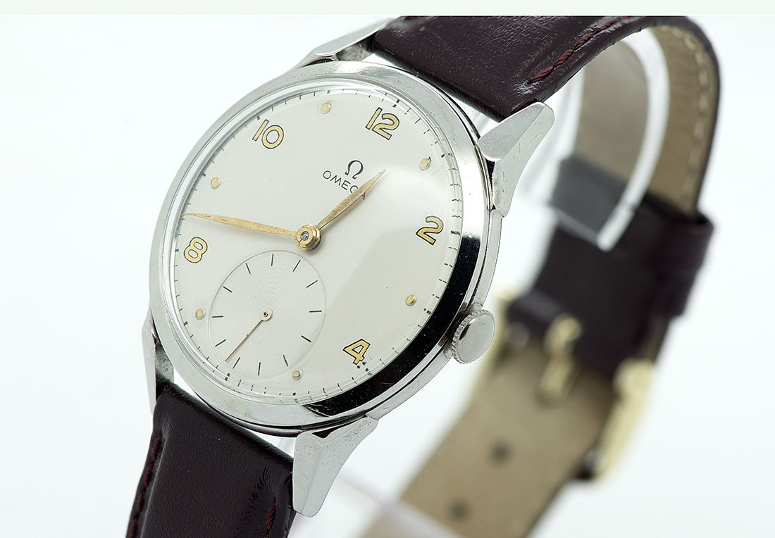

  1. prostie1200 Apr 6, 2014
    282
    232
    Using a Nikon 105 on a rail took 12 photographs with12 different focal points then merged and stacked them to get this final image

  3. woodwkr2 Apr 6, 2014
    1,366
    820
    How do you pull off the stacking trick? Is that a photoshop plugin or skill I haven't discovered?
    Beautiful shot! That could end up in any commercial catalog and look excellent.
    Light box?
  4. prostie1200 Apr 6, 2014
    282
    232
    Hi woodwkr2
    No trick quite simple really - yes for convenience I do use a light box just to temper the light, but the processing is part of PSCS 5-6.
    Take maybe up to 12 shots from a firm fixed tripod - use manual focus on say the Crown then slowly advance the focal point a couple of millimeters and so on taking each shot in sequence
    Then read this it explains it better than I could
    http://photography.tutsplus.com/articles/focus-stacking-made-easy-with-photoshop--photo-12621
    Follow the instructions and hey presto you have a complete infocus shot across the face.
    It will also work vertically taking a complete movement from top plate to bottom
    Have a go

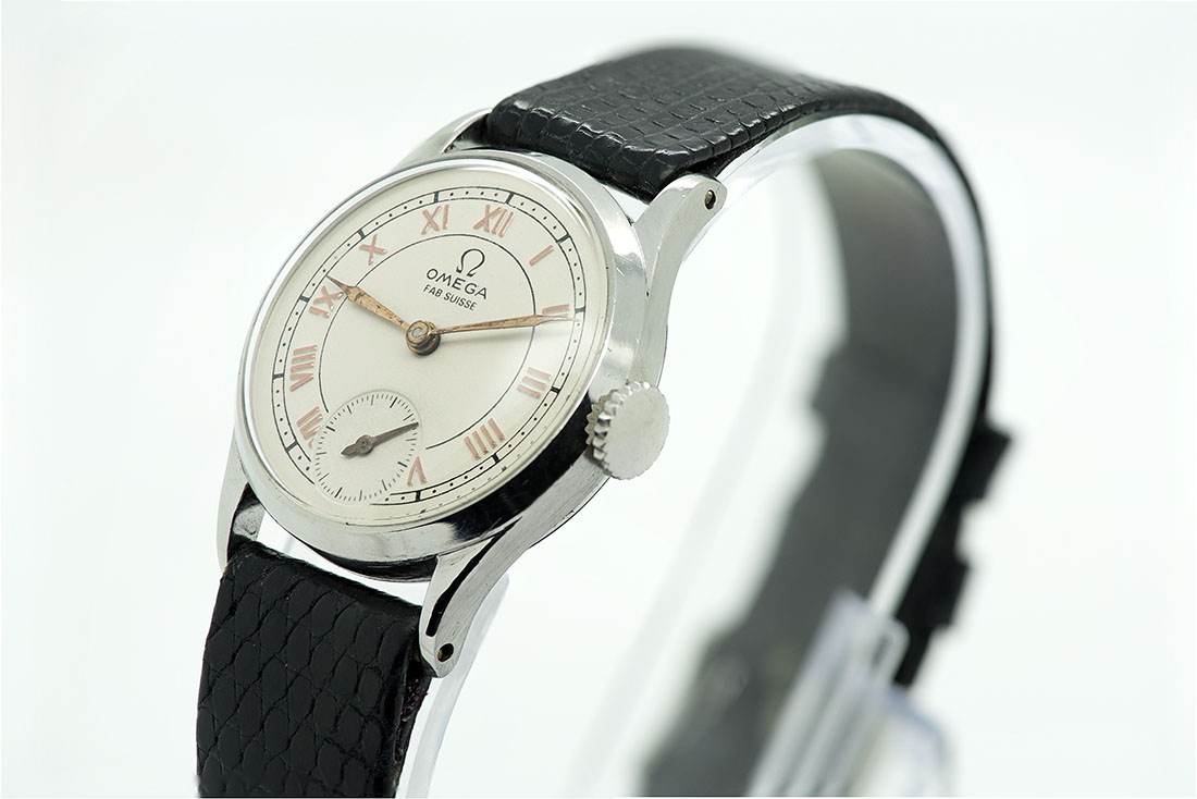

  6. prostie1200 Apr 6, 2014
    282
    232
    I do not believe there is any need for Pro tackle my rails are Chinese and only cost £23 including postage after all you only need to advance the focus by a couple of millimeters each shot and provided you tripod is substantial all should be well,
    Here is a stack I have just taken of a Jumbo 30T2 keeping the camera steady on the tripod and gently adjusting the focus on the ring by hand.
