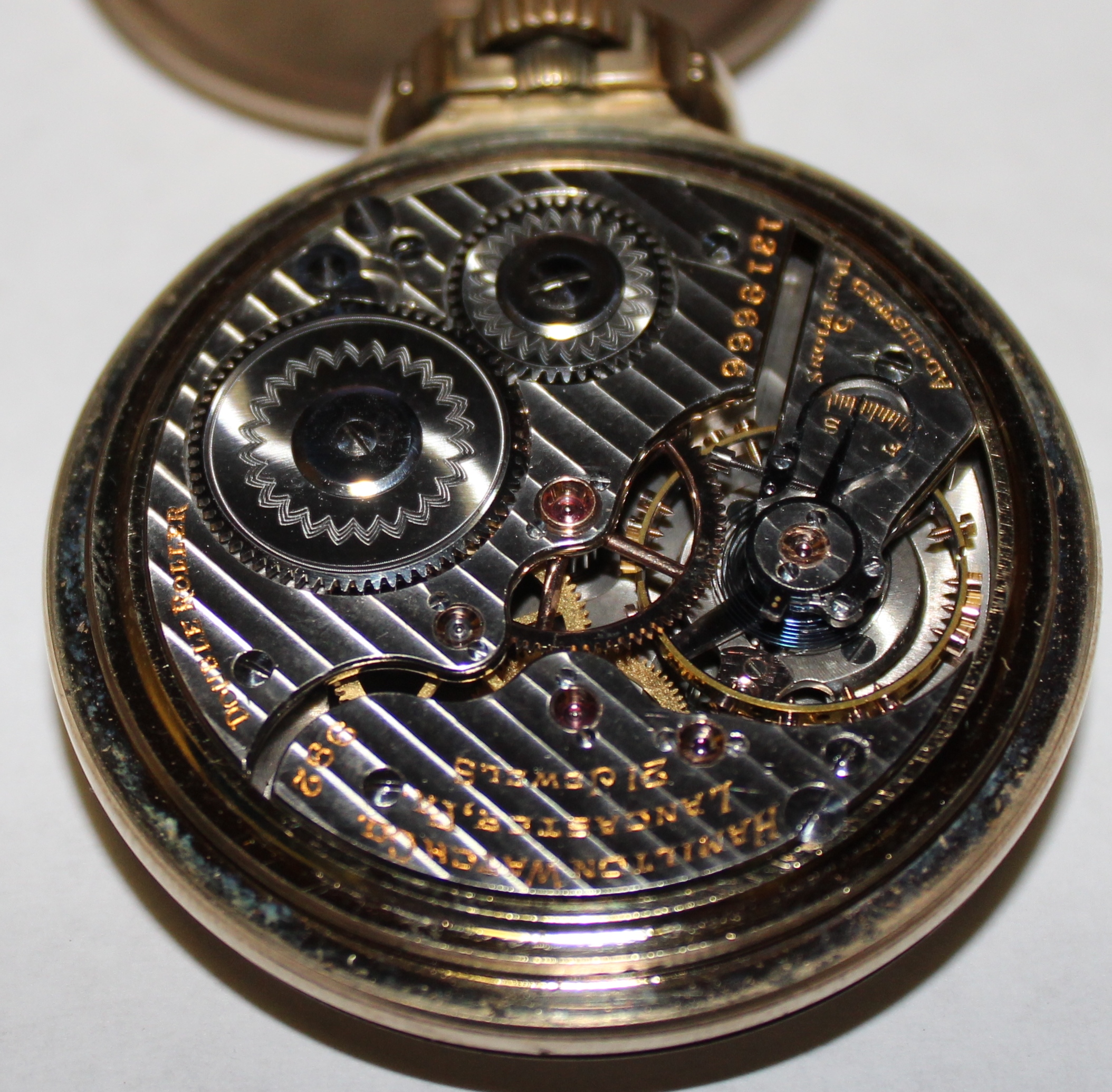

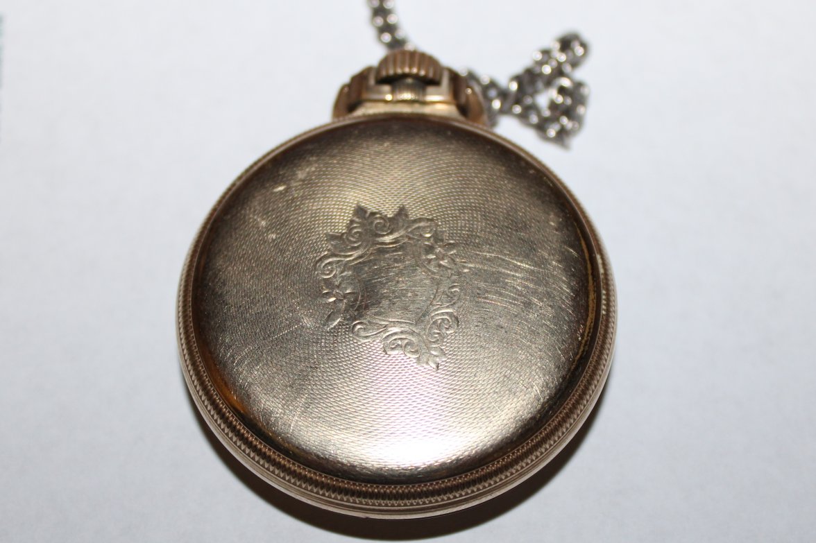

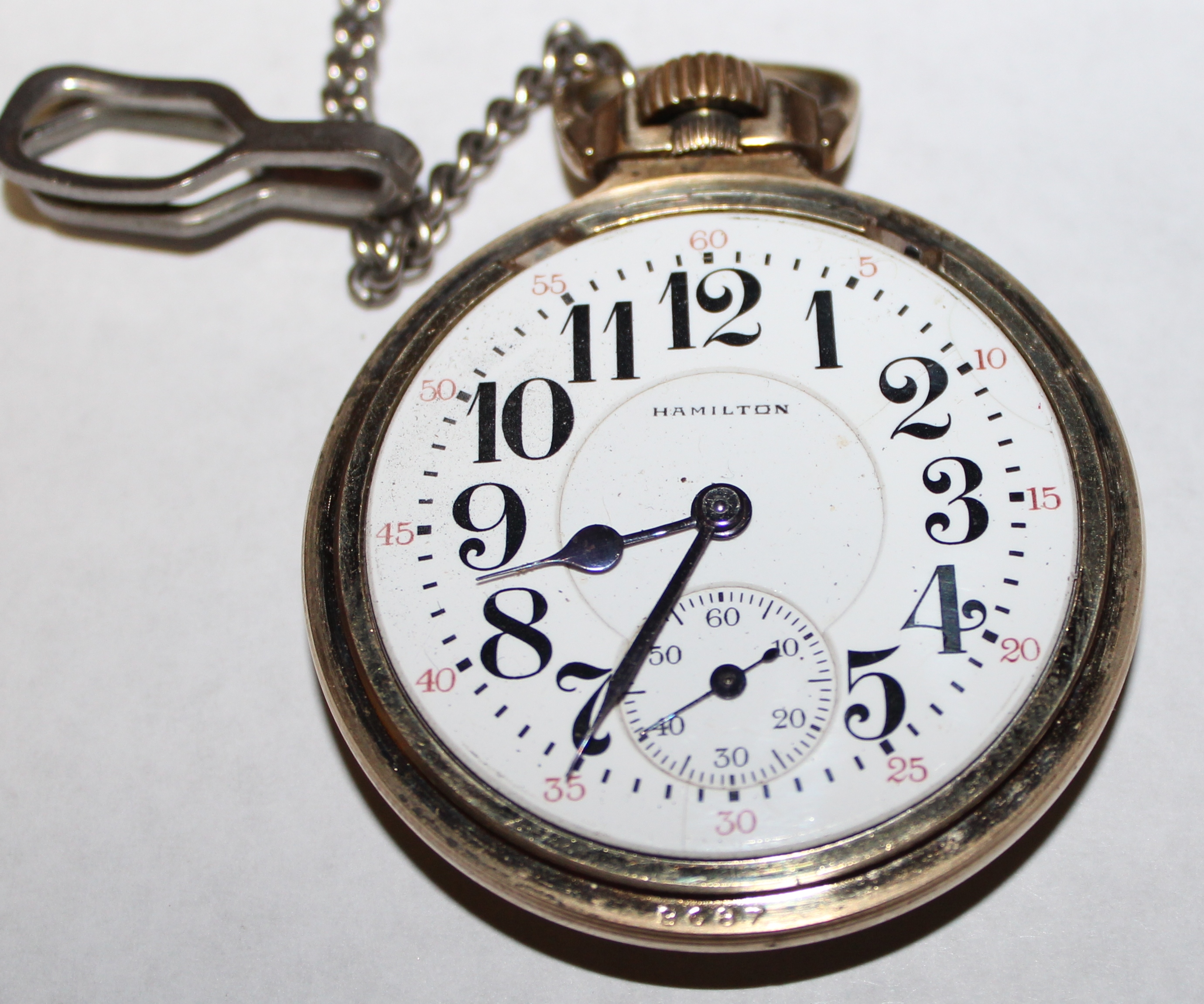

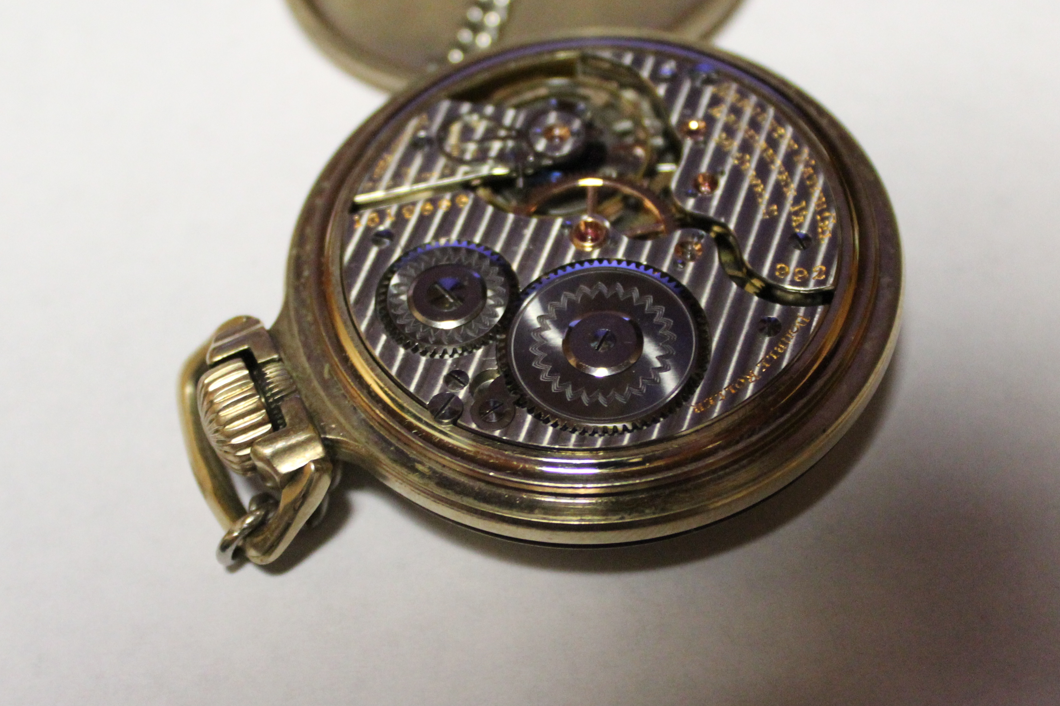

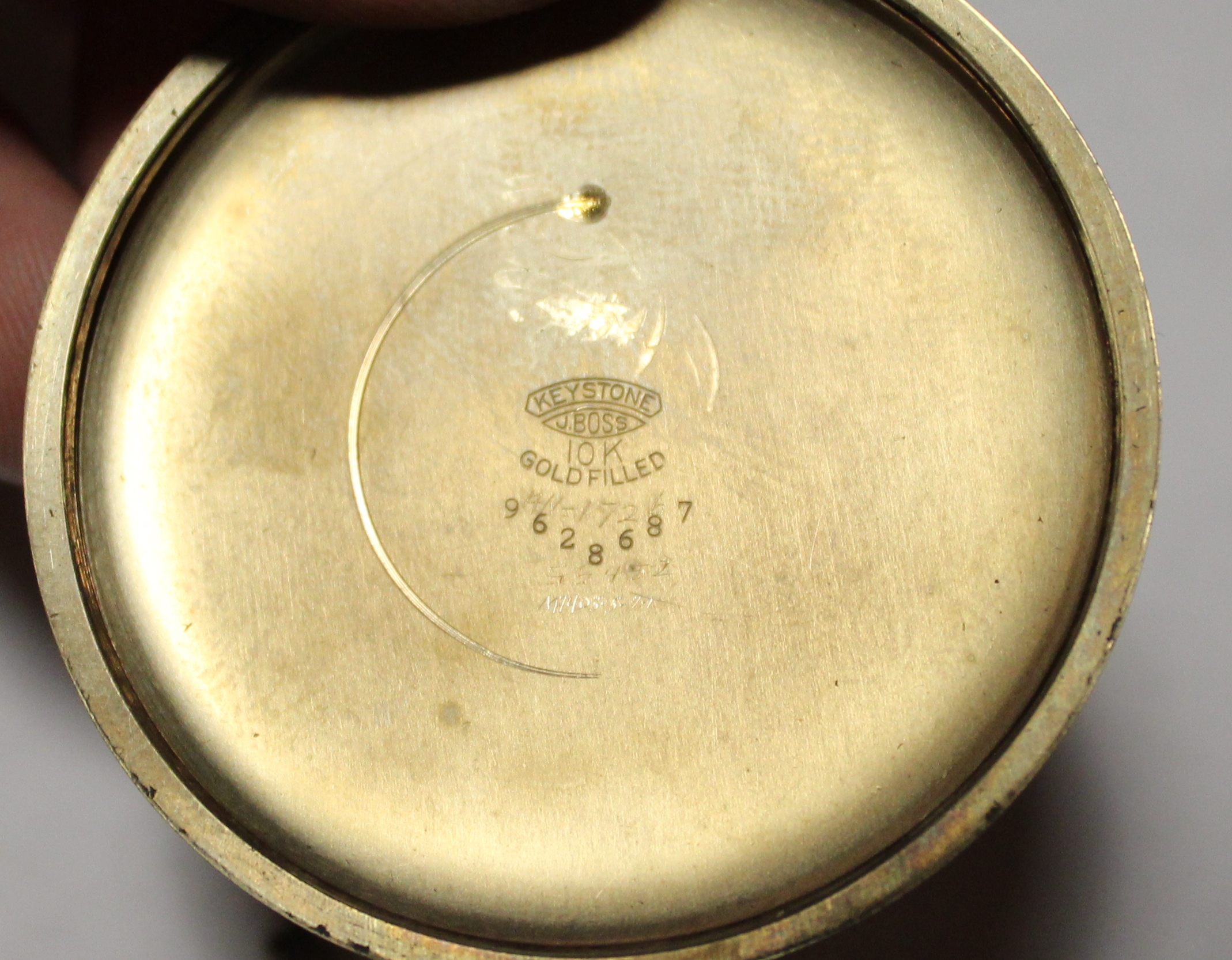

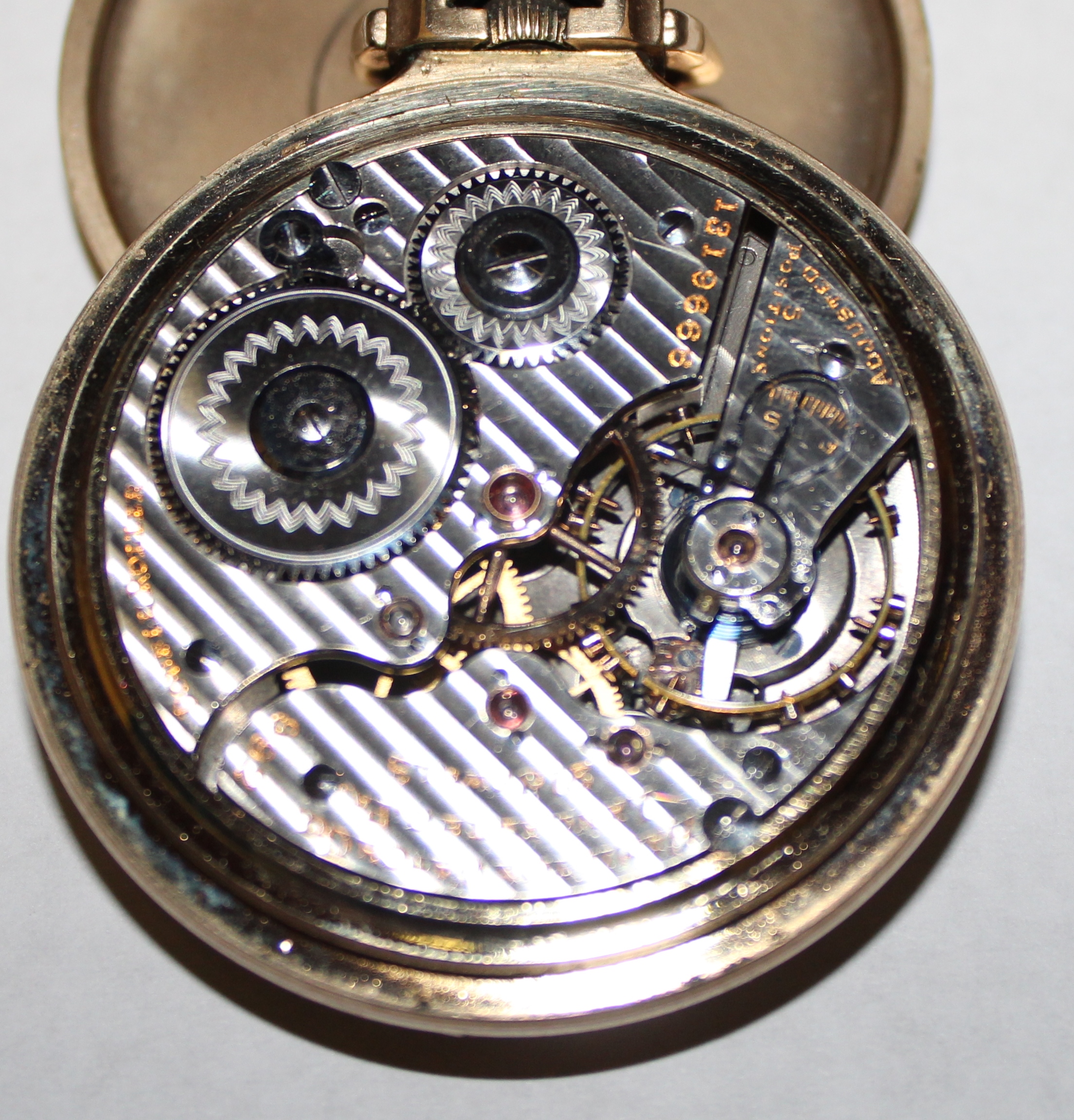

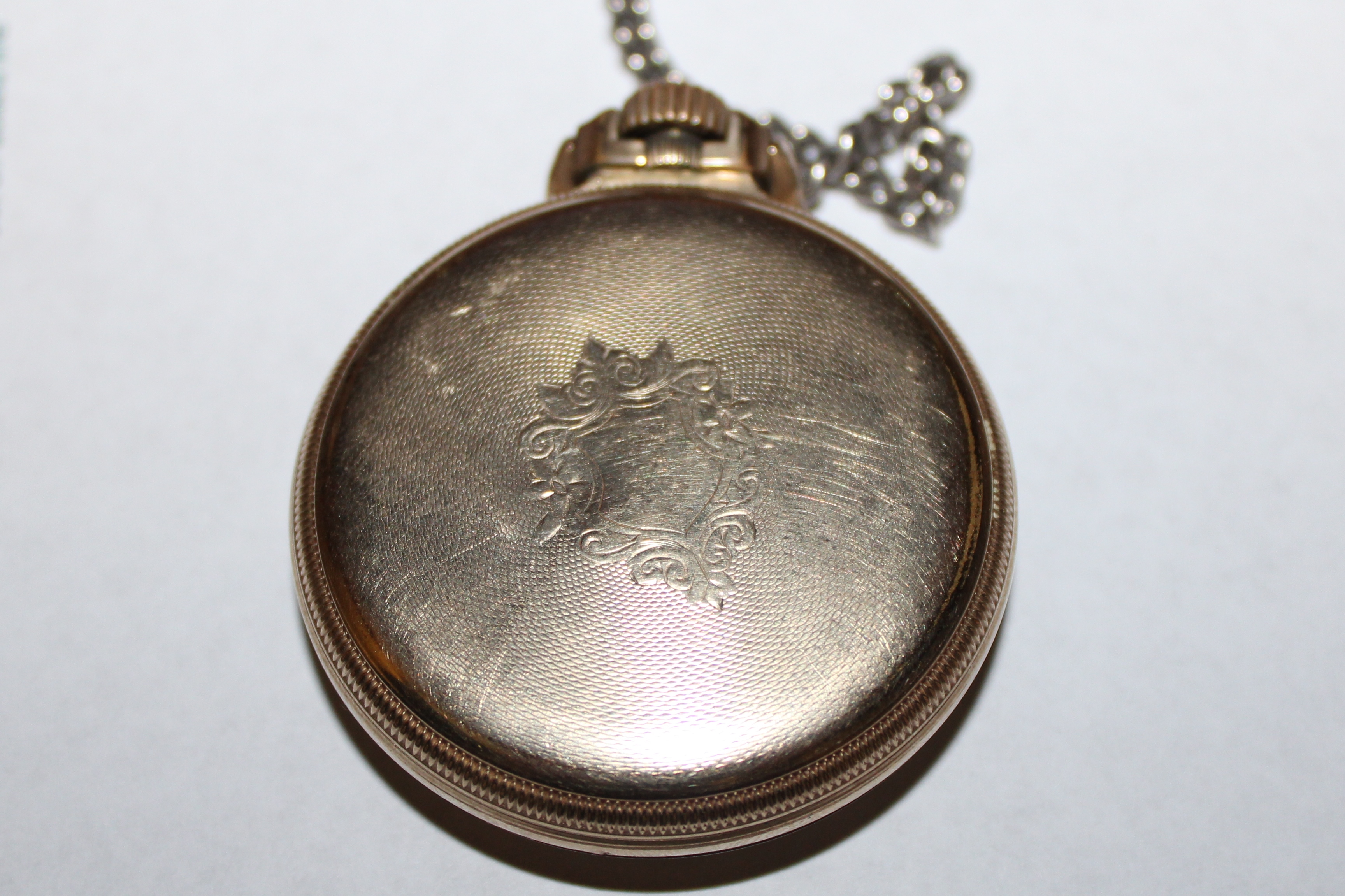

    Need help identifying this watch. Works great looks like it has been professional serviced and repaired on the back cover.It has a bunch of etchings hard to see with the naked eye but they say An=17267, 55452, AF403-5-7-1. Also says 992 21 jewel 5 position 1319666 watch 001.JPG watch 004.JPG watch 005.JPG watch 006.JPG watch 007.JPG watch 008.JPG

  3. Fritz genuflects before the mighty quartzophobe Dec 20, 2014
    3,817
    15,990
    Serial 1319666 is a 992L, 2nd model, production of this variation started in 1914, the block of serial numbers this piece falls into left the finishing department Aug.16/1918. One of the best railway watches ever, Hamilton made 438,213 of these before it was replaced by the 992B.
    Double sunk dial and a gold center wheel too, a nice piece! That watch was designed to run inside 30 seconds a week for years, I bet if still will with a bit of care.
