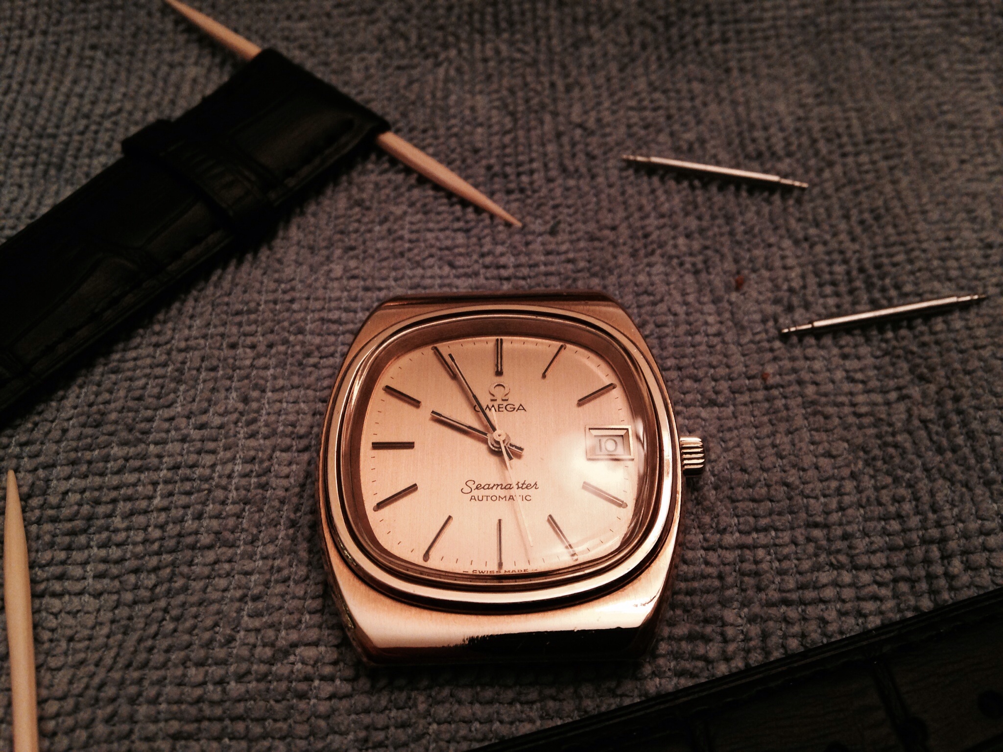

  7. citizenrich Metal Mixer! Mar 3, 2015
    2,617
    5,515
    I use toothpicks to solve your dilemma...

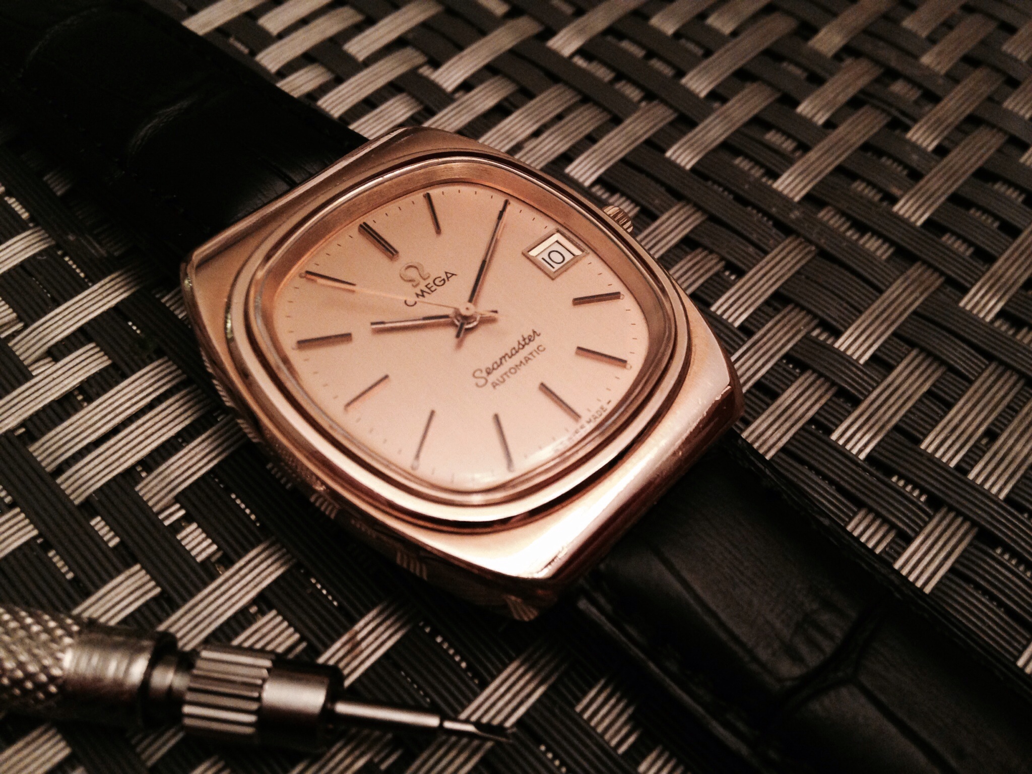

  9. eustace Mar 5, 2015
    95
    39
    @woodwkr2 - 18mm.
    I tried the toothpicks trick. Worked like a charm...thanks guys!
