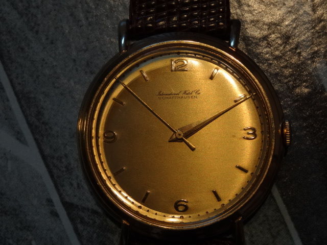

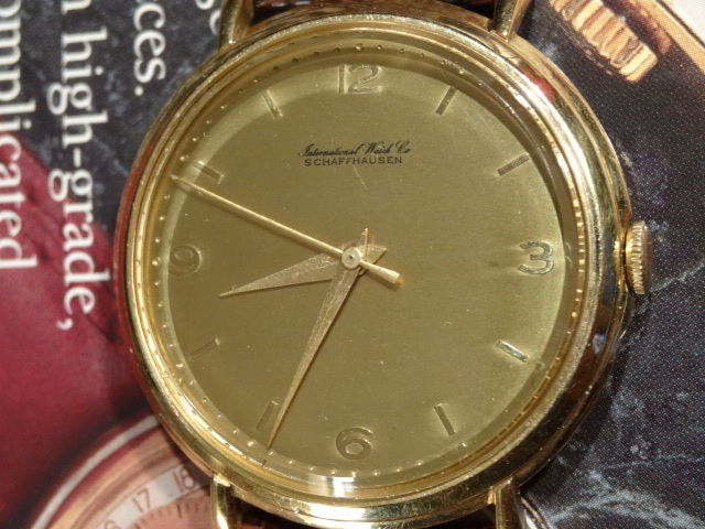

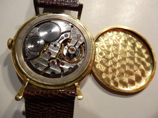

    Hi guys, what are your thoughts on the following watch? Movement and case numbers date it to around the early 50s, but I'm not come across such a combination of dial and hands. Could it be a franken?

    Case and movement look OK. It's the caliber 89, one of the best manual wind movements of the era.
    However, that's a horrible looking redial. Logo isn't even close.
    [​IMG]
    That's what this dial should look like. Also, I'm pretty sure the hands aren't right either.
    I'd say that it's time to move on...nothing to see here.
