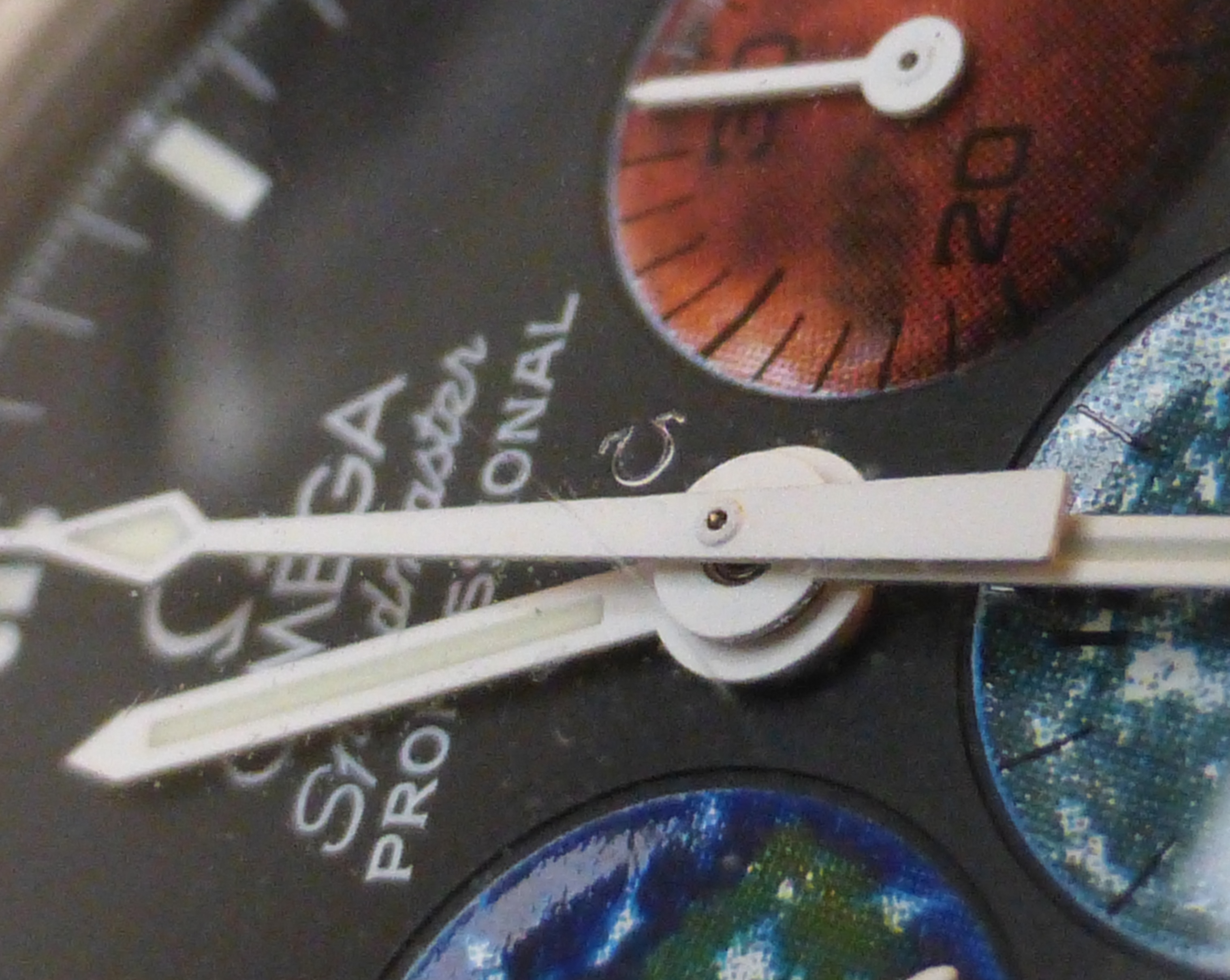

    At the moment I have three lenses for my Canon 600D
    Standard - Canon EFS 18-55mm
    Telephoto - Canon EFS 55-250mm
    Macro - Tamron SP 90mm F/2.8 Macro 1:1

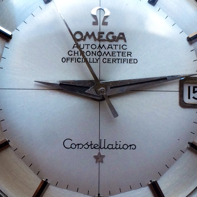

    I'm not all that happy with the "macro" lens, it doesn't seem to be able to really "macro" much more than my standard lens.
    Any suggestions from expert WIS photographers, something that suits watch photography?
    Here's a pic that I've cropped from the macro shot.
  2. blackwatch wants tickets to the HyperBole. Jan 28, 2014
    438
    178
    Use the smallest aperture available to get the greatest depth of field. Use a tripod. Supposedly longer macro lenses also increase the depth of field, so instead of a 90mm try 150mm. (?)

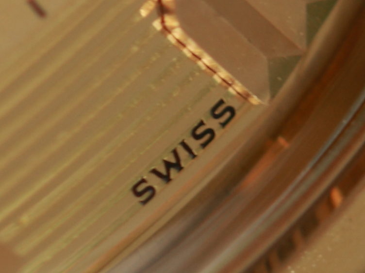

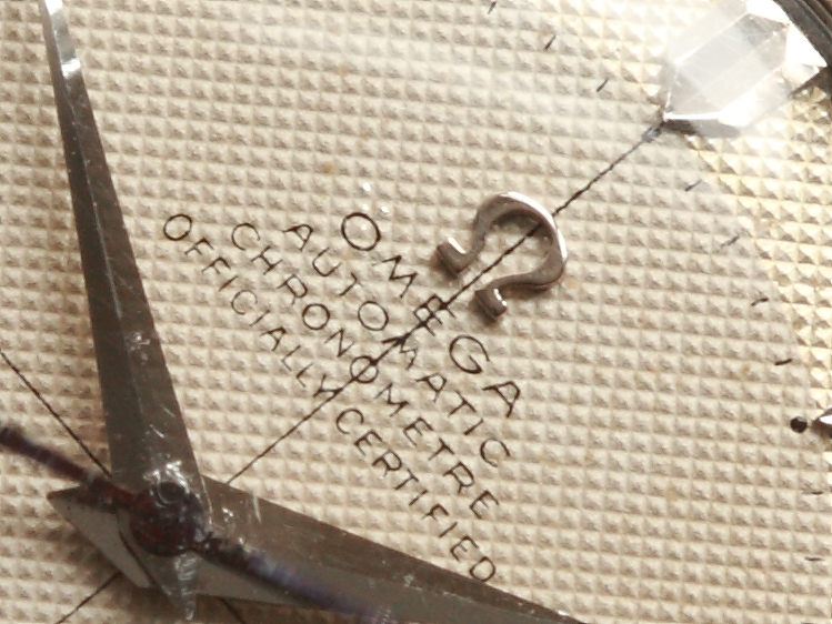

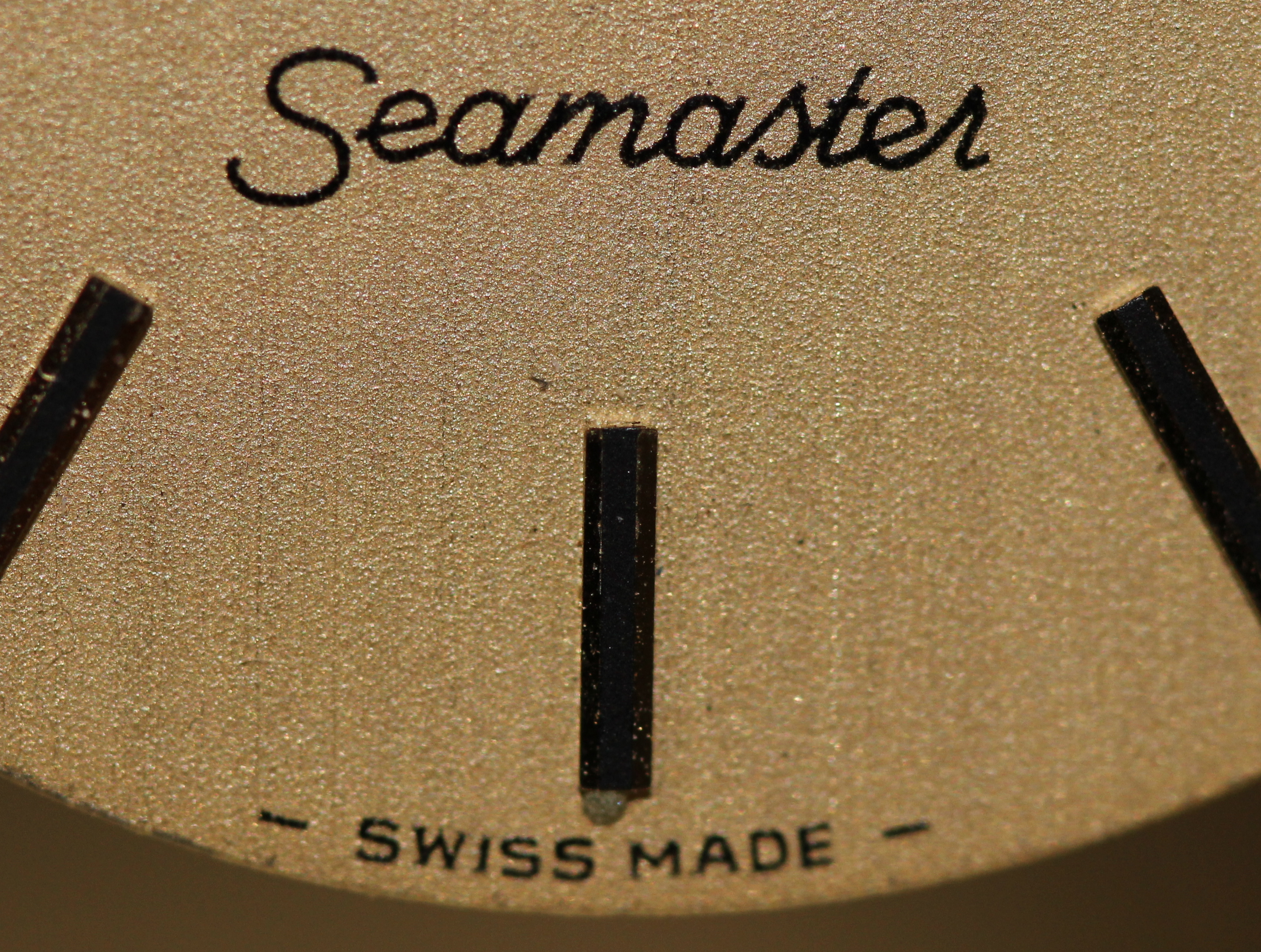

    I'm using a Canon EF100mm f/2.8 with my 400d and I'm happy with the results, I'm not super serious about it all and don't spend more that 2 minutes on my set up. I do however always use a tripod and have just bought a remote shutter release which has improved things image stability by 50%.
    Here's a couple:

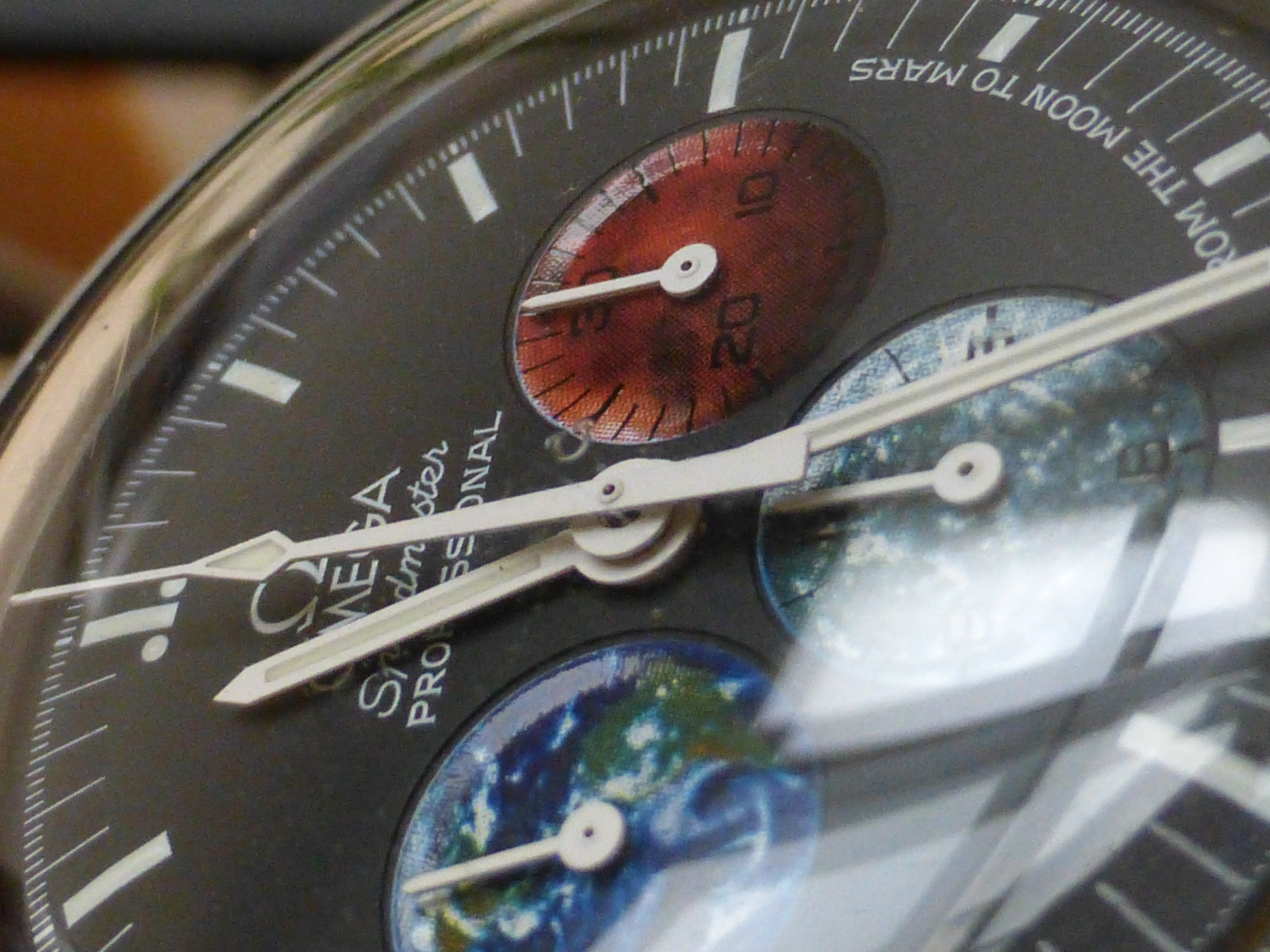

    26,992
    32,710
    I use a Nikon 105mm VR F/2.8, equivalent in Canon would be the EF 100mm F/2.8L
    I also bought a Nikon TC-17E II teleconverter which gives a 1.7X magnification on top of the 105VR, so it effectively makes it a 180mm marco with greater than 1:1 reproduction

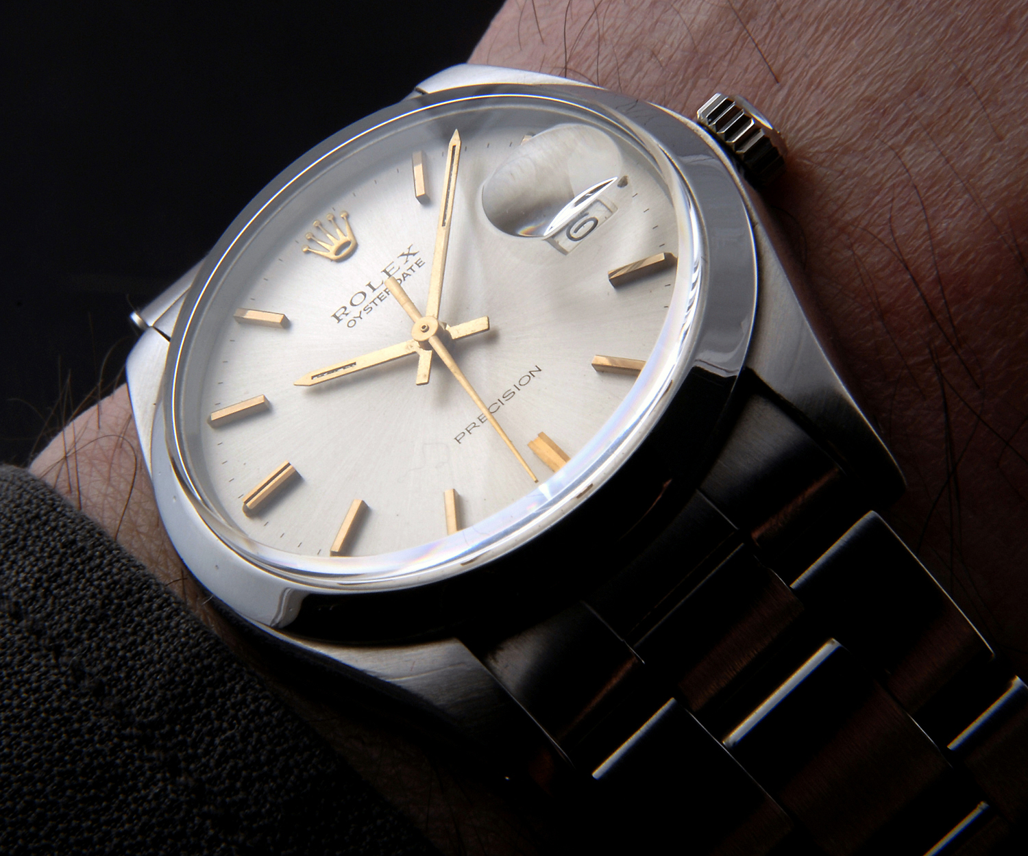

    However you might be surprised what a degree of patience, a bit of tracing paper, a sunny window, and a couple of white card reflectors, can achieve.
    Quick snap of an '82 Rolex Precision 6694, on a full 13 link 78350 bracelet. - This will be for sale, once I get round to shooting it properly
    Wuza72 likes this.
  9. alam Jan 29, 2014
    8,095
    18,682
    ...and what about the camera/lens set up for this shot? Nice watch BTW!

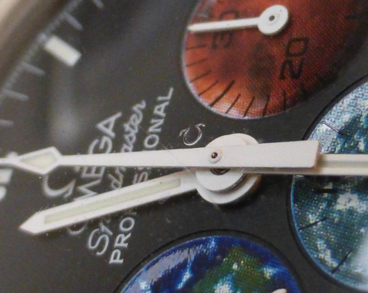

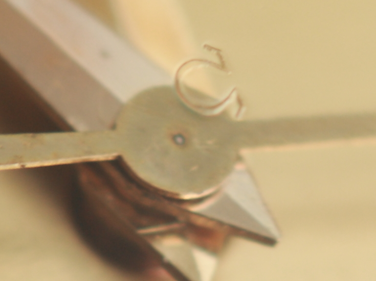

    I bit the bullet and returned the Tamron in exchange for a Canon MP-E 65mm ƒ/2.8 1-5X.
    I now think I have close-up and extreme close-up under control.
    A few quick snaps with the Canon MP-E are amazing. This is the balance jewel in a Tissot ladies movement, about 2mm ø
    [​IMG]
