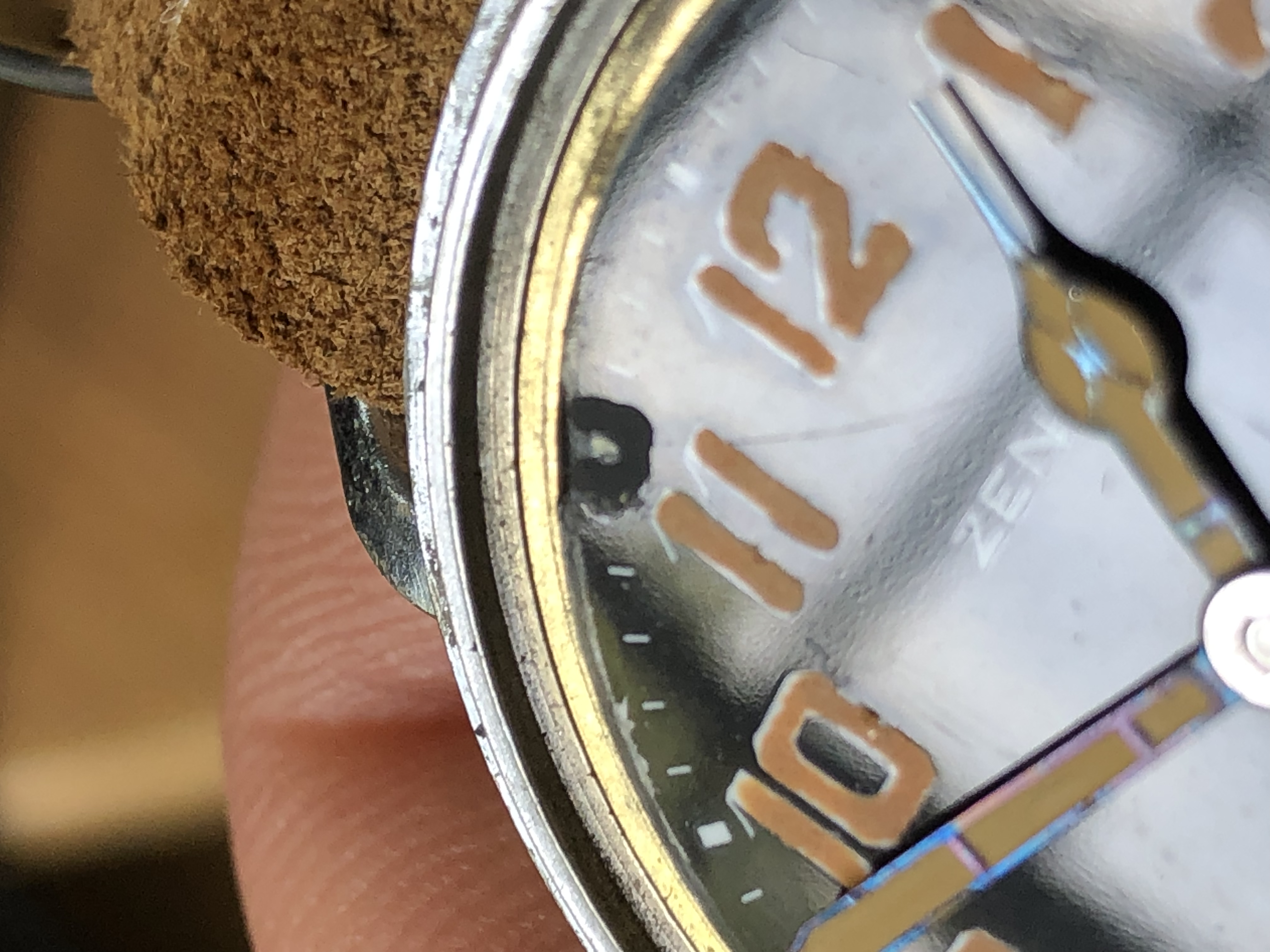

I’m no expert on this model whatsoever but surely the ‘Special’ text is not correct and the dial has been refinished

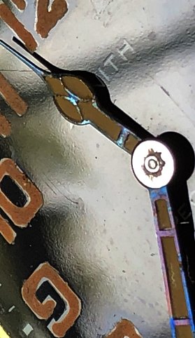

Update: I have removed the paint with a toothpick and a tiny vacuum cleaner. Definitely not radium - no burn at all on surrounding area.

In this case it was pretty clearly just some modern paint. But in general, if you think there might be radium, even underneath, it's best to check with a Geiger counter.

I'm going to go against the grain on this thread and say that the dial is original and that only the "lume" was redone. I say this because refinishing a vitreous enamel dial is nigh on impossible. Enamel dials are not simply painted. They are painted with colored powered glass enamels and then cured in an oven, creating a hard glass like surface. Yours also shows a small repair at the 11:00 mark.

12,905
Look at the hairline that is radiating outward from the 11:00, where there is a chip. I'm assuming that a dial foot is on the other side and it was over tightened. It's a common way for enamel dials to be damaged.

I'm certain it is enamel now. Yes. So many of these ones in particular have the same crack forming in the same place. The same thing also tragically seems to happen with a number of lovely old trench watches I've seen online. Impossible to restore. Most are invisible to the naked eye after a good clean. I don't have any tools to loosen it. My biggest priority was finding an upper bezel (if this was indeed a model that required one).

Just FYI, tightening the dial screw is not the root cause in these cases. It’s likely that the dial foot was bent an tightening the screw then caused a deflection of the dial. It’s the bent foot that is the problem, as dial feet screws need to be tight...I find them backed out, loose or missing quite often.
Thanks for the clarification. I've always just snugged the screws on my dial feet down because I believed that simply over tightening them would crack a dial.

worst enamelling I have ever seen (if enameled)
