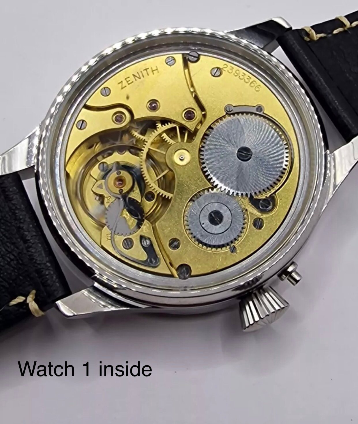

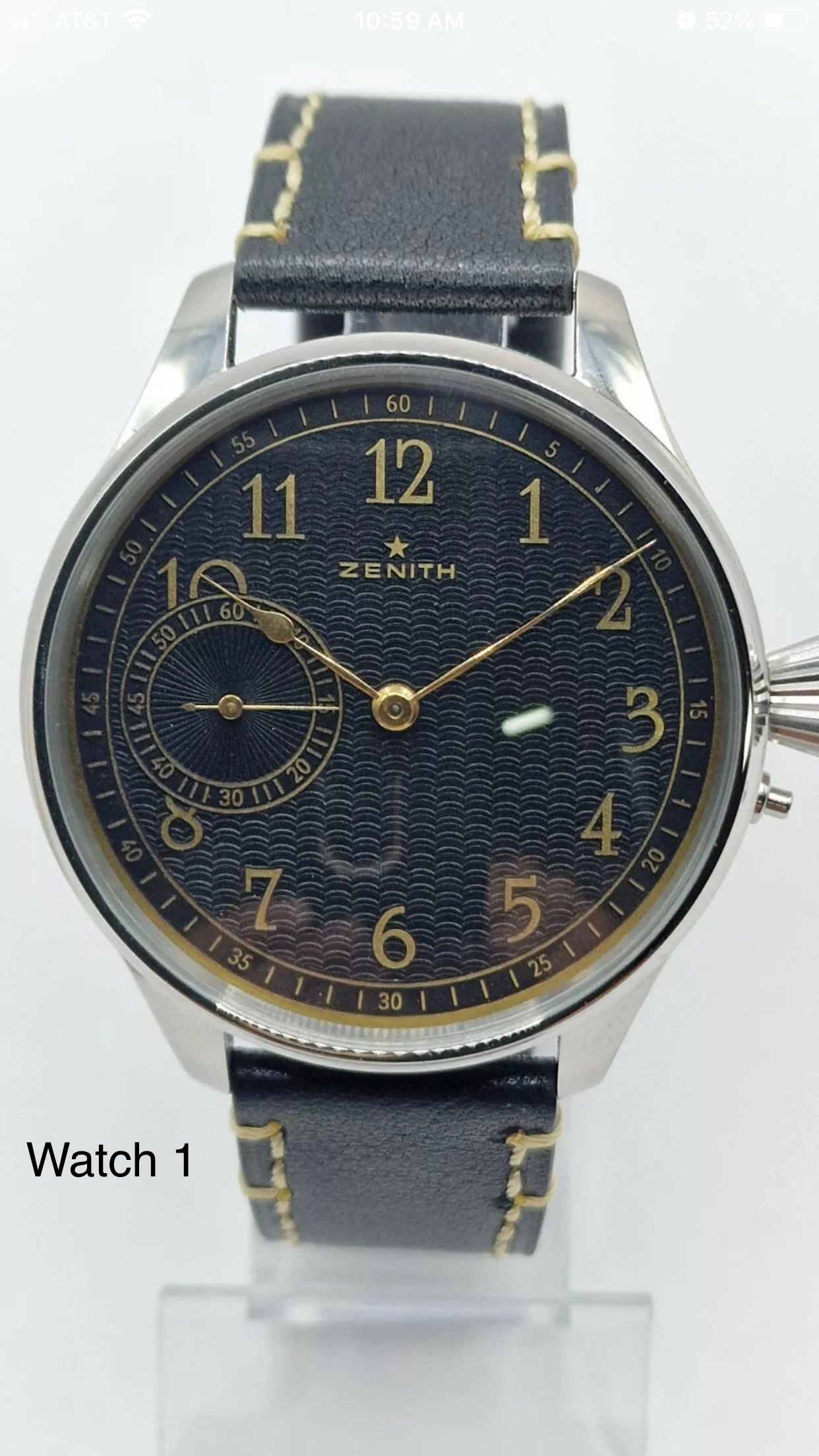

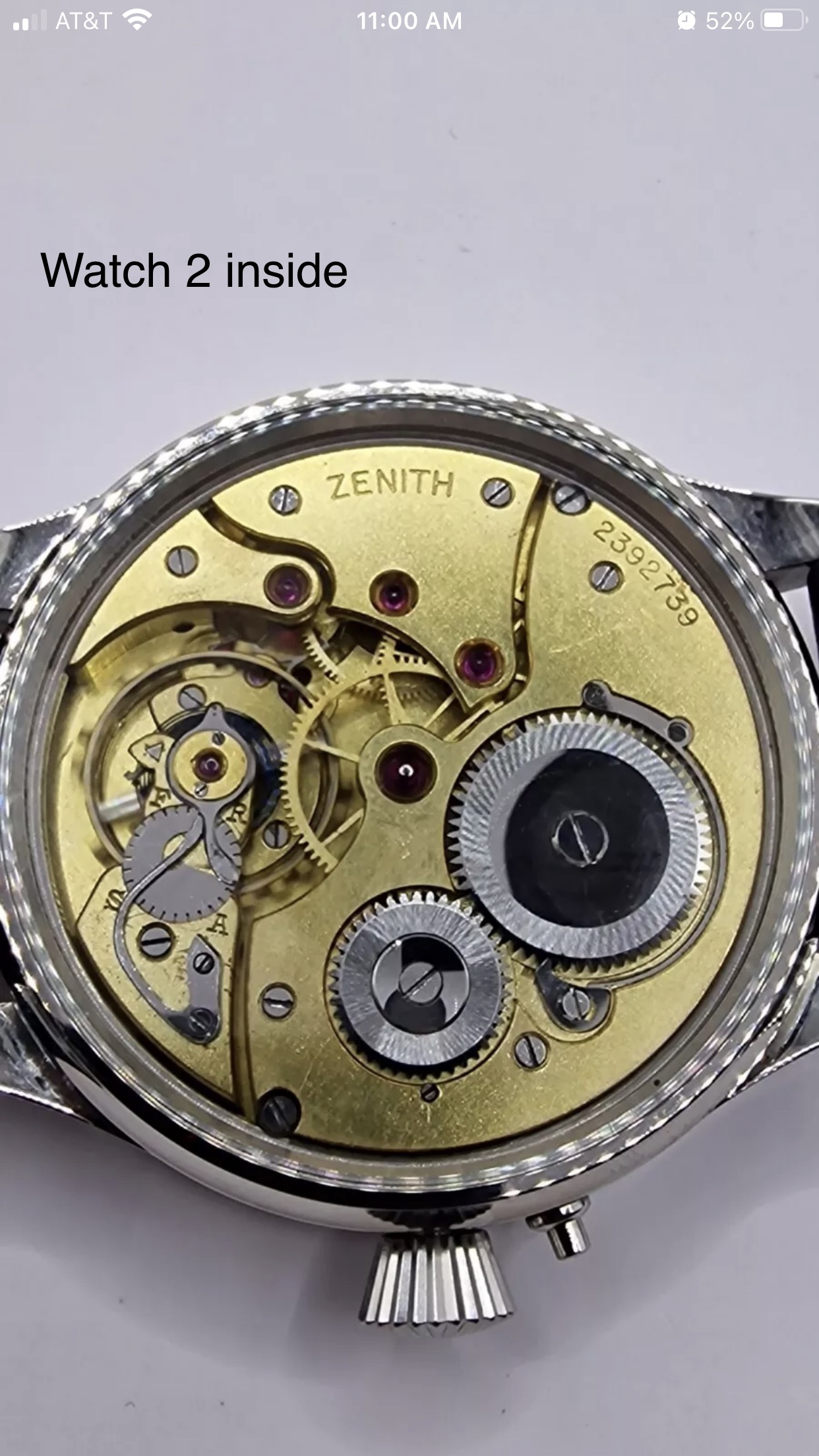

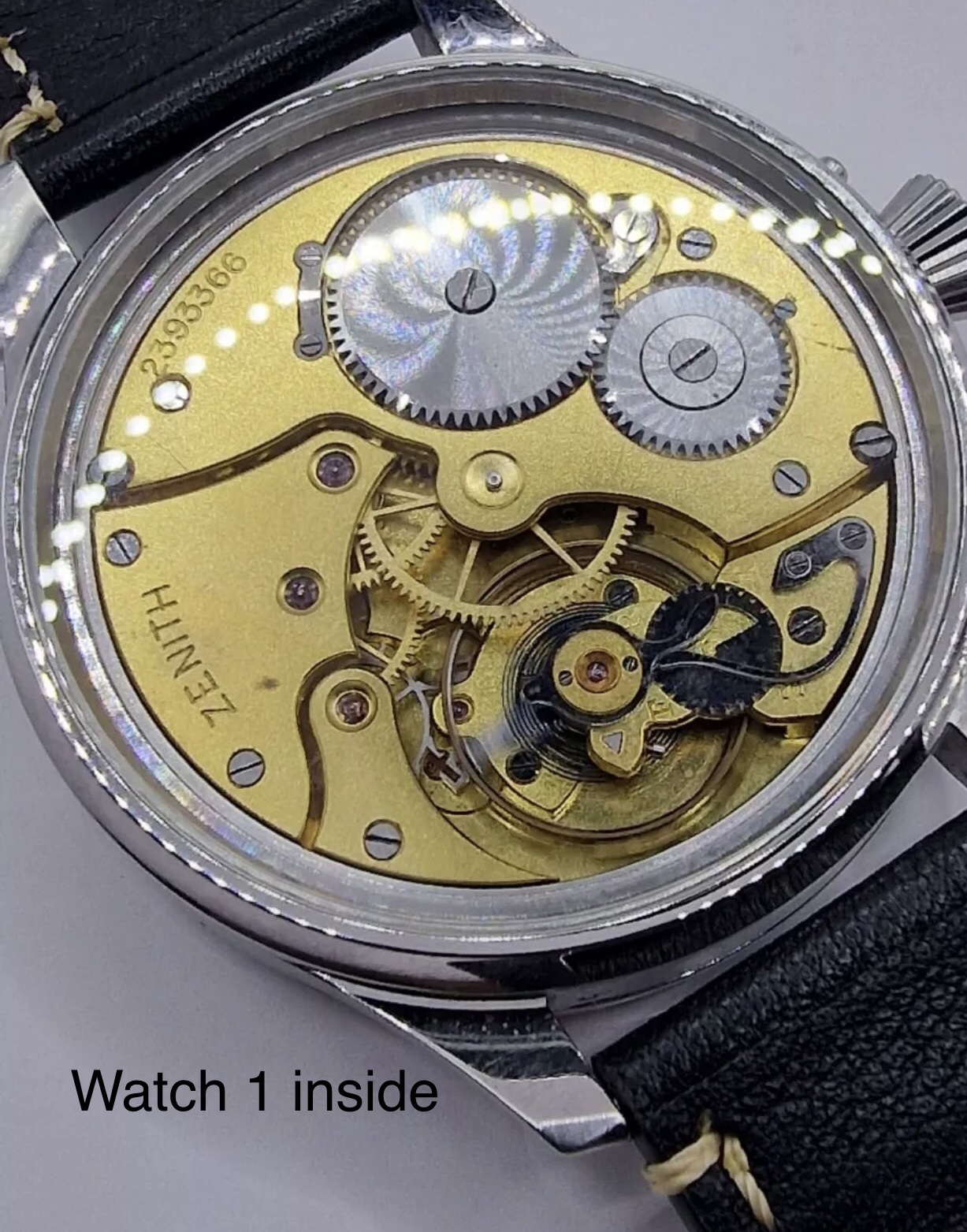

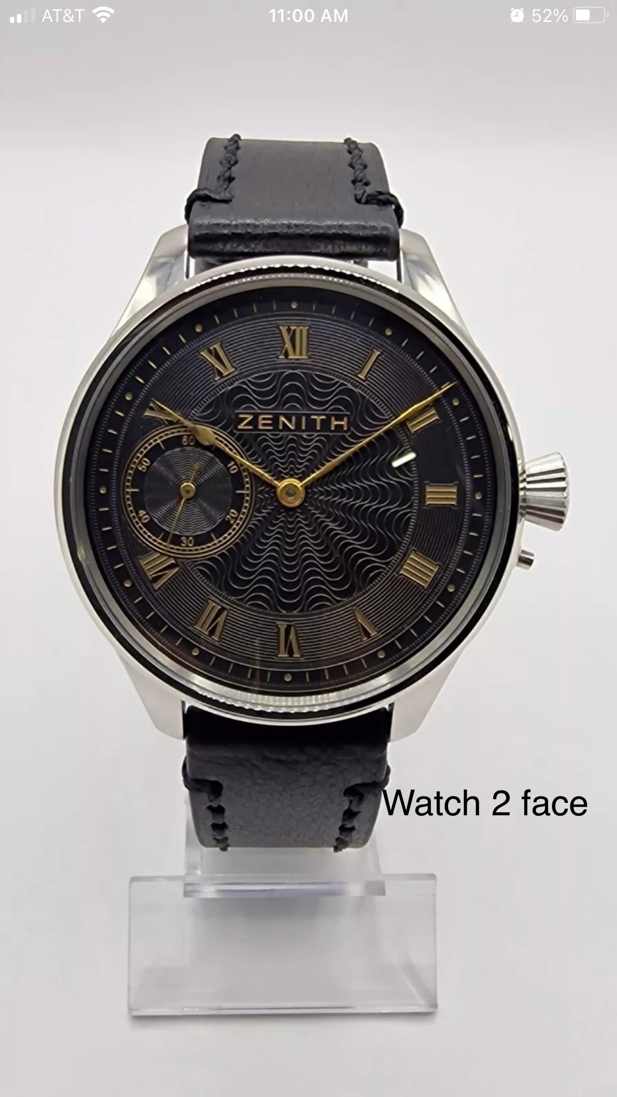

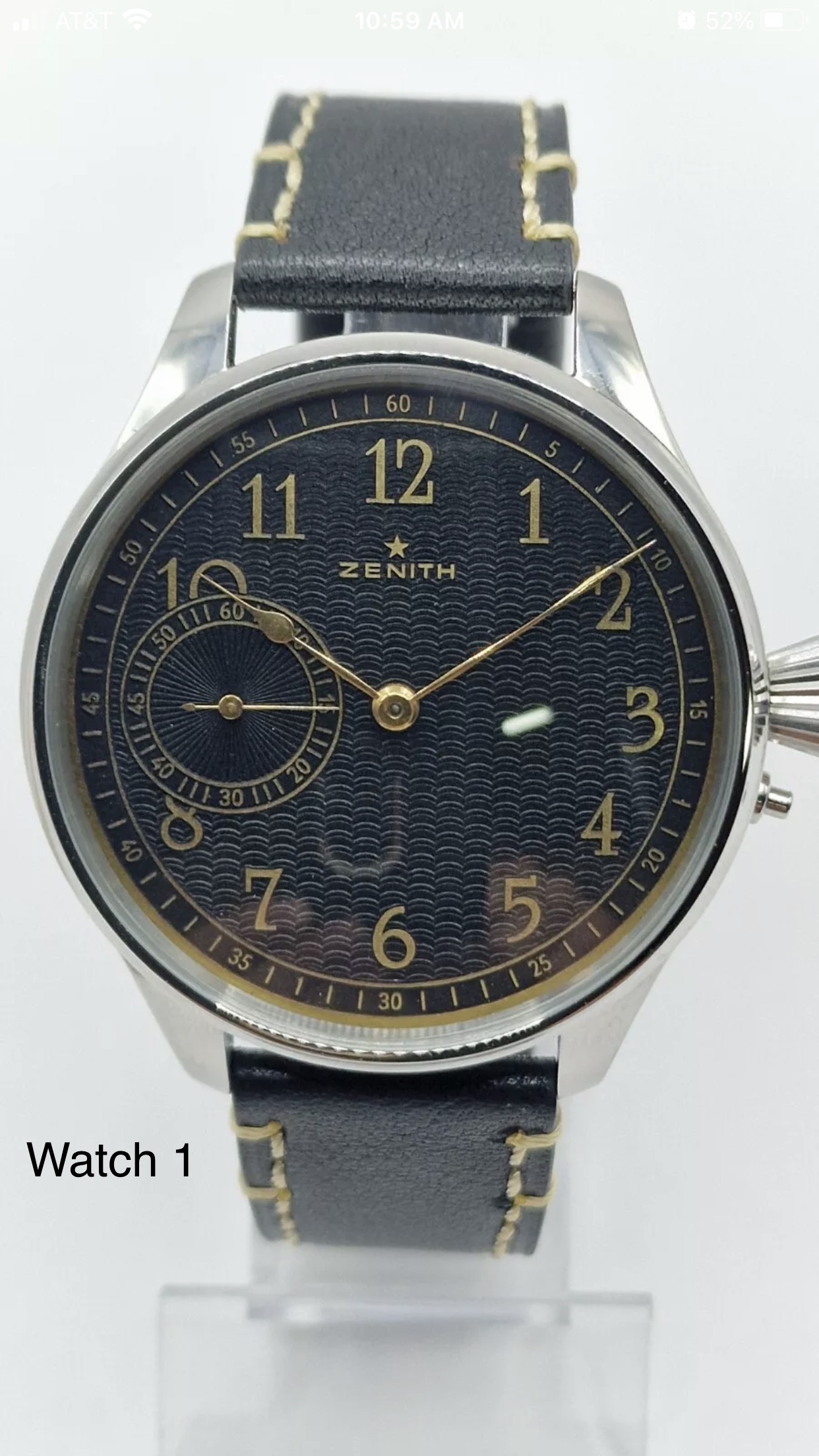

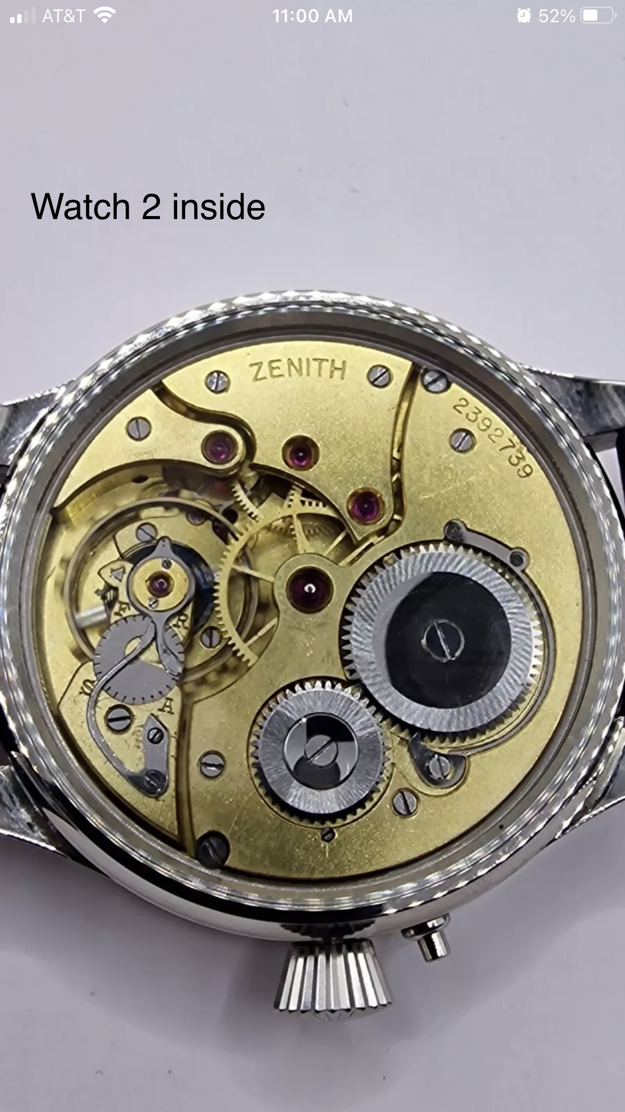

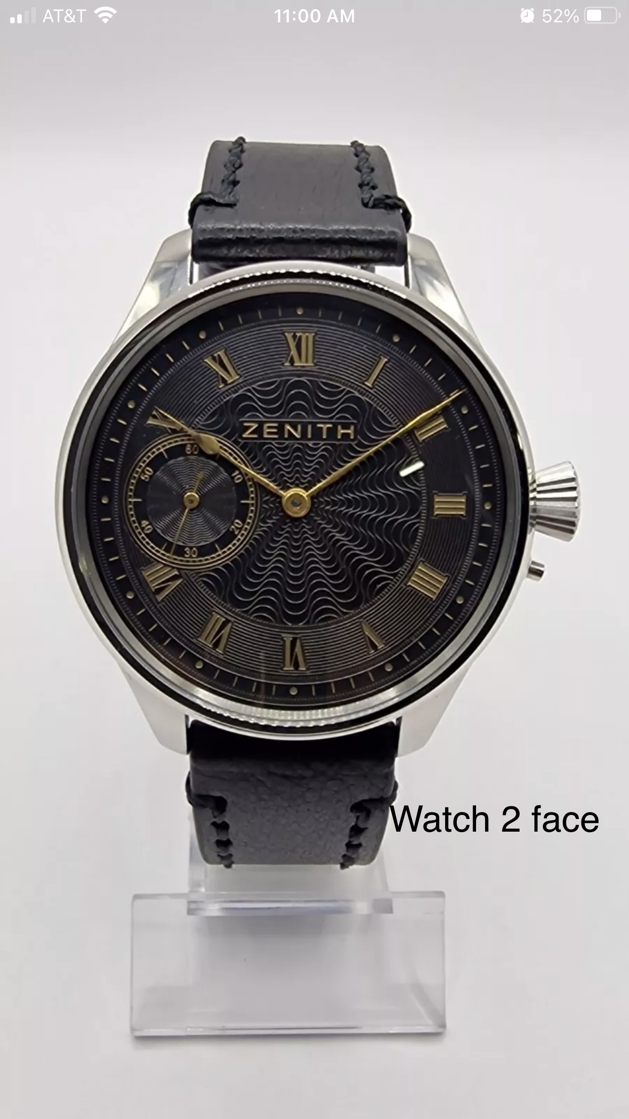

Hello I know most people do not like marriage watches and that’s ok but that’s not why I’m here… I have 2 that I am looking at that I like but I am wondering if by looking at the backside if you can tell if the insides are authentic zenith pocket watches? I feel like the faces are not authentic (but idk) and I am ok with that but I want the internal to be. Any help would be appreciated. Thank you.

Don’t spend your money on this. Dial is fantasy btw

Both calibers are genuine Zenith, but they never left the factory in those cases or with those dials.
Had they have been made into marriage watches with sterile dials it would not be an issue.
However, the addition of Zenith markings makes them into counterfeits.
35,397
39,741
So I’m not going to link to the parts for these, but they come as a marriage watch conversion kit on AliExpress, Wish and TEMU, the kits cost about $20, the dials are also both sold and produced cheaply, they are counterfeit as they use trademarks without permission which is not allowed here.
The Zenith pocket watch movement itself is real, and worth about $25-50 in running condition.

So in total the sellers have about $60-80 into the watches plus a minor amount of labor as these aren’t hard to do a half-assed service on. They then sell them for several hundred or more to people that typically think they’re buying a real watch.

I confirm that both movements are genuine Zenith.
I used to frown at "mariage" watches also, but have changed mind some time ago. Provided that the original dial and hands are still present. There are so much orphaned pocket watch movements around, where some idiot owner had decided to scrap the watch for the material value of the case. What to do with the remaining movements? "Mariage" watches are imo a great approach for "revival" of orphaned pocket watch movements and might even temp buyers to look into the pocket watch field, which before had never thought of these.
And if someone thinks that this still is a trademark infringement and such watches are "fake", then most of the current American pocket watches are "fake" also, because most of the gold plated watches have been recased in the last 100-150 years, some even several times ....
