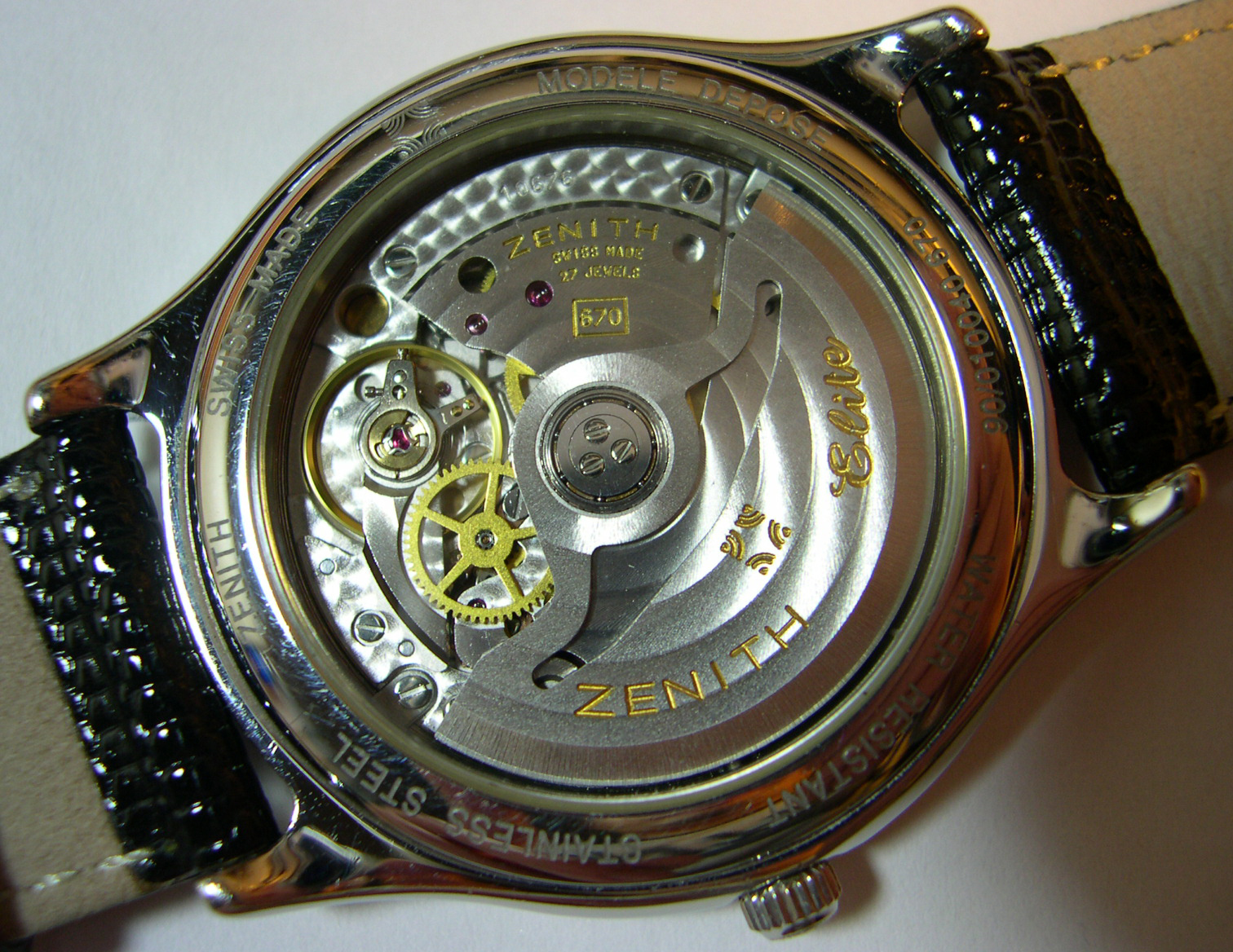

    I have one of its Elite 670 watch and the movement is so thin and beautiful. Absolutely one of my all time favorite automatic movement. 100% in house!

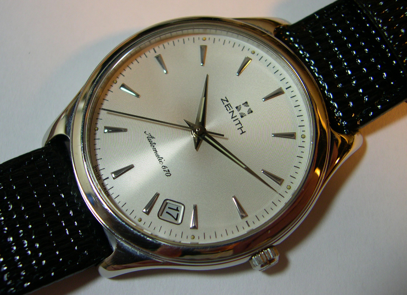

    My favorite "thin" watch. Zenith Elite 670 with beautiful textured dial and see thru back. ZenithEliteBack.JPG ZenithElite.JPG
    Rusdaell and Privateday7 like this.

    Nice! :thumbsup: Seen these in various color dials, including an almost purple kind of blue.
