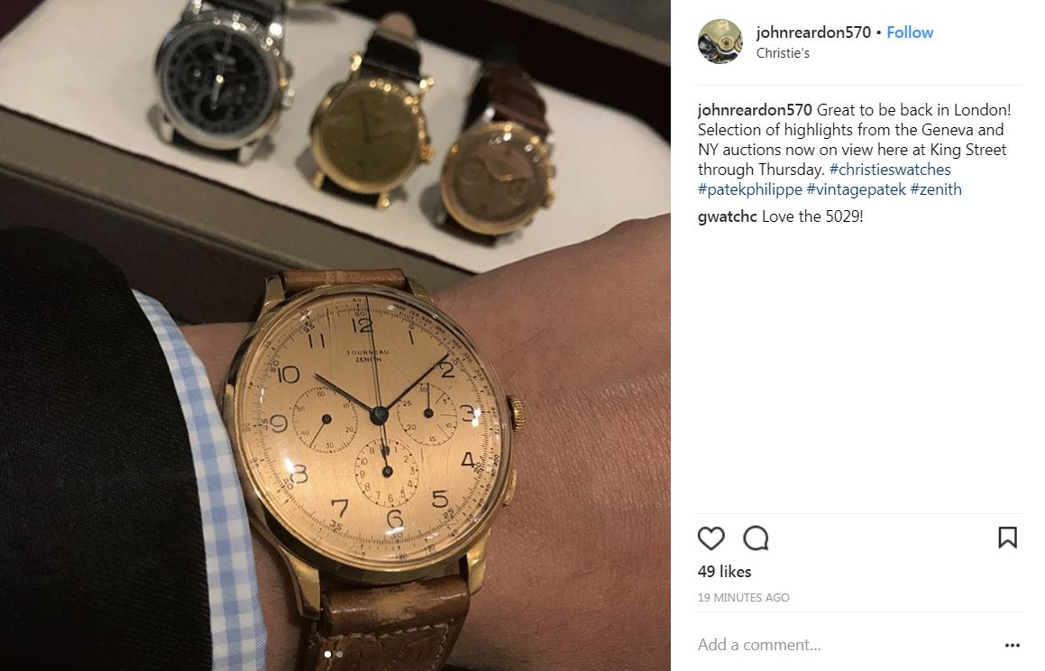

    Is this not a redial?

    Sure looks like one to these tired eyes.

    To mine too. Any thoughts on the markings at 4, 8, and 12 on the minute counter? Thought they should be at 3, 6, and 9.
    Edit: I see that the Benrus Skychief also has markings at 4, 8, and 12. Have others seen them on Zenith/UG dials?

    I have a Universalone with traditional 3,6, 9 and all that I have seen, as well as the few Zenittones have same. I missed that, tbh; I was more attuned to the overall quality of the sub registers, from what can be gleaned from the photo. The second and hour sub dial printing is unlike anything I've seen.

    I appreciate the response, Larry. The sub-dials also jumped out at me. They do not look sunken or engraved and the numbers are all upright. Curious about the absence of "Compax" as well.

    John Reardon says, “clearly reprinted,” so I think we are all on the same page.
