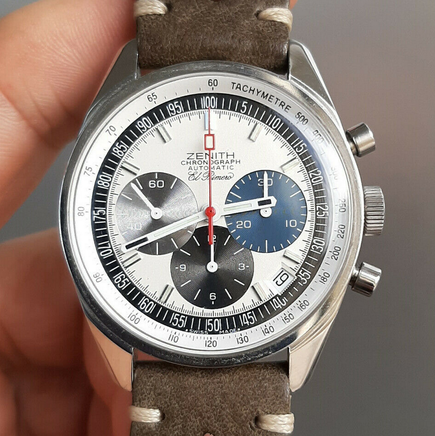

    Not sure it’s a Mk 1 case because I see a groove in the case where the lugs merge into the body. it’s definitely a service dial
  6. killer67 Feb 20, 2020
    1,443
    2,425

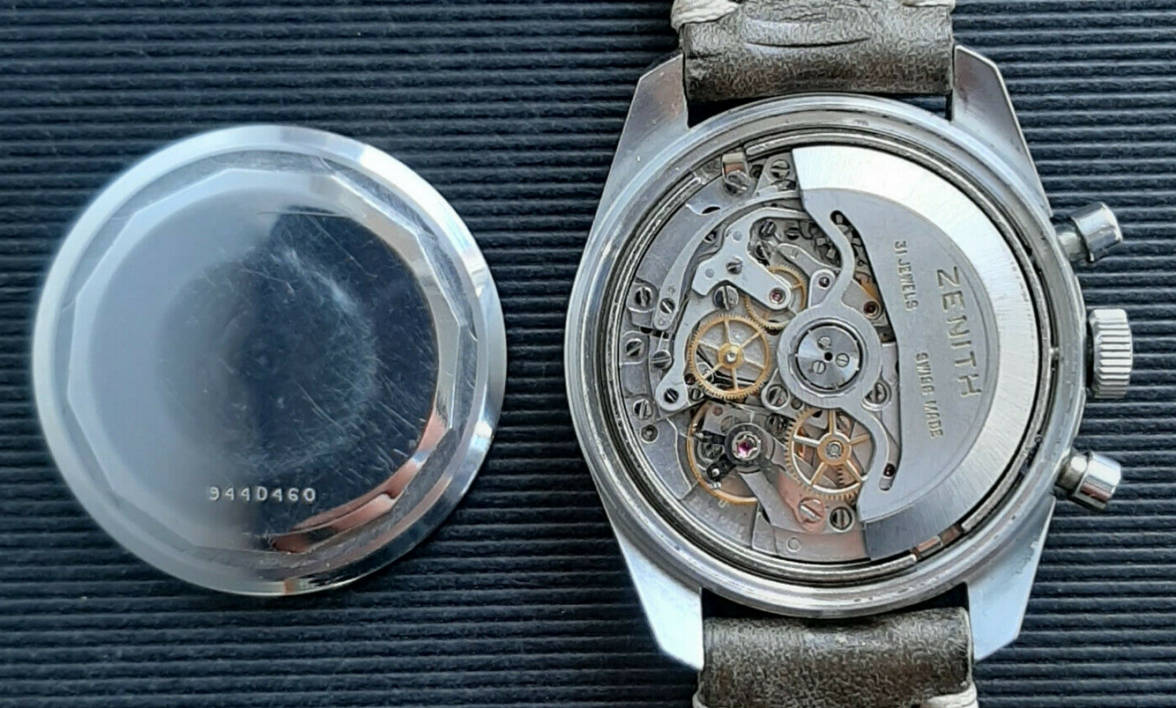

    Also service tach scale, service register hands (should be flat tipped), caseback points to a 5XXD serial and eBay piece is 944D

    So in your opinion, a bit of a Franken special? If these are all service parts, assuming they are genuine Zenith, how does that affect value? Personally I think it's a great looking watch. I would much rather have the pointed register hands.

    As mentioned above it has a Mark II caseback with a Mark III number creatively etched into the back. Actually according to alphahands there are no 944D serials for A386s.
    https://alphahands.com/vintage-watch-research/zenith-a386-el-primero/
    In terms of value I'd say it's worth $3200. The value is in the movement, crown, and case (excluding caseback).

    There’s actually no value in the case either as it’s highly a forged case, and has no reference to any of the A386 iterations.

    I’ve never seen so bad writing of serial numbers ...
