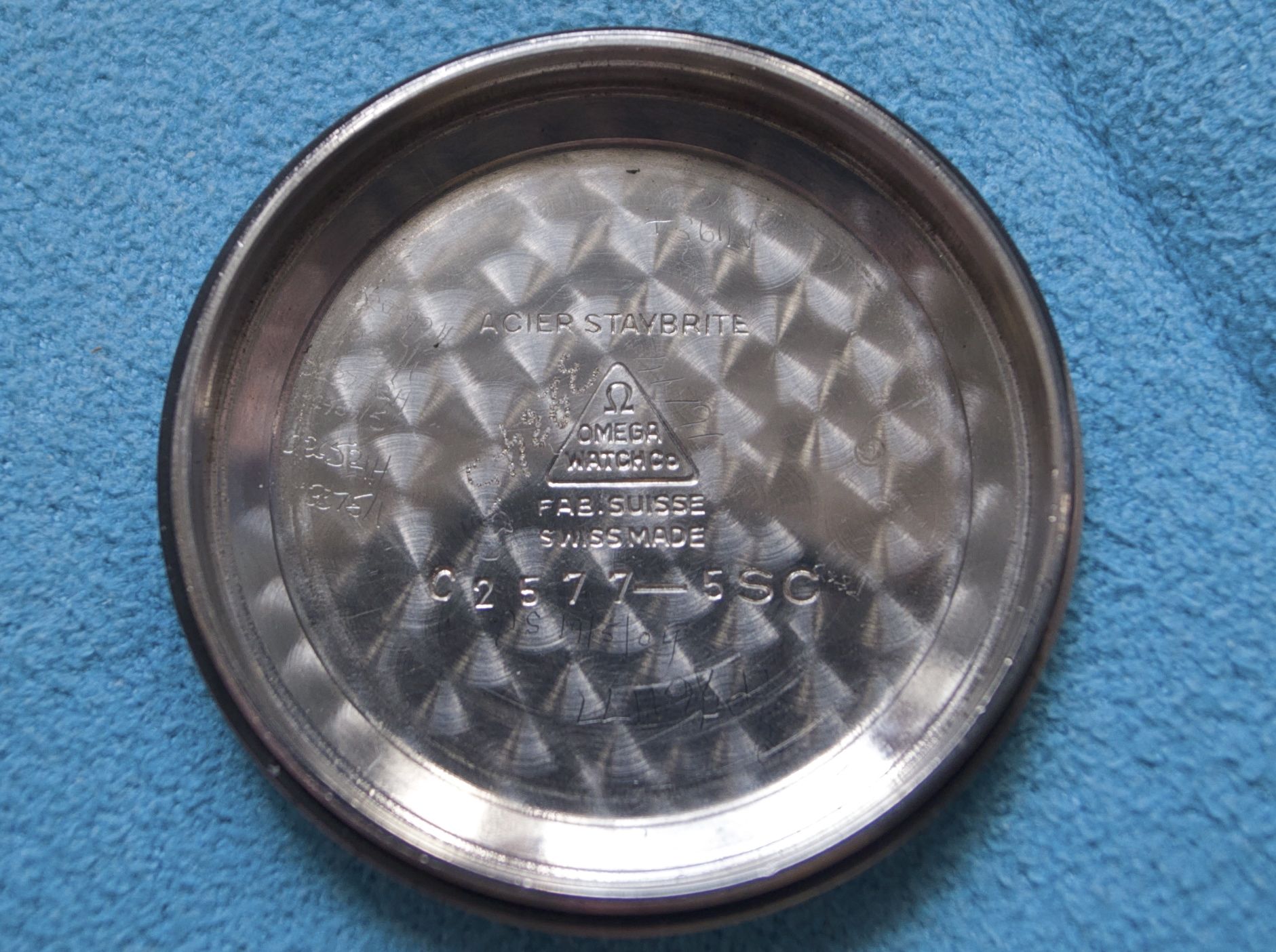

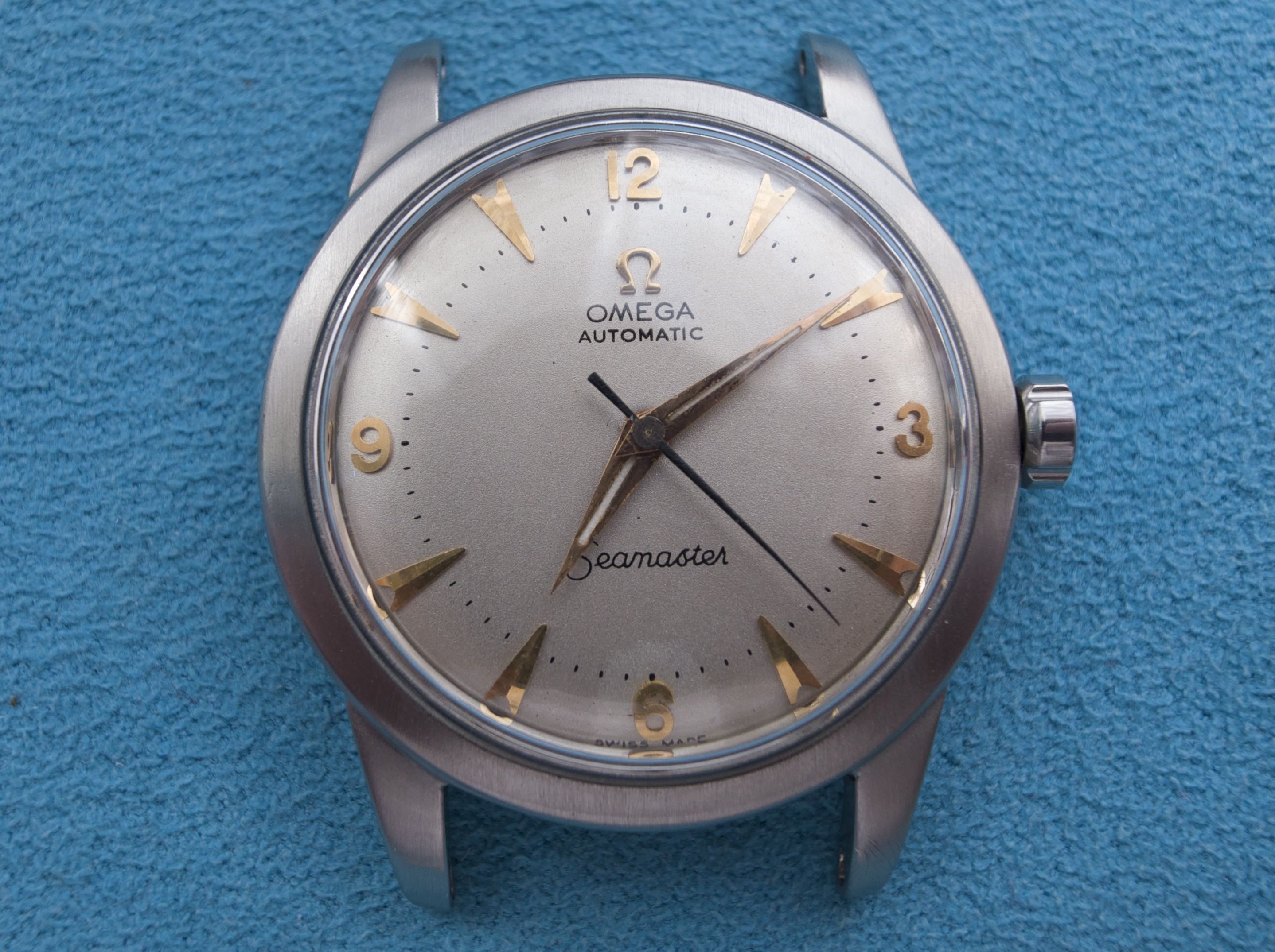

    I'd be *very* grateful for your feedback on my much-loved vintage Seamaster.
    In particular, I would like advice about:
    1) What you think about the originality of the dial (I presume it's original because of the slight discolouration at 6).

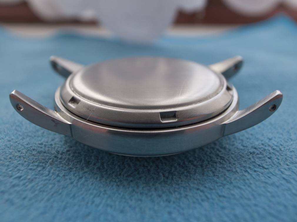

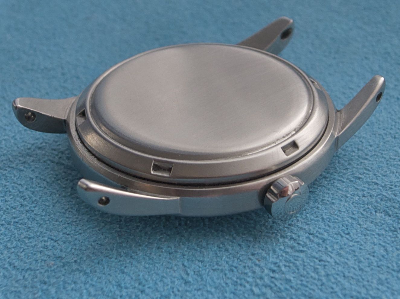

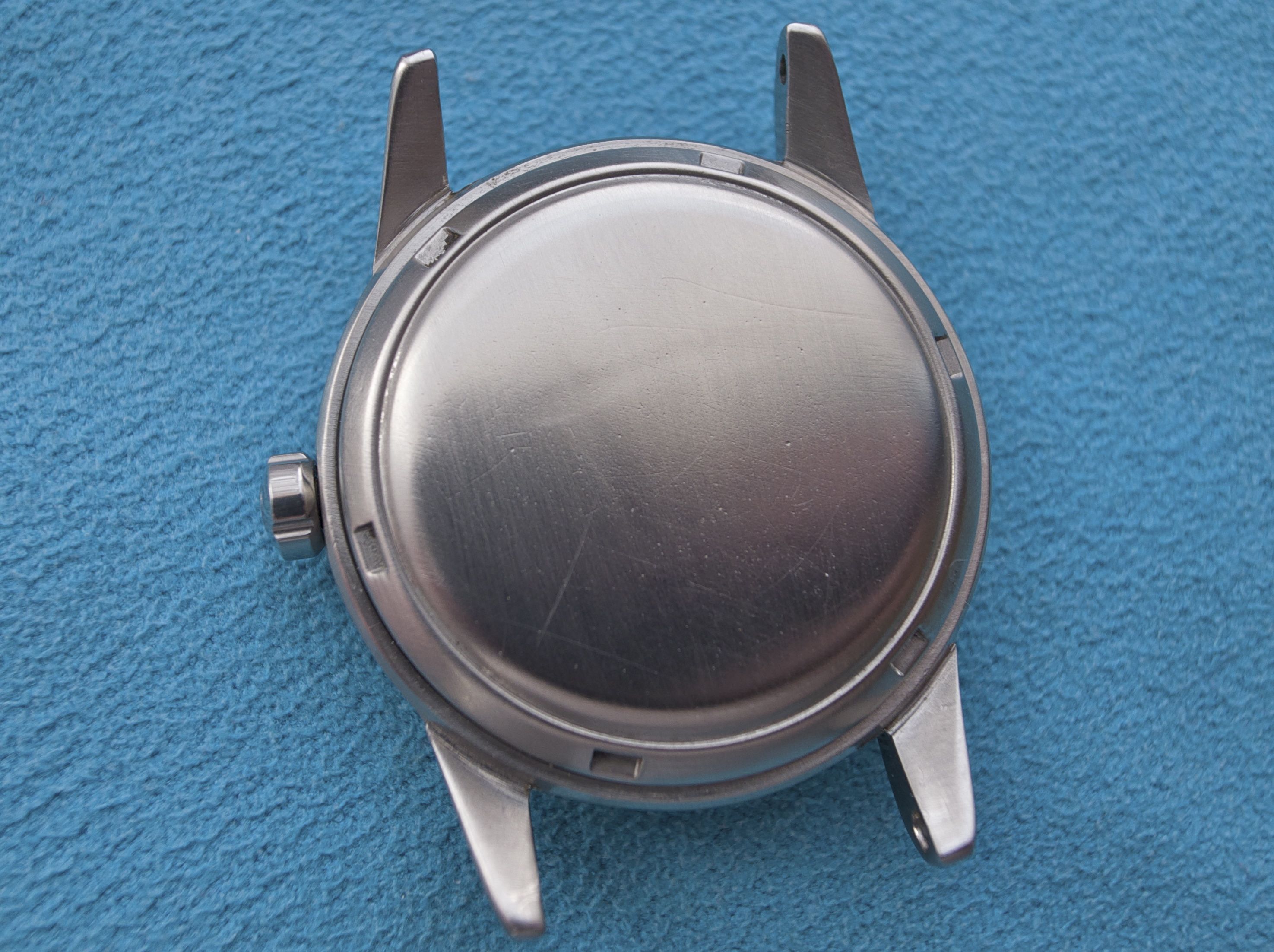

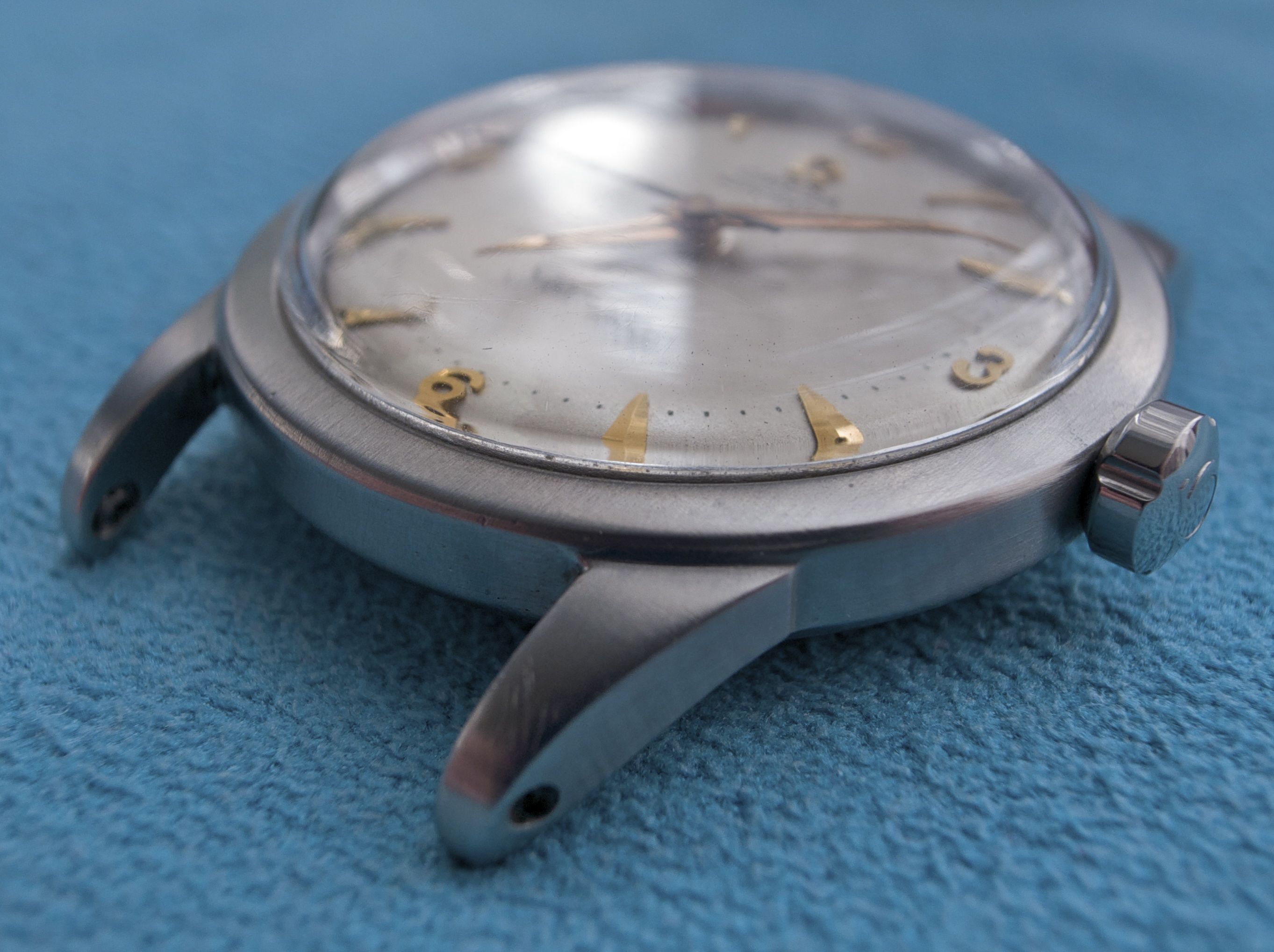

    2) What you think about the finish of the case (has it been overworked, what would the original finish have been, can I get it refinished if need be?). The edges don't seem as crisp as other early Seamasters I've seen, and the case back has a slight shallow horizontal indentation that you can see in the backview photo (is it an inscription that has been polished out to re-sell?).

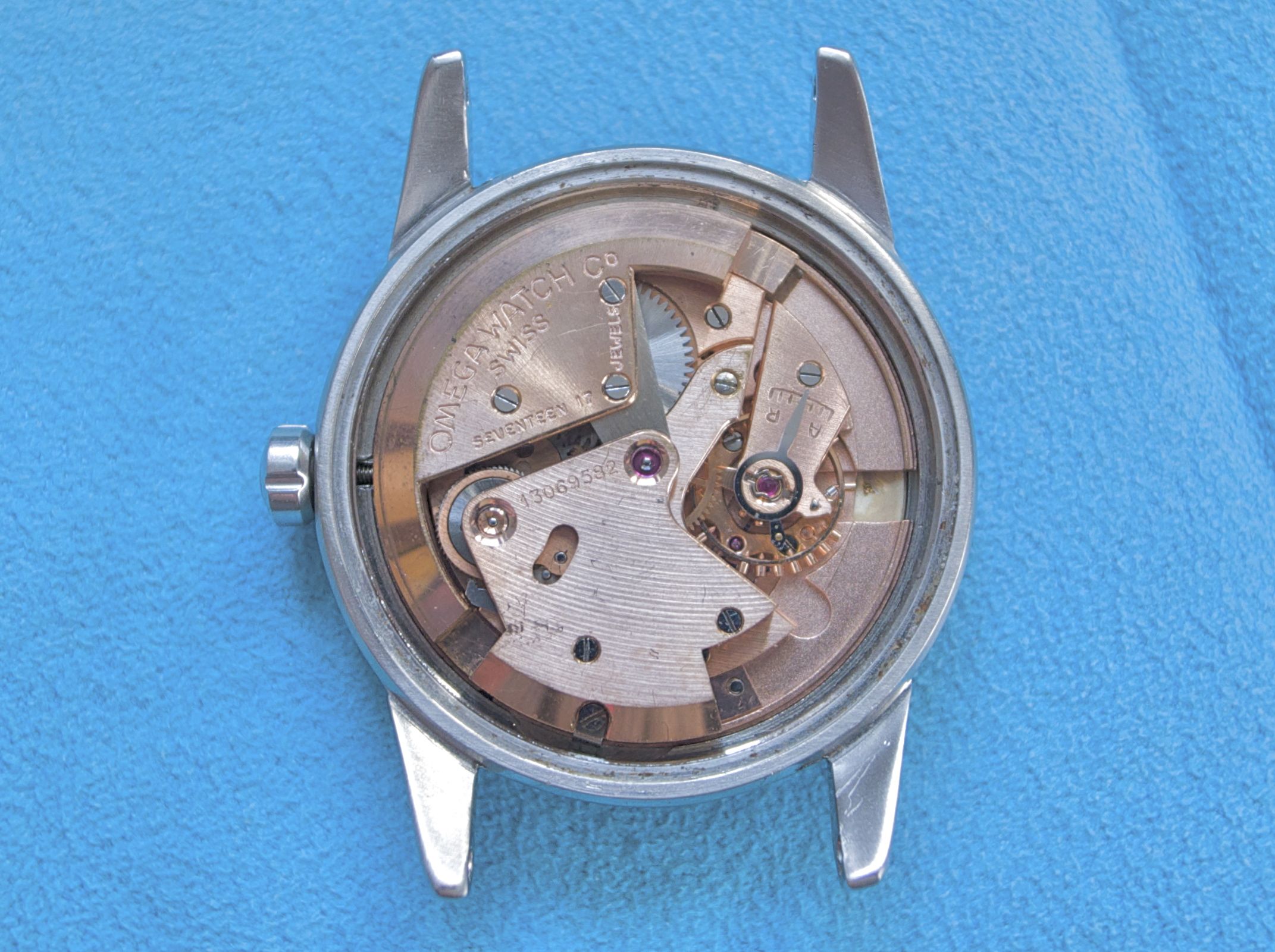

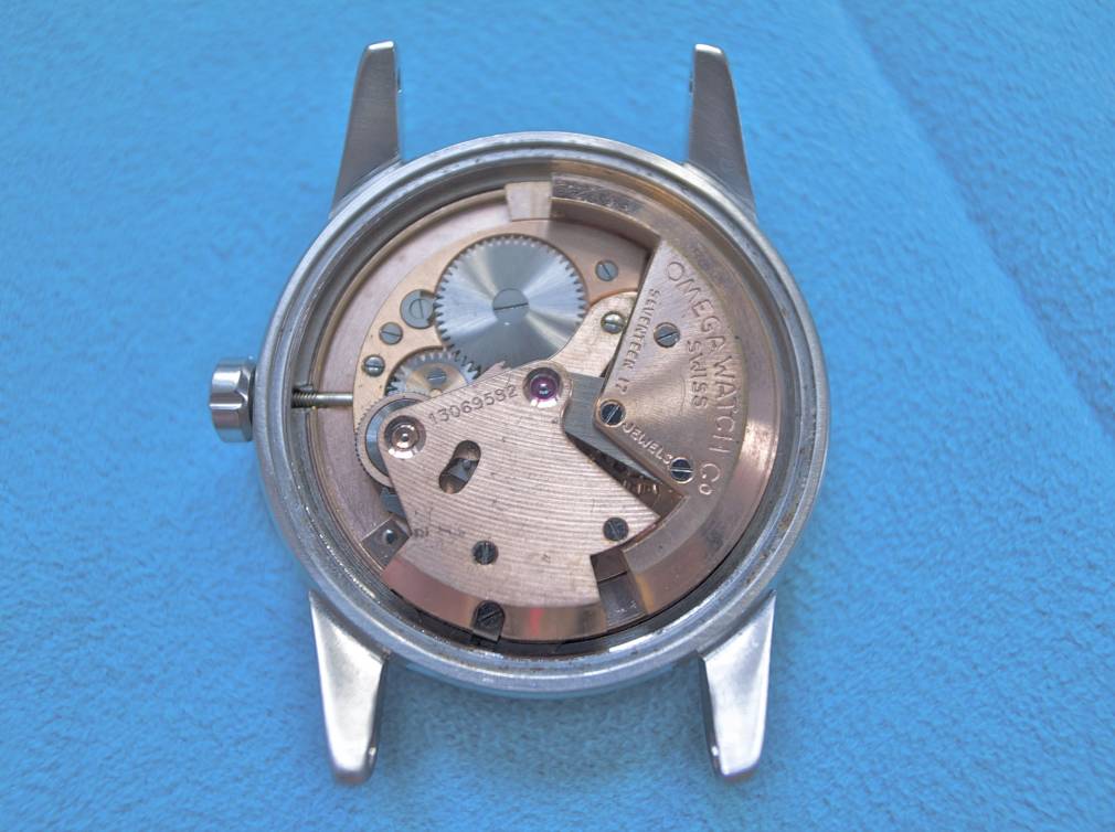

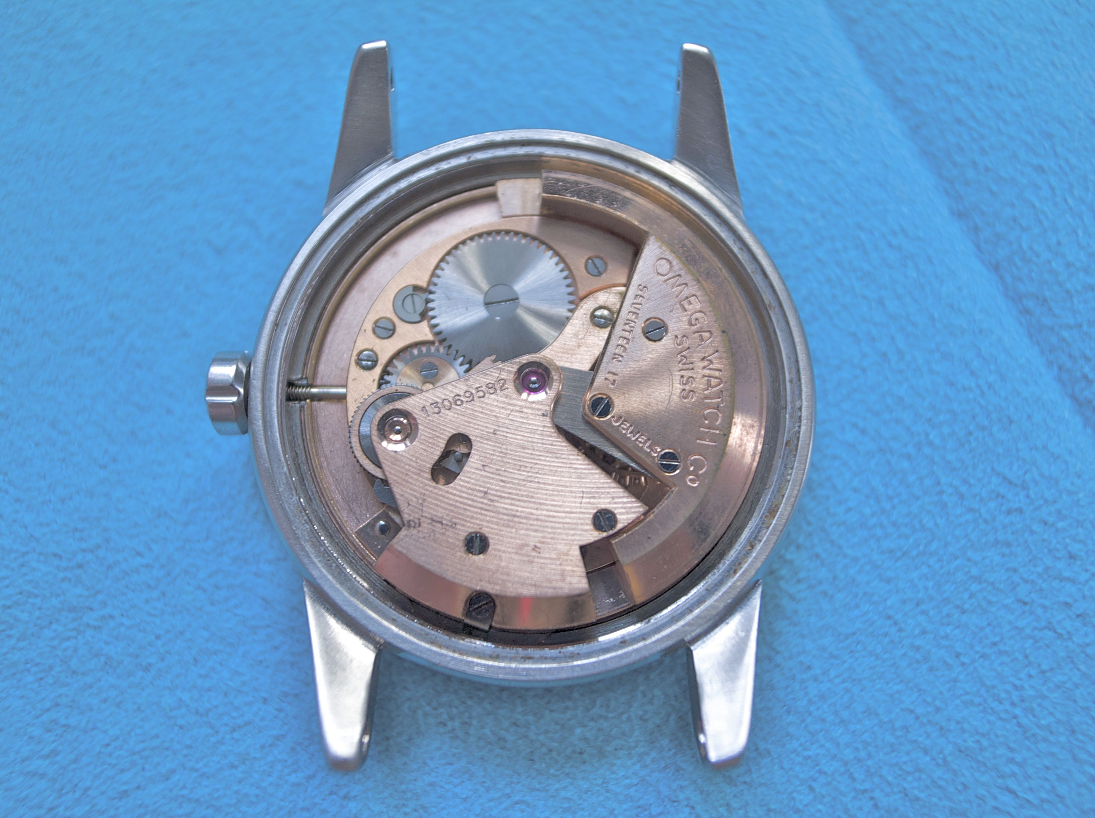

    3) What you think about the condition of the movement (I haven't opened it in 7 years till now!) - and also which year/caliber movement it is (351 or 354).
    4) What you think about the price - £320.
    These are the details from omegawatches.com:

  2. ulackfocus Apr 10, 2013
    25,983
    26,968
    I'm afraid that's a refinished dial. Might be an older one, but it doesn't look correct.
  3. MSNWatch Vintage Omega Aficionado Staff Member Apr 10, 2013
    6,528
    10,780
    The dial is a refinished dial and the case is at least for me overpolished. The movement is in average condition at least cosmetically. I am afraid for this example the price you paid was too high - today I would expect this watch to go for about $250-300 at auction.
  4. cicindela Steve @ ΩF Staff Member Apr 10, 2013
    15,047
    23,789
    The case polishing in this instance might best be described as refinishing, the case has been reworked to remove dents and re-contour the the edges. The finish was probably smooth shinny originally, not stain, especially the bezel. Having heard out assessments, I would not worry too much over it at this point. It is a fine wearing watch and it now has built up a heritage and memories with you. Enjoy it.

  6. X350 XJR Vintage Omega Aficionado Apr 10, 2013
    12,430
    29,483
    Caliber 351
  7. danjperry Apr 10, 2013
    18
    Thanks cicindela thats helpful, the more Seamasters I've seen the past few years the more I felt the case was way too satin.
    It has given me a lot of enjoyable use, although I've become very OCD lately, and knowing it's not as original as I would like is probably going to be the catalyst to sell and get myself a new treat.
