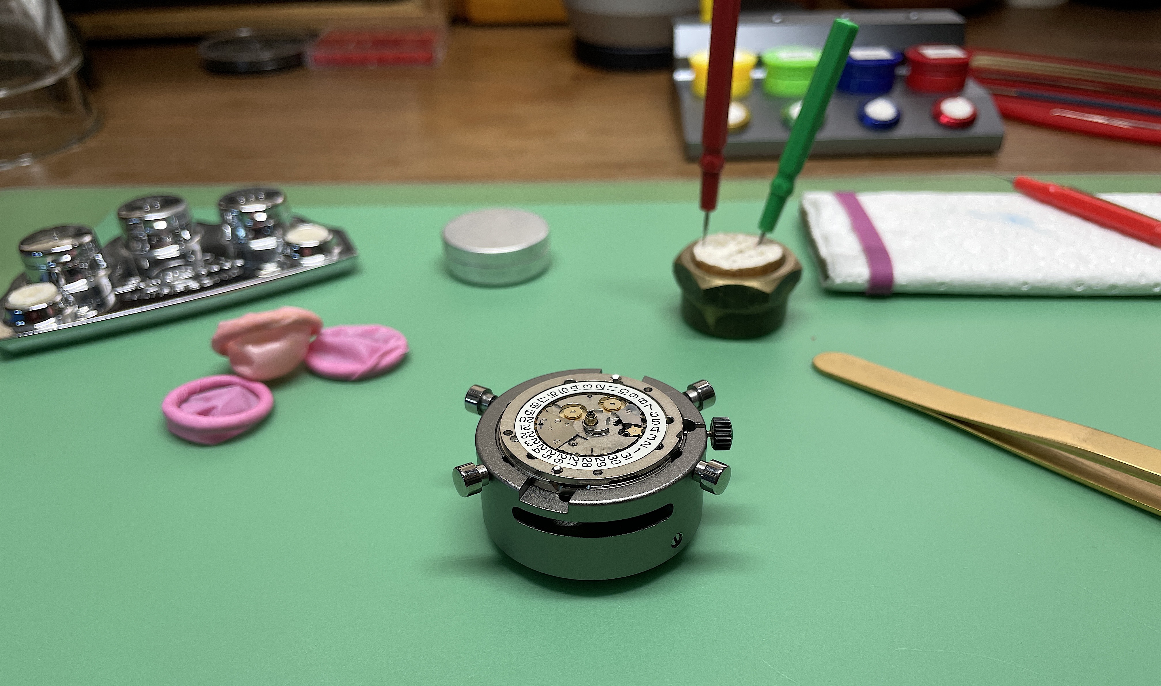

You know it's time for a beer..........
18,067
37,711
............ when you get to this point with a vintage Valjoux 7750 without losing or breaking anything.

Interesting. Didn't know the 7750 was so... what? fragile? complicated?
29,815
77,159
It's neither. However there are two spots that tend to trip up the less experienced. One is setting the calendar plate on the dial side, without disturbing the spring for the hour hammer - it can go flying off pretty easy.
The other is setting the automatic bridge side on without disturbing a number of parts that are placed on there as you line everything up.

Considering that that looks like my watch, I am bloody pleased! My shout!
