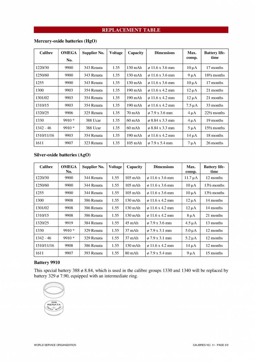

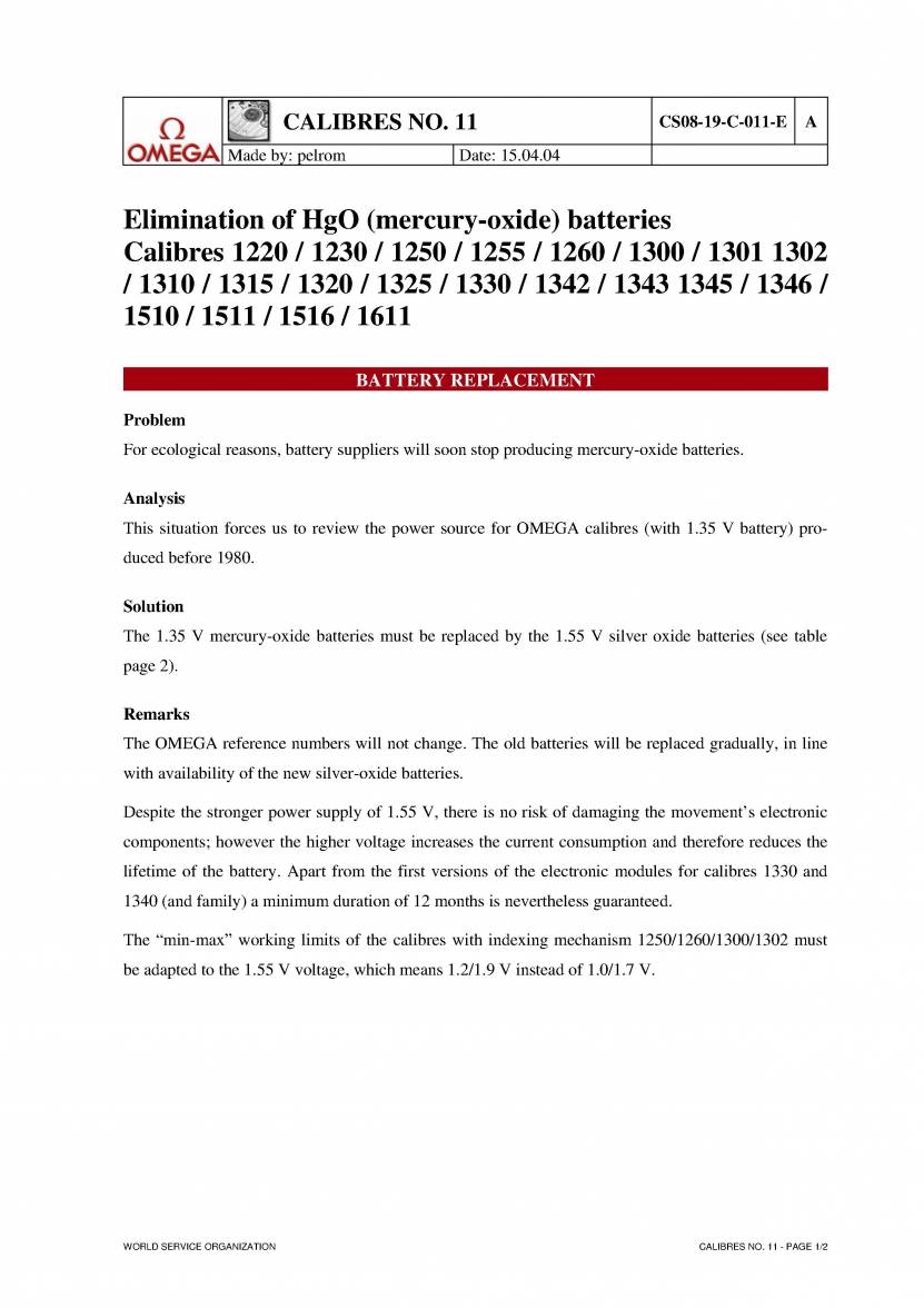

No need to go the 1.35V way. All of my f300hz watches are running on modern cells, and doing it well.
The Bulova 21x calibers seem more sensitive to the voltage than the ETA/ESA (f300) ones.

BTW: Here is the Omega official bulletin regarding changing to modern (1.55V) batteries on the f300 and other calibers:
