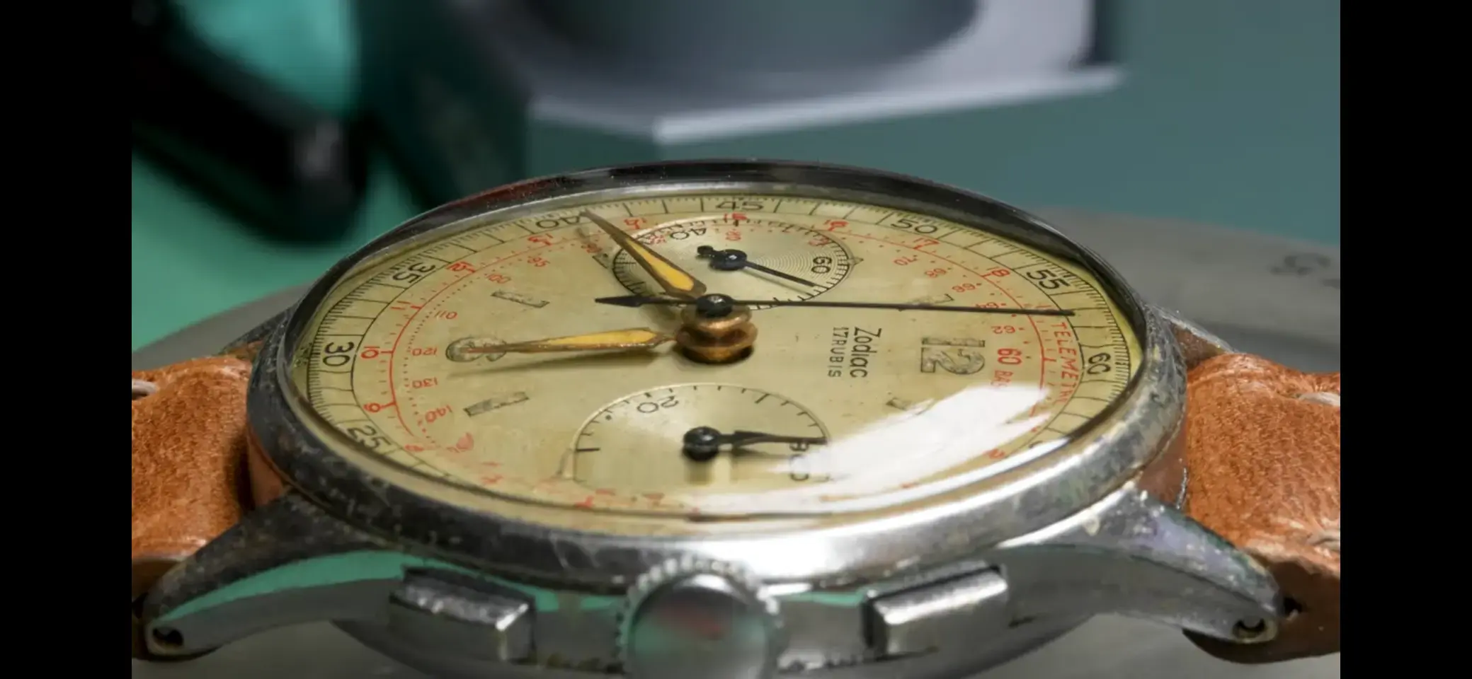

Hi all!
I watch Marshall knowing he's imperfect and a hobbyist,so forgive quite a bit in exchange for watching movements go together. His voice-over is a little silly of course, as he clearly knows what is going to happen, but IMO, its kinda nice narration.
This one, however, I was kind of appalled at quite a few things (not letting down the mainspring because he didnt 'know how'), a GIANT cat hair he let sit on the movement while he worked (which he admittedly removed/commented), forgetting a setting lever screw (I'm only a few dozen movements into my watch cleaning career, and already have a complex about that, and some generally sillier than usual commentary.
Anyway, link for anyone curious, go in with low expectations 馃榾

Yep, new crystal plus relume did that a favor if you dont look too close at the case
