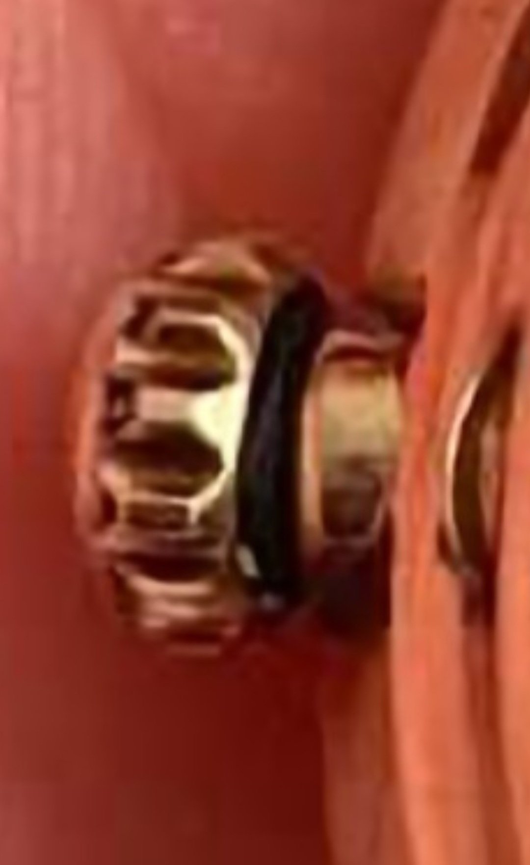

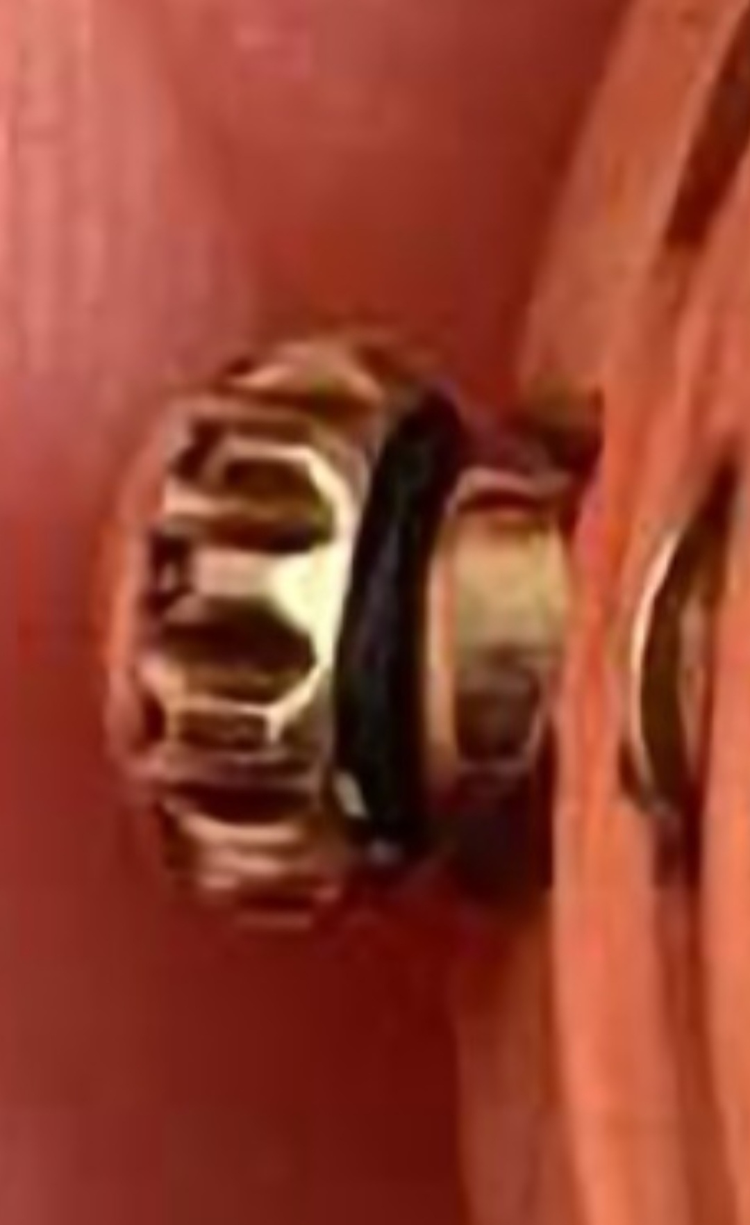

I'll post a picture when my watch is back from service.
EDIT: actually you can see the gasket on this picture here:
3,790
6,452
Doesn't look right to me. The original gasket is square with flat surface.
This one has a round O ring like the cheap ones sold on eBay.
The picture doesn't show but this one has flat surfaces. It will be replaced during service anyway.

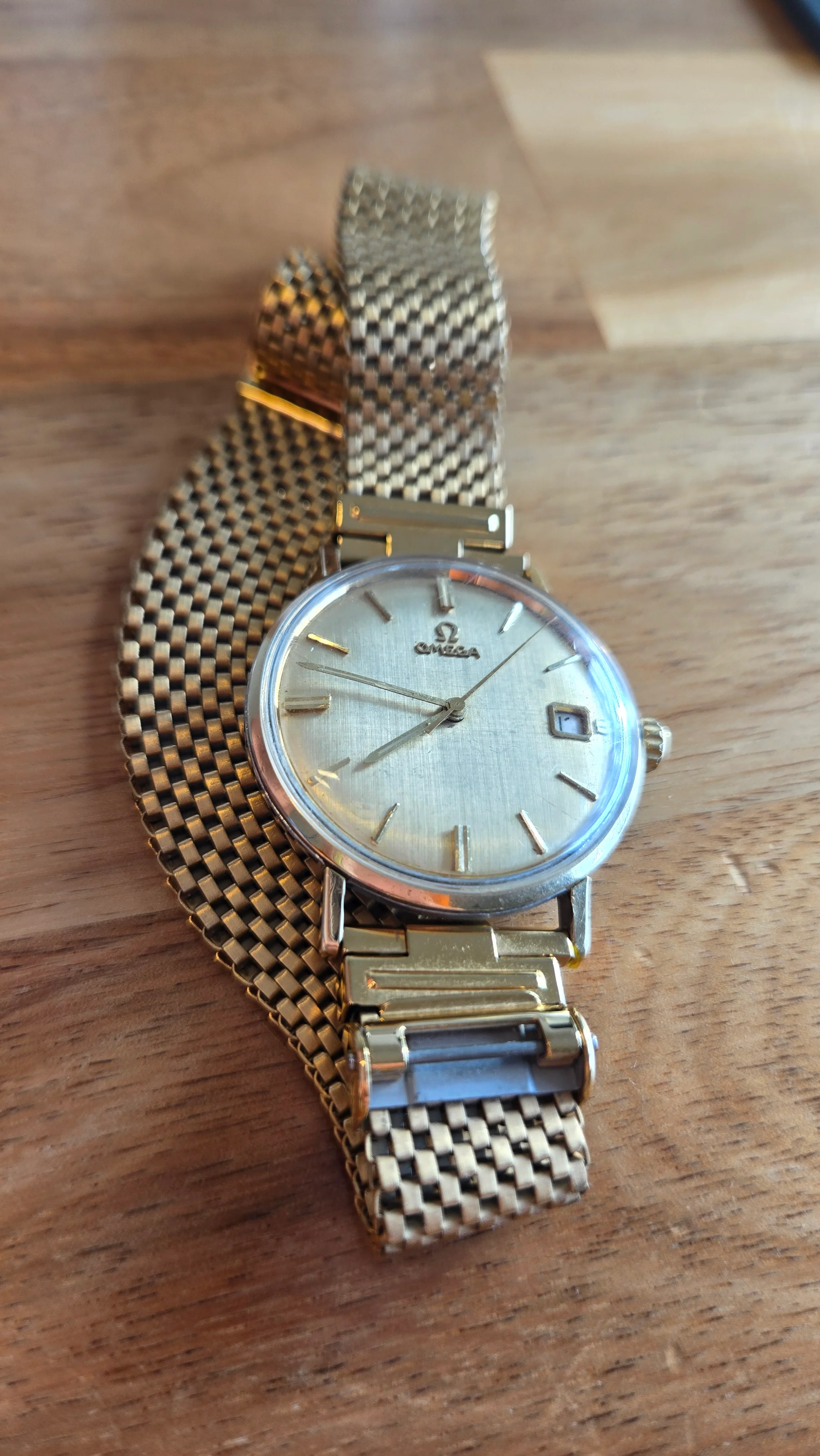

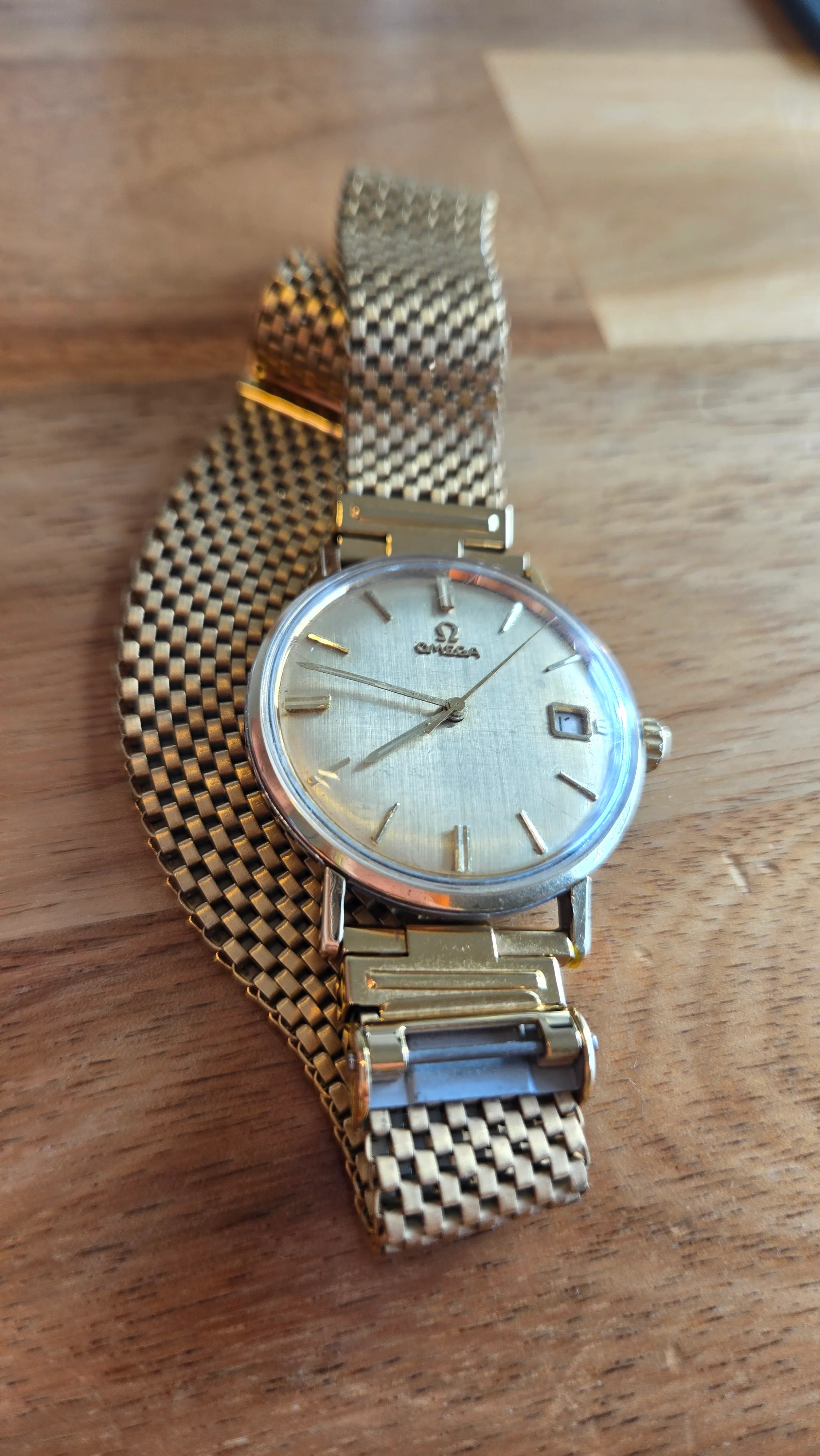

Do you know what the gasket specs are for the crown? I also have a gold omega seamaster deville, mono bloc case, but with a linen style dial instead of the ribbon. I just had my watch serviced and noticed this was missing. Weirdly it was pressure tested and supposedly passed for about 30m, so maybe there is another gasket inside the crown tube?
