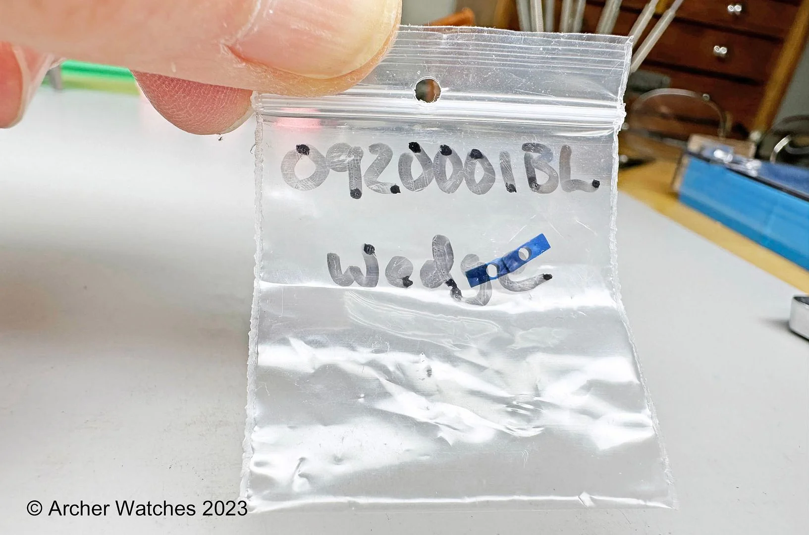

The little half moon spacers used in the dynamic cases can be cut/milled using a laser cutter. I am thinking that I have some scraps of HDPE that might be even better for this. And the laser is overkill, since it is mostly a turning and drilling operation.
I don't have a laser cutter 馃榾 What do you mean by 'half moon spacers'? Can you share a picture?
3,013
4,781
They are described in one of @Archer's threads. If you search watchmaking you can find the thread.
edit: I see he posted the same time I did.

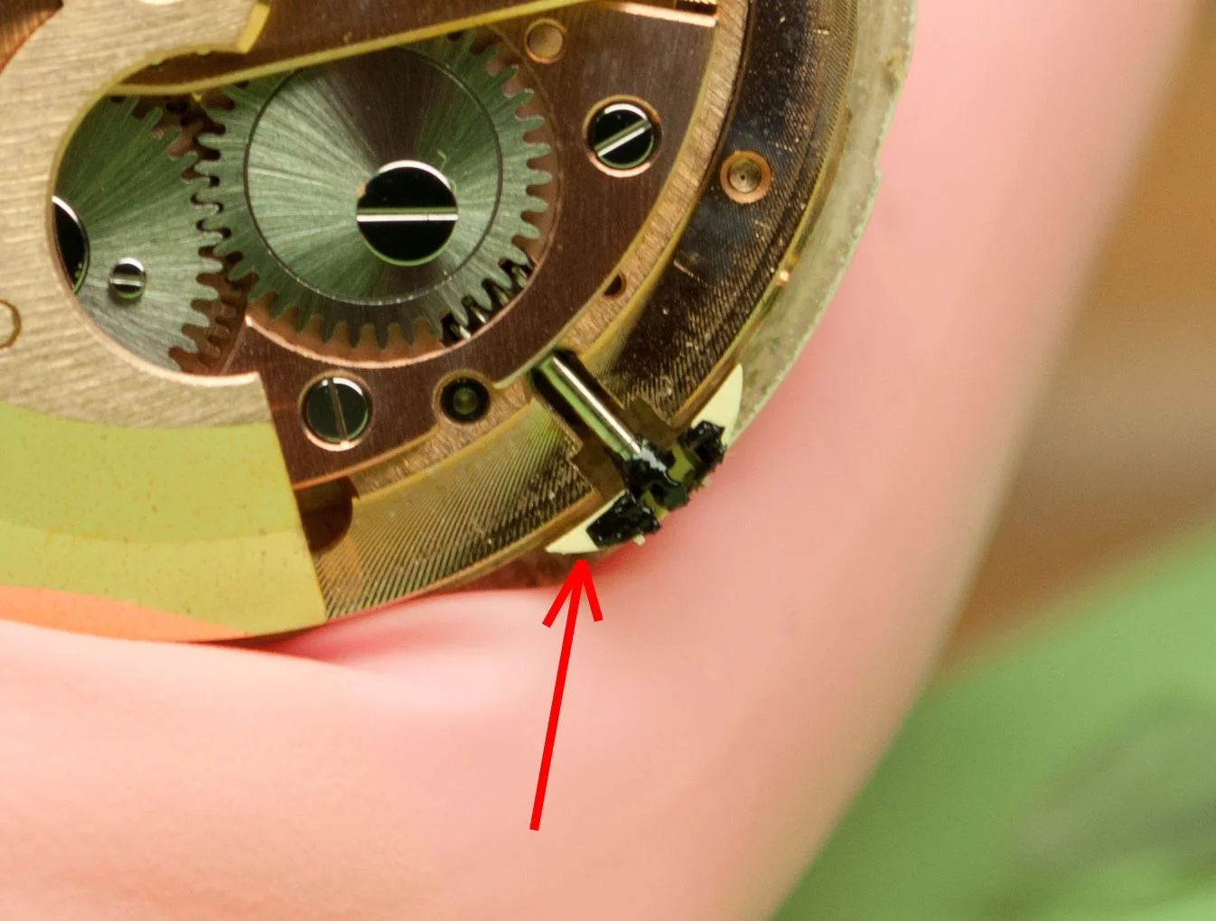

I think I know even less than I did before the picture 馃榿
2,671
2,856
Here it is in place:
OH! That IS really helpful! I see now! Hmm... No reason I couldn't figure out how to fab something like that! The only 'unfortunate' bit here is that the case tube isn't in the middle of that half-moon cutout on this case! Maybe this is reason for me to actually use that UV 3d printer I never setup 馃榿
