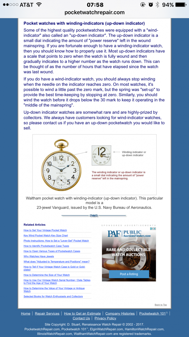

    Also, I found this which correlates to what you fine sirs are talking about...
