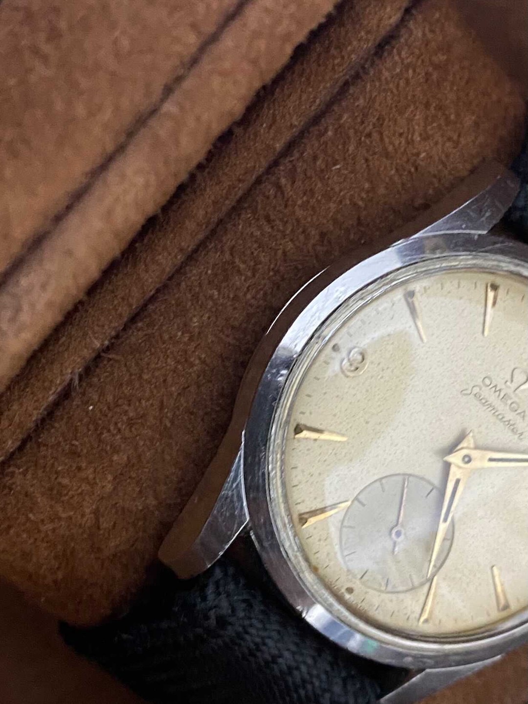

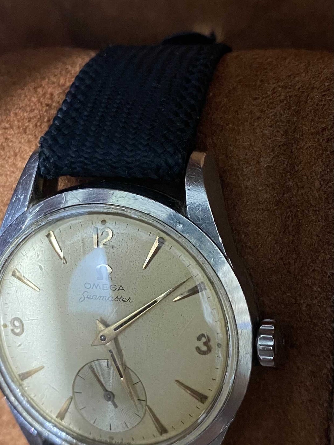

Hi! I have a lead on a parts watch a ref CK2938 for my CK2937 cal 267 Seamaster. Mainly after the bezel. @omega_enthusiast on Instagram told me the only other model with the same bezel is from a CK2938 cal 284. Can anyone else confirm? Thank you so much!

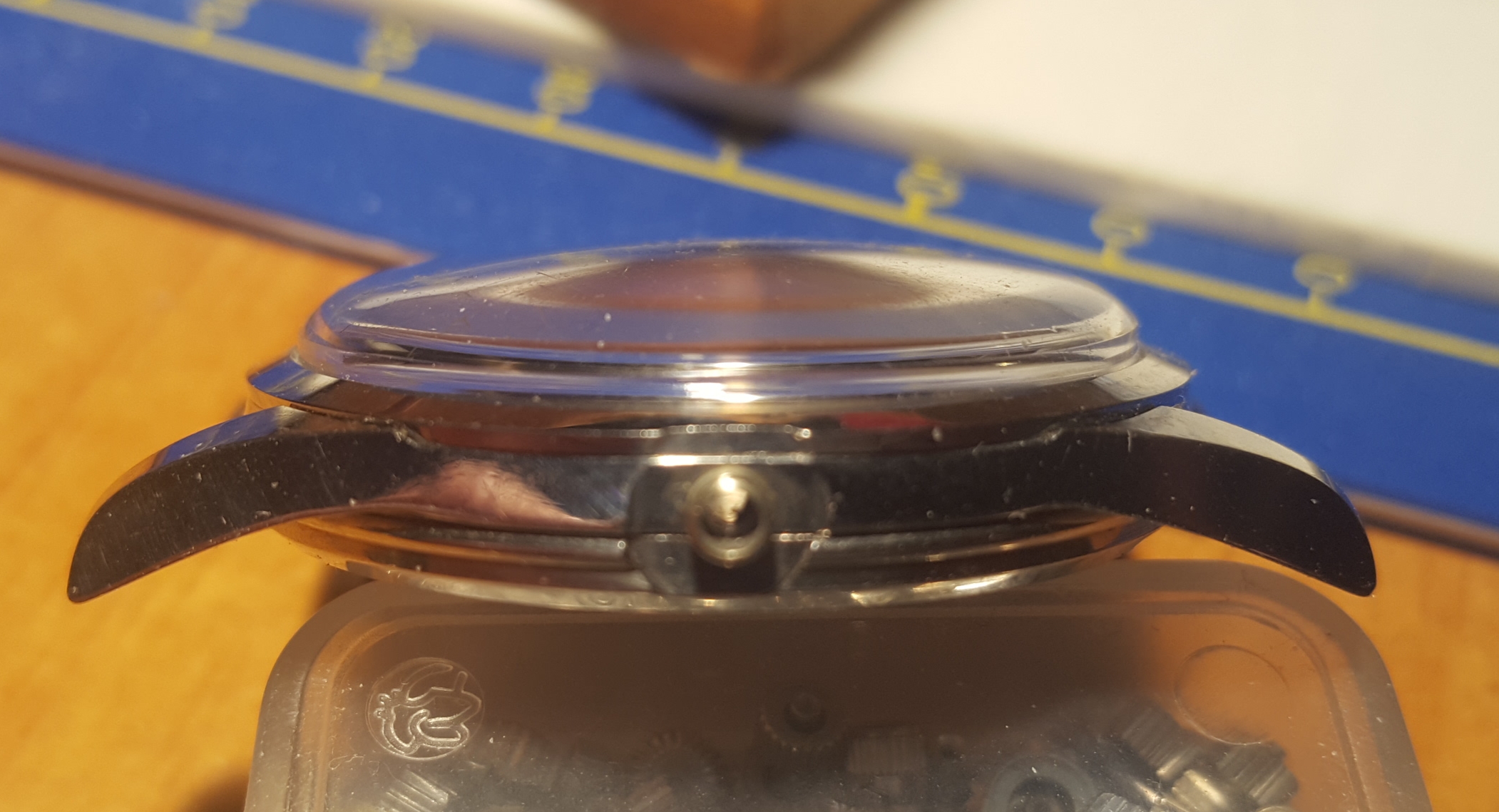

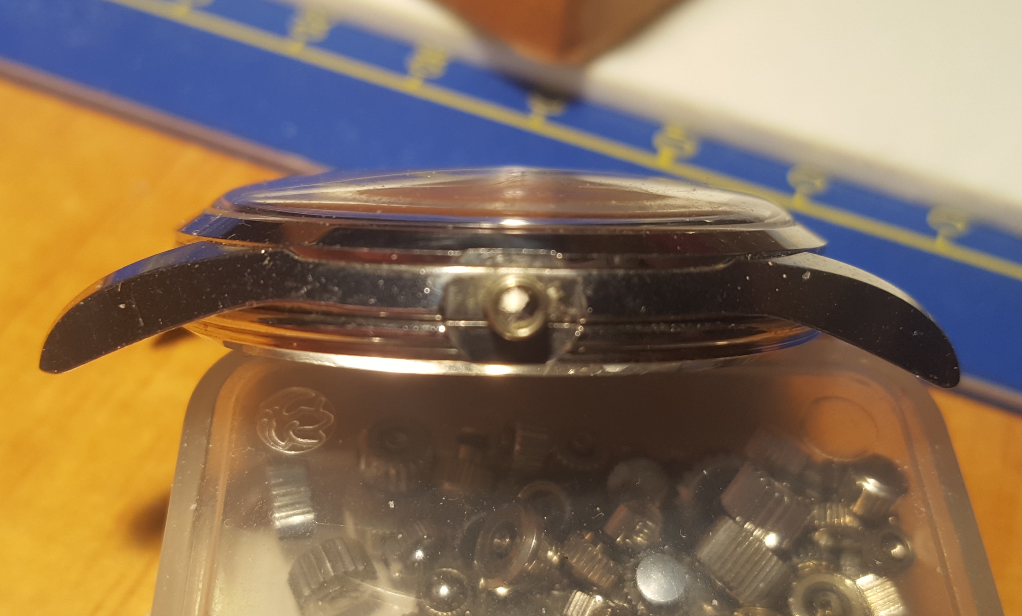

Here are NOS 2937 and 2938 cases; indeed there is a small difference with bevel angle. 2937 case with shallow chrystal.
So I shouldn’t buy the 2938 as a donor and wait out a 2937 instead?
Any chance you have a bezel for sale? Or just the whole case
Would you happen to know if they are interchangeable? Please I’m close to giving up on the bezel
