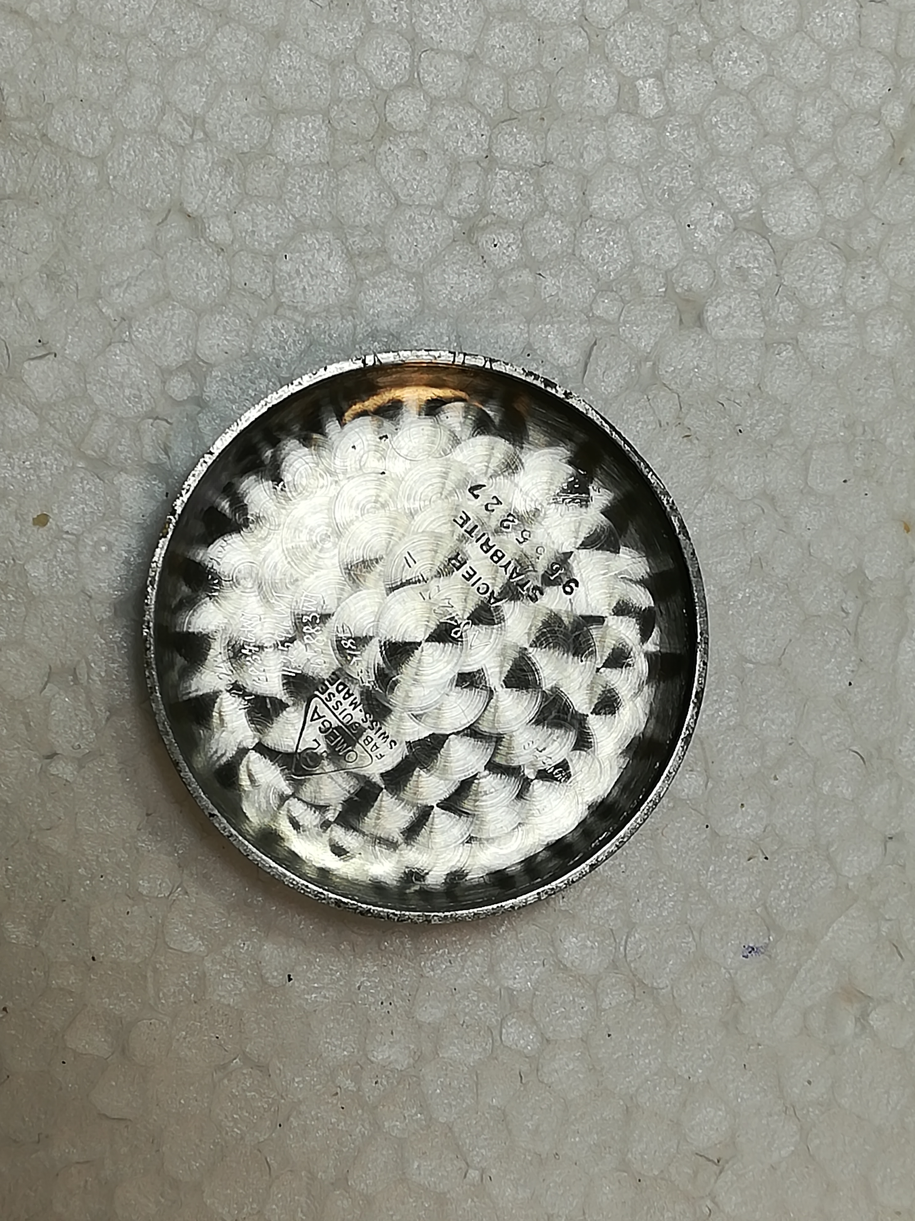

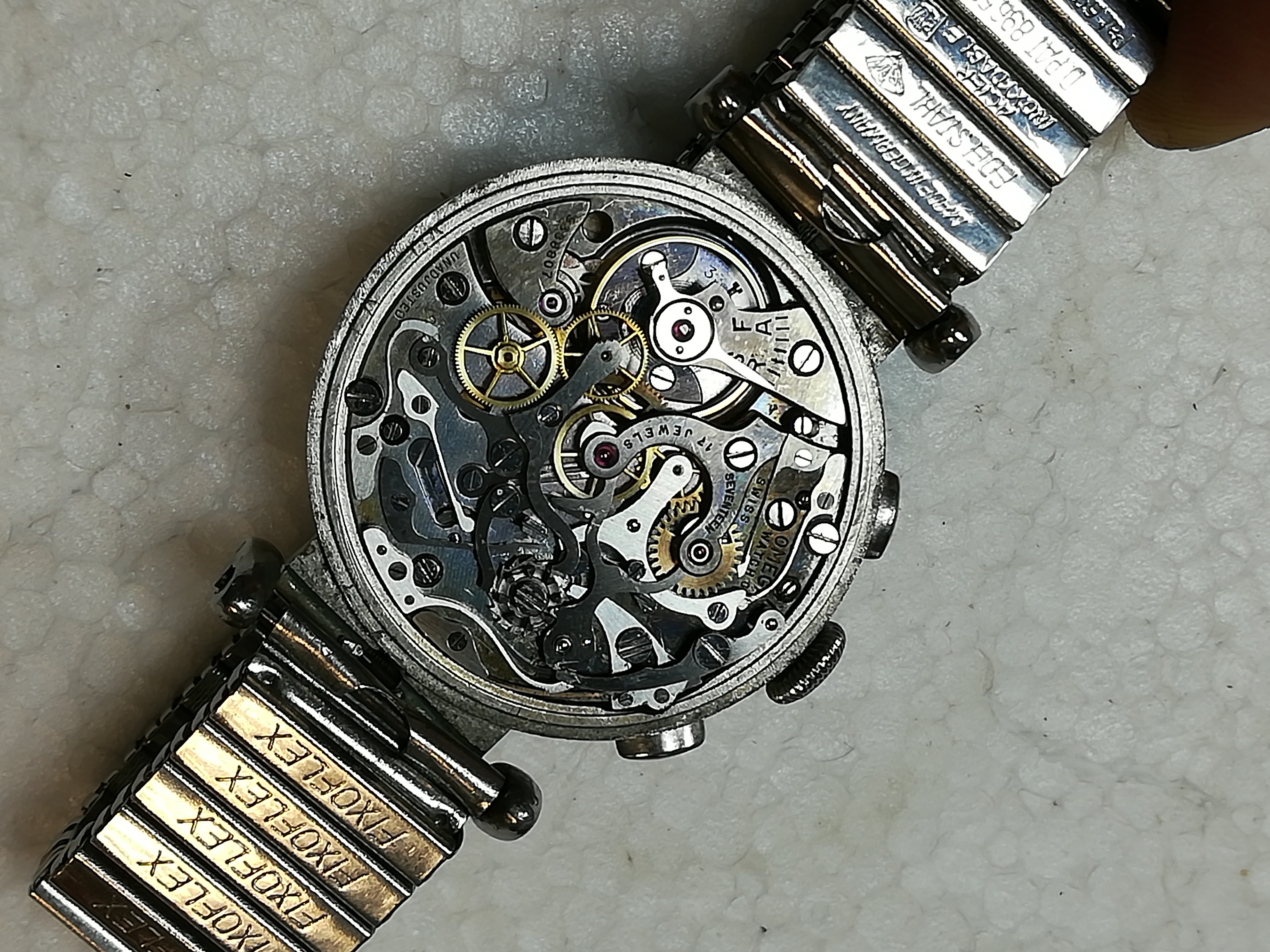

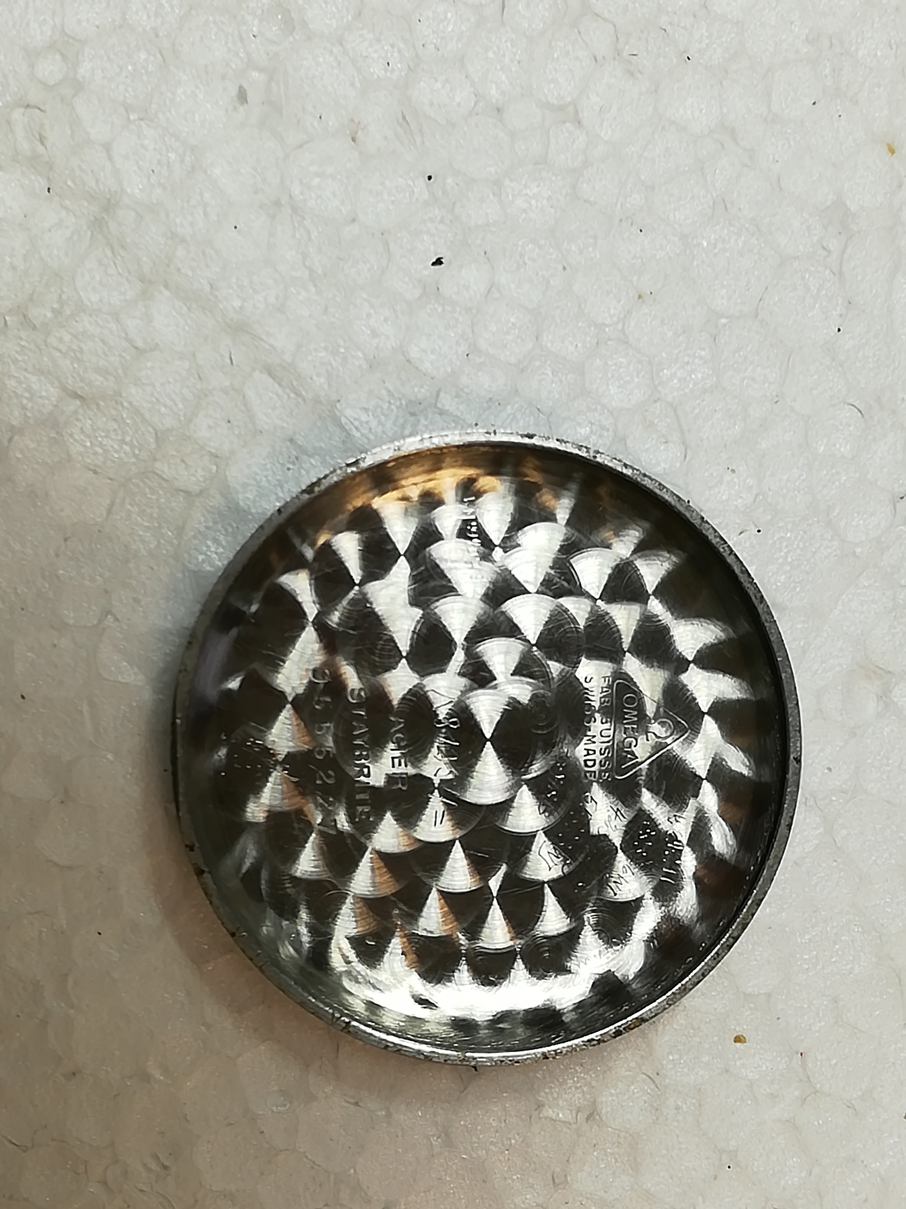

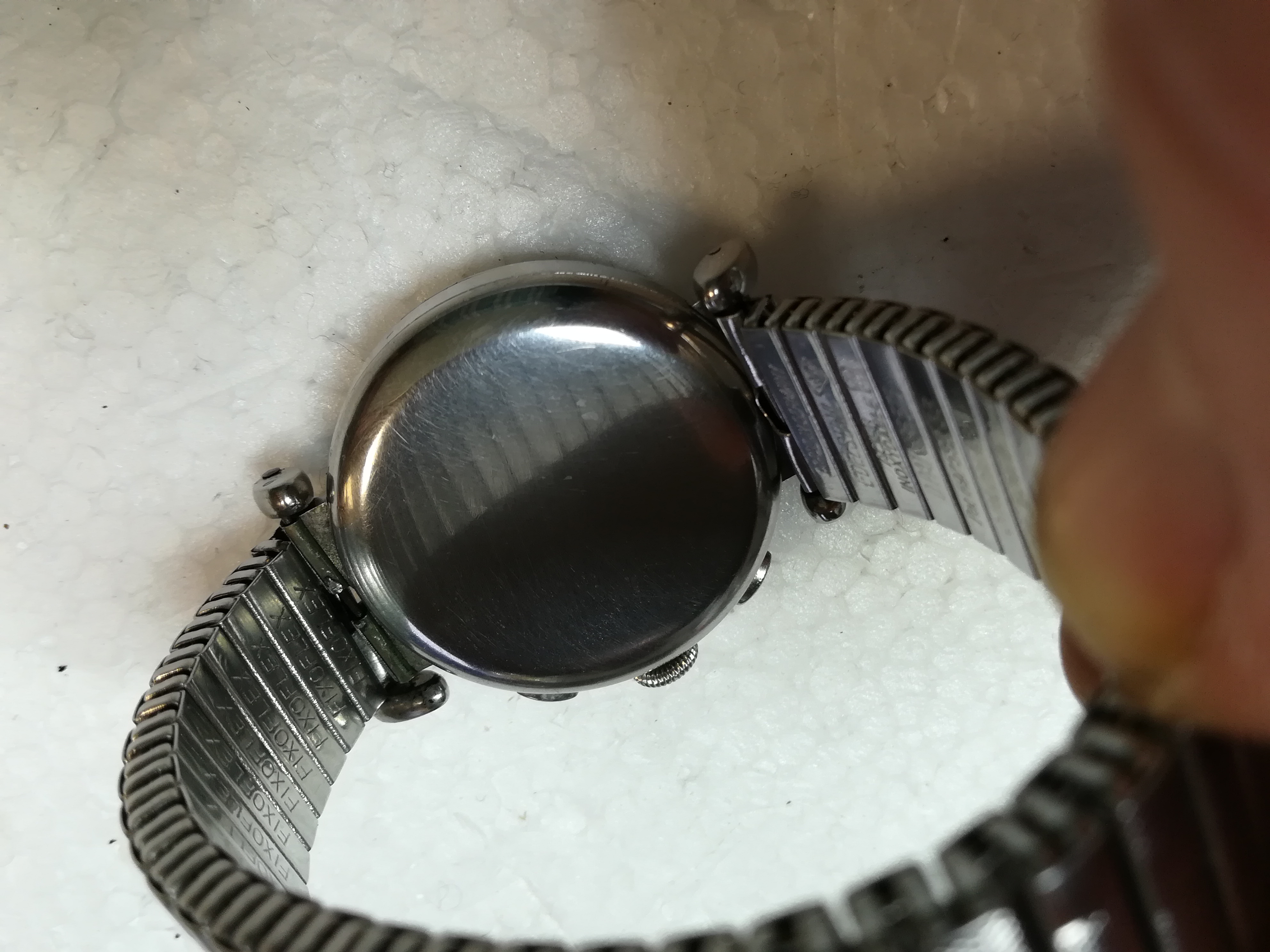

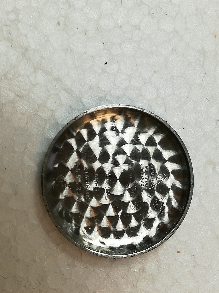

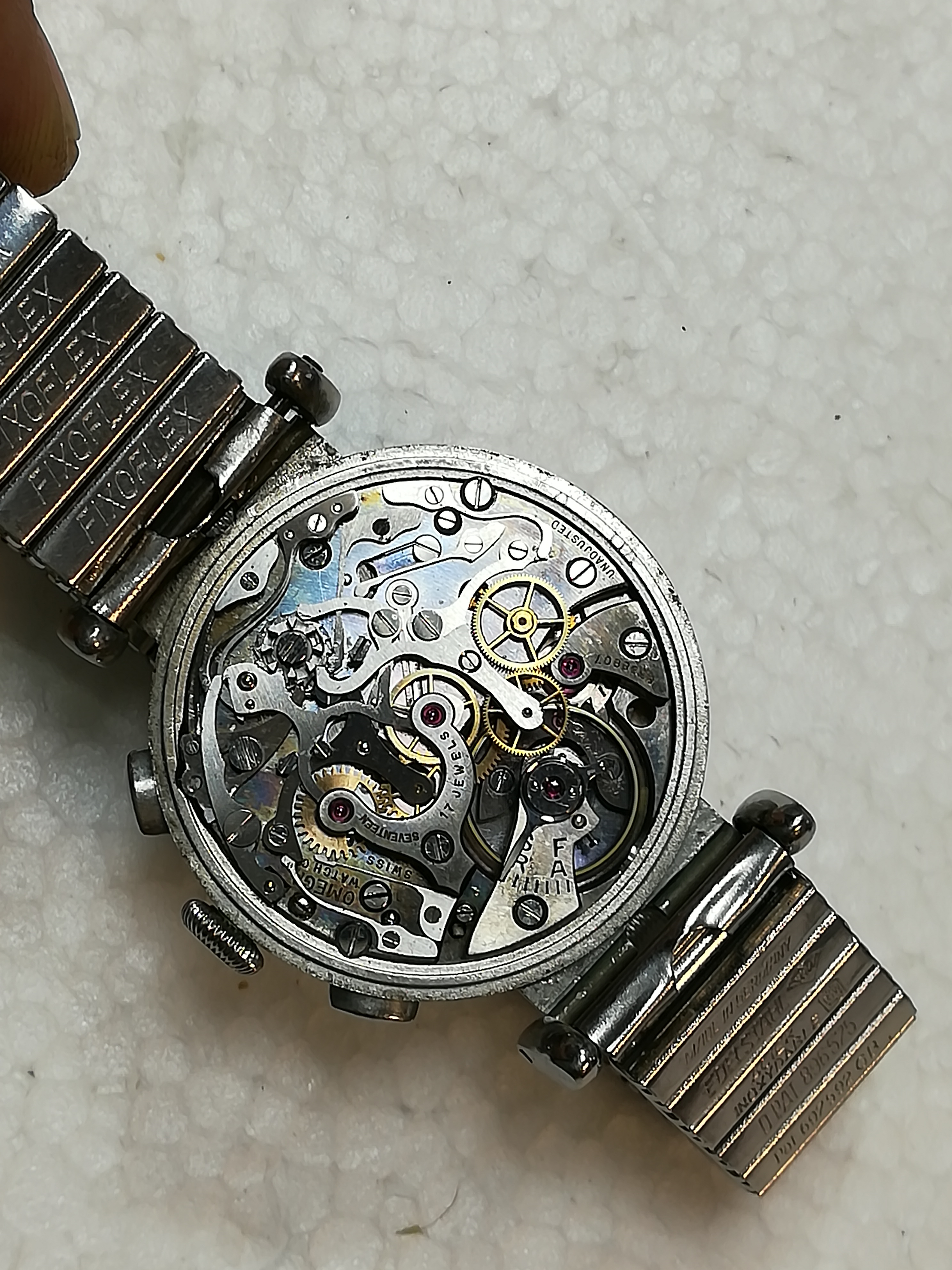

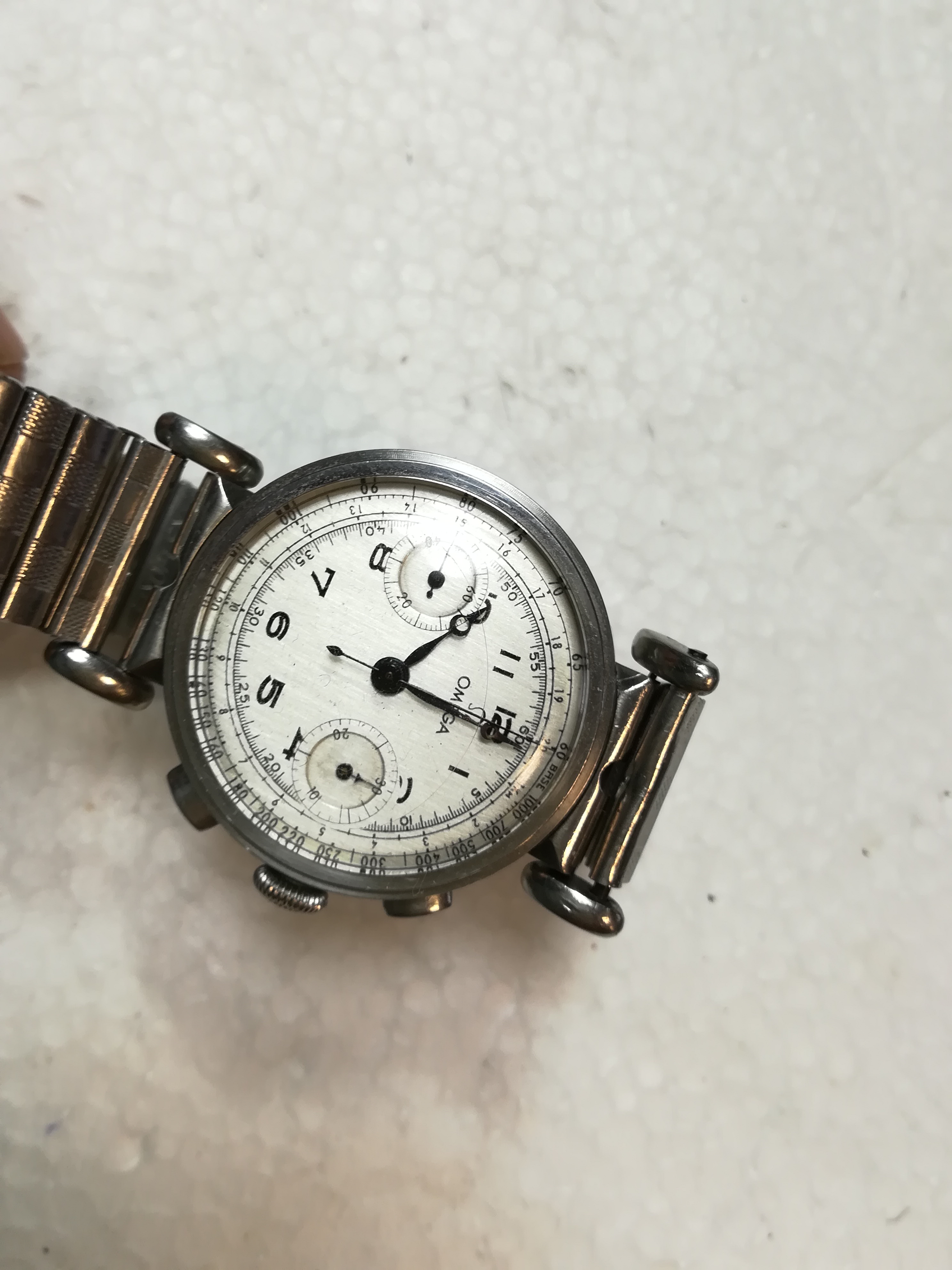

    Hello, i am from germany and want some professional Dealer or collector for help.
    i have this old omega chronograph and want to know the age, the model and best what wearth does it have.
    can me help someone ?
    IMG_20171223_100035.jpg IMG_20171223_100042.jpg IMG_20171223_100132.jpg IMG_20171223_100145.jpg IMG_20171223_100232_1.jpg IMG_20171223_100242.jpg IMG_20171223_100249.jpg IMG_20171223_100300.jpg
  2. uwsearch Jan 12, 2018
    1,055
    1,596
    reference Ck2080, cal 33.3 chro T1 from 1941

    thanks uwsearch, and it is an original from that time ? what do you thin about the price ?

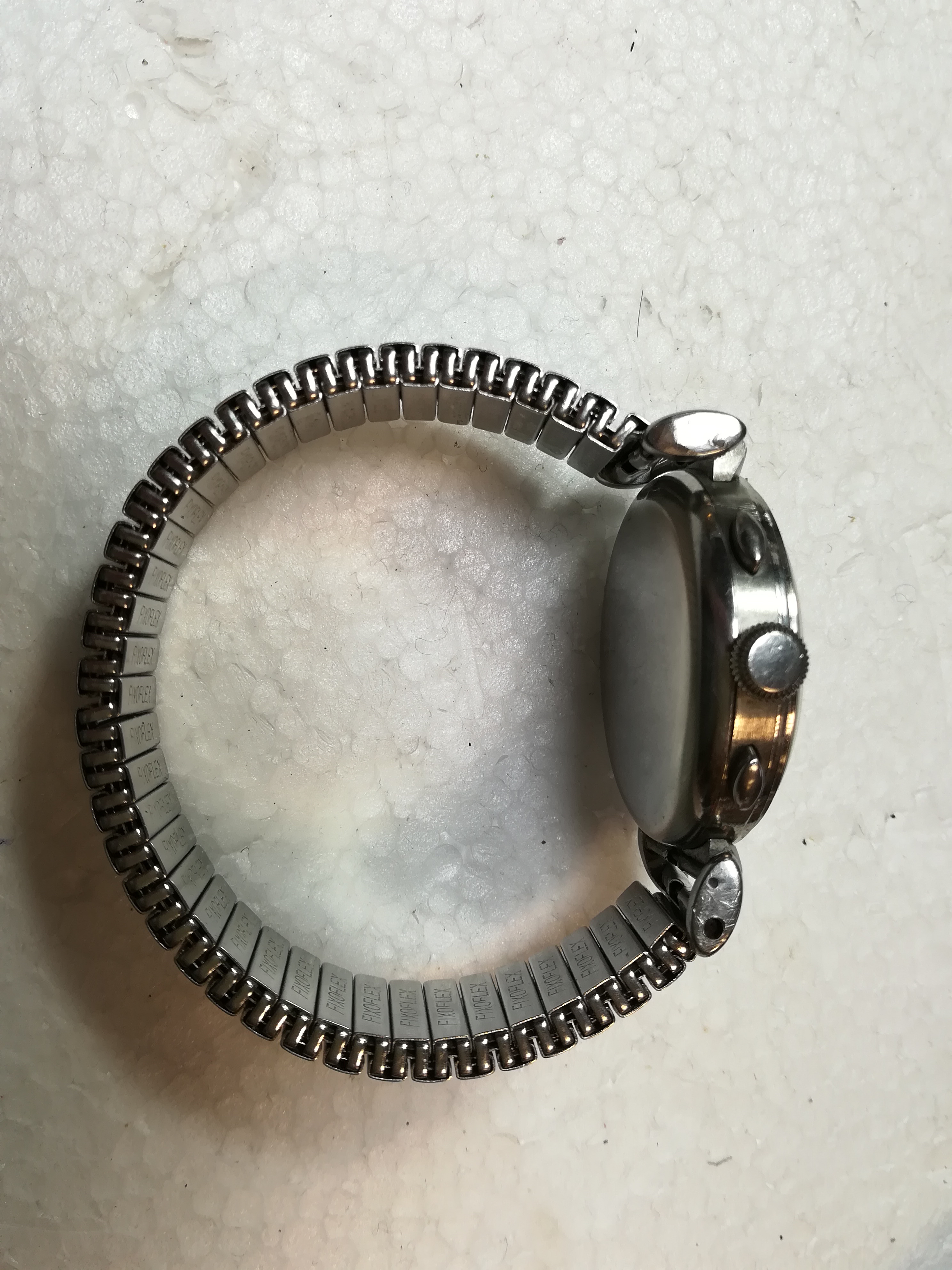

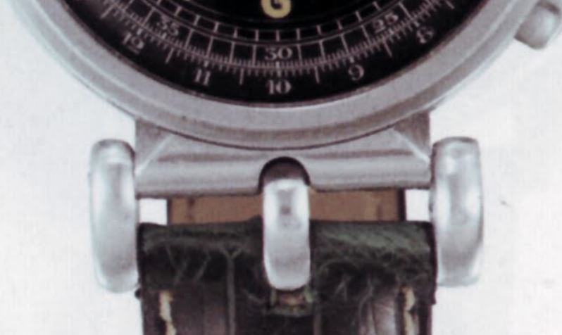

    There are 2 missing parts in the middle of the lug..
    No idea about the price, let's say from 500 to 20'000, put it on Ebay to get the price.

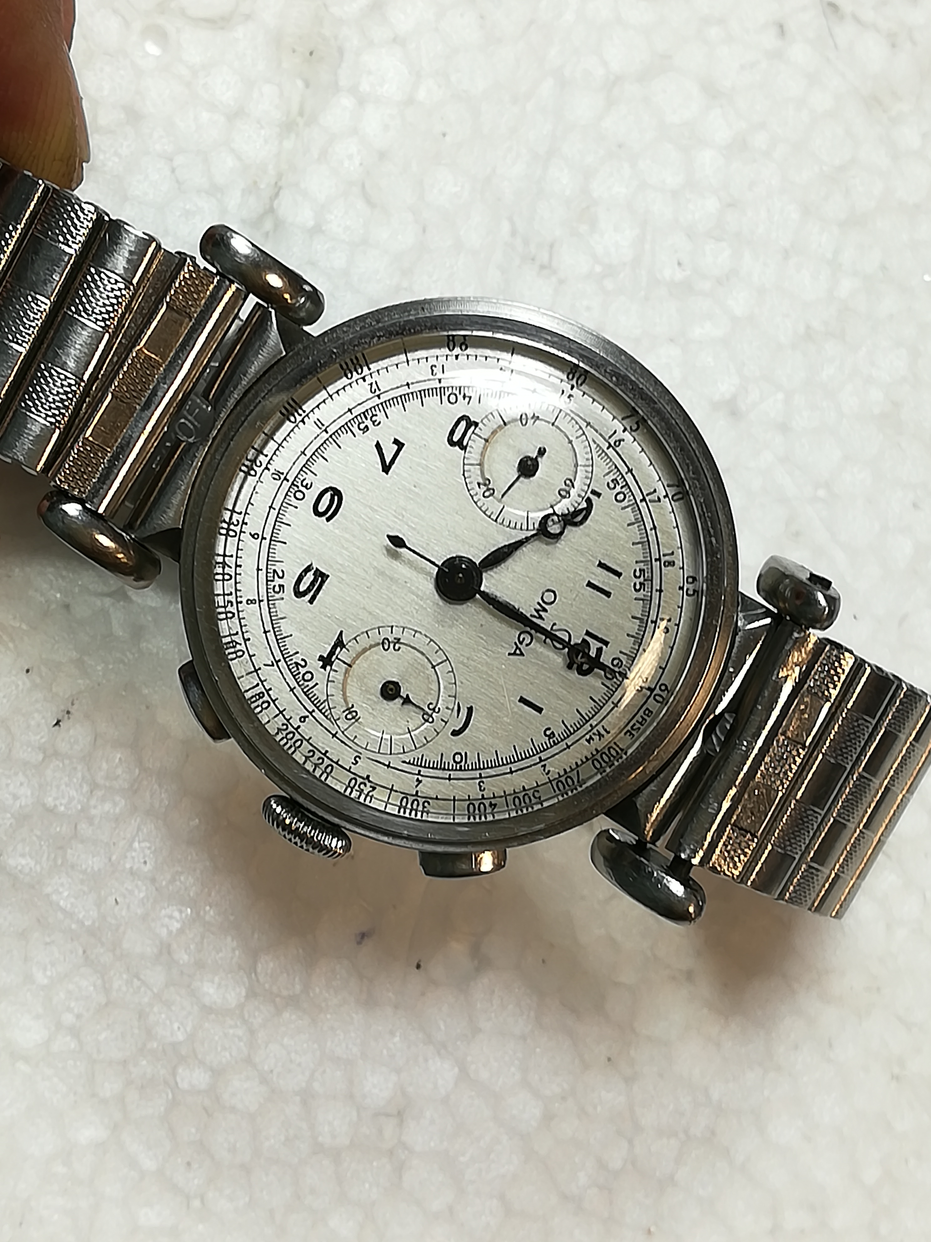

    The repainted dial will hurt value a lot.

    OK thanks, but i dont unterstand what parts a missing ??

    the dial is not from this time ? was it black ?

    Who knows? There were probably a lot of different dials available at that time, some of them black, some of them silver or other colours :)
  11. gatorcpa ΩF InvestiGator Staff Member Jan 12, 2018
    12,205
    15,718
    Not even close. Probably refinished within the last 10 years.
    There is no way to know the original color of the dial. That was destroyed when it was refinished.

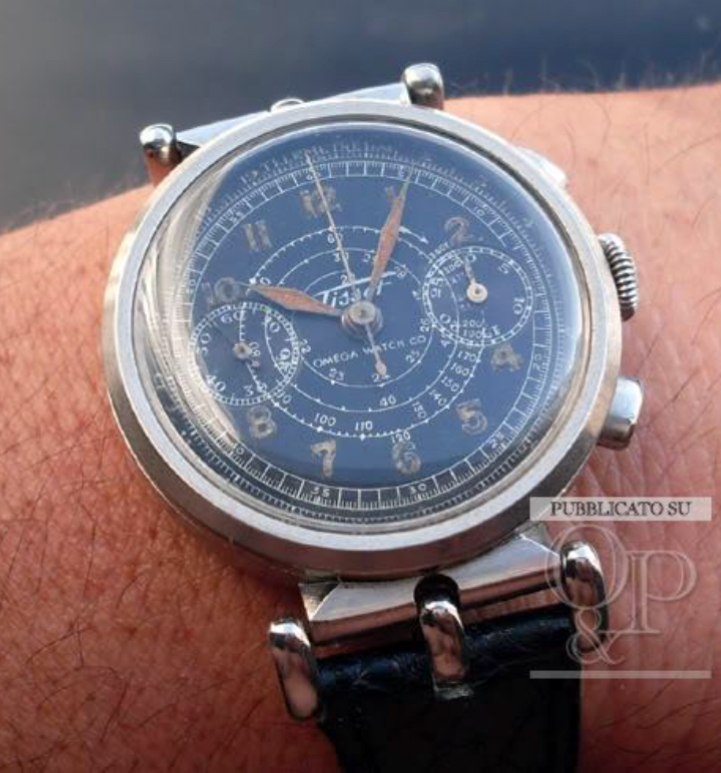

    The original may have looked something like this:
    Random image pulled from the internet. Detail of a photo originally posted by Douglas Gravina.
    Some of these were co-branded by Omega and Tissot. This was common in the 1930’s.
    You still have a very collectible watch even though it is not in great condition.

    There were silver dials too, check AJTT 536
