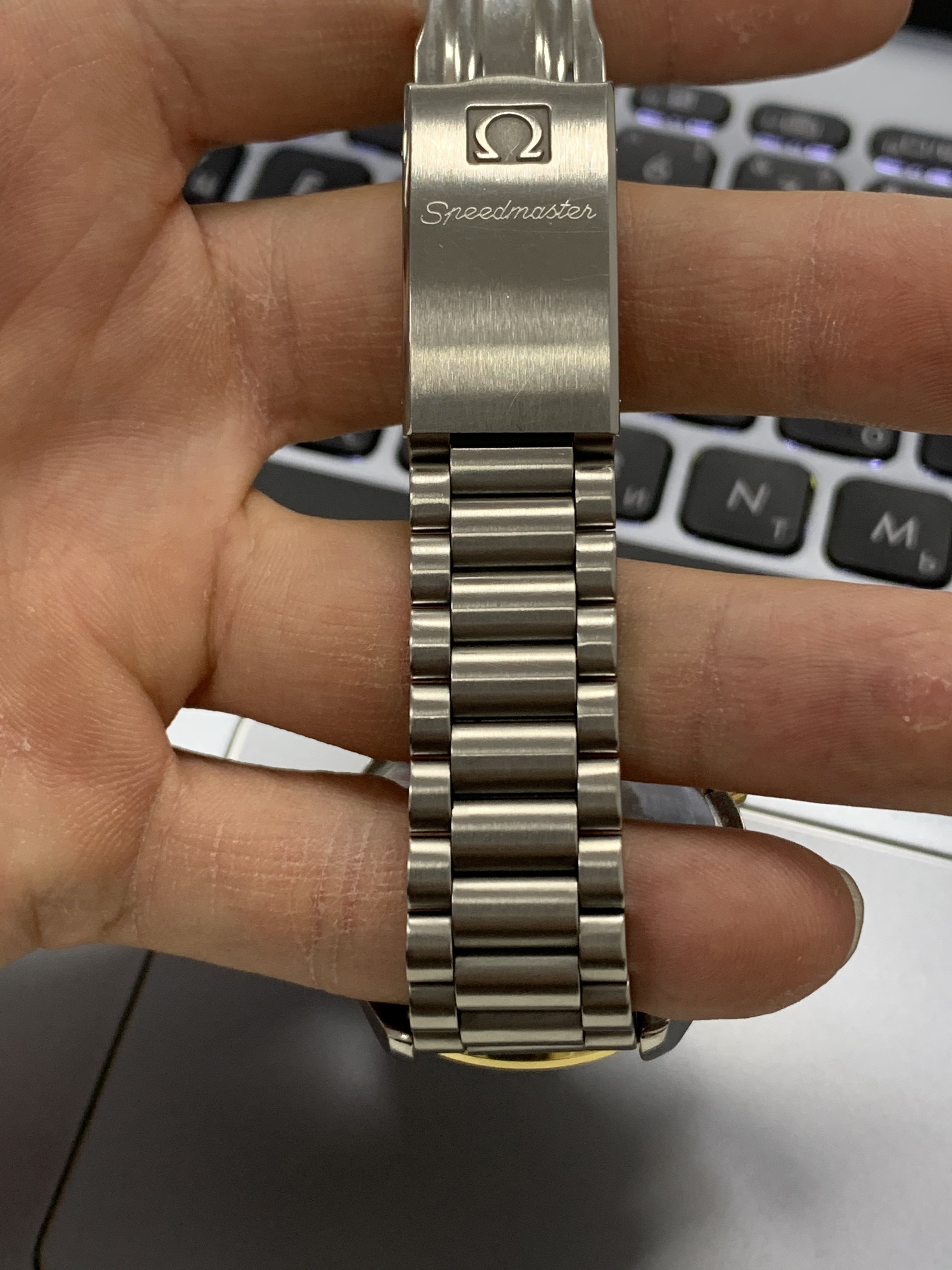

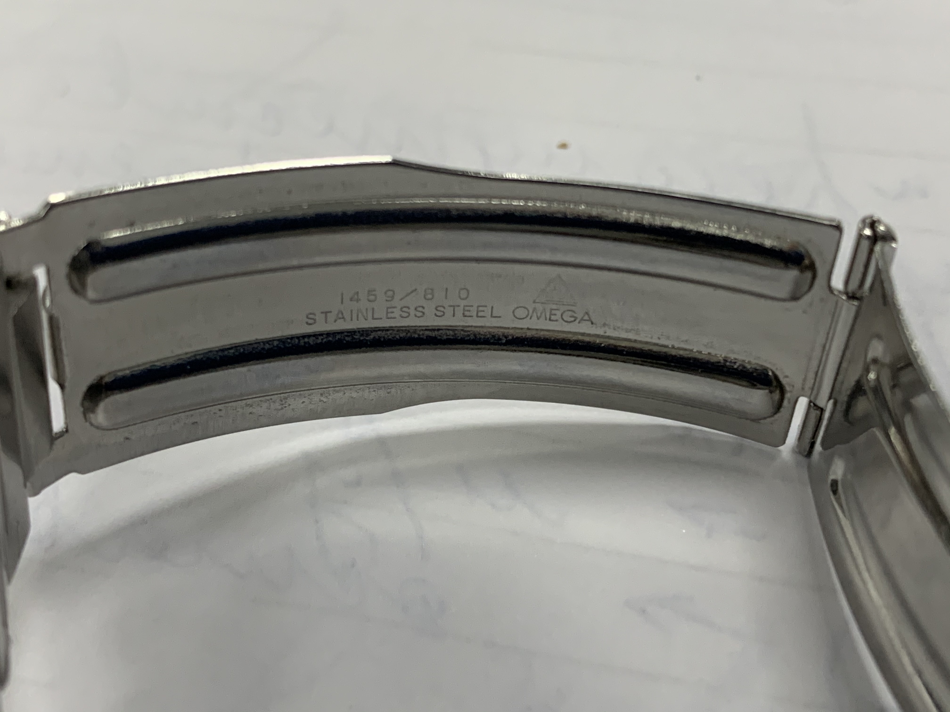

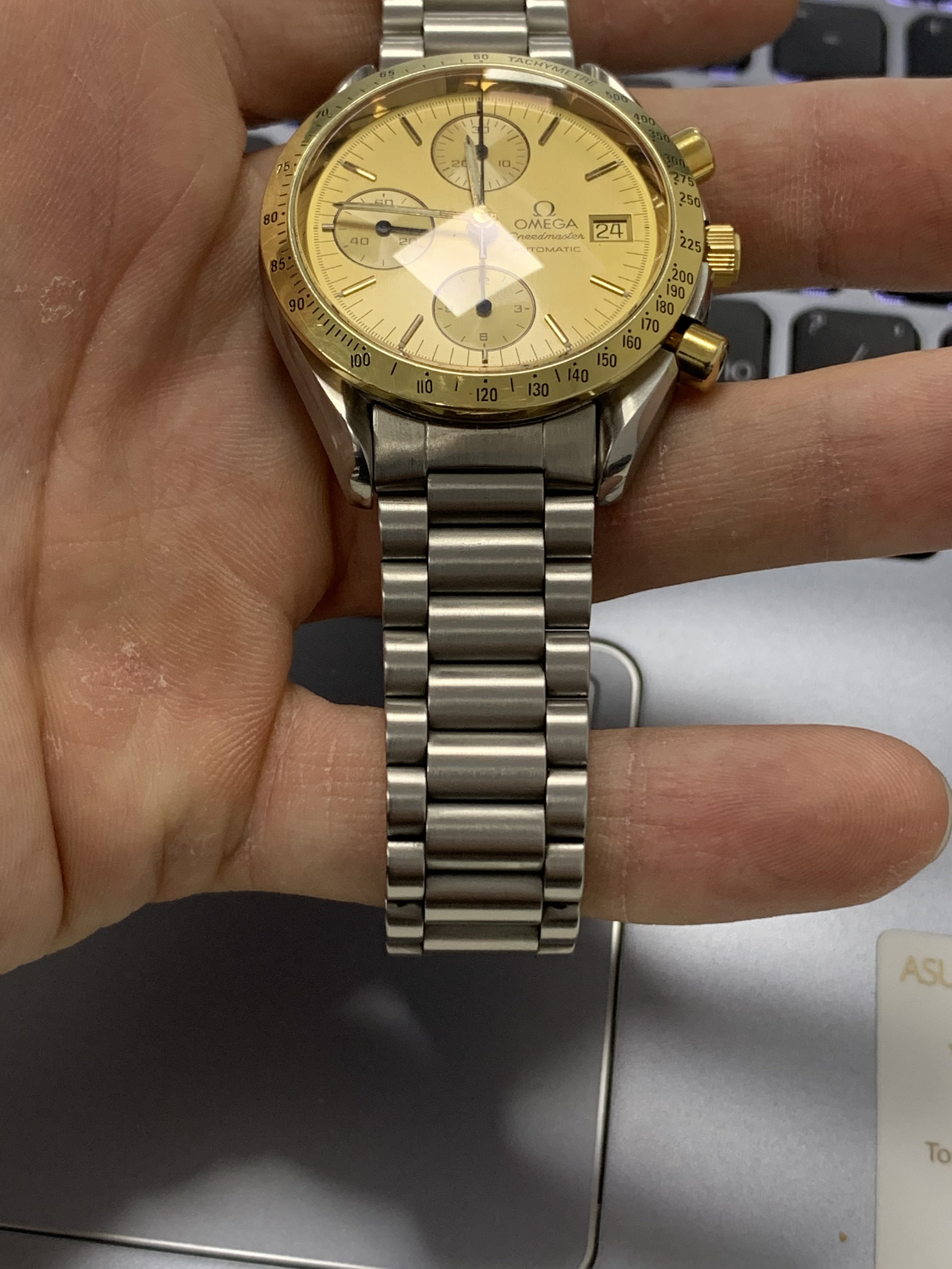

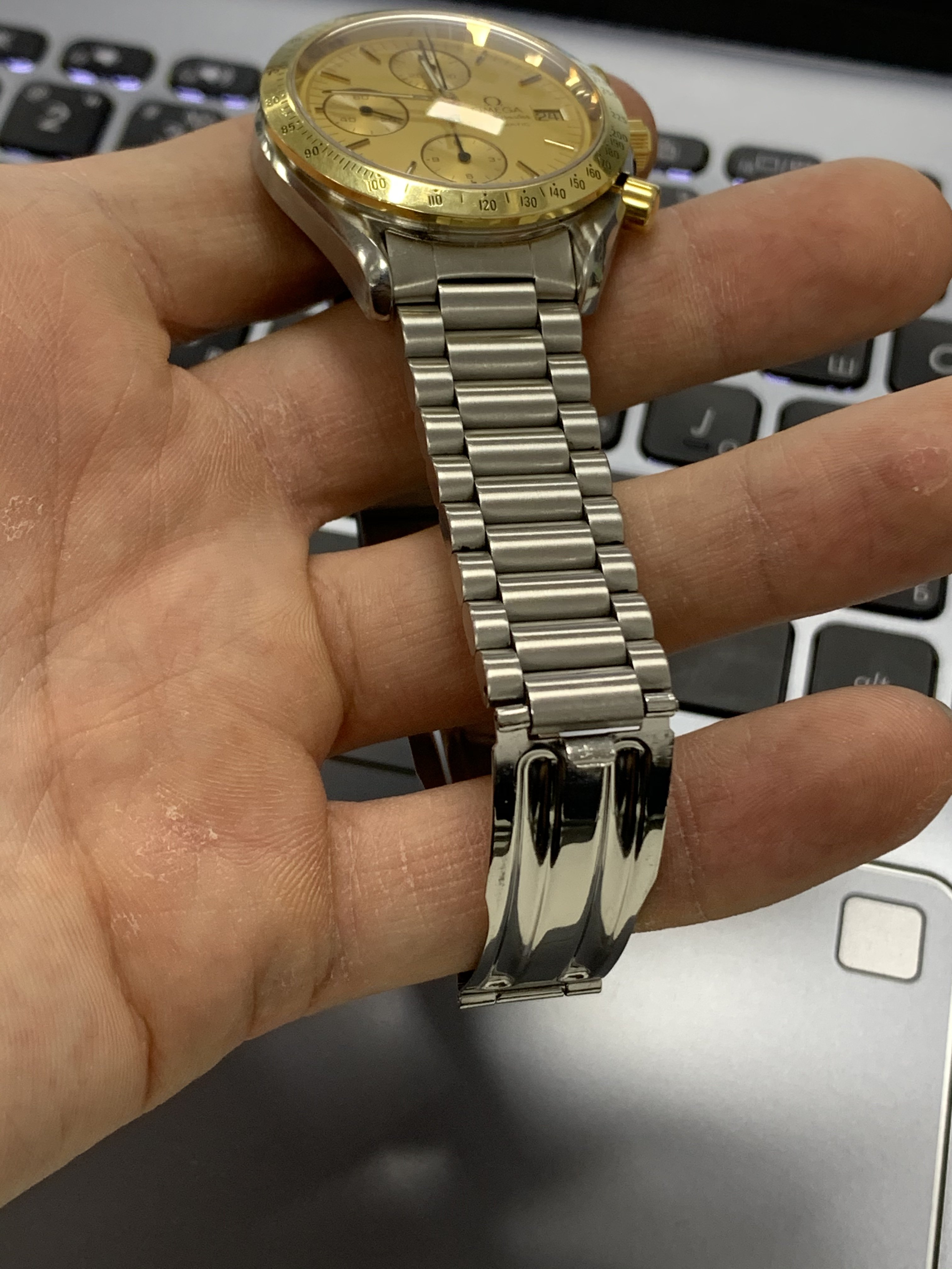

Also - there is a 1459 bracelet combined with 810 links which looks very similar to rolex president and sits very comfortable on the wrist. I've sourced one in mint condition a year ago here on OF with no end links. 810 end links are very hard to find so I found the 605 end links on eBay and the fit supernice to the bracelet. Here is mine
