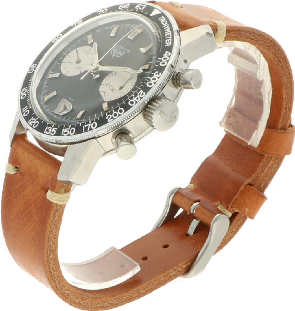

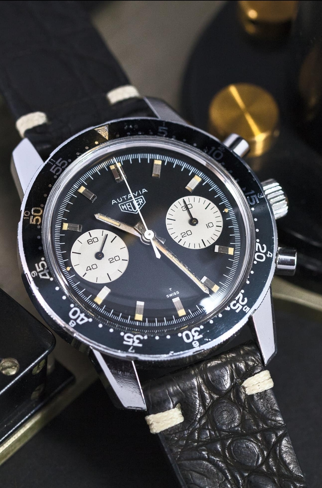

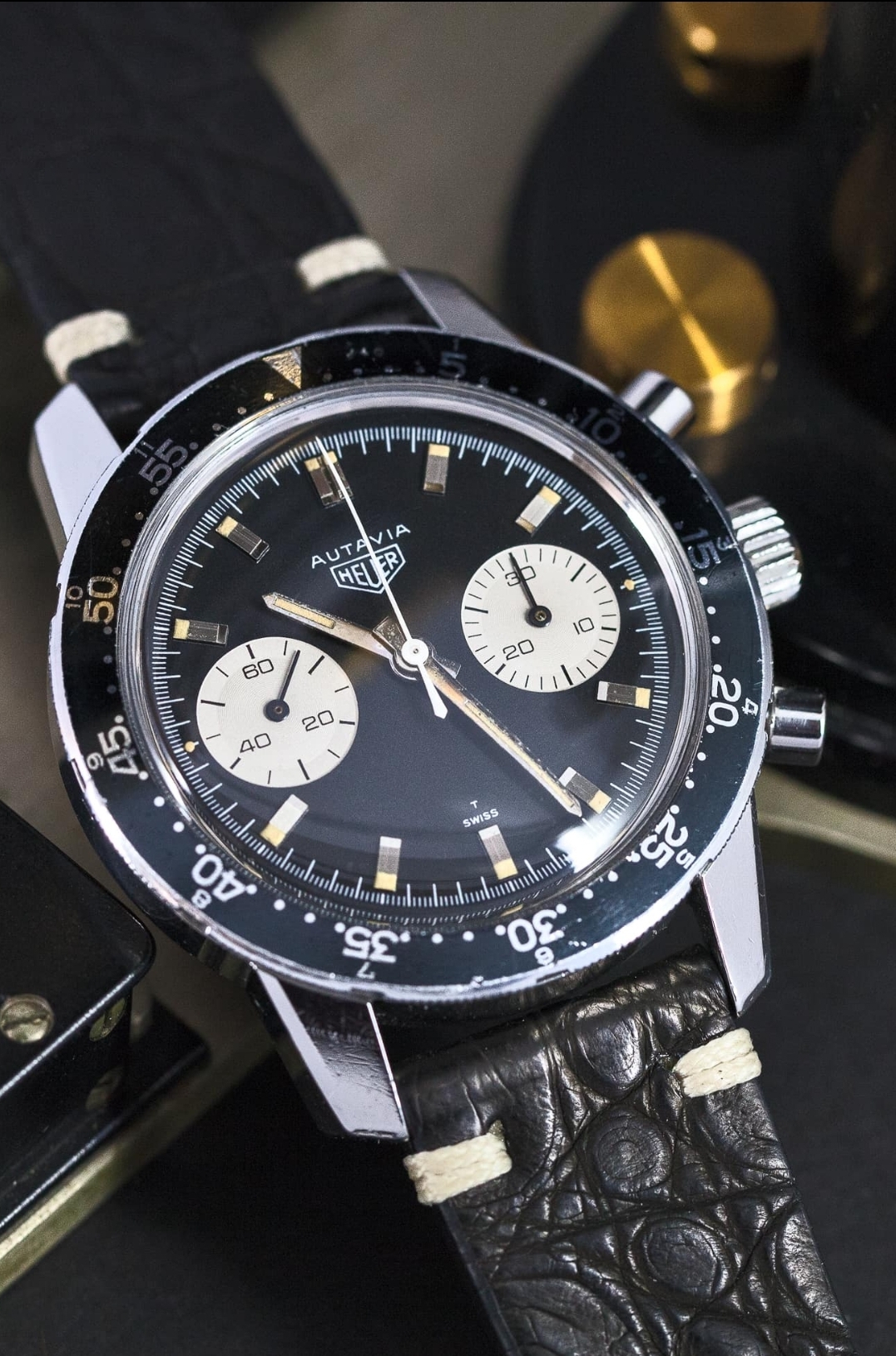

Which one would you choose? Autavia heuer 7763 or 7863? Update: final result
5,026
18,607

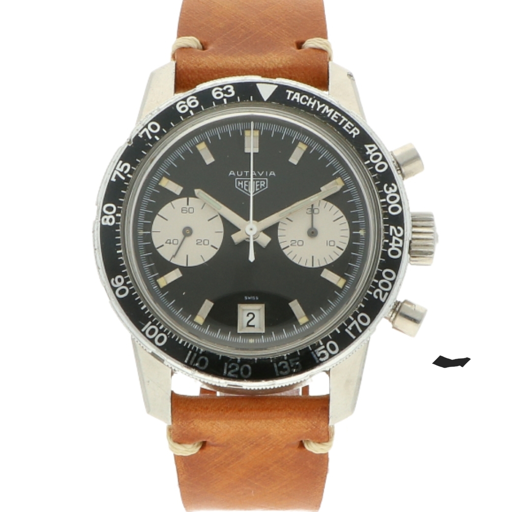

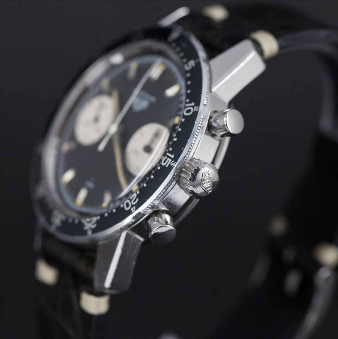

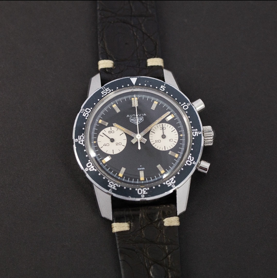

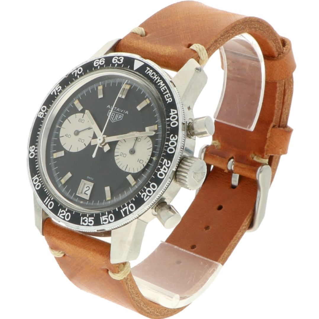

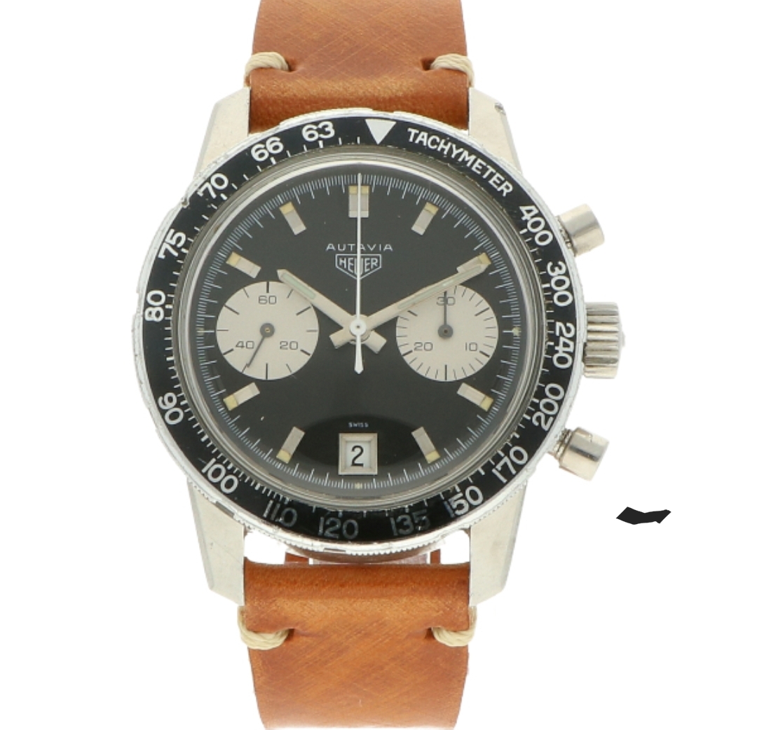

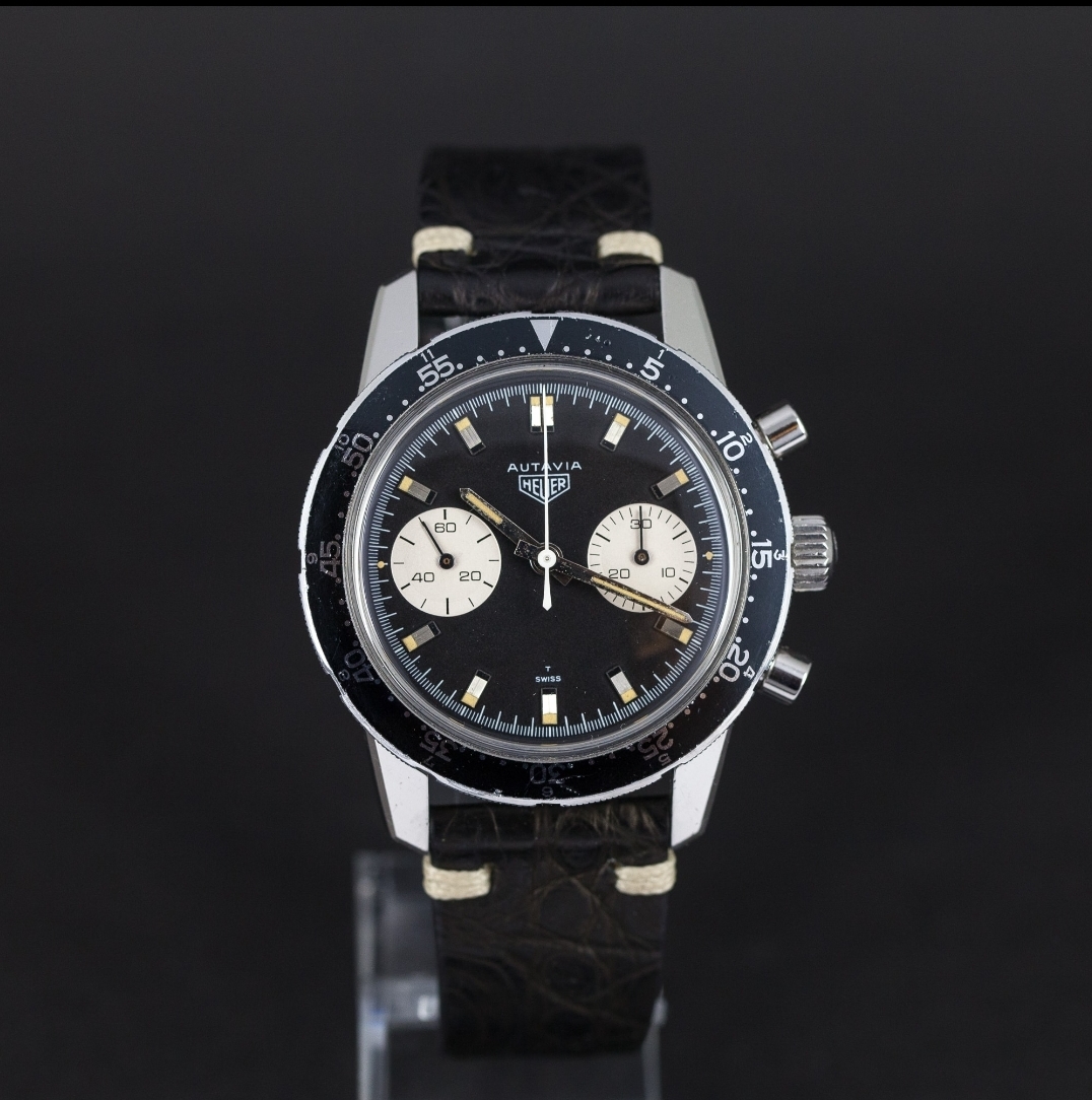

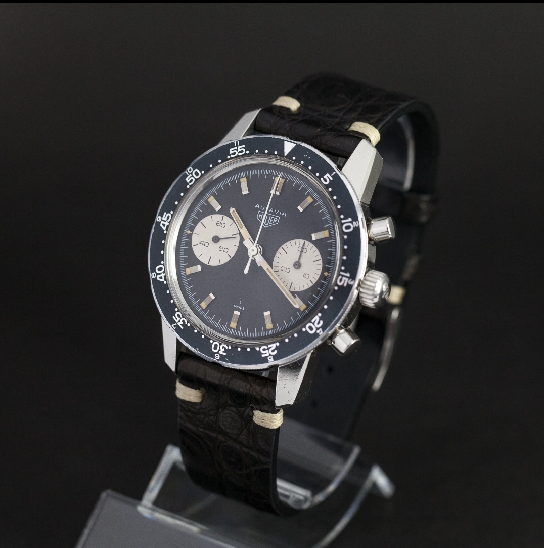

If you could choose between the two, which one would you choose? Both can be bought probably for app EUR 6500.

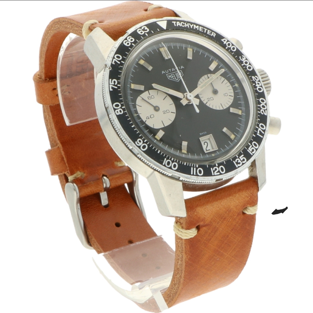

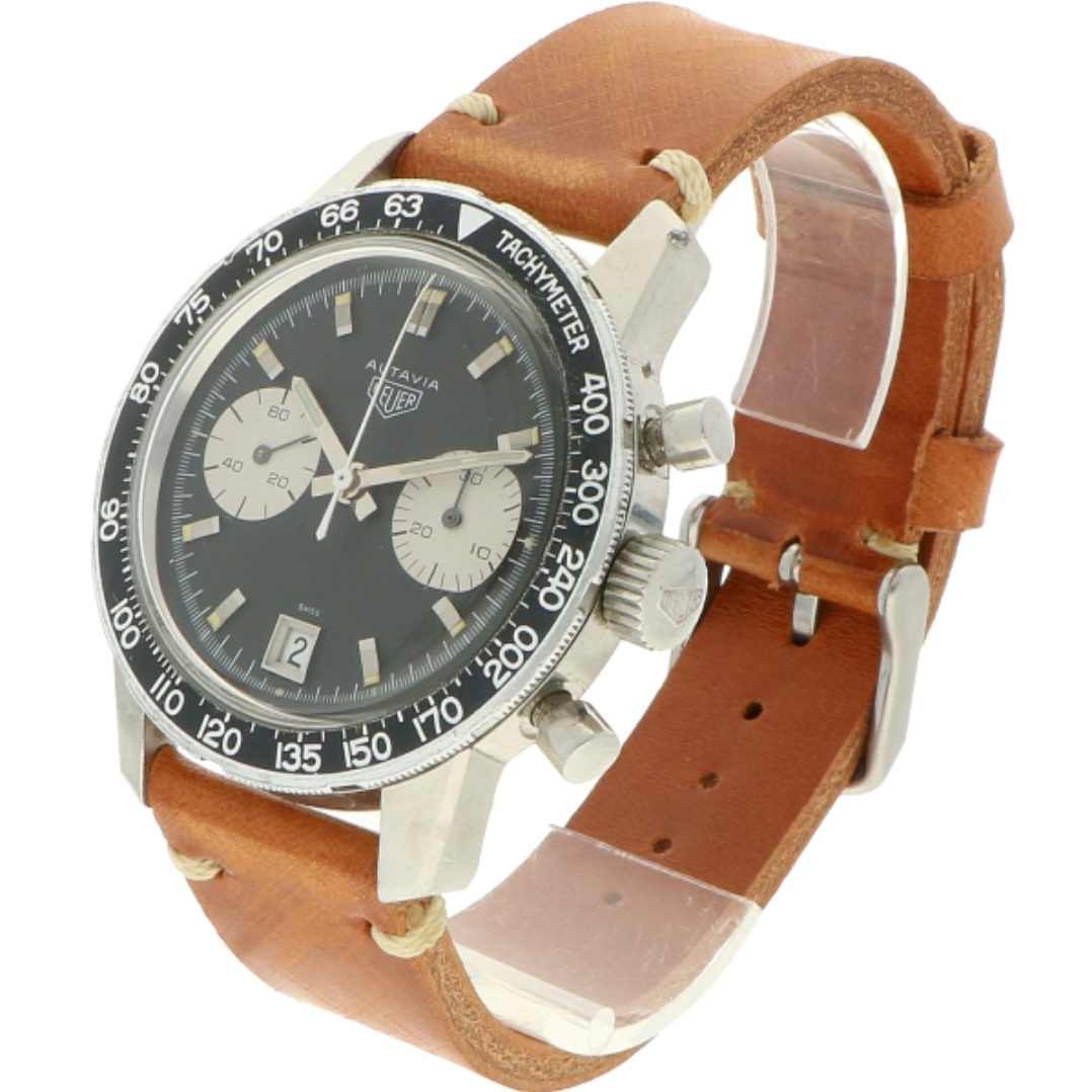

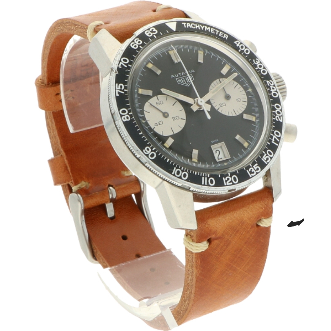

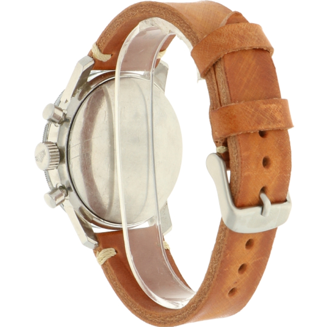

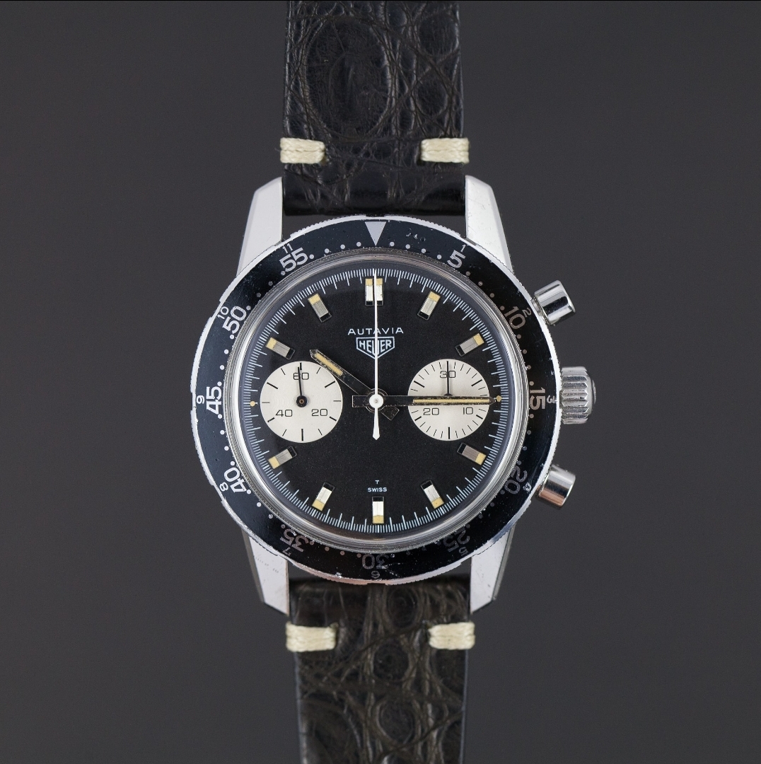

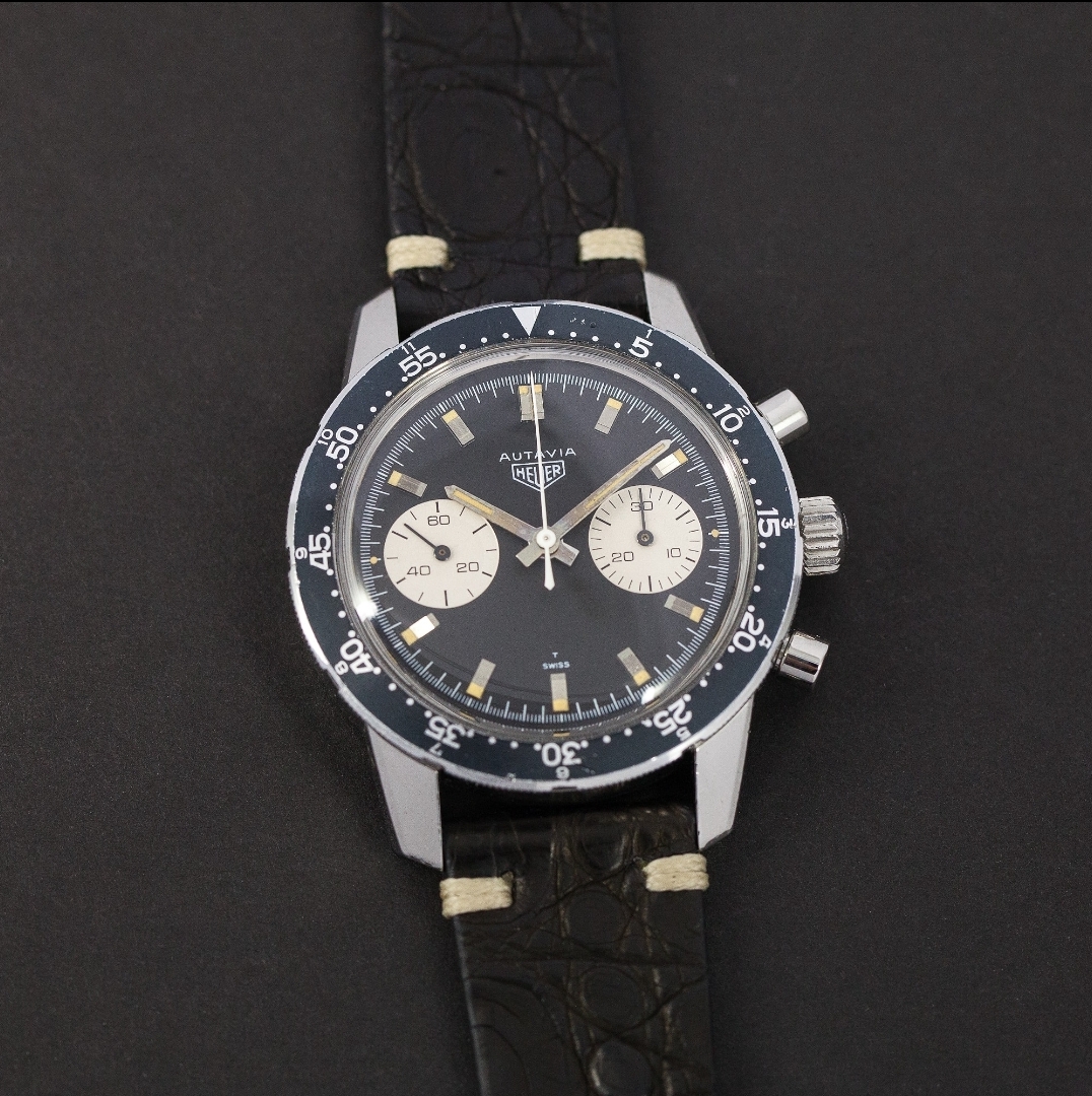

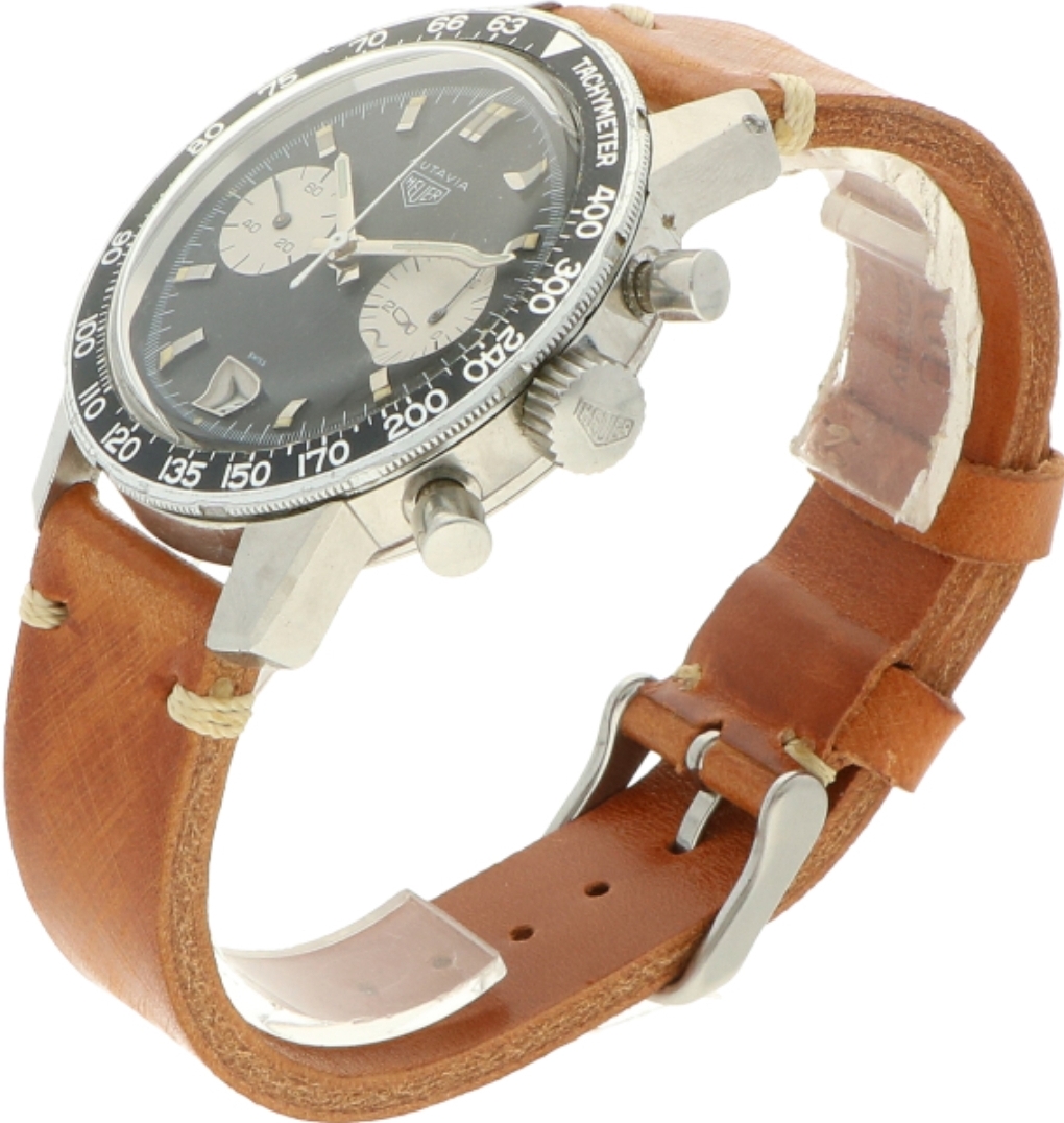

The hands of the 7863 are probably relumed, the lower pusher is questionable and the bezel got a ding.

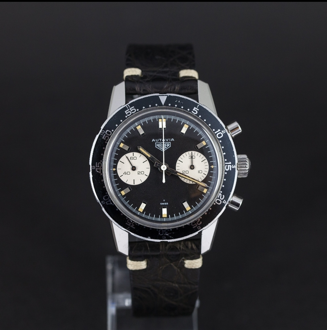

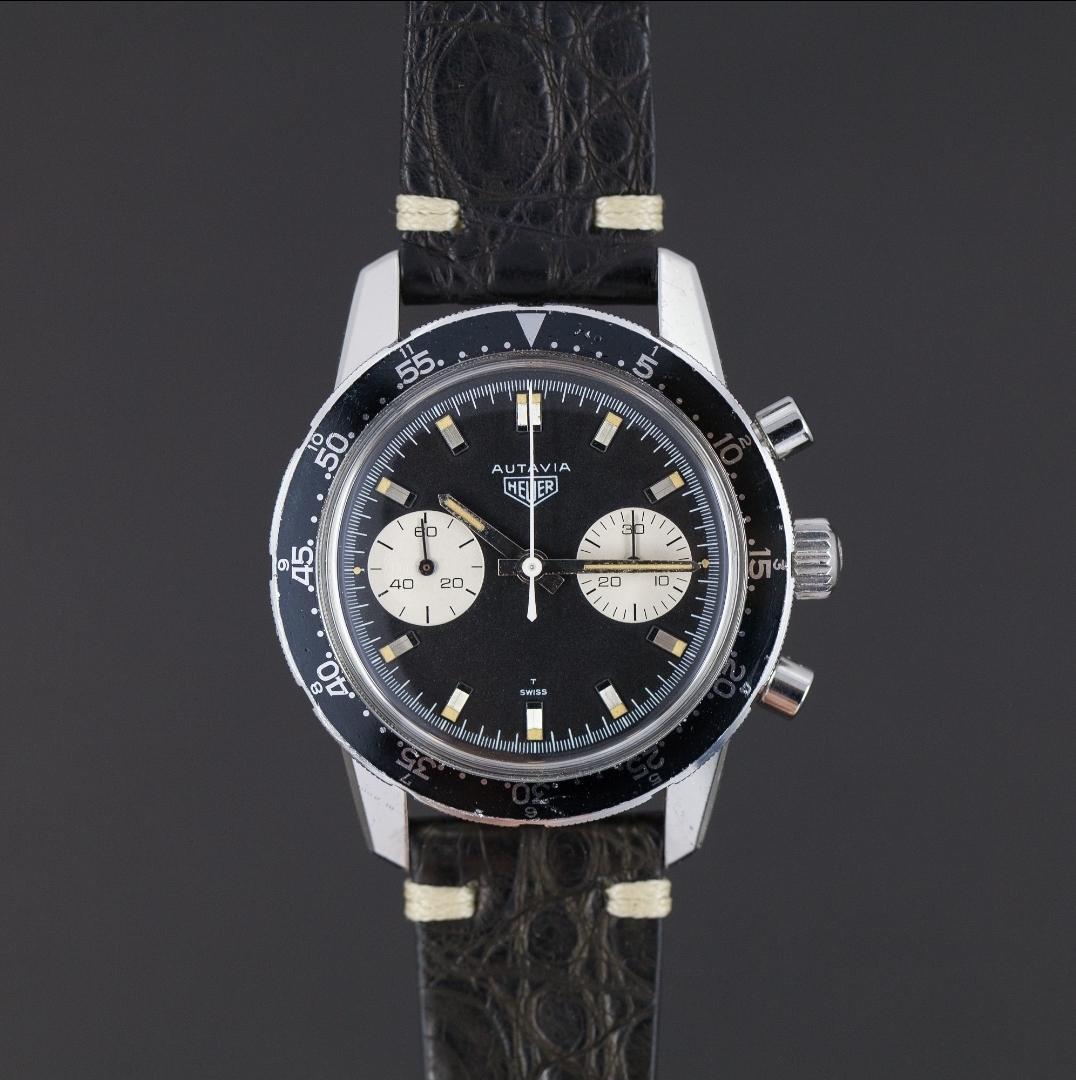

Not sure what's wrong with the 7763. To me it looks good. It's equipped with a valjoux 7733. The dealer said he bought it from the first owner.

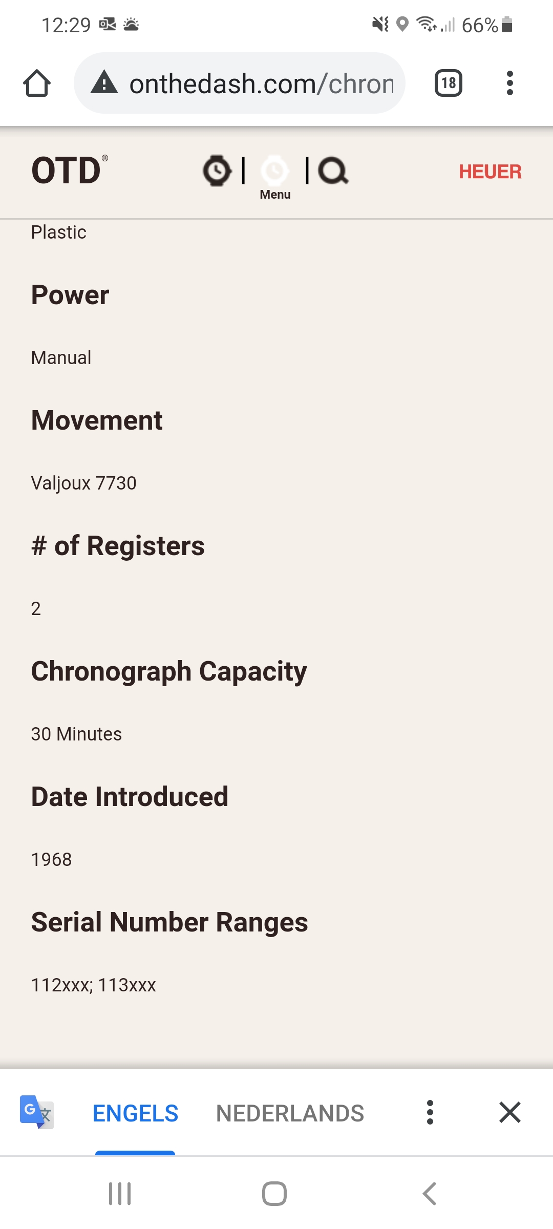

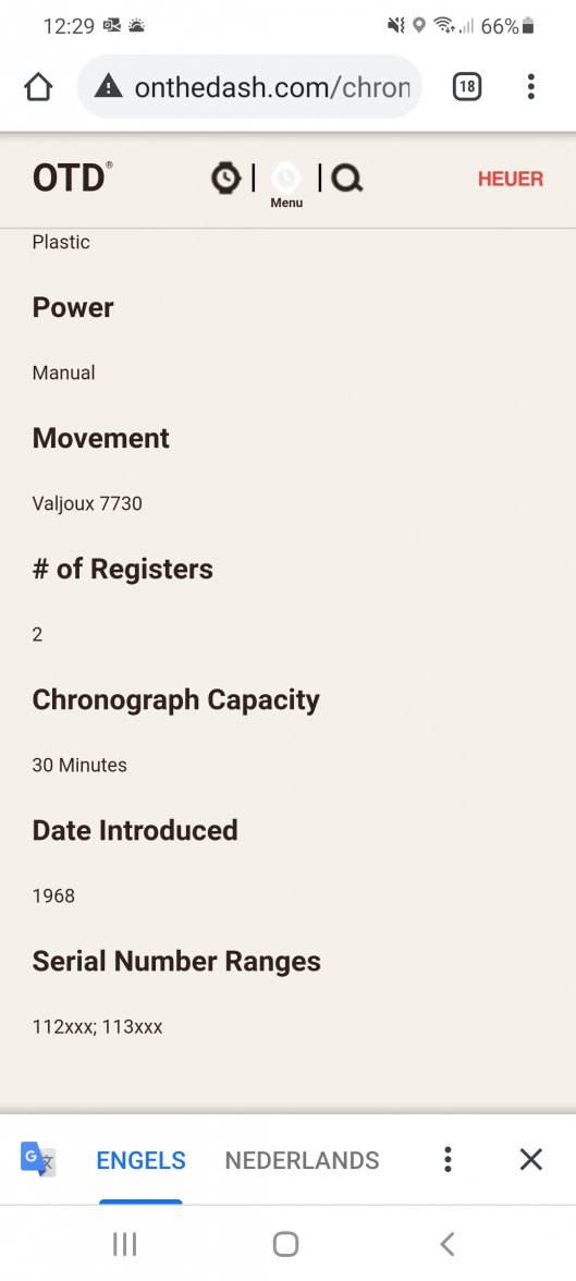

By the way, the info here about which model came with which caliber does'nt look complete.
http://www.onthedash.com/autavia-early-in-depth/
If people use this as a source, this source does'nt mention the 7863 came also with a 7734 valjoux and the 7763 came also with a valjoux 7733.

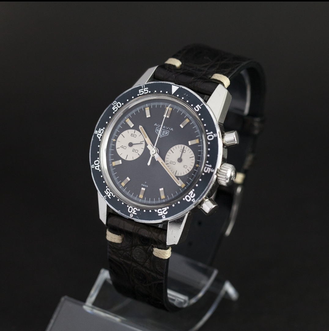

I tend to the 7763. It looks in better condition and more original. Also 40mm case. Cleaner dial.
1,615
3,862
Me too. Cleaner dial, useful bezel (who needs a turning tach scale?) Also, (only from quickly looking at it), it seems to be a cleaner watch overall. I somehow don't like the look of the second one.
6500 is a lot for what it is though (I don't follow heuer price, I only know they are a bit silly).

7763 too; same reasons 😀
not yet mentioned but some nasty dings on the 7863 too: lug, bezel...

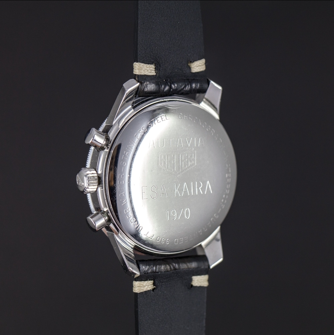

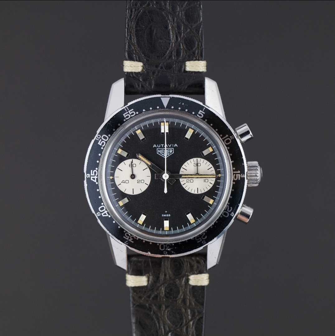

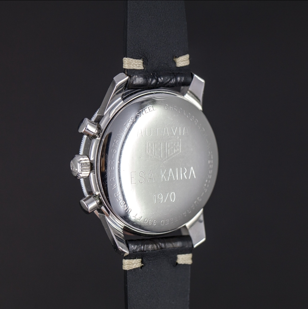

The 7763 would be my choice and not only because it has Finnish provenance. It looks "cleaner" without the date and simpler bezel.
Btw the Dealer states it has a Valjoux 7733 not a 7333. Not sure if a typo on their sales page or here.

And
Yes. Typo here. Thnx!

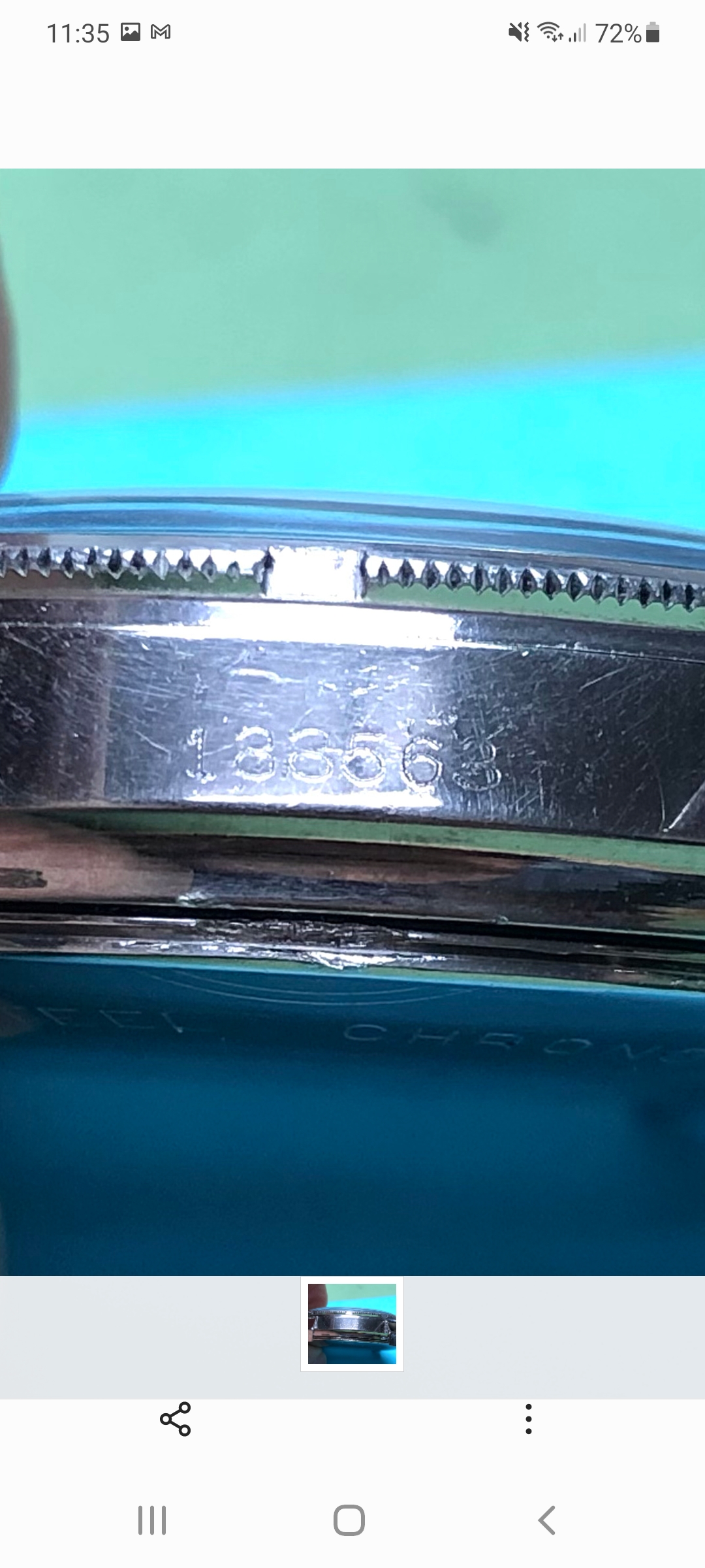

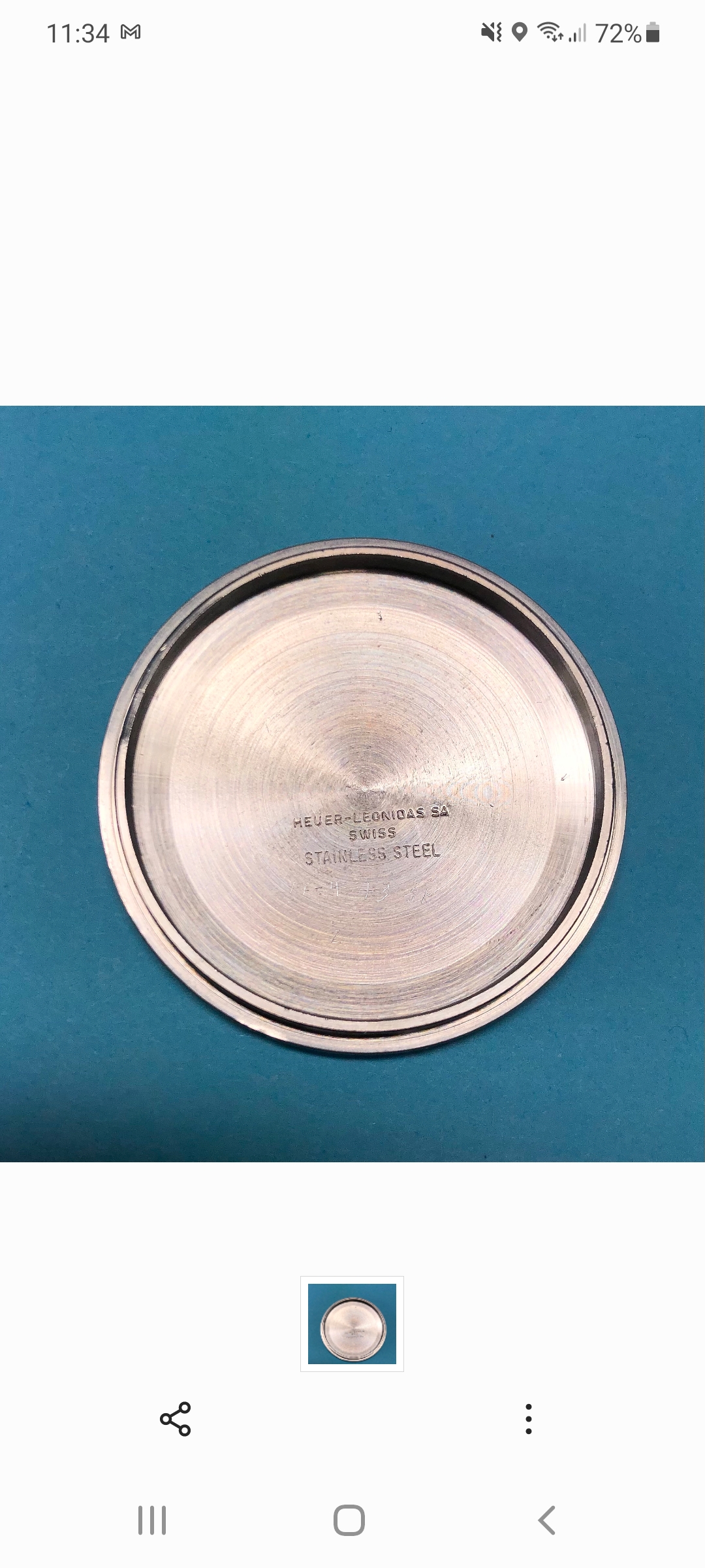

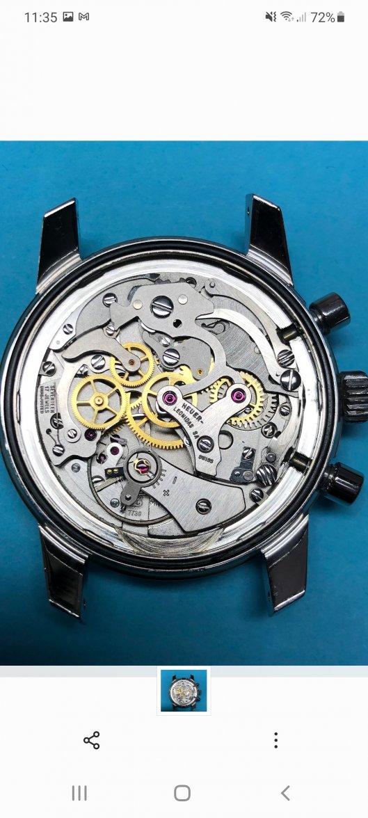

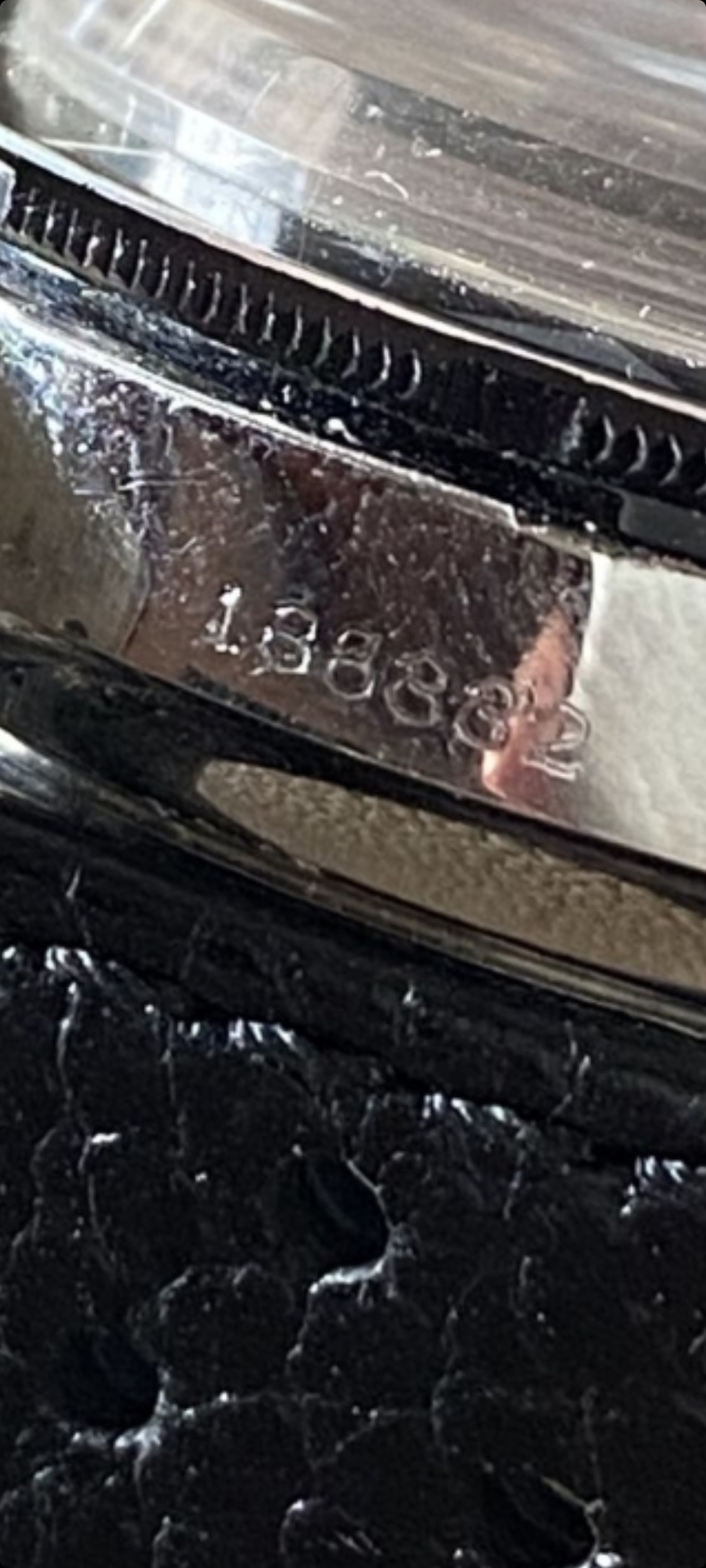

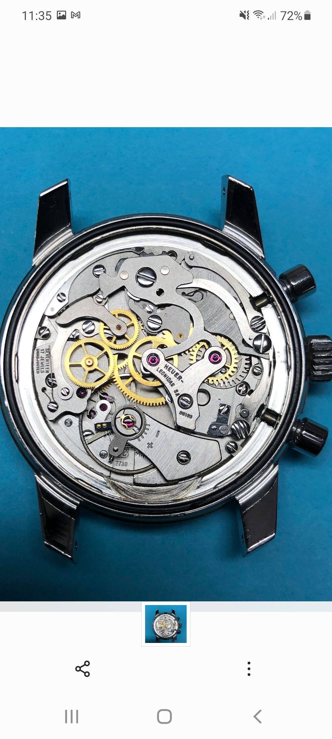

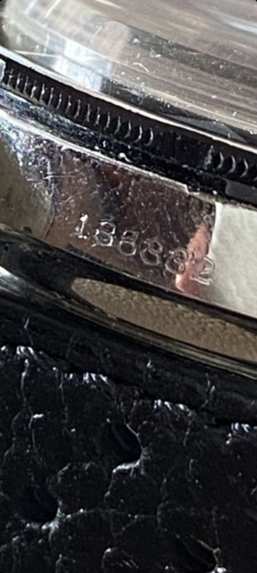

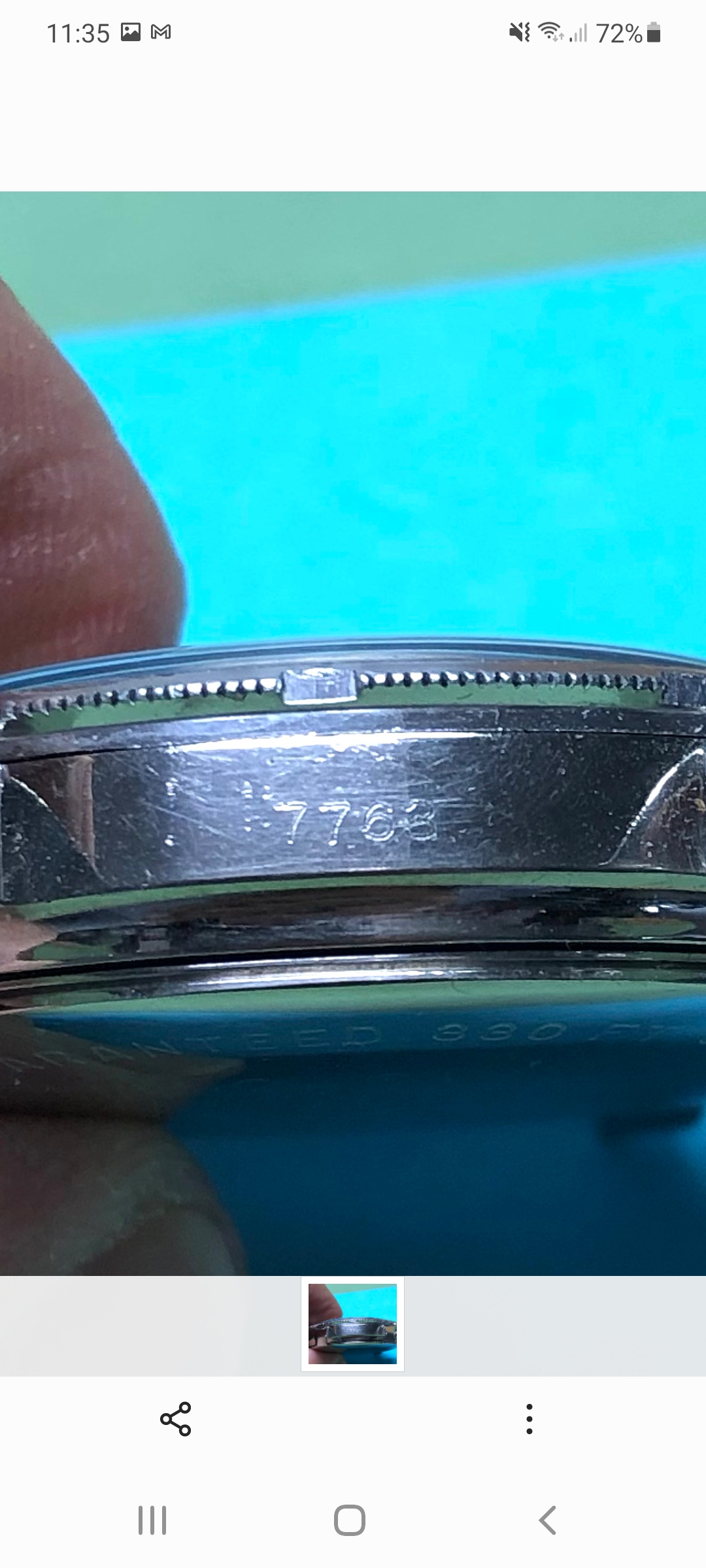

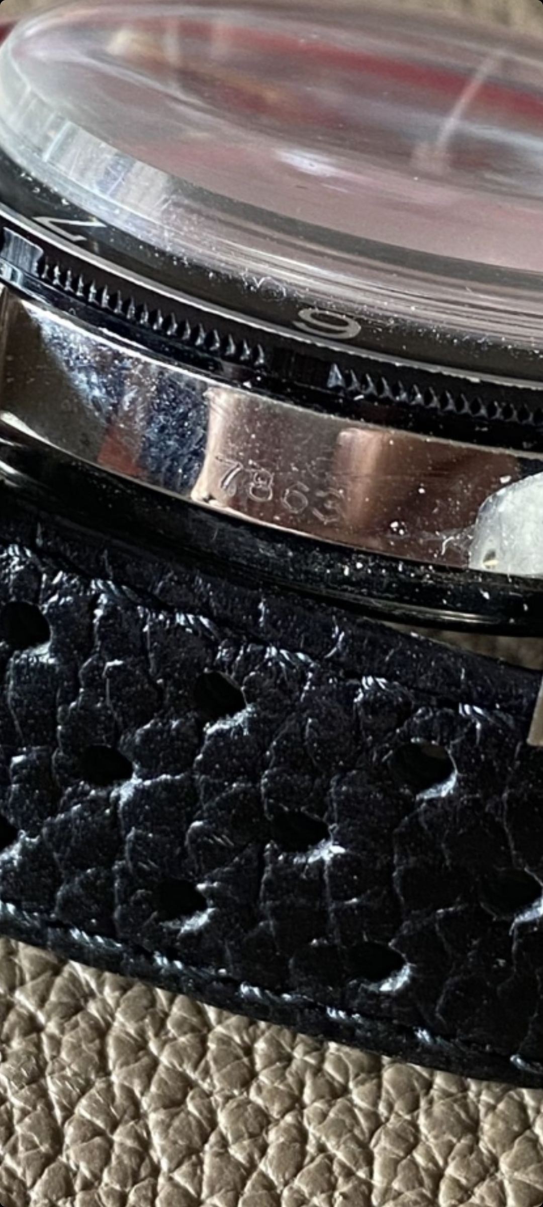

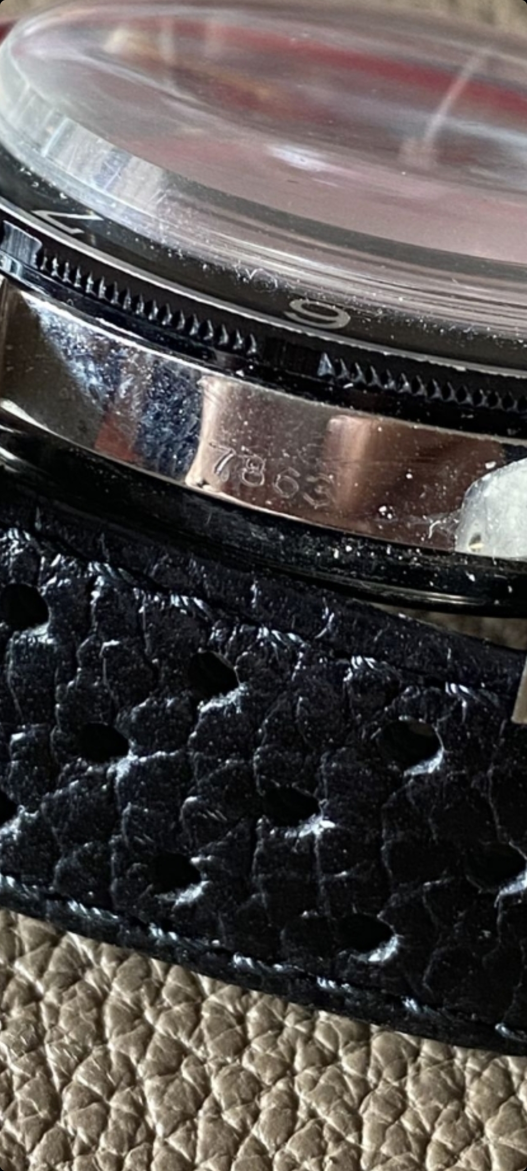

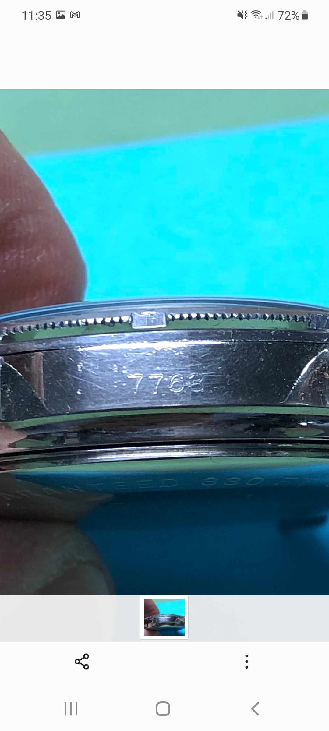

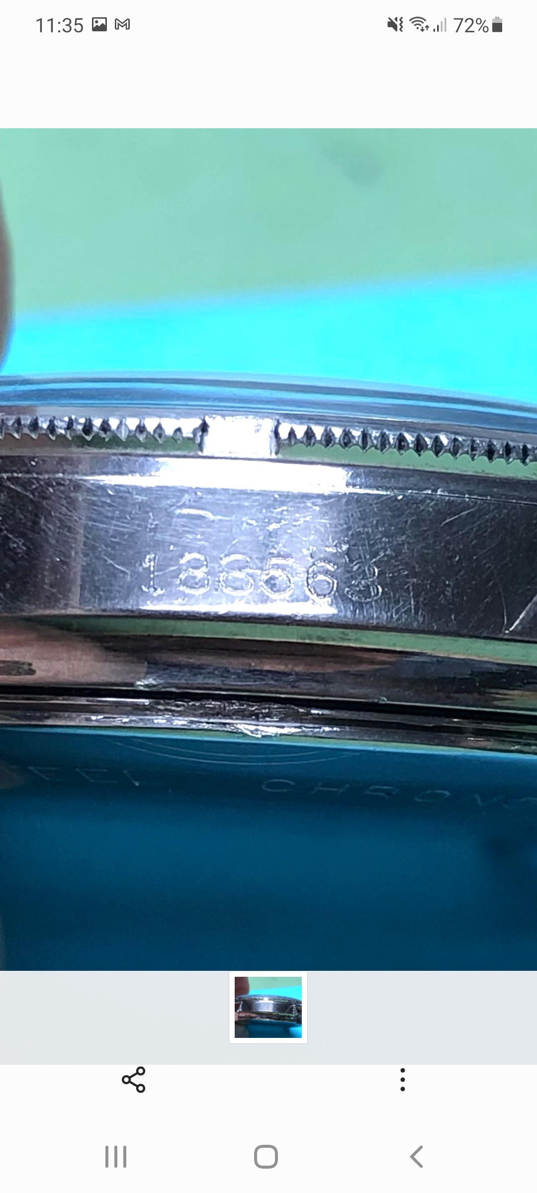

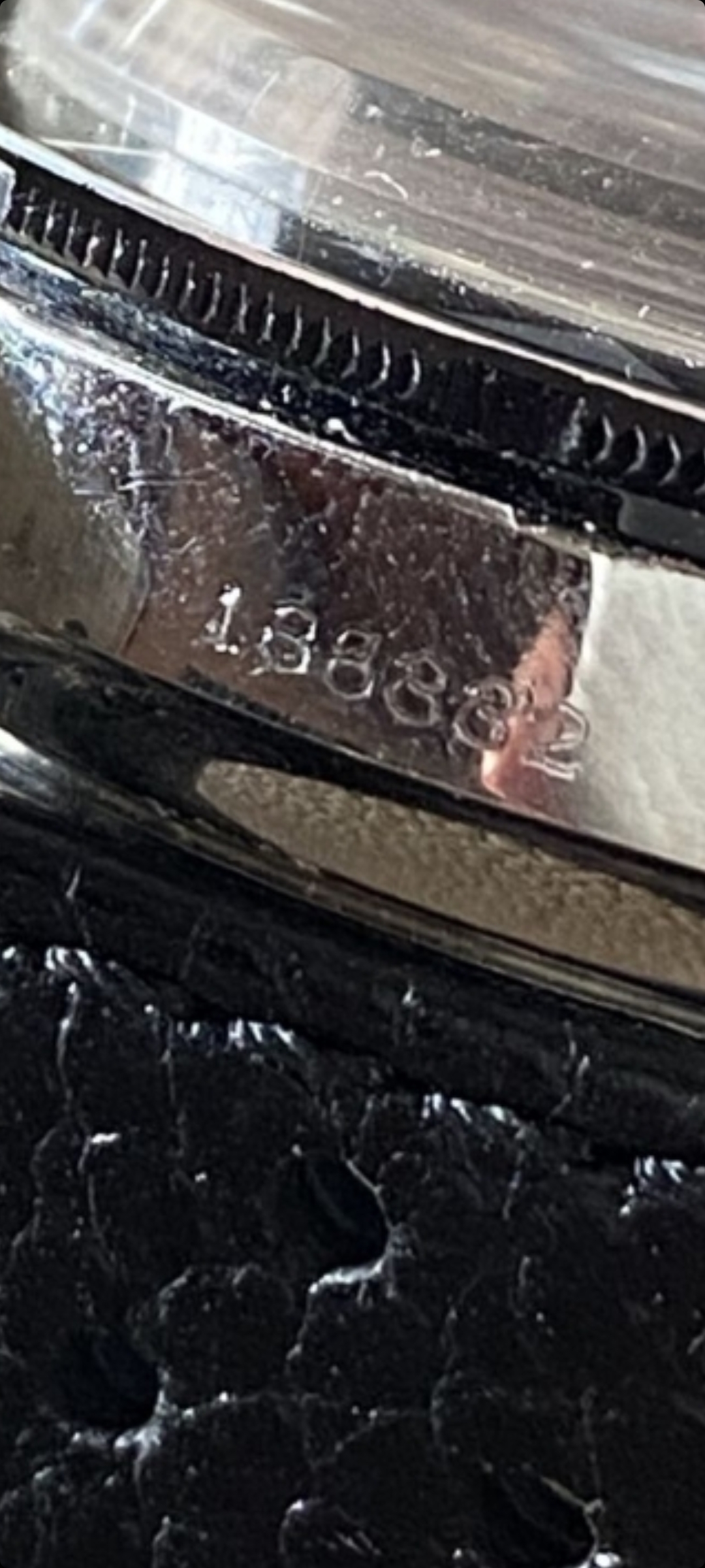

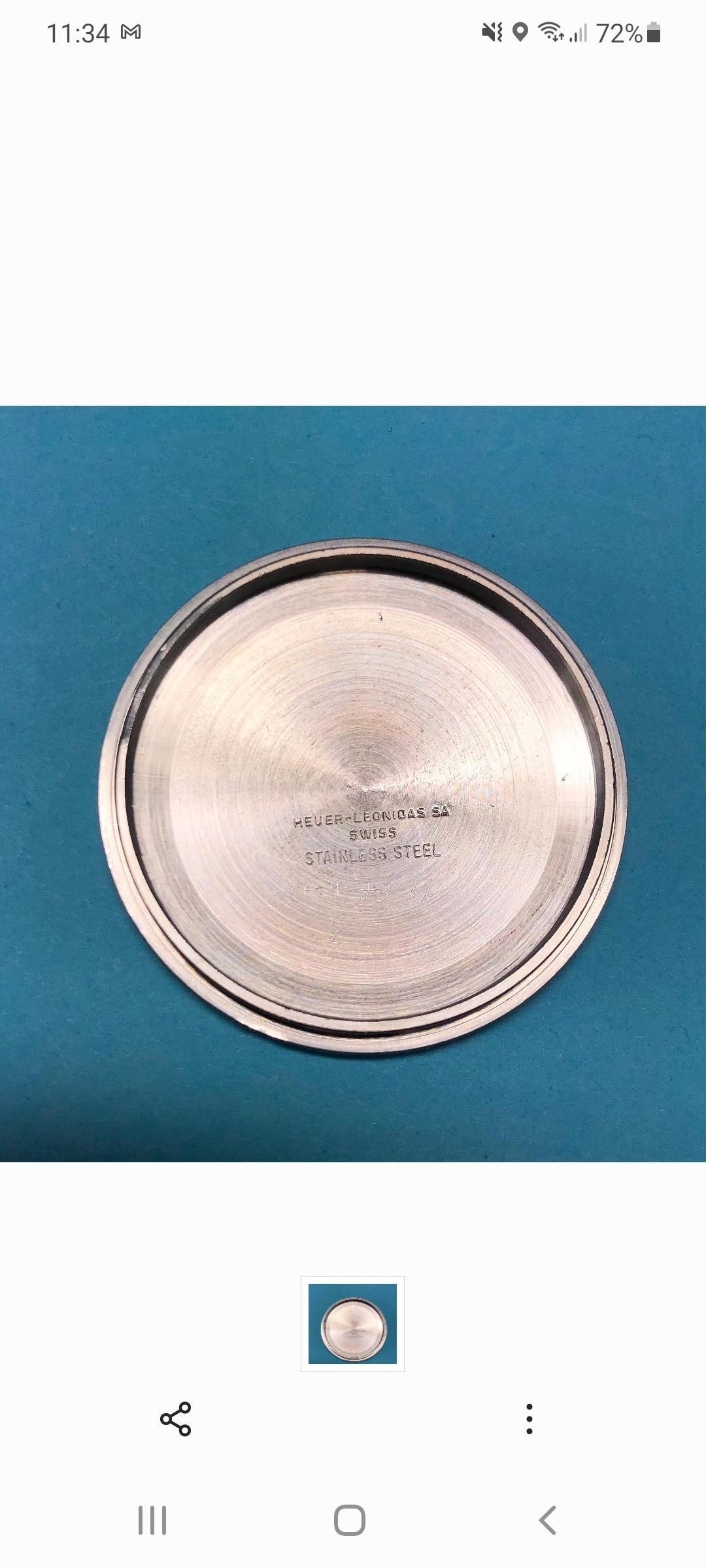

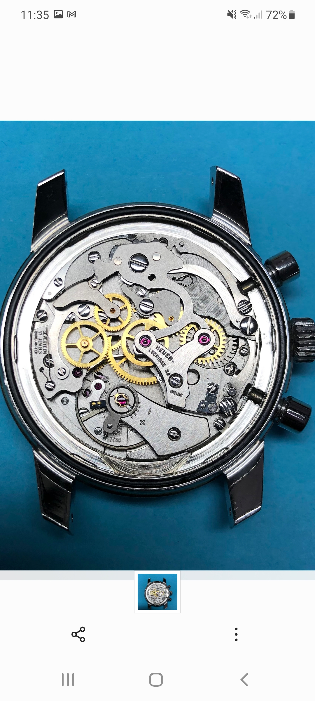

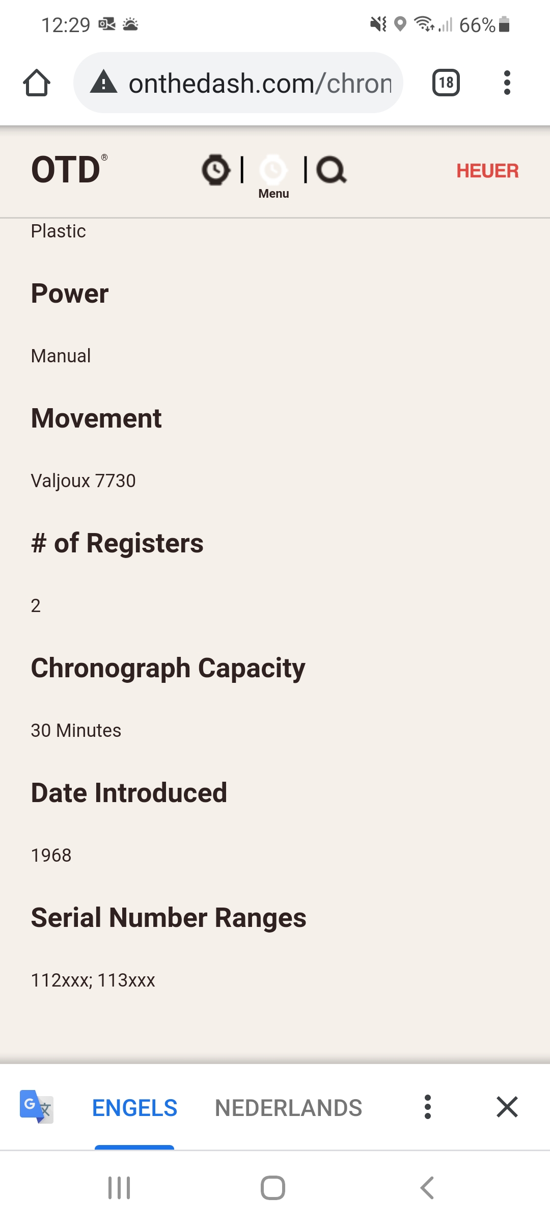

So I've received pictures of the movement and serial of the 7763. I noticed the serial number on the watch does not match Autavia Ref table from on the dash. The table suggests ref number 11xxx but this watch has a 188xxx serial number and a 7763 engraving on the other side. What is your opinion on this dial and case configuration? Does this discrepancy suggest the watch is a re cased?
Any comment or information will be extremely helpful for me. Thanks guys

Thnx! But is that book so specific that we can find the serial range regarding certain models? Does anyone have this book? If so, what does it say about the 7763c Mark 1 and serialnumbers?
3,602
9,160
The Carrera book certainly does and I cannot imagine the Autavia or Monaco versions being different. For example my 7753NS comes within the quoted range of ~4000 serials and my 3647S in one of the four quoted ranges covering 16.000 numbers -- it was in production for six times longer than the 7753s.
119
343
These books are outstanding. I’d go out on a limb and say that if you are going to buy a 6,500 dollar watch that first buying the $200 insurance policy by buying the books is a smart move.
