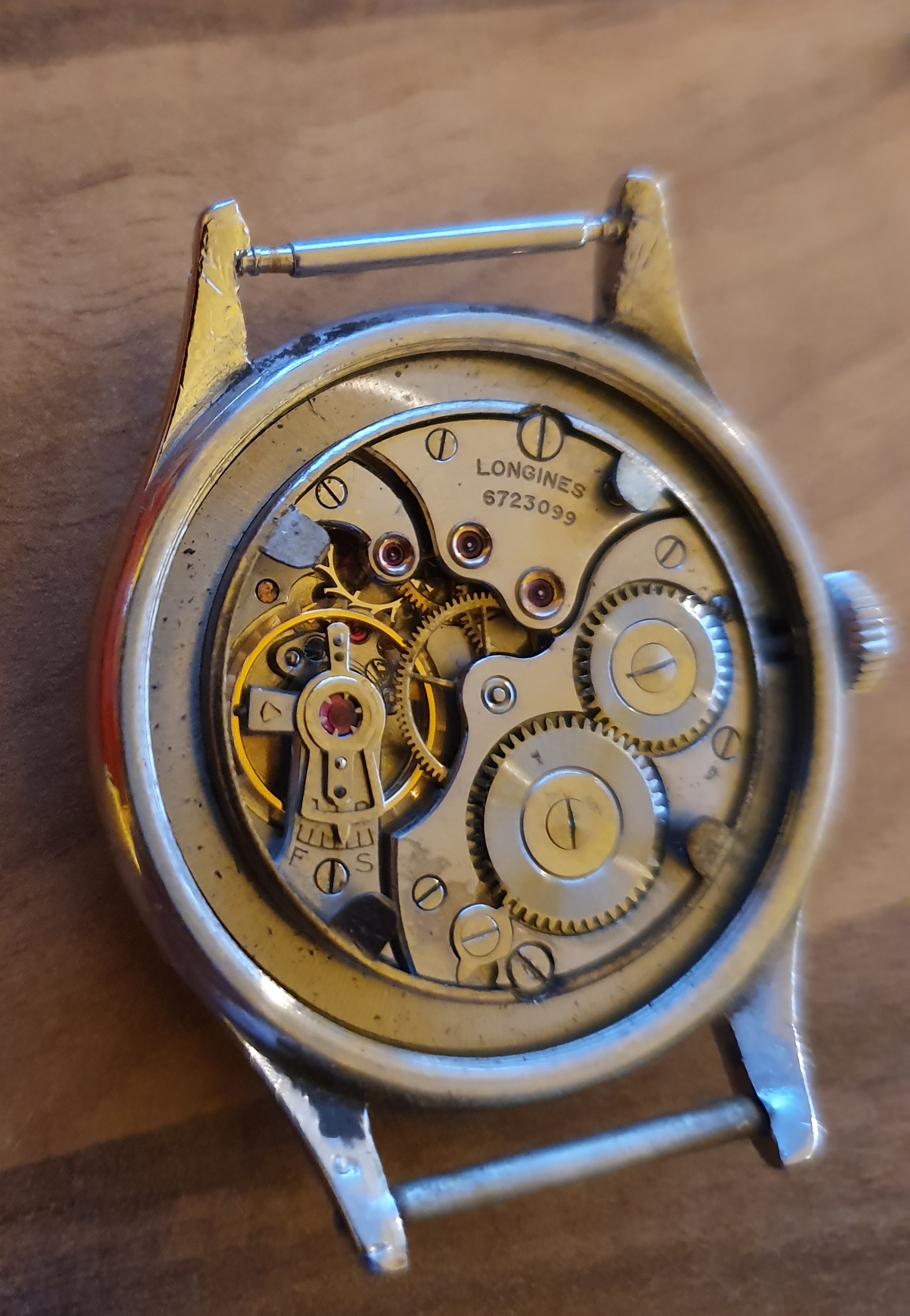

Which movement ?
468
1,955
Been looking at Ranfft but cant tell. Anyone care to help I'd be pleased.
24,801
55,084
I would guess cal 23M or 27M. What is the size of the movement?
468
1,955
A bit hard to measure excactly, bit more than 23 mm
24,801
55,084
OK, I guess that answers it, since it's apparently not 27mm. Should be quite obvious from Ranfft. You can also ask the Longines archive folks, assuming they're working.
103
96
Didnt see one with the same regulator
Here's a few with the same regulator:
https://forums.timezone.com/index.php?t=msg&th=1031044&rid=0
http://chronocentric.com/forums/chronotrader/index.cgi?md=read;id=83844
These regulators seem to appear more often on the 23M center-seconds variant like the one above. I couldn't tell you what the technical difference of the regulator is though. Maybe someone more knowledgeable could chime in.
24,801
55,084
Different regulator, different shock protection. It's the same movement.
468
1,955
Is that an age sign, quality or neither or something else
24,801
55,084
We are talking about an era where shock protection was becoming more common, so earlier movements are more likely to be unprotected, and after a certain point nearly all Longines movements had shock protection. But there may also have been a transitional period where shock protection was selectively added to higher end watches. I haven't made a detailed study of it.
