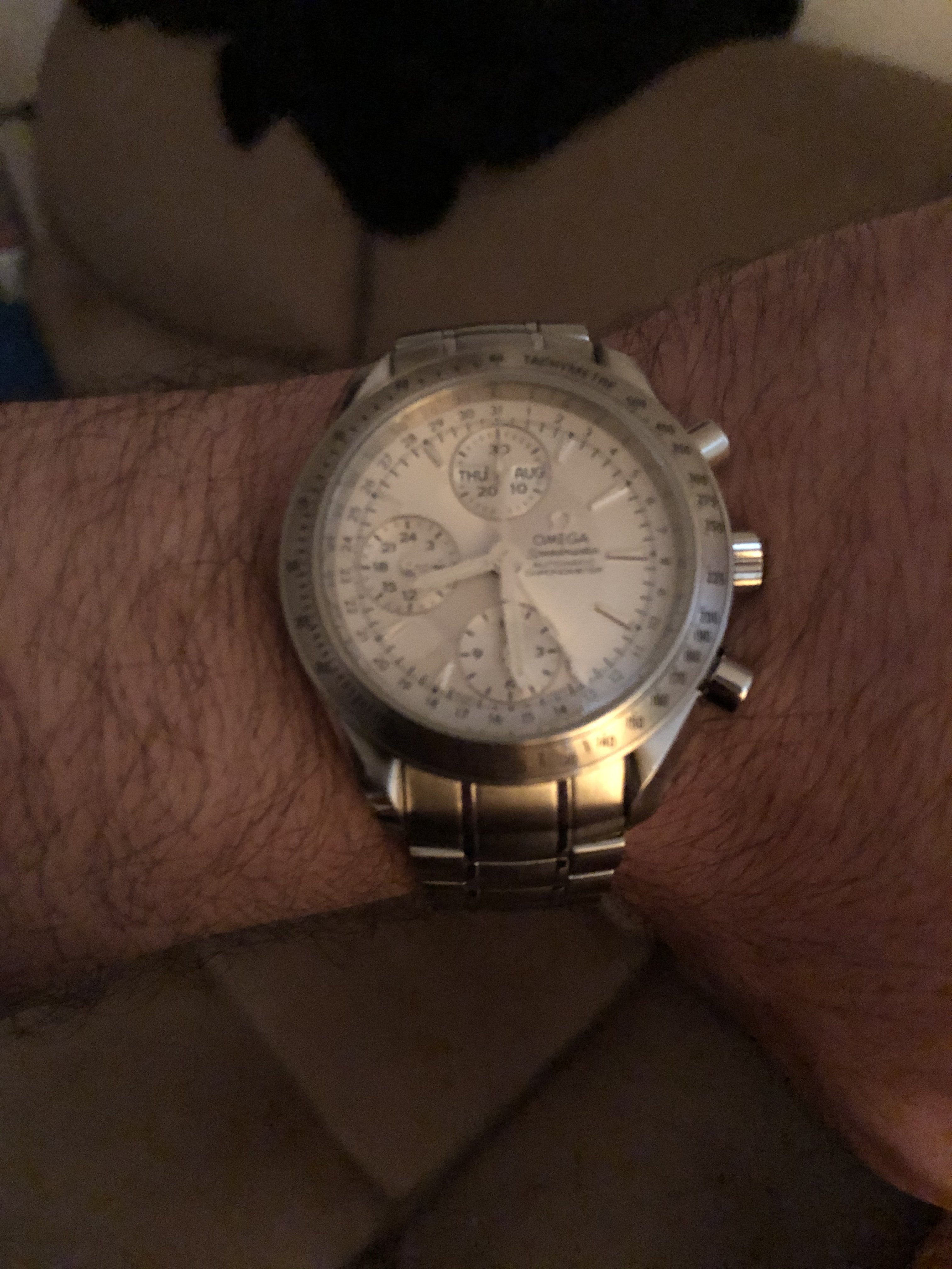

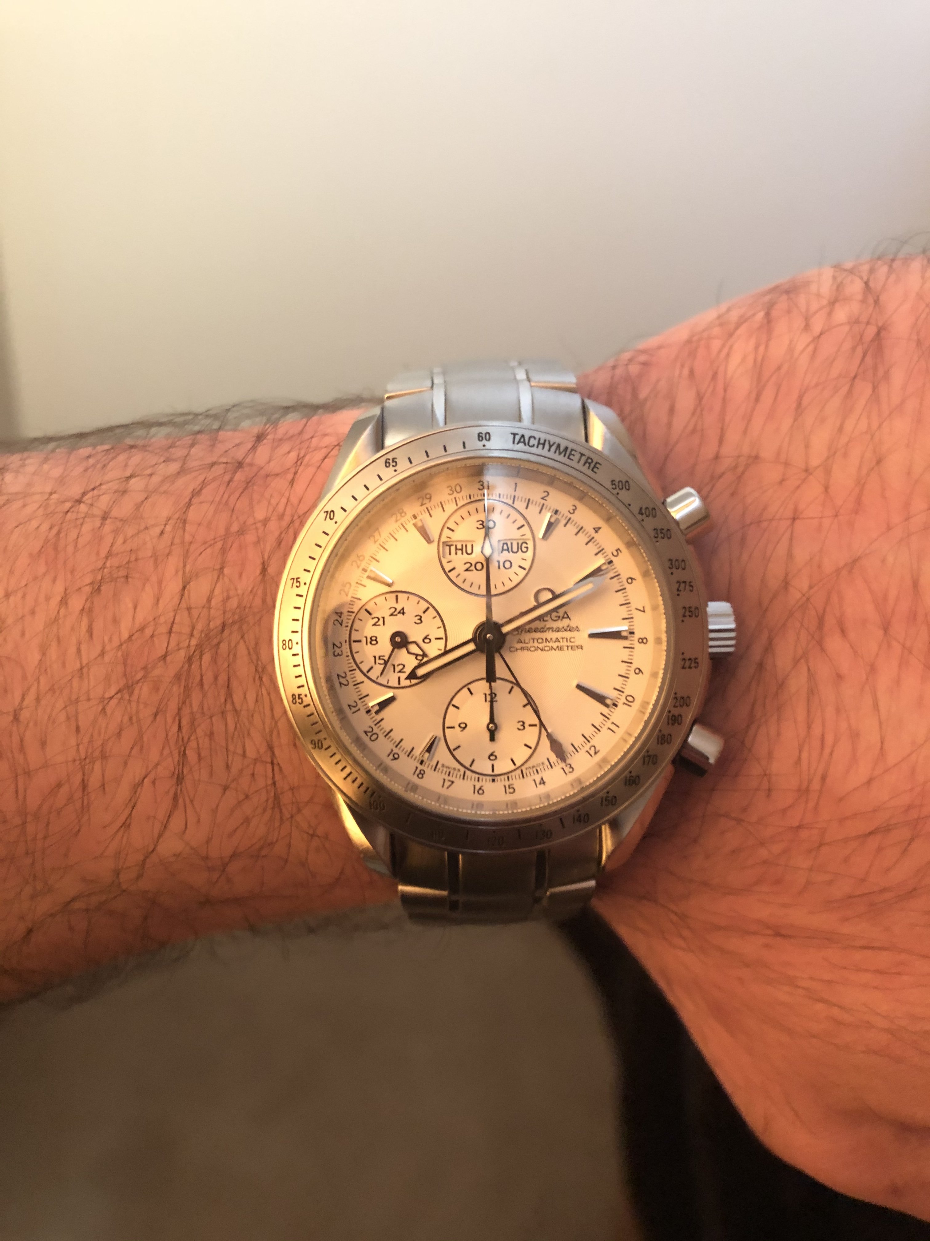

Hello all ... new to this forum read through some posts seems like a good forum ... can some one let me know which model triple calendar is it ? And what’s the mechanism in it ? And which year series was it ? Many thanks to all

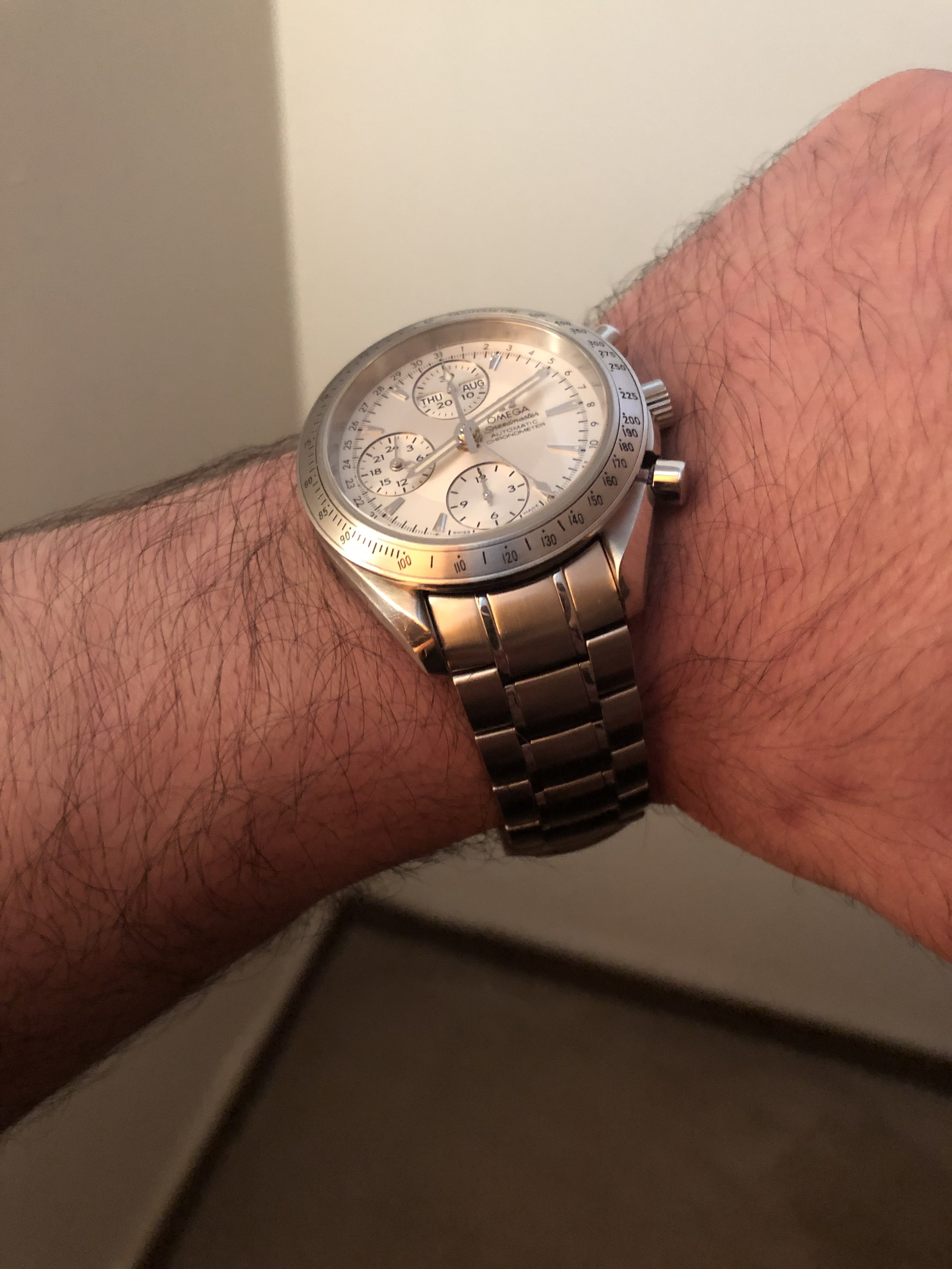

I did check with omega and they said it’s either lamnia movement or else FP but not sure could it be ?

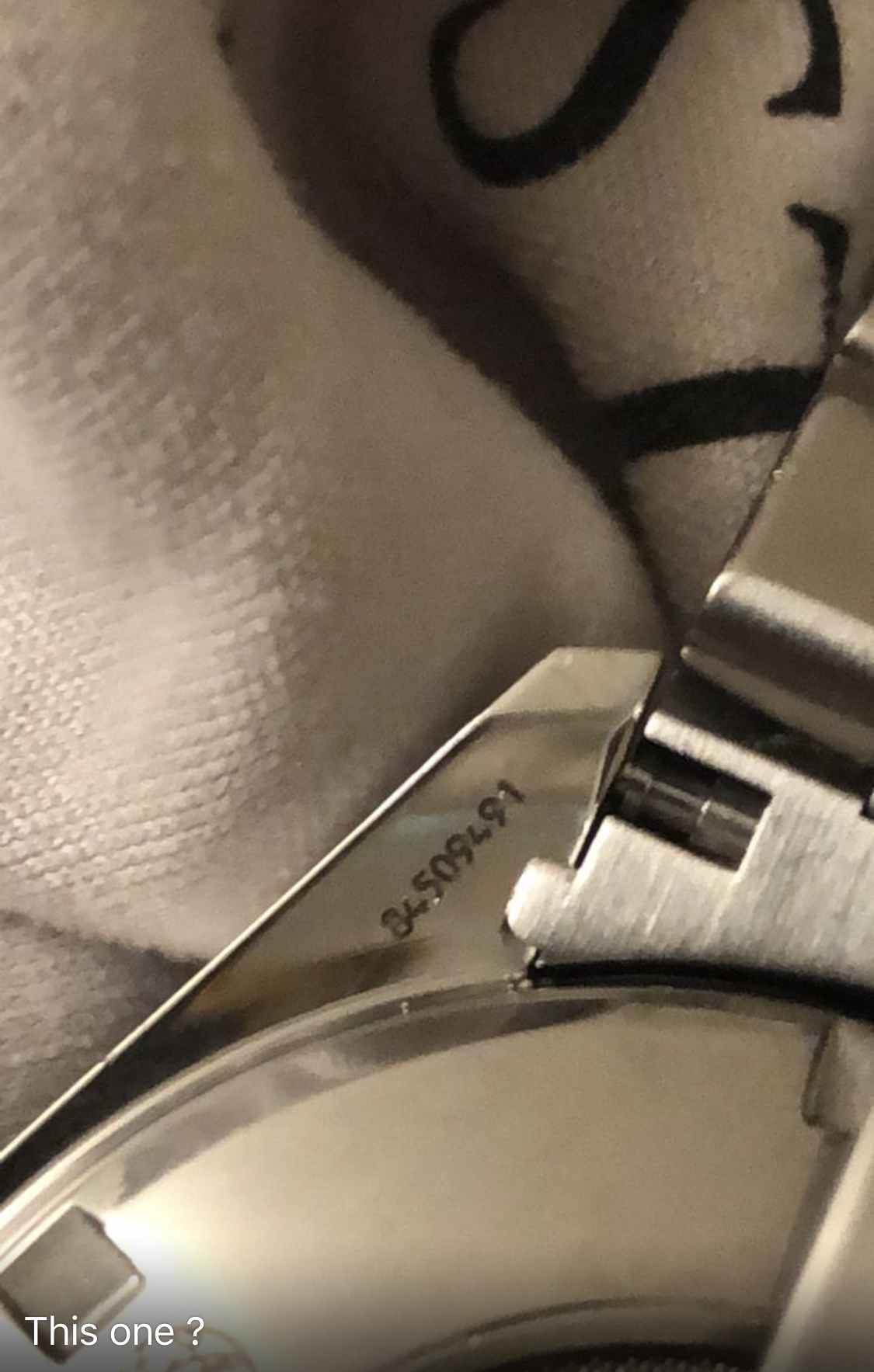

There should be a serial number on the watch - if you post that or send me a PM with it, I'll see if I can confirm, the exact model.

Yes, it's an 1151, based on the ETA 7751...
Many thanks for the help sir .... I see u are technician ... needed ur advice ... do U recommend the watch to be serviced and polished at the omega dealership coz I feel like I am in love with it and will keep it for ever ... usually my watch never ever see any scratches other then the clasp ones which I usually take off at home but other then that never had any scratches on my daily watches ... I will get 2 years omega warranty with it as it got it recently 2 days ago and it’s used watch and since I am going to run it for ever I am titled to give it a new look and refreshed mechanism ... at the moment I am in dubai where the omega has good presence and orginally from Pakistan where the service may not be so good ... so what’s ur take ?

Serial number: 84509491
Article ref: 32213000
Movement is the later version, so a 3606 rather than the 1151, but it is still based on the ETA 7751.
If you don't know when it was last serviced, it's not a bad idea to get it serviced. If you send it to Omega or not is your choice. Any watchmaker with an Omega parts account can service this. You can request that Omega not polish the watch if you like, but there's still a chance they might if the message doesn't get passed long. Most people I work for don't want their watches polished, and yours looks to be in good condition, so I don't think it really needs it.

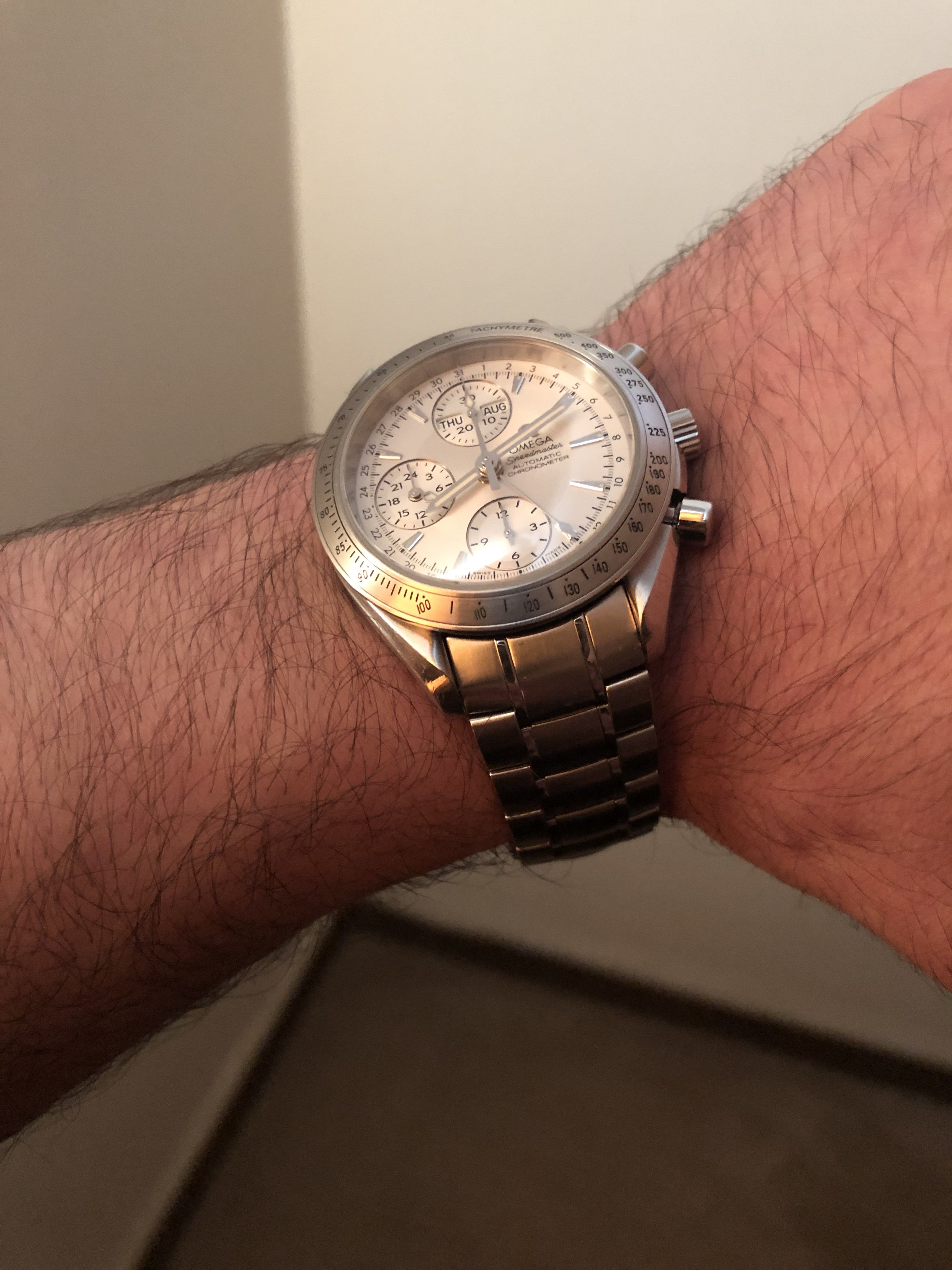

well can’t enough thank you for the help .... I have never polished a watch ... I started of in the watchs at age of 22 and today I am 42 and I started off with one of the trilogy watches so I am one of those guys who consider watch piece of art so I never take them in water ... always clean with soap once a month ... always put it back in the box every day ... always hand wound all my 3 watches every day ... lightly clean it With cloth every day .... now the issue is the that even a small scratch will take my eyes towards it all the time ... it doesn’t need much but just the shinny part of the watch and the bracelet have marks hairline mostly ... so will it make a huge difference if I just get it polished once to bring back the glory ? Asking coz I never polished a watch in my entire life ... the tachymeter is engraved and also Matt so I will ask them exclusively not to polish or even touch the techymeter on the bezel ... the omega people saw it and the tech guy there also says no need for service or polish ...

Hi Hussein and welcome, there are many watch collectors in Dubai as you know, one friend always has a new piece in every photo he sends to me. To polish is up to you, some people prefer their watches to show their wear but others like them pristine, and yes the factory service will maintain each surface the way they were intended so they will not polish your bezel. If you take it to a general watchmaker anything can happen with a polish so it is always best to describe clearly, and get in writing, what you want done and what you want left alone.
Your enthusiasm is something we share here, welcome and enjoy your time with us!

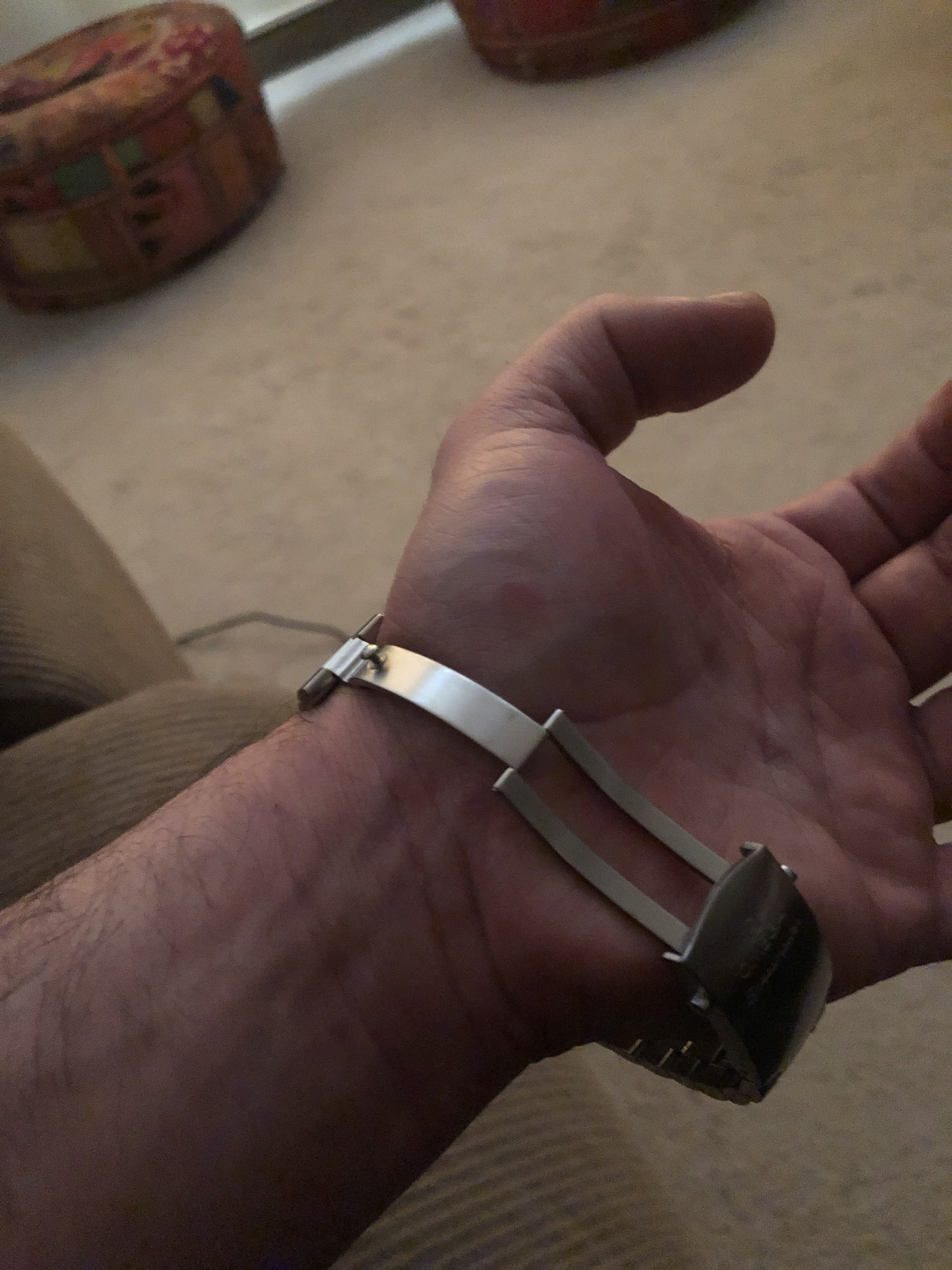

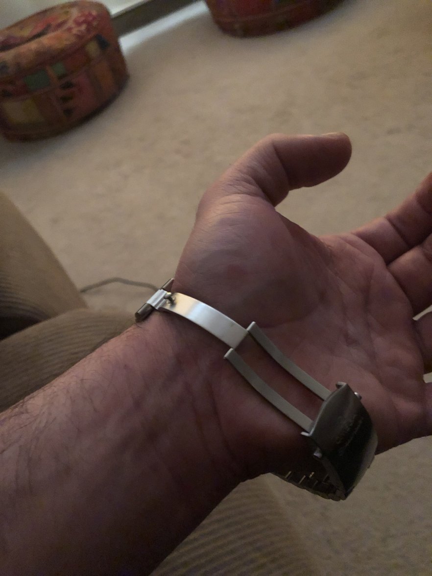

Can anyone give me an idea which year make could this be ? It has the other clasp not the older one ?
521
789
I think that puts it at 2008 or later, but please, anyone speak up if that is incorrect.

The owner claimed its 2011 .... and I have seen a 2017 model as well with black dial and black bezel I am not sure as to when the series was stopped and produced
