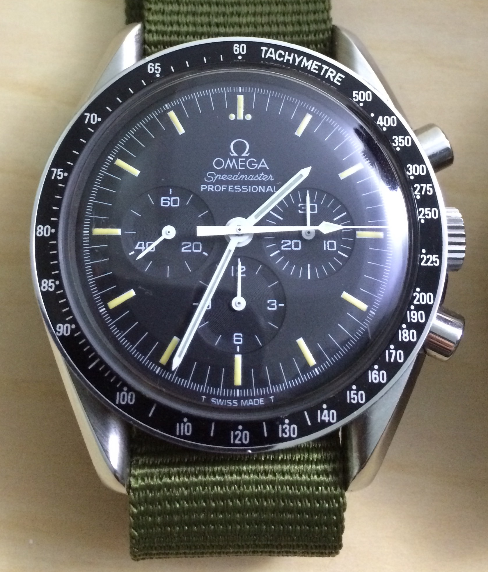

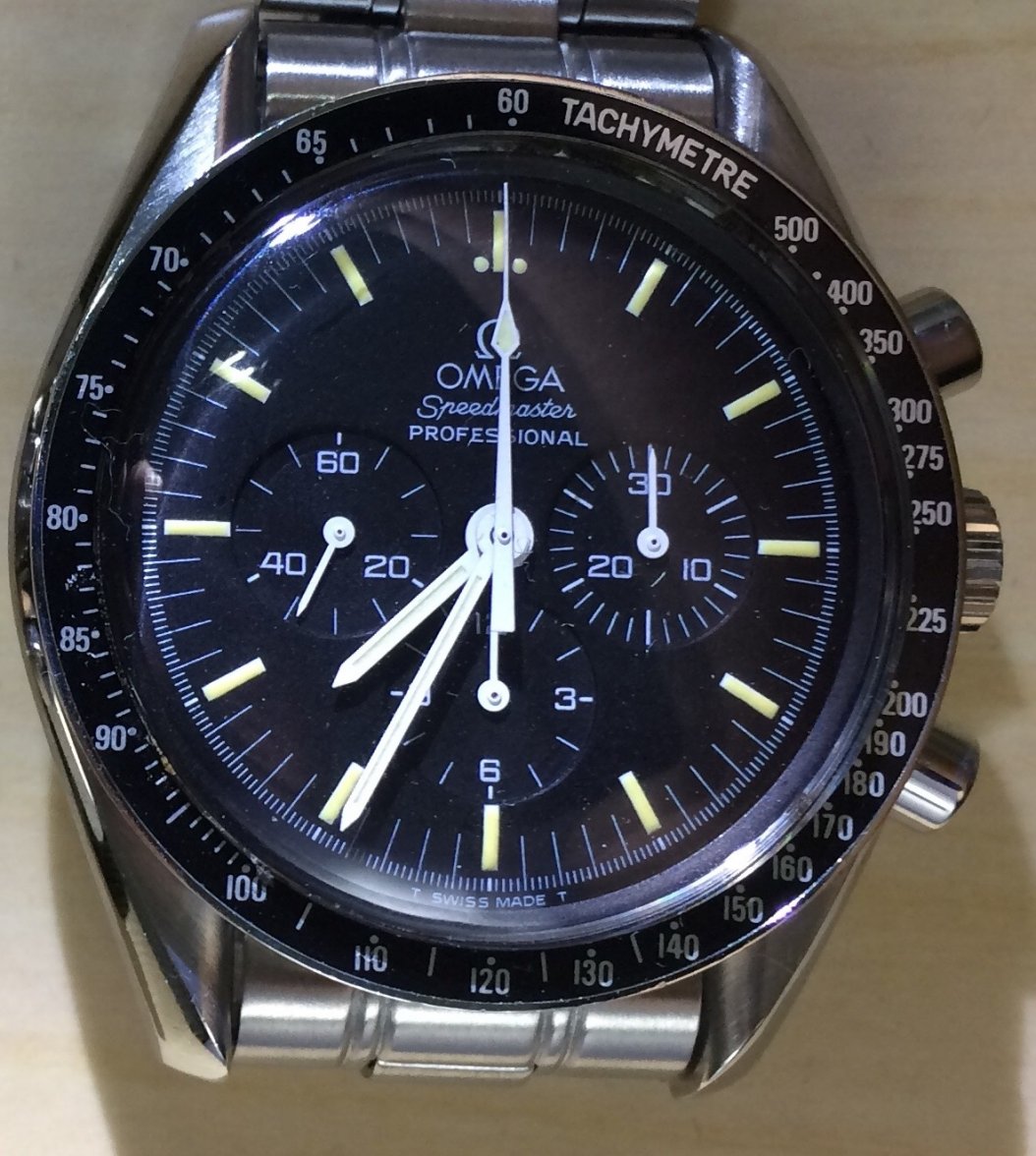

    I have attached photos of both watches and swapped out bracelet of one of them for clarity sake.
    Highly suspicious that the one with the green nato has had its tritium hands replaced.

    I think you may have it reversed, the hands on the first pic look way to clean for a ~20yr old watch.
    I'll let others chime in.
