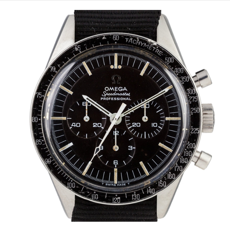

  1. watchknut New watch + Instagram + wife = dumbass Jun 30, 2017
    4,025
    13,790
  2. arcadelt Jun 30, 2017
    1,038
    1,299
    Wrong dial.
  3. alam Jun 30, 2017
    8,095
    18,682
    if so, then off the chart! :)
    Mark020 likes this.
  4. Taddyangle Convicted Invicta Wearer Jun 30, 2017
    4,820
    31,399
    And Chrono hand.
  5. arcadelt Jun 30, 2017
    1,038
    1,299
    Write up says that movement is four years newer than the case, so begs the question whether this watch was put together from parts. Based on Speedmaster101, $15000 minus dial, minus hands, minus movement, so perhaps [well] less than $10K?
  6. 77deluxe Jun 30, 2017
    2,058
    4,613
    Parts watch. So subtract the value of disingenuousness. Is disingenuousness even a word? A = case value + "E" for effort.

  9. watchknut New watch + Instagram + wife = dumbass Jul 1, 2017
    4,025
    13,790
    @Spacefruit I just find it a bit odd that they have a cobbled together Ed White with a movt that they say is 4 years newer than the case...and a dial that is totally wrong.
    I have always respected them as well, but not having full disclosure on this one and asking that money seems a bit off to me.
    They know it is incorrect, yet choose to have it described in such poor terms.
    Imagine if someone described that watch as such on here and asked that price? They would be hand eviscerated like a chicken.
    Just my 2 cents.

  10. KJH666 Jul 2, 2017
    289
    262
    I suppose there is a market for watches with replacement parts for those who perhaps cannot afford the real thing. The issue here is that the price being asked is consistent with the Watch being correct, which it clearly is not.
    The watch does have some attractions, the applied Omega logo, the don insert, the stepped dial and yes it is even pre-moon, but anyone buying a 105.003 wants it to be pre-professional as well.
    At $10k it would look a more attractive proposition.

  18. BartH Follows a pattern of overpaying Jul 3, 2017
    1,770
    7,686
    Looks like a nice 145.012 in a wrong case.

  20. harrymai86 Jul 3, 2017
    1,254
    2,708
    Is it just me or the stamped ref no on case back 105.003-64. the "4" looks abit too big and off?
