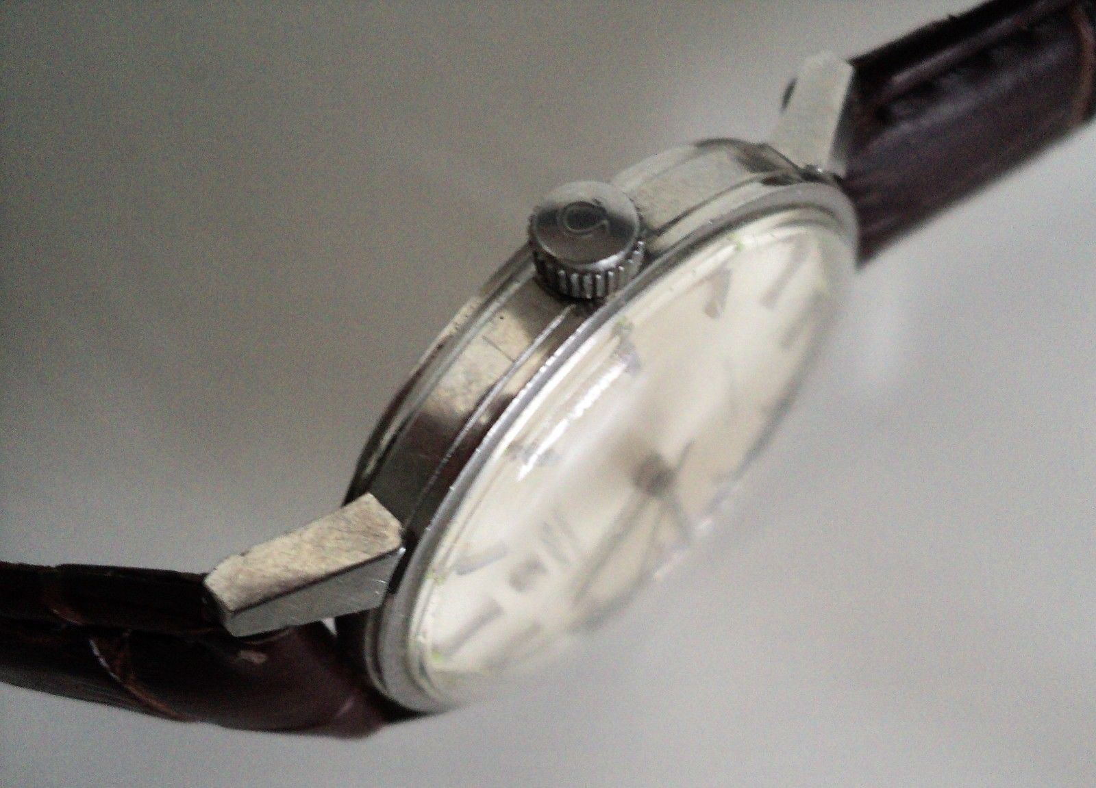

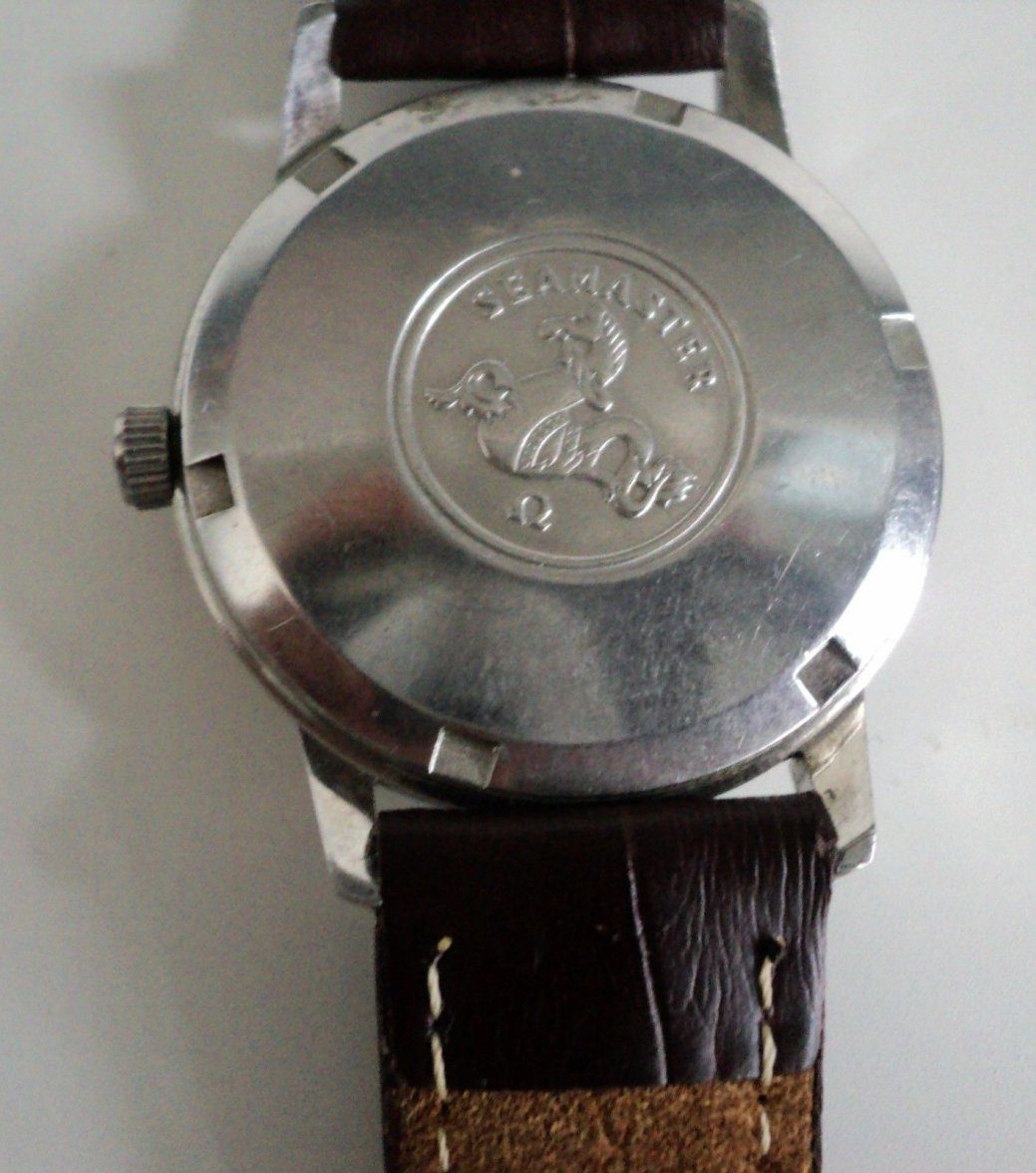

    I've been told this watch has a redial and I wanted to know where i could find a authentic dial (can be used) for under $50. The crown is also not authentic so i would like a real one. It's from 1960-69 and the case size is 35 mm. The watch costs $180 rn but the auction has 7 more days. s-l1600.jpg s-l1600 (1).jpg s-l1600 (4).jpg s-l1600 (3).jpg

    Maybe start looking for a new case at the same time, that one's been polished to death.
    Seriously, you would be wise to look for a better example, there are a few around, just take your time..

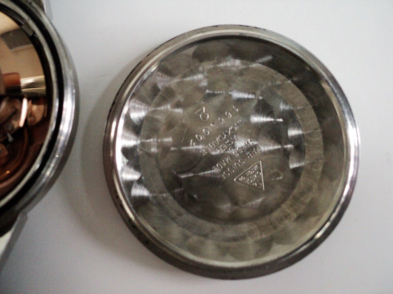

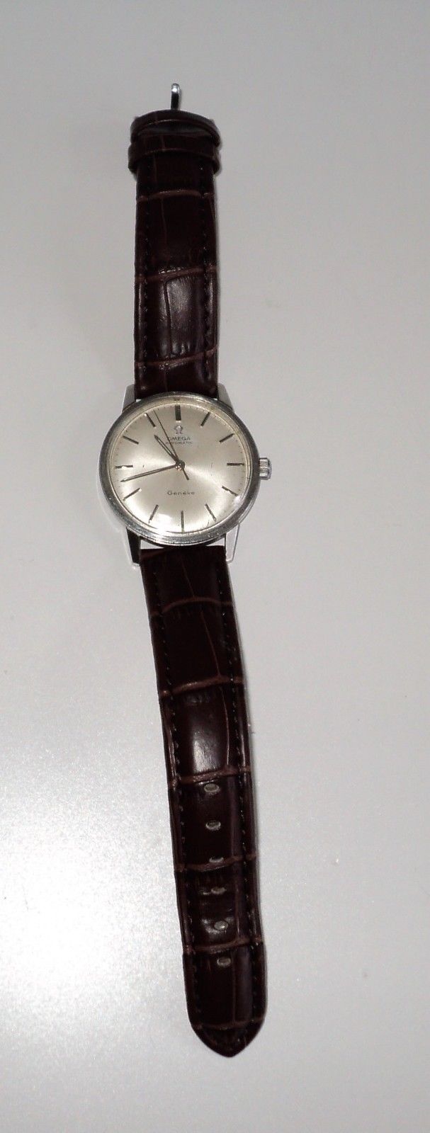

    I like the other watch because the seller said it was serviced. Is this better?
    s-l1600 (7).jpg s-l1600 (8).jpg s-l1600 (9).jpg s-l1600 (12).jpg s-l1600 (11).jpg s-l1600 (10).jpg

    Rough case, wrong crown (maybe), dial from a Genève when it should be a Seamaster.
    You need to spend some time learning about your target watch and then buy with confidence.

    you sure about that, I've seen more than a few Geneve's dials in this case type
    rohin likes this.
  10. JimInOz Melbourne Australia Jul 31, 2018
    15,467
    32,300
    Just using the reference number, Omega calls it a Seamaster.
    I know that the Seamaster/Genève names were often interchanged, but not in this case.
