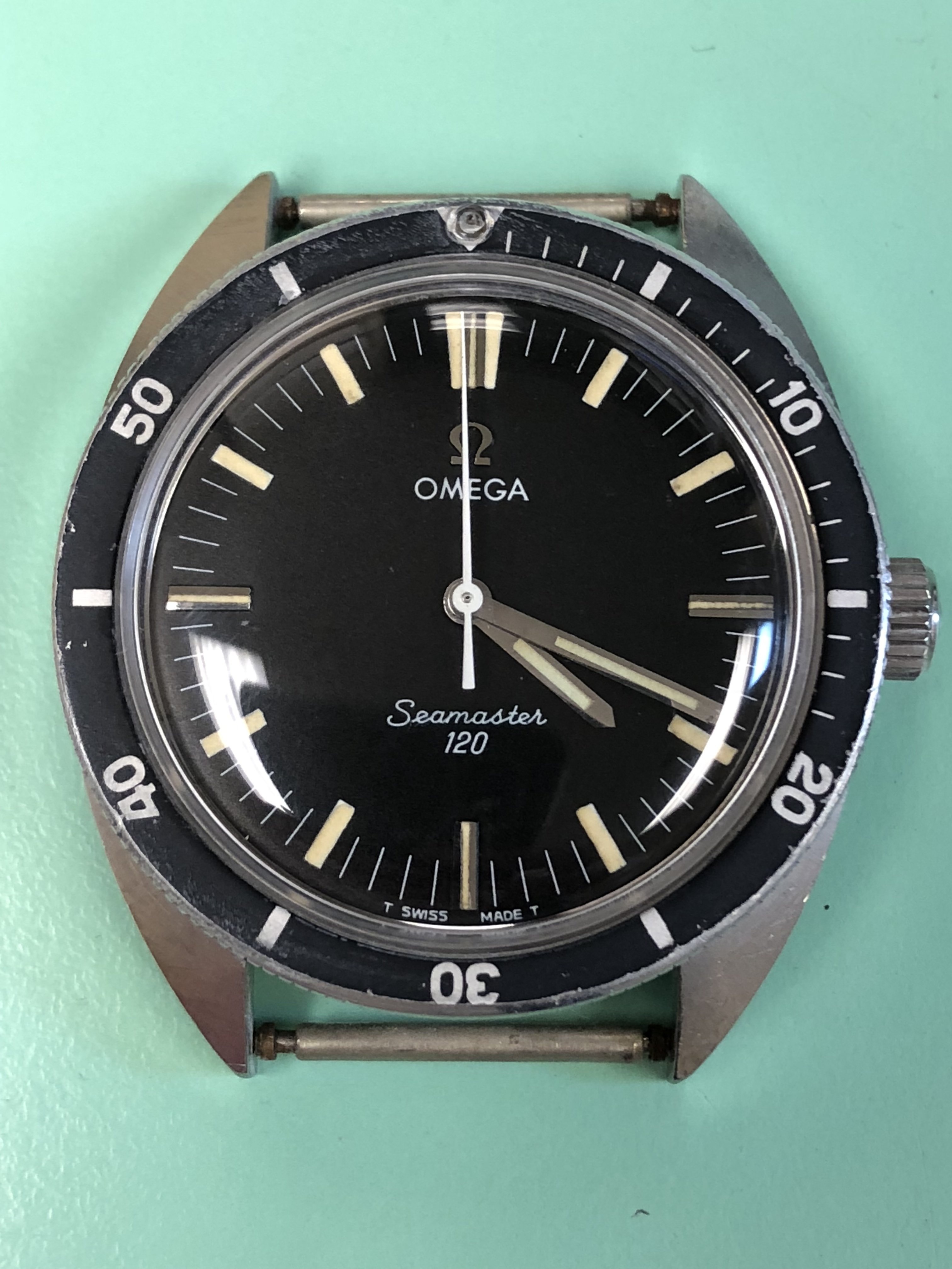

    Hi to all, i just acquired a marvelous Seamaster 120 model 135027, but unfortunately no matching bracelet. A friend of mine told me about reference 1177 with end links 540. Impossible to find so far, and also impossible to post a message on this forum (insufficient privileges). Should be shipped to Belgium. Thanks for your feedback ! do not hesitate to send me an email on sorgelooseDOTgregoryATskynetDOTbe

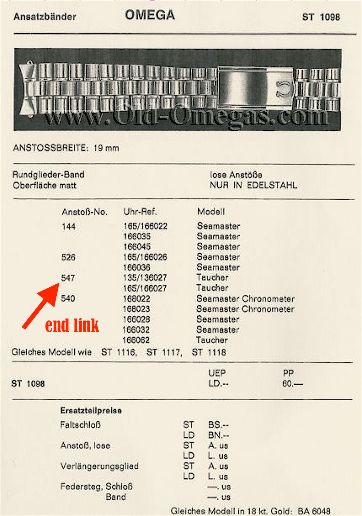

    Maybe 1177 is a typo ?? Think it probably should read 1117 / 540
    However according to recent post on bracelets you might want to look for a 1098 (with 547 ends) which looks identical to the 1117
    https://omegaforums.net/threads/fro...ge-seamaster-and-speedmaster-bracelets.45883/
    First one, 1098, is designed for 19mm endlinks. It was found with 540 endlinks on Seamaster 60 "big crown" 166.062 or with 547 endlinks on Seamaster 120 165/166.027. This one is on 20mm 575 endlinks that are obviously too wide for this bracelet.
    EDIT 1098 was fitted on:
    Seamaster 165022 166022 166035 166045 with 144 endlink
    Seamaster 165026 166026 166036 with 526 endlink
    Seamaster 135027 136027 165027 166027 with 547 endlink
    Seamaster 168022 168023 166028 166032 166062 with 540 endlink
    Some sales posts claiming 1098 / 547 as period correct for Seamaster 135.027

    1067/532, 1069/524, 1172/570 and 1098/547 are correct for 165/166/135/136.027

    based on the vintage ads a ..... OMEGA CORFAM (or perhaps a Leather) strap... and or ..... 19MM curved end Swiss Tropic MOD Dep. along with ..... Omega 1098 Bracelet /w 547 endlinks for Seamaster 120 case ref # 135.027 [19mm] would be appropriate for the 120 both manual and automatic versions ...
