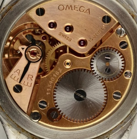

I’ve just found this 30T2 with a serial number exceeding 11.3M, anyone seen/own one with a higher serial?
