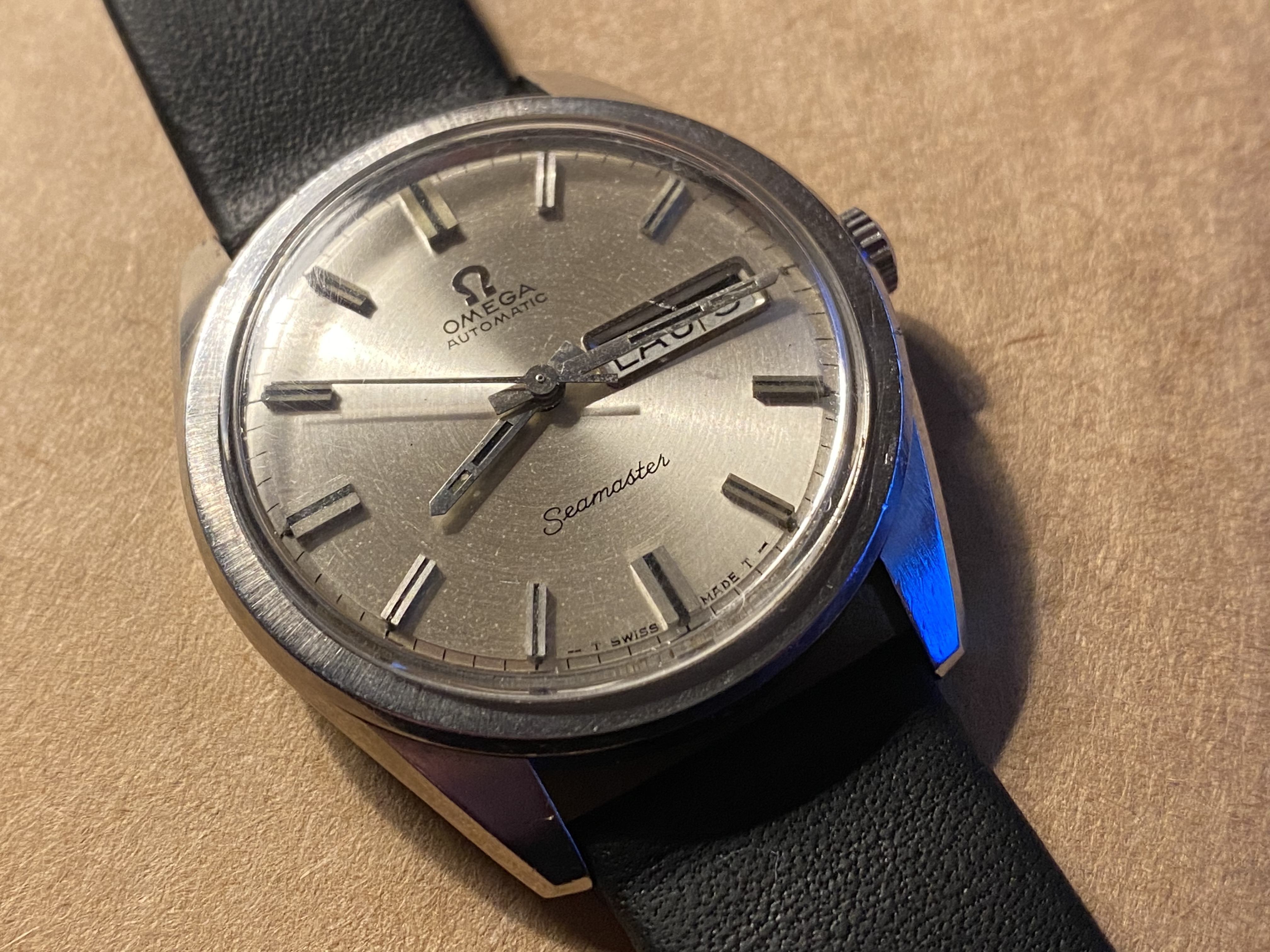

Hey folks,
I've just received a beautiful example of a 166.032 from our very own @ConElPueblo , sporting a cal. 752 that runs very smoothly.
When going through the lengthy process of setting the day and the date, I noticed that the day disk jumps over at midnight, yet the date does so at exactly 5am. It's been a while since I last owned an Omega with a 752, so I was curious if any of you could tell me if it's designed to work this way (maybe for both functions not to interfere) or if it's an "issue" that I might have adressed by my watchmaker?
I'd like to point out, in all fairness, that this is not to criticize the seller in any way - he's as curious as I am, so this is for educational purposes only, not to re-negotiate or express any hard feelings.
Thanks a lot, looking forward to be enlightened!
