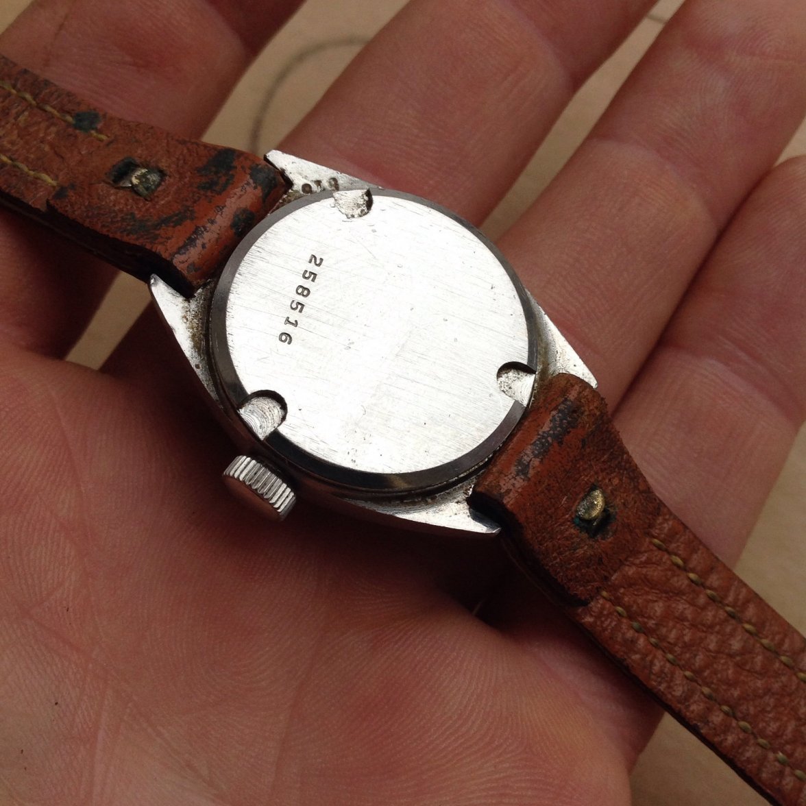

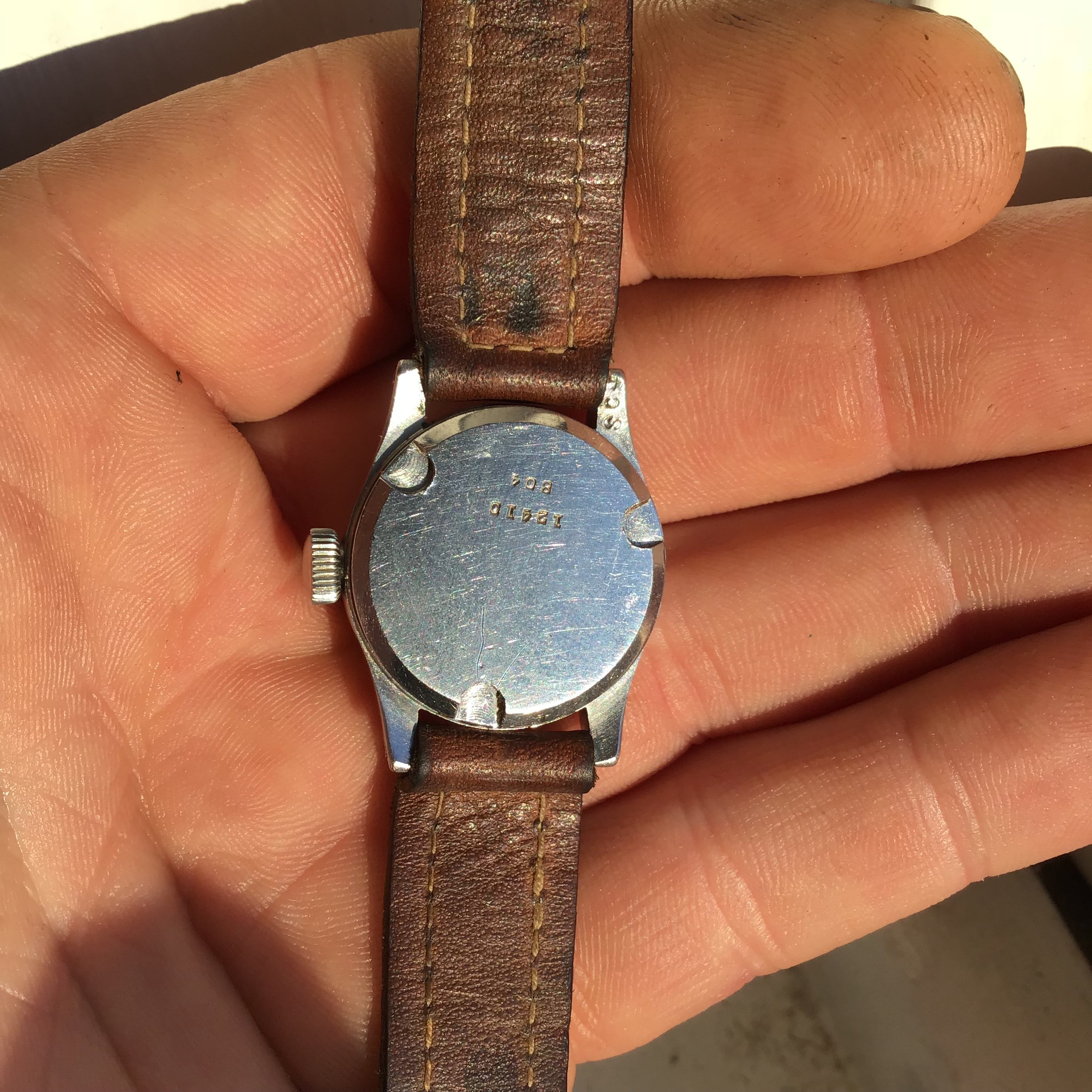

Based on what I have seen, this practice began around 1936 with the introduction of the waterproof "tre tacche" (e.g. reference 3777) and continued to be used into the mid-1960s on at least some waterproof references (e.g. 902x).

I’ve only seen it on screw back cases, I suspect it’s because the snap backs are easier to fit while the screw backs have to be really tight and precise.

I don’t think so because it’s the second number on the back after the order number.
To me it clearly seems applied at the same time or in the same framework as the Longines batch system.
