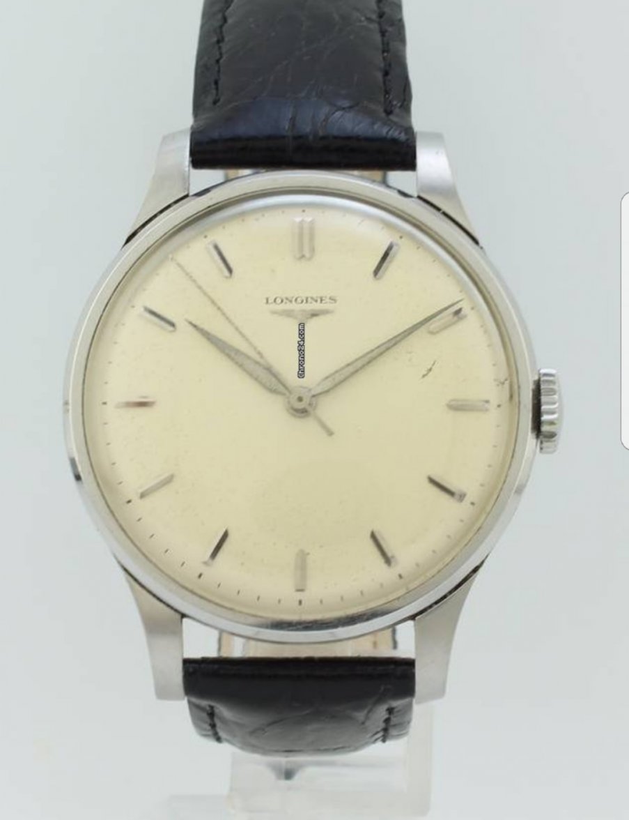

    Is there a concensus when Longines first started to put the applied hourglass logo on their dials (like on 1954 Longines Conquest)? In particular I would like to know when these applied logos first appeared on 12.68Zs.

    Applied, winged-hourglass emblems can be seen on early examples of the 30CH from the late 1940s. I have seen applied emblems on examples of the 12.68Z from the early 1950s but "raised" emblems were far more prevalent.

    Applied? I have seen printed on 12.68Z dials from as early as ~1944 but not applied.

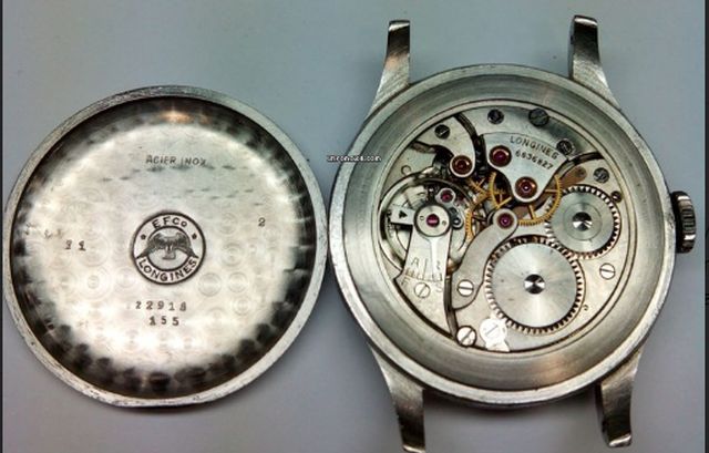

    I have a Longines 10.68Z with Movement No. 5630xxx which was invoiced in late 1940 to UK. According to the movement number it should have been in 1937.
    The 12.68 I posted is dating to 1944 according to movement which is a little early for this dial, but let's see when I have it in hands I will contact Longines and ask for an extract.

    Surprisingly early serial number on the 12.68N. Style of case-back markings matches though. Difficult to imagine such a dial from ~1945 on a Longines. Keen to see the extract.

    The serial number of the movement says mid 40s but in my opinion the dial is from the 60s

    I would have put it more to early-mid 50ies.
    Well let's see what Longines will say to that suspect. I will also ask if they can investigate when the first applied hourglass logos appeared on dials -especially on 12.68s to widen up the forums knowledge base.

    I'd say early '50s.

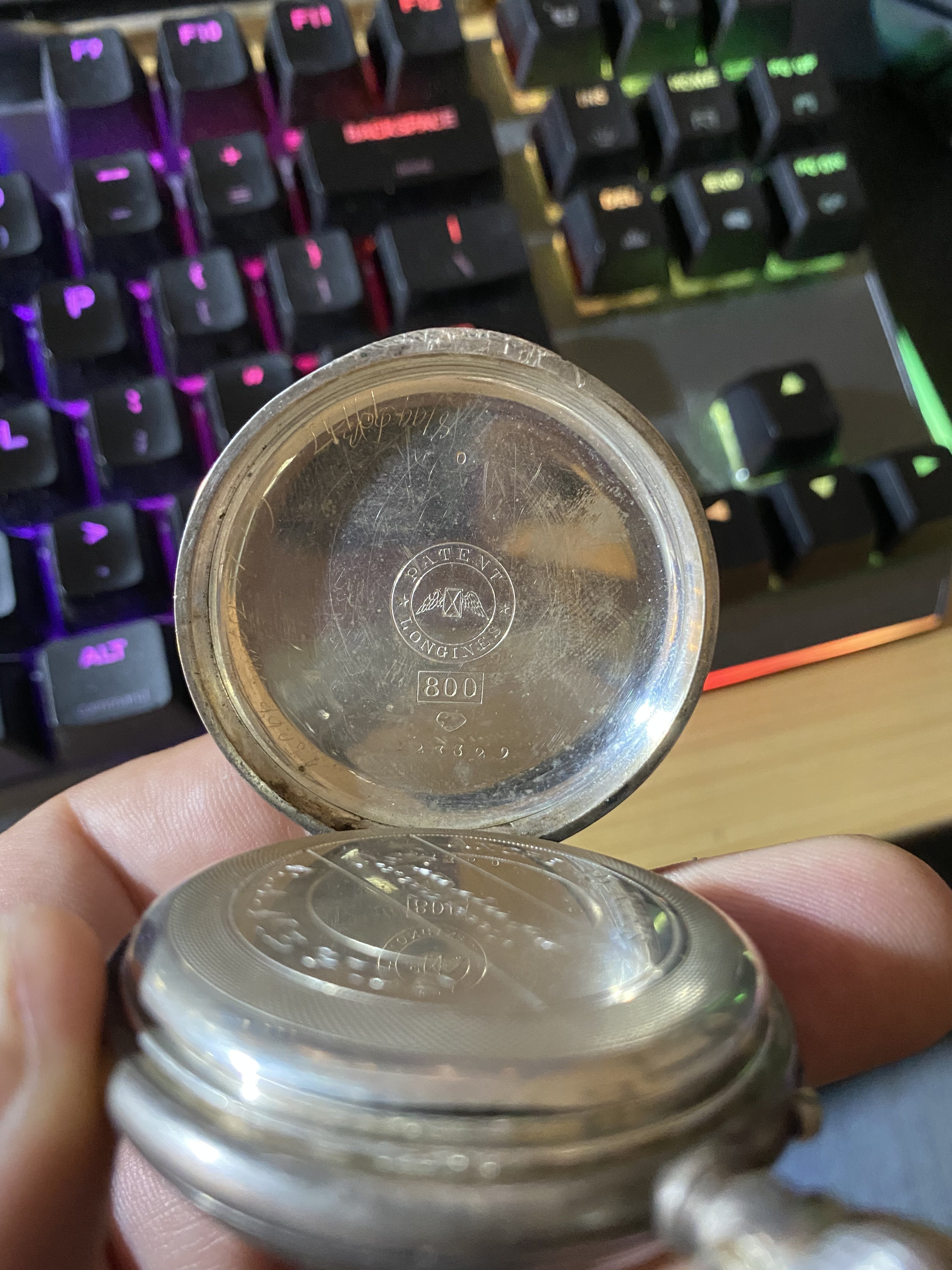

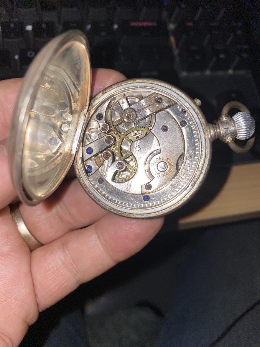

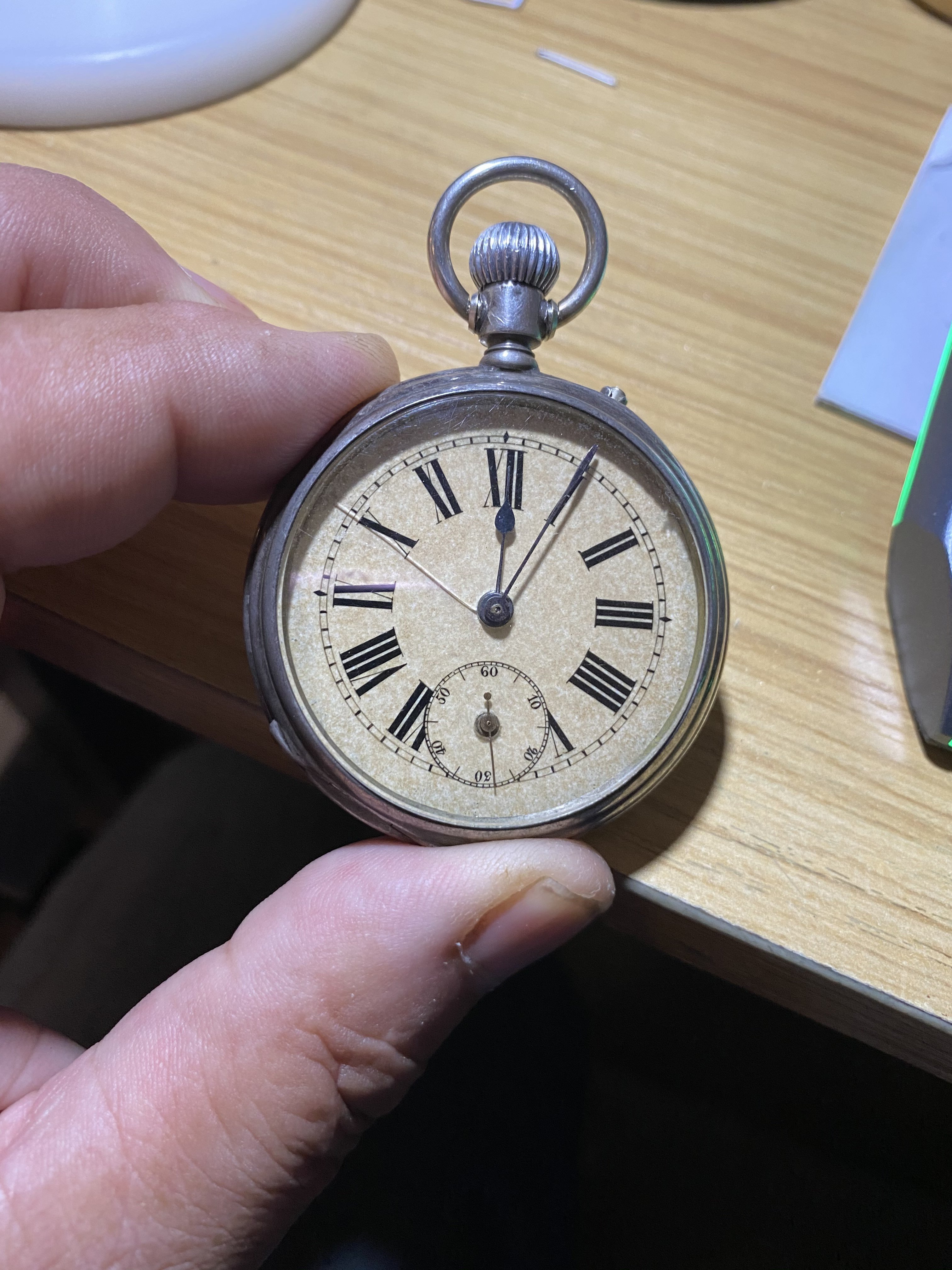

    Here we see the winged hourglass in use in this 1882 pocket watch. 7 years before it was registered.
