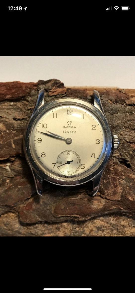

What’s with the Türler print on the dial at some models ?
666
485
Seen some omega models with the printing Türler on the dial.
Why excatly is that print on some models ?
And is it better or worse in the aspect of the value of the watch?
For example this one:
It’s a ref 2450-3 with Türler print. Any idea of value ?
Is this example more value then an ordinary 2450 without the Türler print
Thx for a great forum / M

Türler is a large European watch dealer.
It is just like Tiffany putting their name on some of their watches.
Sometimes these names can give a watch a little more provenance, but on occasion these scripts can be faked.
Value? in the eyes of the buyer.

Double-branded watches typically do have more value than otherwise equivalent ones, but it depends on the retailer. Turler is both well-known, and sought-after by some collectors.

Nowadays, redialers tend to put Turler or Tiffany &Co to make it look original, that dial is one of them, I think.

For me personally, genuine or not and no matter the retailer, it's definitely a negative...

Maybe it’s no original print ? I’m not the one who can judge that.

That dial looks correct to me, though better photos would be be required for a more confident opinion. There were different styles used.

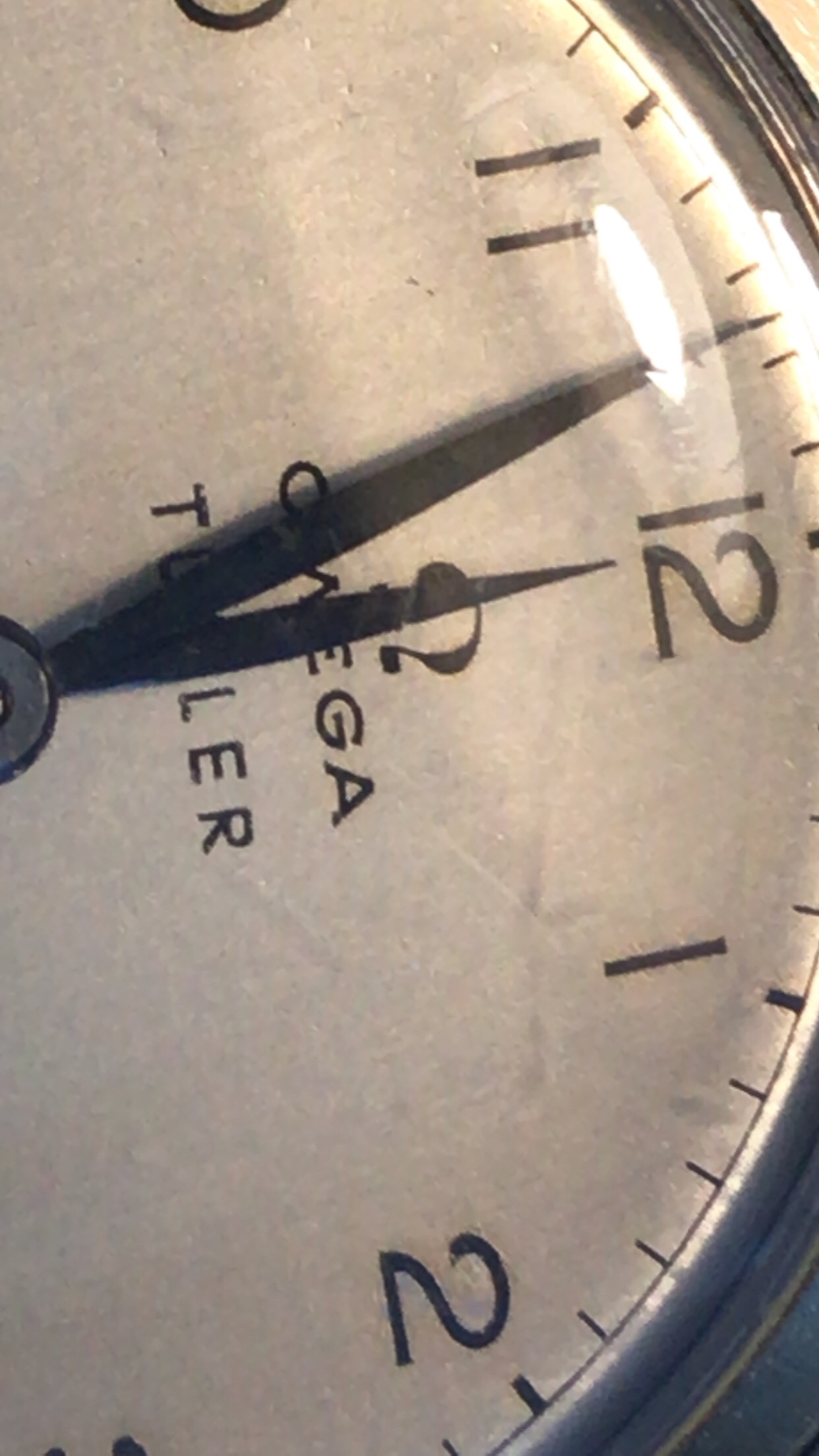

I Will fix better and more pictures soon..
