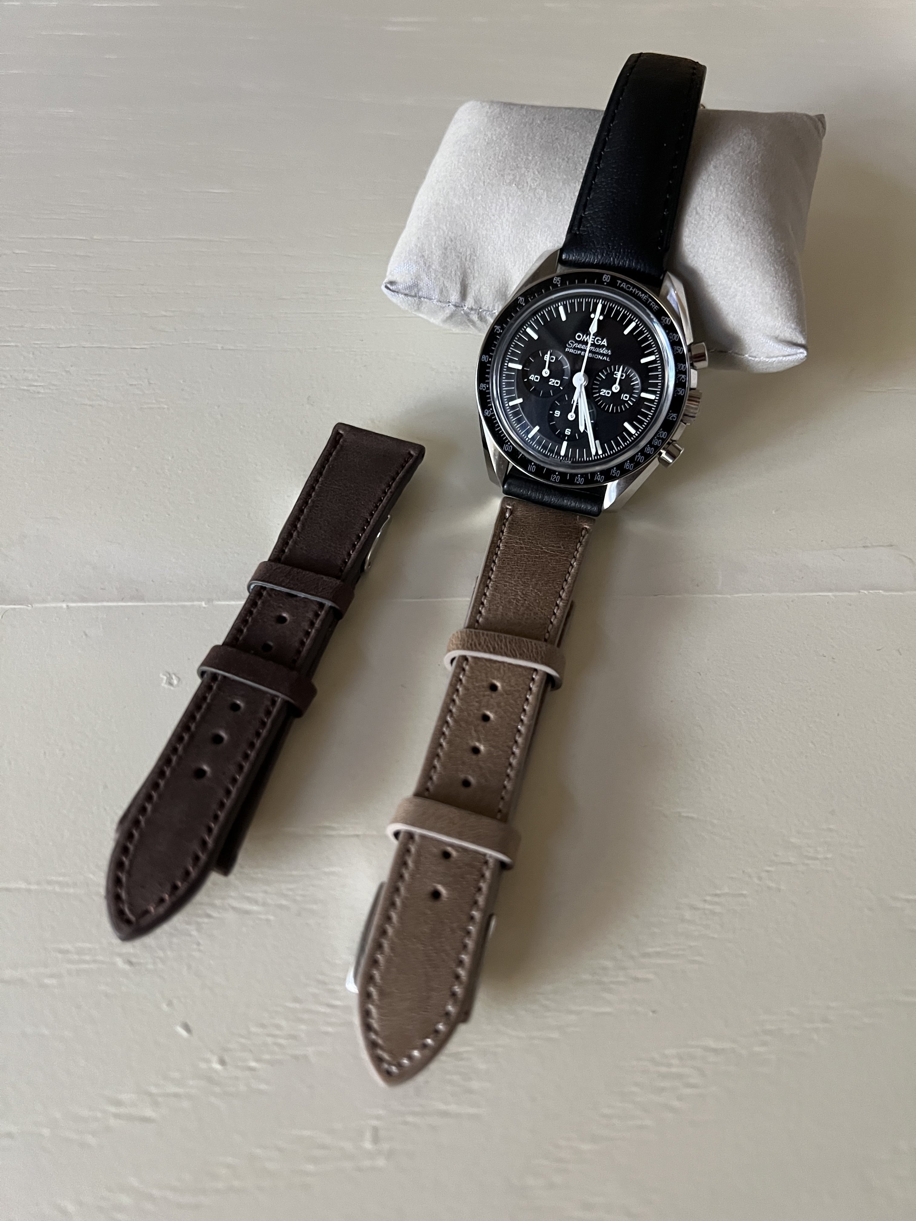

That would be the plan… haven’t tried yet. I bought some 19mm straps for a 19mm watch, but I think they would also look great on my speedy.
Right on. Any pics of the straps you care to share? Also the speedy?! Haha
