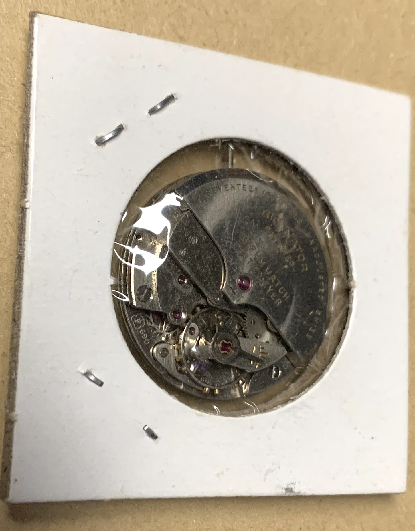

I went through a phase where I was intrigued by automatics. Even to the point of getting a large coffee table book on them. Of course I wanted a Bidynator. One of the Mart dealers used to package movements in coin sleeves. Which I though a clever way to display movements. This is the only one I have like that though.

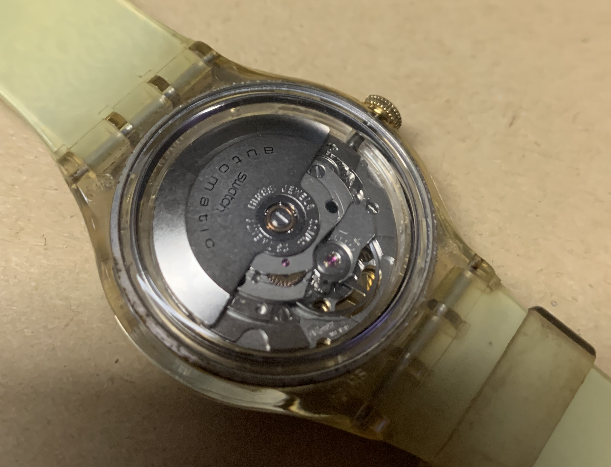

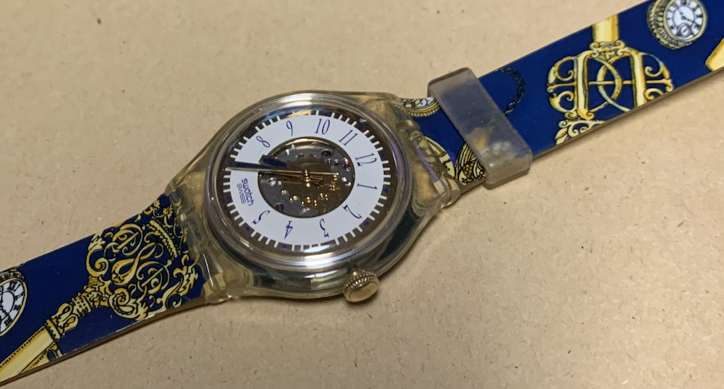

My favorite Swatch is an automatic with an ETA 2842. Showing it's age a bit now.
