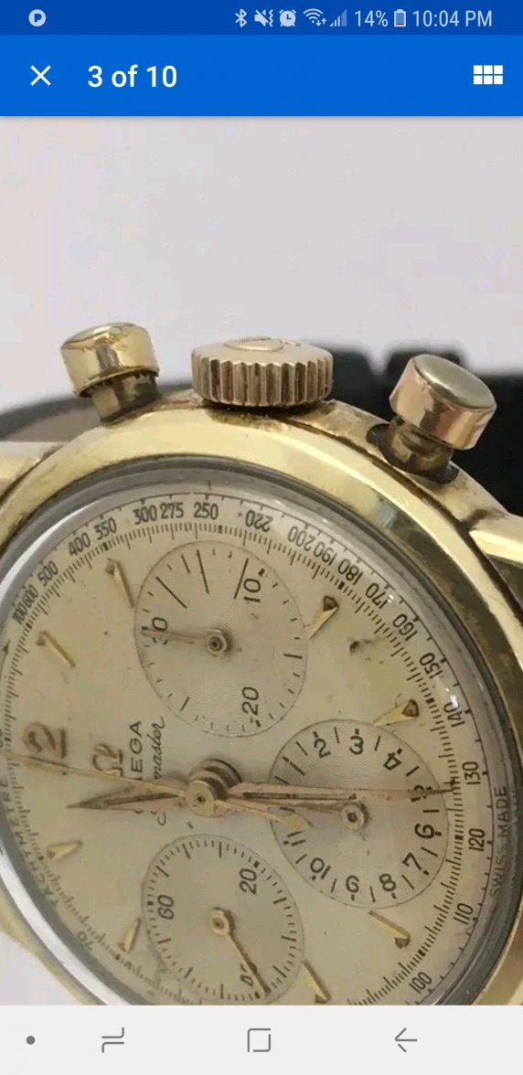

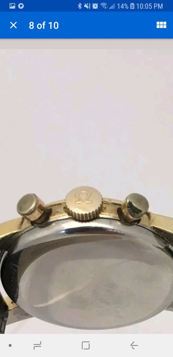

    Ok, will start with a couple pics of the pushers...
    So is the pusher on the right in the last image just devoid of plating, or should they appear to be one continuous piece? The one on the left would imply a plated collar. Is there something other than appearance that screams the pushers are not functional? Clear pics for the more informed on the subdial and sweep hands.

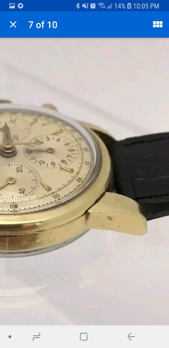

    I assume this is the lug where you can see the plating flaking off?

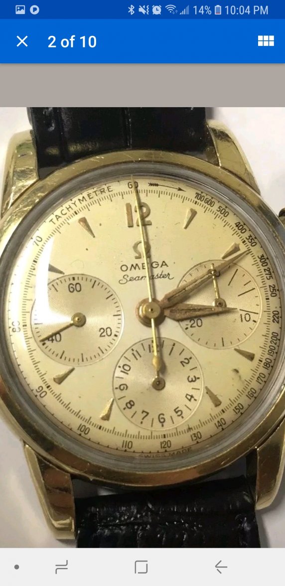

    Regarding the dial, is there anything other than the black spotting, the wear at the end of tachymetre, and the spots at some of the lines? Obviously, I think, the wear like at the end of tachometre wont clean. Does this appear something a cleaning would clean up some, not really have an effect, or be in a state of rapid deterioration? I know black spots on carbon steel wont go away, but with proper maintenance wont get worse. Are the hands supposed to be skeletal and filled with something that glows, or was that something that was done later? Is it correct to assume the dial has not been redone? I also noted loss of crispness on some of the markers.
